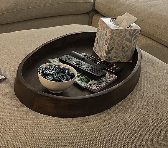

I’m relatively new to CNC and carbide create. I’m trying to make a bigger version of this tray.
I was able to make a rectangle and use node editor to pull out the top and bottom. I still need to do the sides. I made a duplicate so I can pocket the middle.
My question is: how can I make my file look like this with the chamfered edges? Do I need to do a second duplicate in the middle?

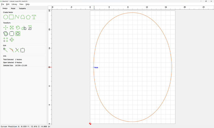

Start by drawing a circle:
Center it:
Scale it to match, clearing the checkbox for “Keep Proportions”:
Done
Since this isn’t as rounded as we want, a bit of Node Editing is in order.
The most expedient way to get precision when Node Editing is to draw in geometry which defines where one wants nodes to be — in this case, it should work to use the existing geometry:
Or, one can coarsen the grid and move the object so that the on-curve node is aligned with the grid pattern:
Repeat for the other side:
Adjust and repeat until one arrives at the desired shape:

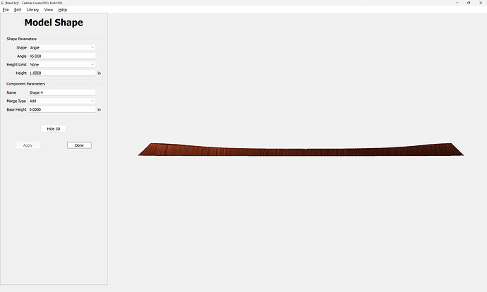

This should get us geometry which when selected and modeled to the desired height:
will result in the desired slope/angle:

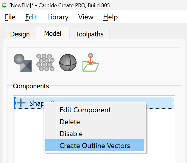

We then right-click on the geometry in question and choose “Create Outline Vectors”
entering the desired height
which does not have the desired result:
Backing up, we try re-examining the modeling to determine the difficulty:
and it becomes obvious that we will need to model past the Stock Thickness:
(indicated by the red area)
and adjust based on that.

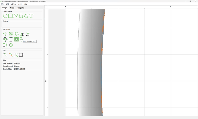

We then Ungroup Vectors
and use the geometry for the top outer edge to model this flat and equal:
at the desired height yielding:
which shows that we are not getting the desired change in slope (due to allowing the additional projection) — re-working the geometry and model would seem to be called for…

Actually getting the differing slope angles can be done by exporting to a vector drawing program which supports blends:
Assigning white to one outline:
and black to the other:
Selecting both:
and assigning a suitable blend:
and adjusting until things are shaded as desired:
Then export as a pixel image
and import:
It is then possible to trace the vectors:
Remove the redundant geometry:
after ungrouping
