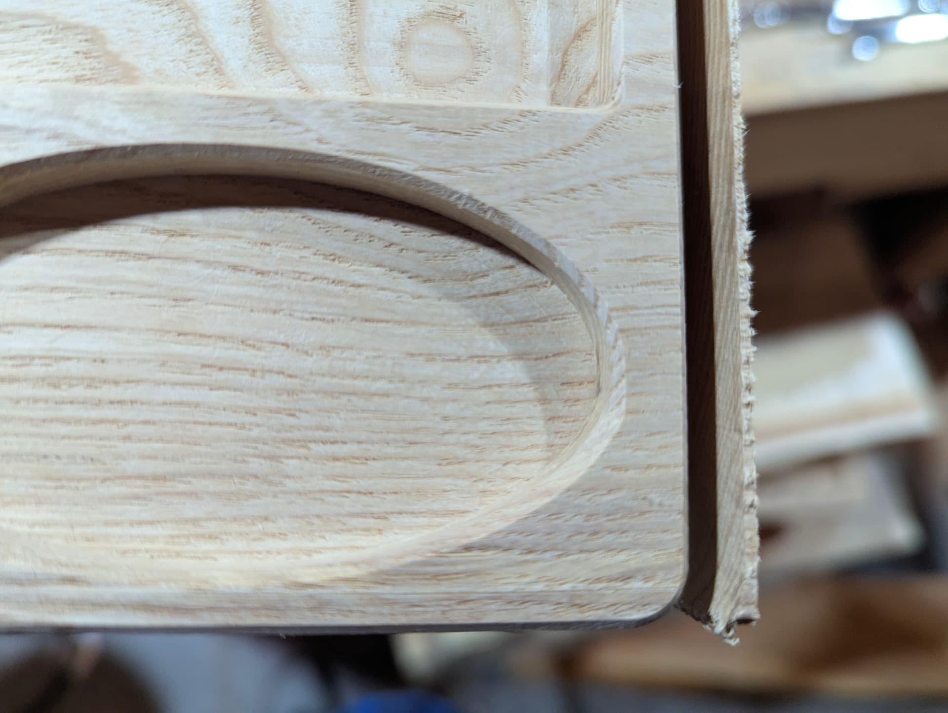

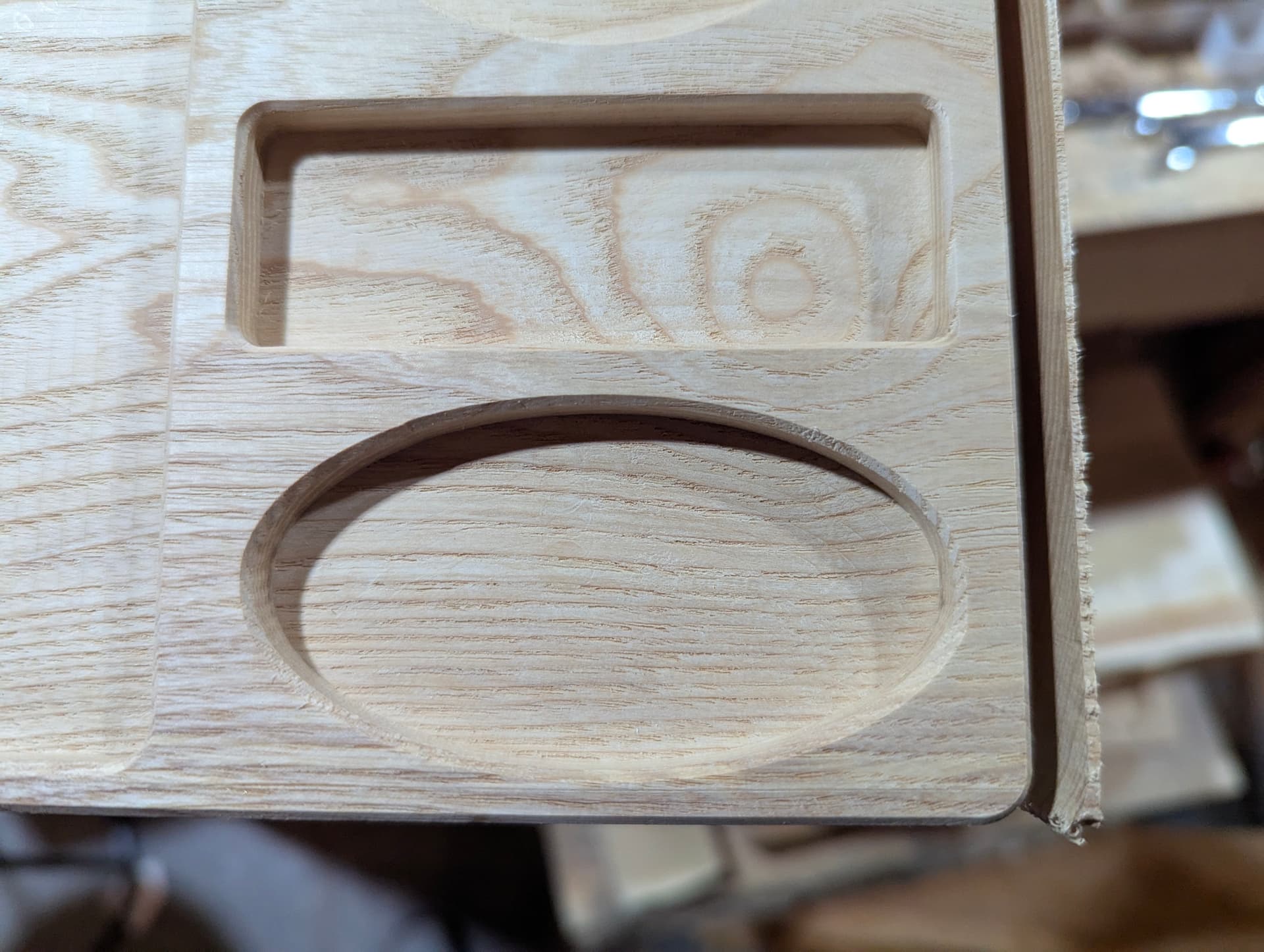

I have also just noticed some other strange tool path things that appear… Shifted during operation to the tune of some text that was pocketed and the very outer line having a slight dip or shift… Some small circular holes not being concentric…

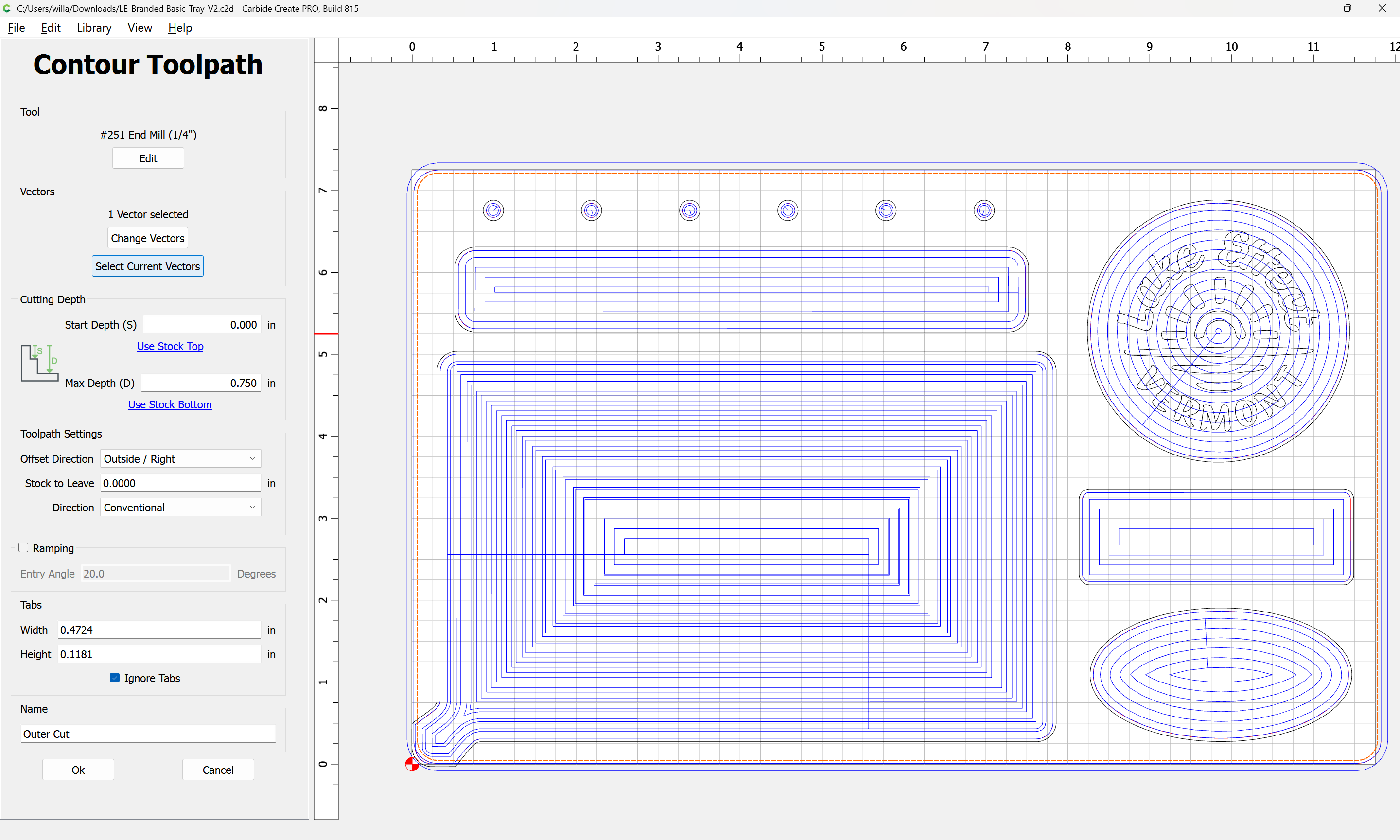

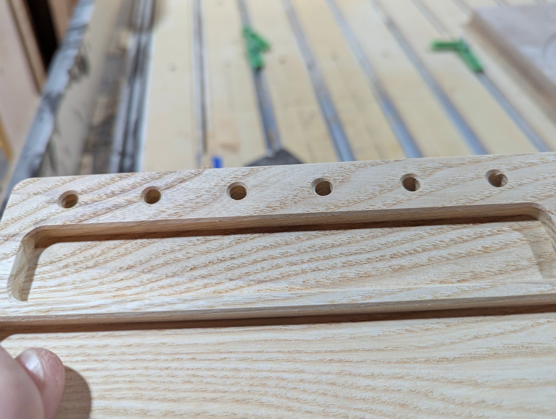

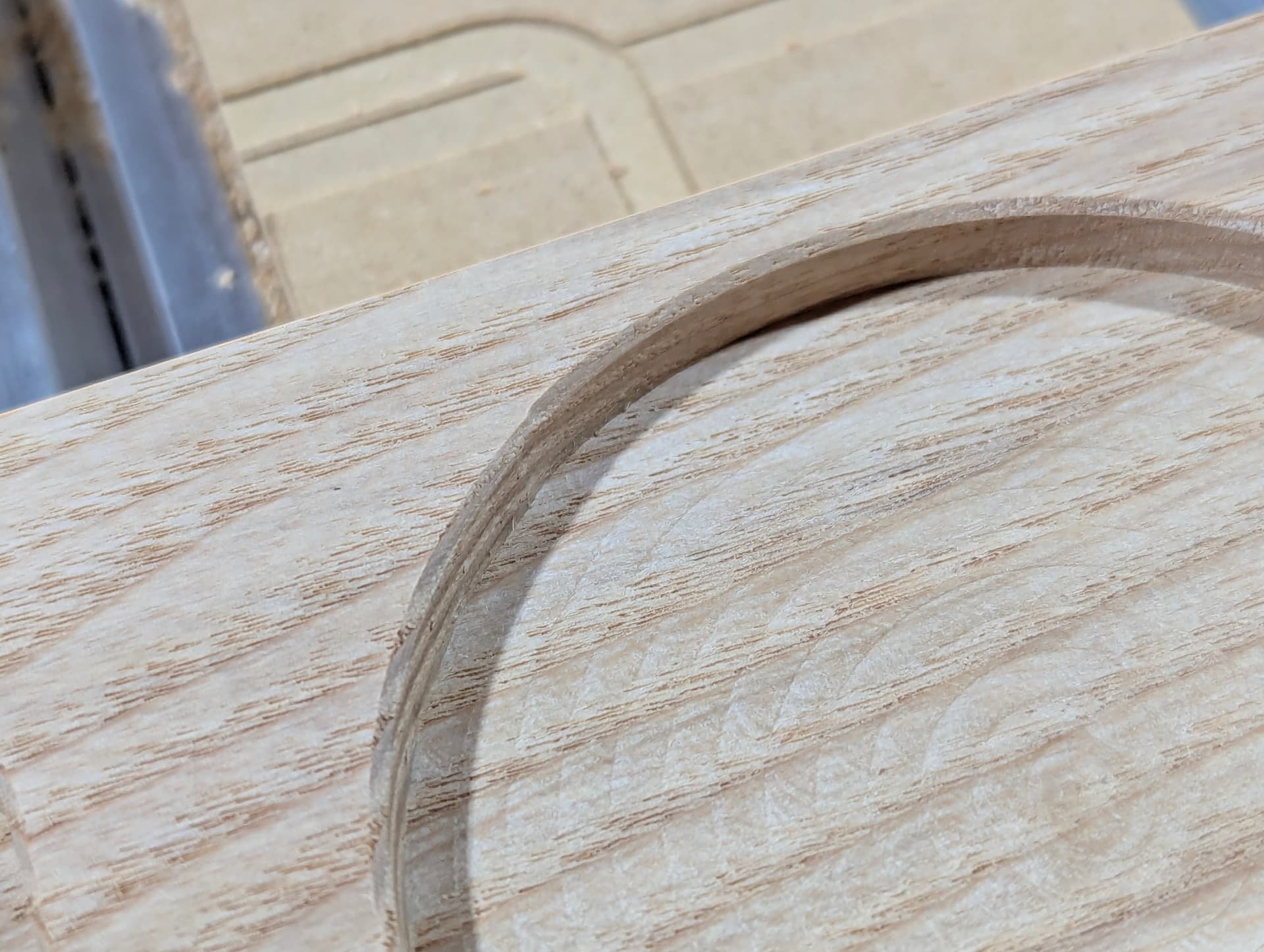

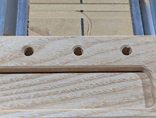

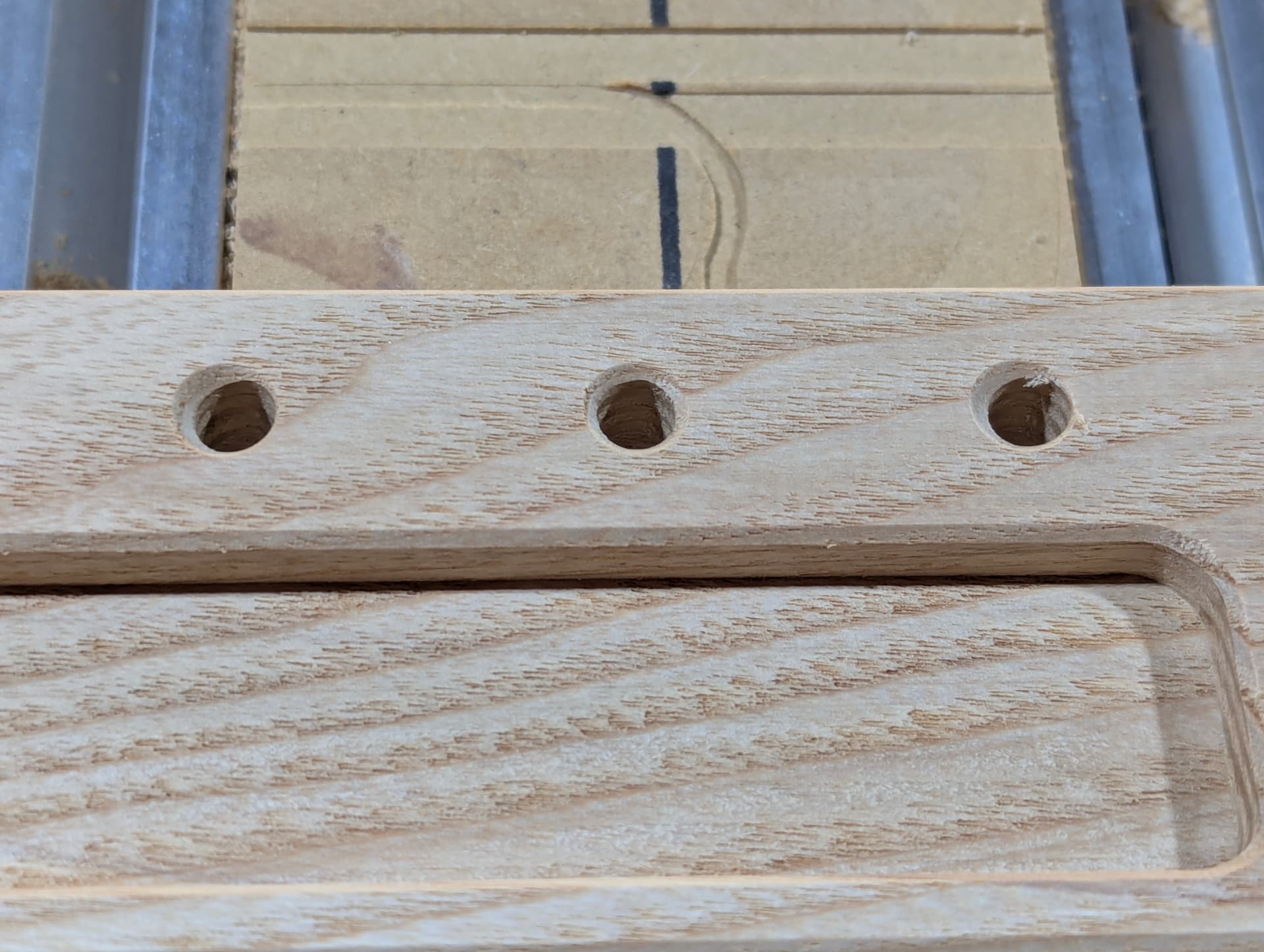

Here is a copy of the project file I worked with tonight. The camfers around the small holes at the top of the tray were done from left to right while the holes were drilled from right to left. Pictures will be attached next but 2 of the holes the chamfer is shifted to the left for some unknown reason. A couple of the other chamfers were not completely clean either. Look like they stepped partially deeper half way around the circular pocket.
You’re cutting a slot just as narrow as the tool to a depth three times greater than the diameter of the tool in this toolpath:
which is the definition of high tooling engagement.
For the chamfers on the holes, my inclination would be to use a drill operation — that will allow using more than just the tip of the V tool.
For the balance of them, I’d suggest doing them either by offsetting the geometry, or by cutting to a suitable depth with an offset toolpath.

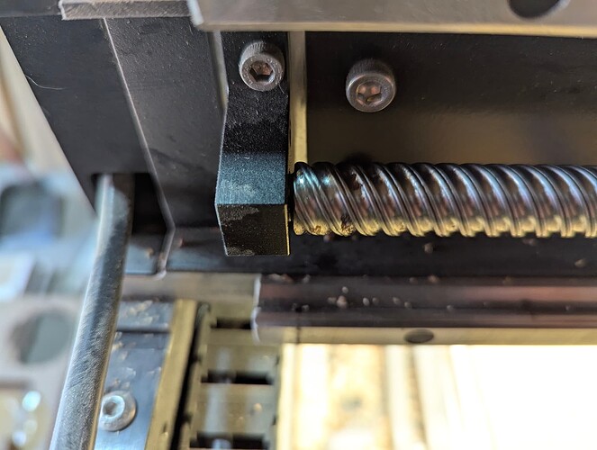

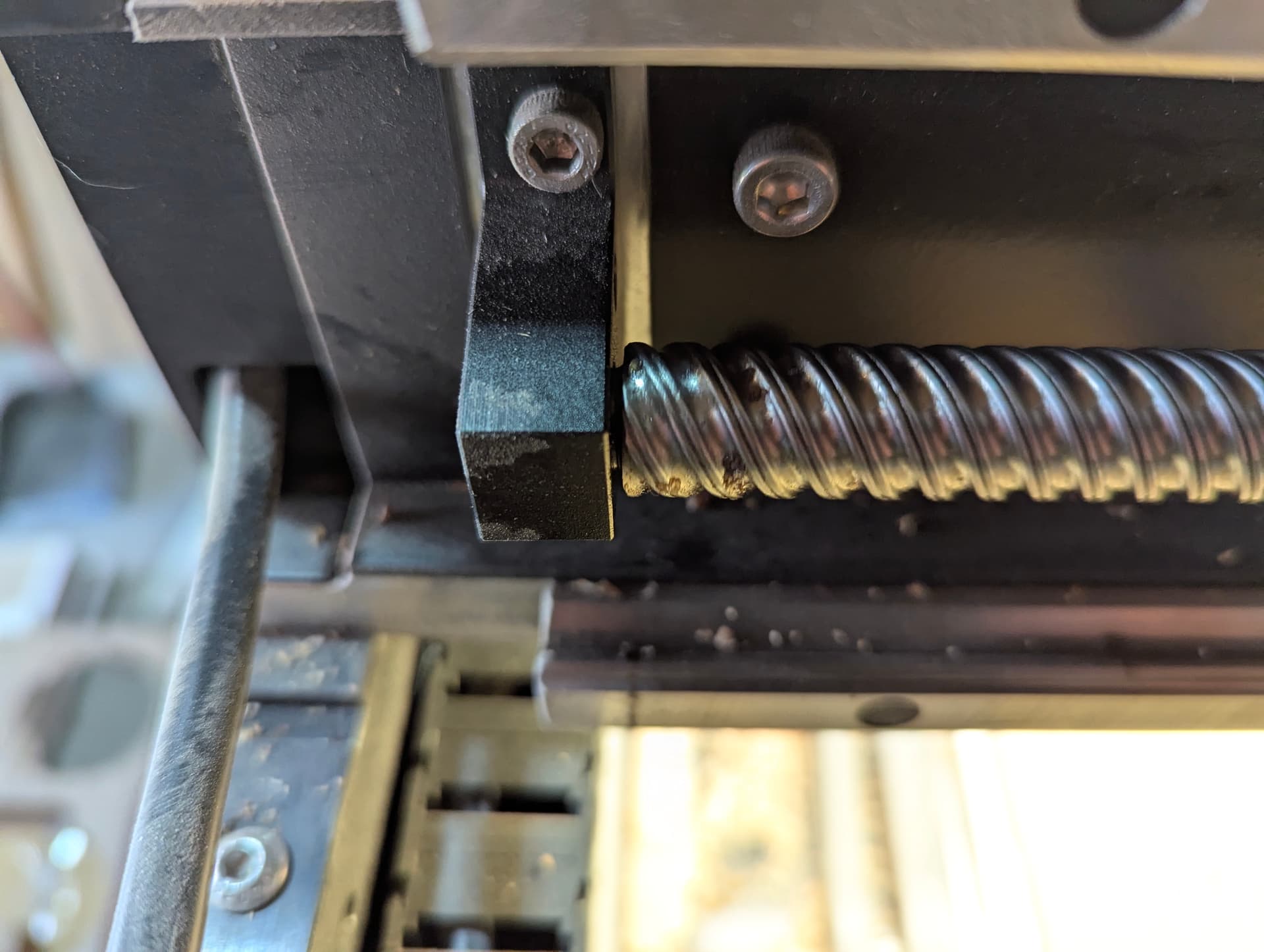

Making some adjustments now to see if it improves. I also just now noticed some lateral movement in the X ball screw rail that I had not noticed before at the end block that wouldn’t have expected to see and am wondering if this is the root of my issue?

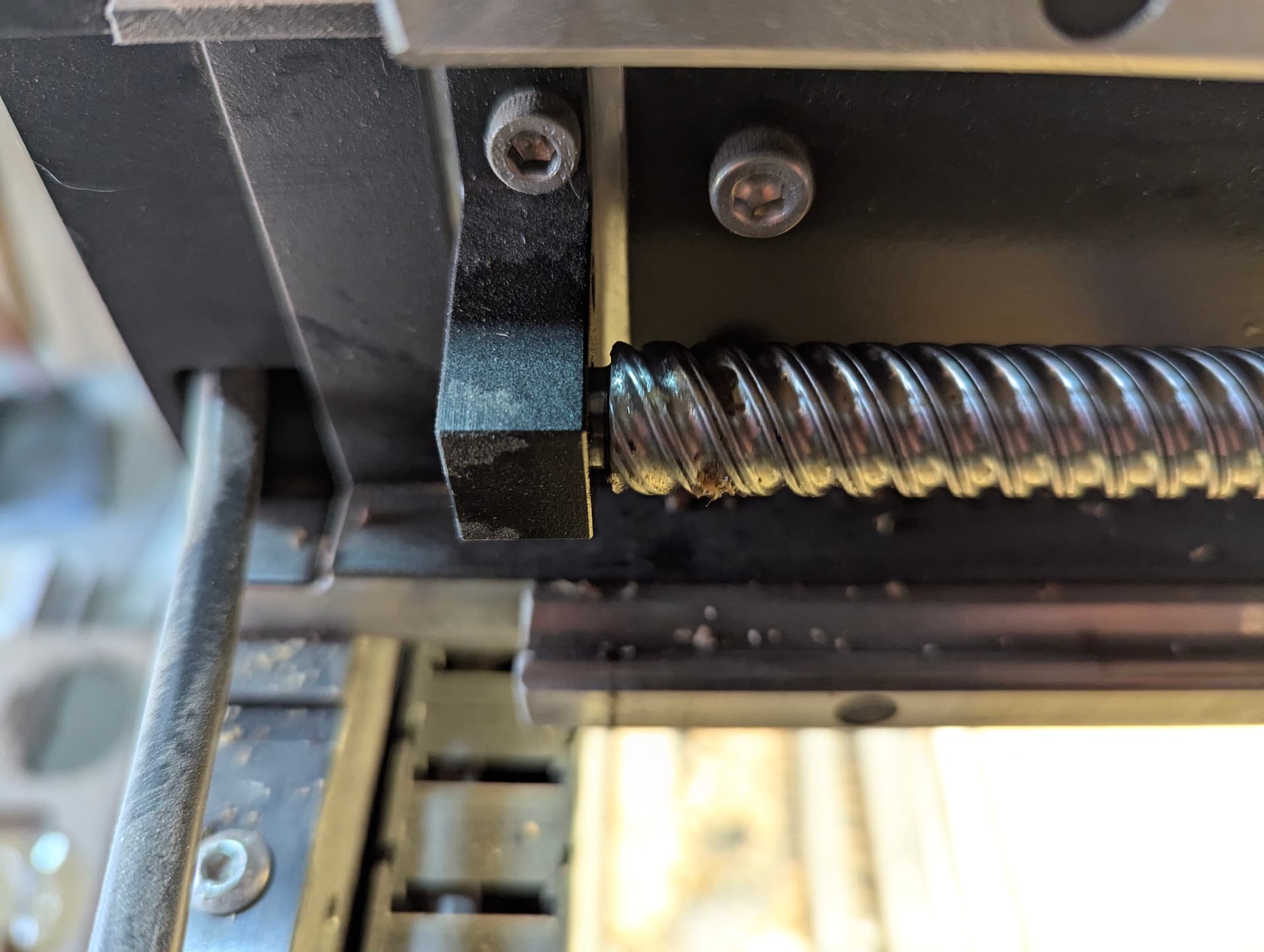

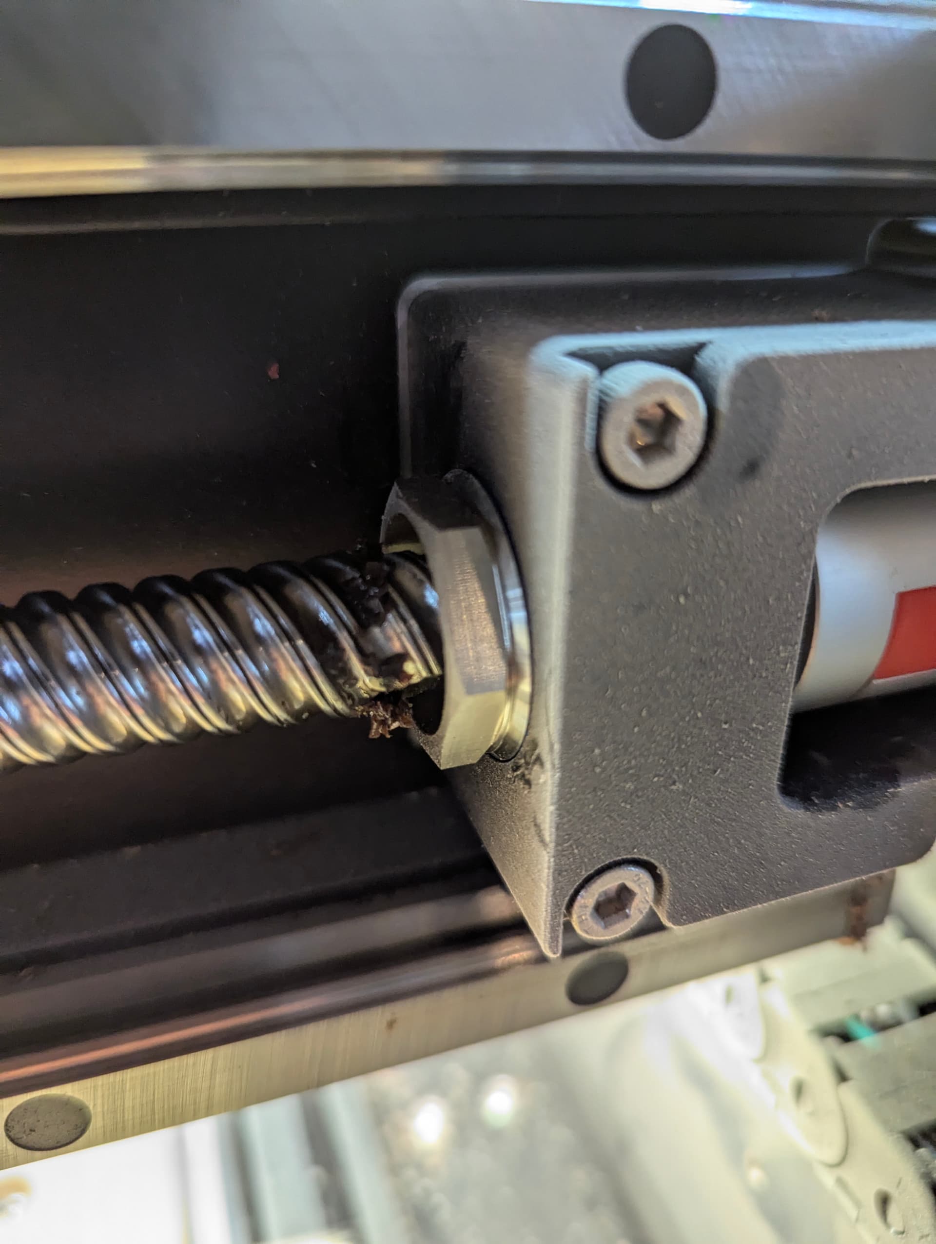

Looks to be in alignment with the discrepancy I have seen all along. I double checked the stepper motor mount and you can see movement where the ball screw rail meets the motor. The motor is not moving… the rail is. Is there a specific adjustment there that needs to be checked that won’t throw everything out of alignment?
Bah… This lock is finger tight…
Looking at all of the other locks on the machine I’m seeing blue thread lock… But unfortunately not on this one.
Is there a certain spec that this needs to be torqued to and is there a specific position that the motor end needs to be in? I’m guessing the nut on the other end has moved as well.

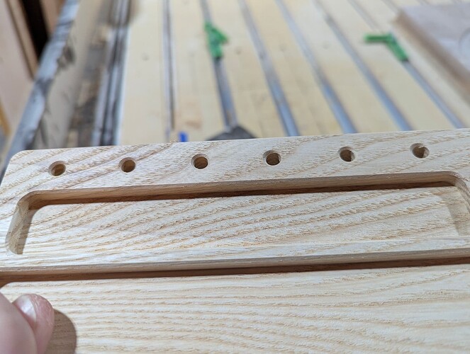

After snugging the lock down with some thread lock… The wandering appears to be gone. Amazing what you catch when you really watch what’s going on… Doh!
Thanks for sharing the diagnostic results for the rest of us. Added another item to the Maint checklist……
