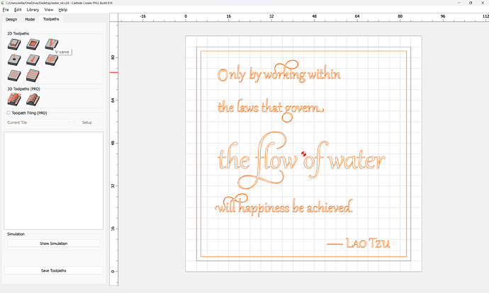

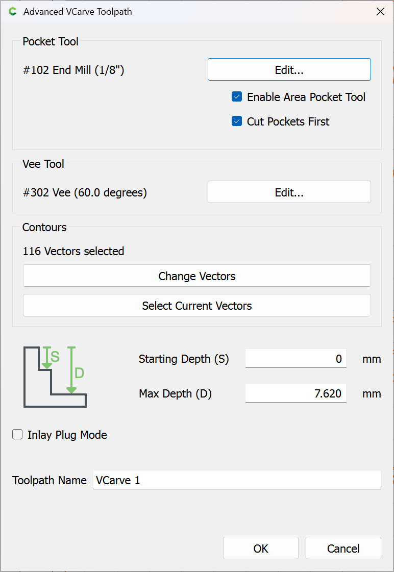

I am doing a project with an advanced v carve toolpath, I need to change my endmill to a different one than is the default bit. Just curious how to do this. Ive tried to research how to do it but I’ve got nothing to come up.

im trying to switch from a 1/8" bit to a 60-degree V bit.

The way this should work is:
  • set up the file in Carbide Create so that it uses two separate tools:
  • configure the BitSetter using the Setup Wizard:
ensuring that it is enabled:
  • set the zero relative to the stock as normal and run the file
  • when prompted, change the tool, allowing the machine to measure it, see:
If things don’t work, please post photos and screen grabs and we will do our best to look into this with you.
