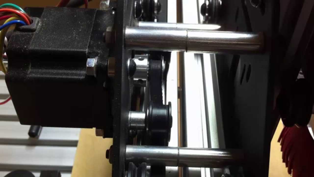

Just curious if there are any recommendations for cleaning/ oiling and just regular CNC upkeep for my Shapeoko.

The Delrin V-wheels can be cleaned at need with a cotton swab, and a microfiber cloth works well for the Aluminum V rails. The neoprene (rubber) belts may be cleaned with a suitable cleaning product if need be.
While for the SO2, this is still a good overview:
On v-wheels I use a stiff nylon brush while pushing things around to get 360 access. On the rails I use the 3M fine/extra fine finishing pads. They are the nonwoven pads. They are white and will not scratch your rails. Mineral spirits selp with stubborn stuck on crusties.

Keeping the rails and v-wheels clean has been my primary maintenance activity over the last year. Toothbrushes are great for cleaning caked-on sawdust from v-wheels. I’ve been considering designing a fixture to permanently hold a toothbrush against each v-wheel, but I haven’t made my peace with the jankiness factor.
