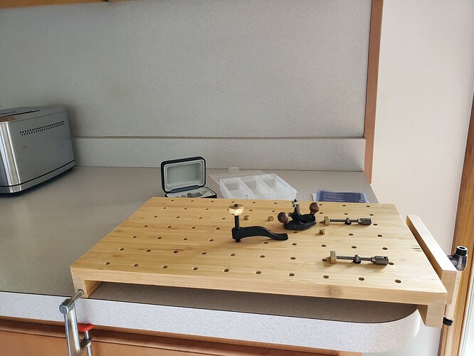

I will note that I use:
https://www.leevalley.com/en-us/shop/tools/hand-tools/miniature-tools/113767-veritas-miniature-surface-dogs
in:
Also shown in the photo are:
and for compleatness’ sake: Veritas Miniature Router Plane - Lee Valley Tools
(current project is fitting out an Apache 5800 case w/ that and an array of small tools for vacation)

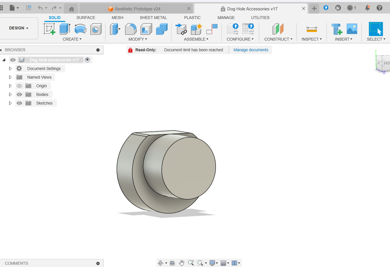

I made my own out of beech, but I’m sure it could be done from metal if desired. Here is the fusion 360 model:
As CNC projects go, it’s rather straightforward. The thing I found is that the accuracy of the diameter is very important. To achieve this, I programmed by toolpath to cut a small amount off the diameter, then pause (M1) so I could measure, and then if I chose to resume it would cut again. This method allowed me to sneak up on the right dimension, 0.05mm at a time. In the end, I found that a 20.00mm dog hole needed a 19.95mm diameter dog. If it’s 19.90mm, that’s too loose.

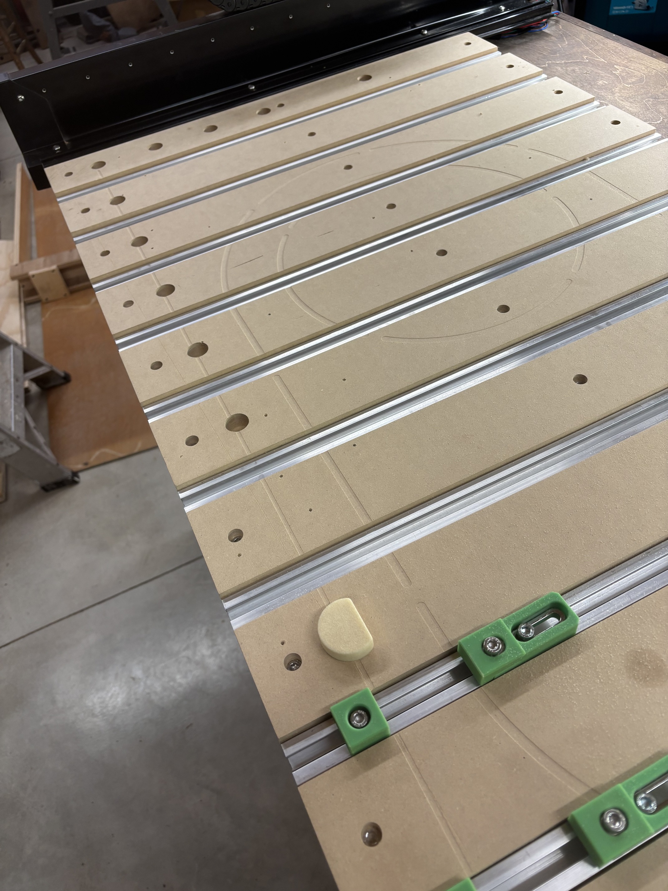

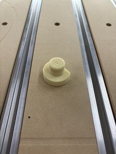

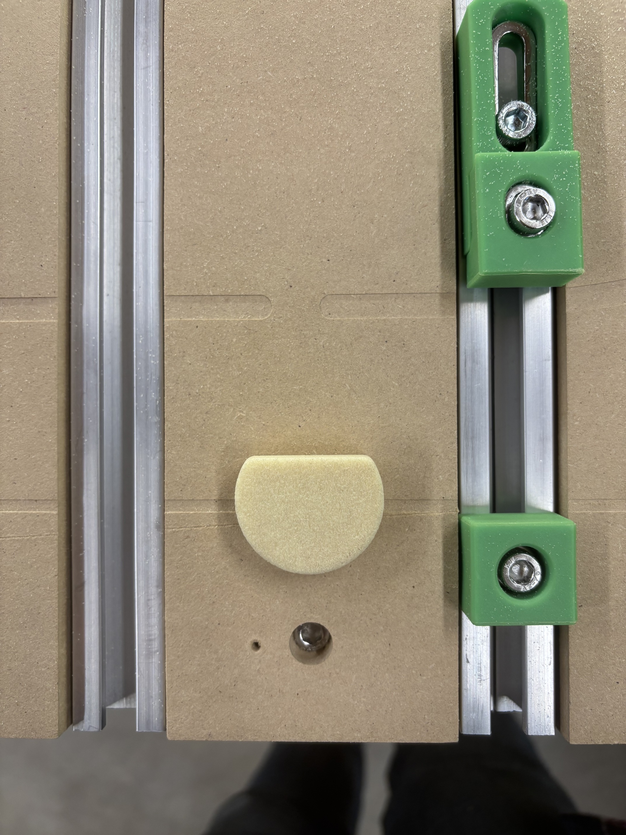

Well, I took my first go at dog holes and bench dogs with a LOT of inspiration from @robinhartleywillows
Scrap HDU is a great material to create prototypes.

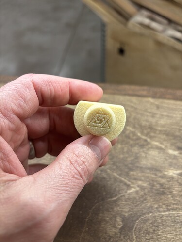

Also created a svg of our logo as which I’m carving on the bottom of the bench dogs… just because. Of course I can scale up and use it for different applications.
That HDU sure carves nicely, good detail there.
