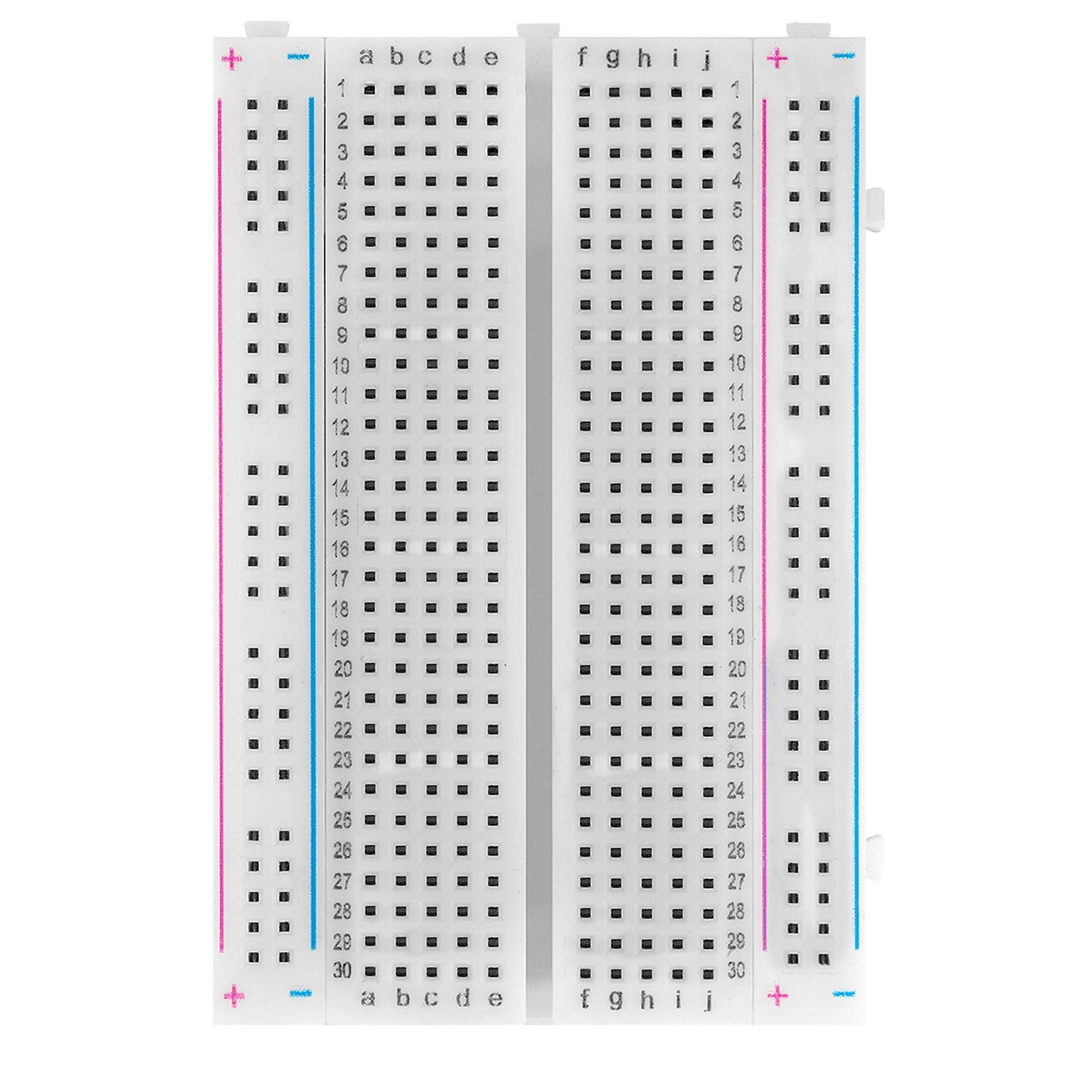

Do you have one of those:
It helps immensely to prototype your circuit before making the real project.

and no I don’t have this thing here, to make a prototype… what is it called?
Breadboard
