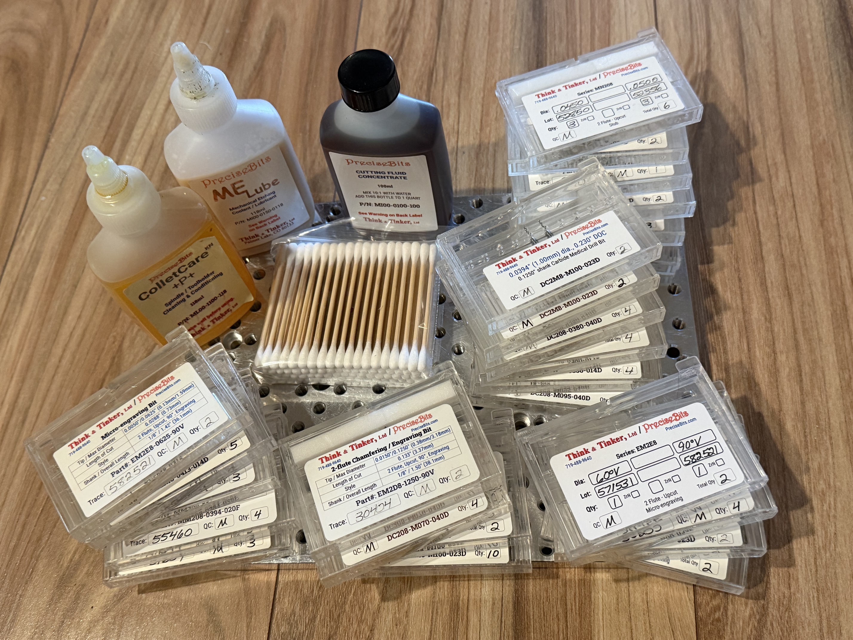

Everything I’ve used from precise bits has been top notch. I’m biased but only based on the years of experience I’ve got from using their products and the wealth of knowledge they share. (Appreciate you @TDA :beers:)
That said, I’ve only used their ER11 products so I can’t speak to their ER16 products from personal experience. I’ve got no reason to believe they wouldn’t be as good as the rest of their products though :man_shrugging:
And to prove that I’m not just a shill, here is a selection of tooling I could quickly photograph without much trouble. All purchased at retail, no kickbacks or special deals.
(Disclaimer: I did inquire about their awesome bamboo q-tips on my last order…so they threw in a pack of 100 q-tips free of charge. That’s the only handout I’ve gotten though :sweat_smile:)
Highly recommend them for anything you might need and feel free to shoot them an email if you aren’t sure about something. They’re usually pretty reasonable with response times.

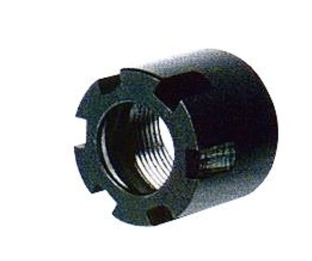

PreciseBits only carries the ER-16M (castle/slotted) nut, not the hexagonal nut. I don’t want to keep two different kinds of collet wrenches around, so I would have to transition completely over to this style and buy the special collet nut wrench.
I can understand that, I wonder if I ordered the wrong thing. Won’t be the first time. :slight_smile: I will have to see when it gets here.
ER 16 Mini Nut 22mm 18mm M19 x 1.0 18 ft/lbs. (24 N-m)
That will probably look like this:
