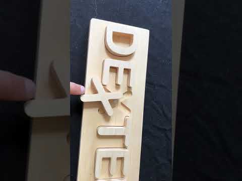

Ok so I’ve been thinking about these for some time now, never got around to it till now. Also this is my first contest entry so tips on format are welcome too!
Children’s name puzzles with embeded magnets. My thought was that these not only double as letters for the fridge but the magnetic snap adds tactile reinforcement/encouragement when the letter is guessed correctly.
So the first one I made only had magnets in the letters and not in the recessed plaque. This was because I though it would be harder to clean the plaque if little found it’s way into the recessed letters. So instead I used tiny pin nails for the magnets to cling to. This worked well but I decided to go with magnets on letters and plaque for the next two names. Plus babies/toddlers aren’t really in environments with tiny pieces of ferromagnetic debris flying around. The reason the other two aren’t painted is because I’m waiting on final paint selection from my sister in law.
The magnets are Ø8mm x 2.75mm neodymium rare earth that I’ve had kicking around for some time now(I’m a bit of a magnet collector). After a quick test with my 8 month old nephew they seamed to be just the right strength to hold the letters in place but not too hard that he had to struggle to pull them out.
Since I made three of them I learned something with each one. Archer - I learned double magnets were a better option. Dexter - down cut bit worked really well but the use of 3/4" material meant there was a ton of sawdust getting packed into the perimeter cutouts. Greer - I used a compression bit this cut things closer to the planned dimension. So the 1mm offset from letters to recess was perfect for the down cut but it was a little too loose for the compression. All the letters are the same size so they can be interchanges between all the names, this also means I had to check, double and triple check I was putting all the magnets the right way into the letters and the matching way into the two recessed plaques.
The names are a big hit with the kids and parents, i just have to keep them some what clean until I can paint and seal them. Here is a quick video of the snapping action of the magnets.
