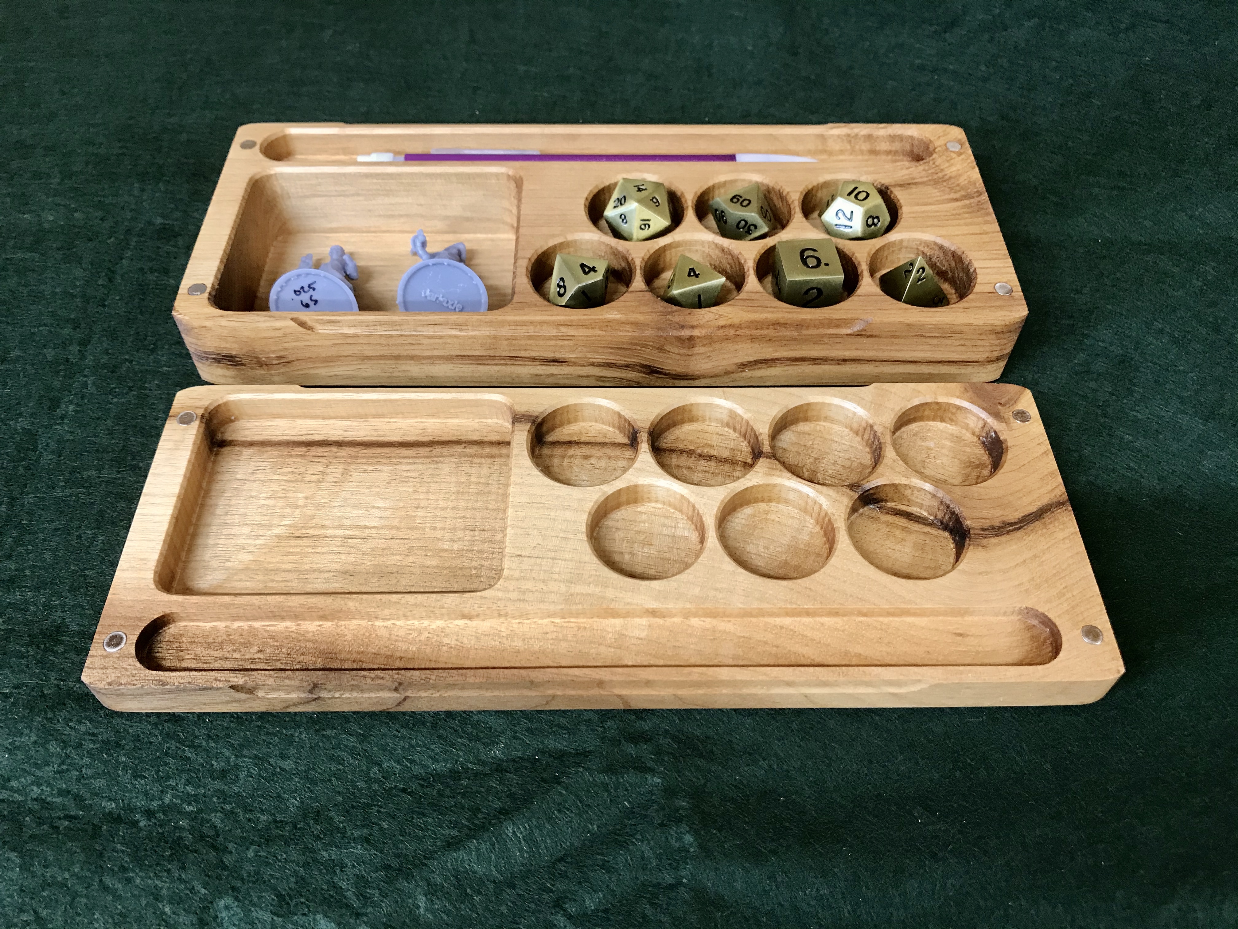

Nothing like a last minute submission! A friend and I have been working on ideas for DnD dice vaults. We came up with the basic layout and have several ideas for the lid in the works. Since I saw this contest, it seemed like a good idea to test out textures on the lid using my XXL. I chose some Myrtle that I had lying around for the first batch. Here are some pics of the semi-finished product. The only thing it’s missing is some foam in the pockets.
I designed it using VCarve Pro and its V carve and texturing toolpaths. The bottom is pretty basic pocket and profile toolpaths. I used a 1/4" ballnose to do the fluting down the side.
For the lid, I first did a V carve of the logo, leaving it 1/16" proud of the pocket. I hogged out the waste using a 1/8" compression endmill, then used a 30 degree Vbit for the actual V carve. The 30 degree toolpath took the longest at about 1.5 hours.
The texturing was done using a 1/4" ballnose. I just played with V carve’s toolpath preview until I had something I liked. I did have to create an offset of 1/8" to keep the ballnose from scalloping the border and the DnD logo. I’m pretty happy that the final product came out every bit as good as the preview. However, I’d really like to create a texture that looks more like dragon/snake scales for future ideas.
I’m not quite sure what file format we’re allowed to submit for the project, but I’ll attach the full .CRV file (VCarve proprietary, I think) for both the top and bottom. If anybody has any suggestions for these dice vaults or just wants the Gcode files, I’d love to hear from them. Good luck everybody, the submissions so far are killing it!

P.S. ooh, I forgot one thing. The chamfer around the edge and pockets was actually done at the router table.

That is a very nice box, very clean and well designed and the logo on top is very stylish. The texture looks great on there! I see you used 4 magnets. I recently bought some for the same purpose. Does the lid stay centered with just the magnets holding it?
Jeremy, I’m curious what you do to keep your magnets properly oriented? I’ve built a “master” fixture and a plan, but am still curious.
Nice project!
yes, it stays centered very well. When cleaning it up for finish, I installed the magnets first, then clamped the top and bottom together to be sanded so that they were perfectly flush on all sides. Now, when I take the lid off and put it back on, there might be a hairline misalignment that’s not big enough to see but you can just feel.
Oriented so two don’t oppose each other? These magnets came (or ended up) in a stack. When epoxying them in, I just press one in and “wipe” it off the stack. I do the same to the other three holes, keeping the stack oriented the same way. When I set the stack down to press the magnets in place, I make sure it’s still oriented the same way. Then, when I go to do the other side, I flip the stack and do the same “wipe” method. I haven’t had an issue yet. Alternatively, you could mark the same pole on each magnet with a sharpie. You don’t have to know whether the pole is North or South, just that they’re all the same. I hope this is what you were looking for!
