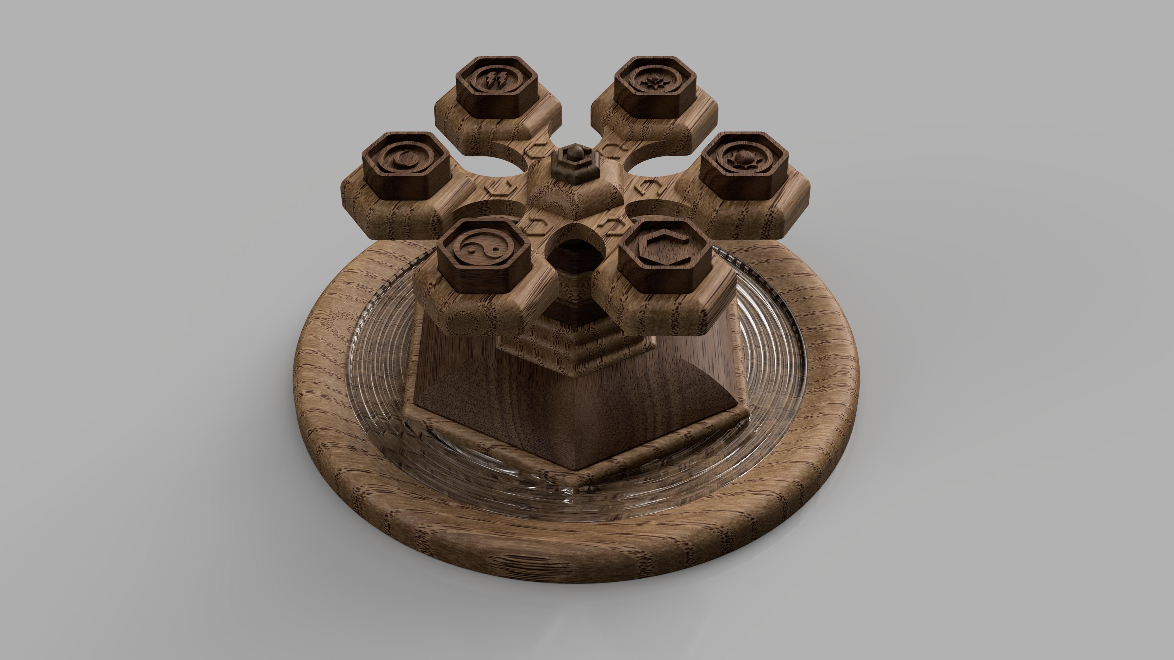

So I was not very enthused about my first submission, the MDF platter, it is very nice but not exciting by any means. I was having nostalgic thoughts of my past level design, the hexagon hospital I built for Malice, and became inspired. Last Monday night I started editing, and have been working almost non stop ever since.
I decided to mix my materials using Red Oak and Black Walnut for contrast. Rob gave me some great advice about Walnut oil, and I very much prefer it to Stain, my new most favorite thing hah thanks Rob, it leaves the Oak a very light bright color which worked well for my design plus the smell is not bad, non toxic, dries in hours!
I originally wanted to do a ripple wave insert on the base among with some clear material to mimic water and possibly some led lighting, but the area was too small to have any impressive effect, and Stu knocked his out of the park so I gave up on that. I had thoughts of making some type of ocean wave scene but I spent hours modeling waves and they all looked like crap so I gave up on that also…

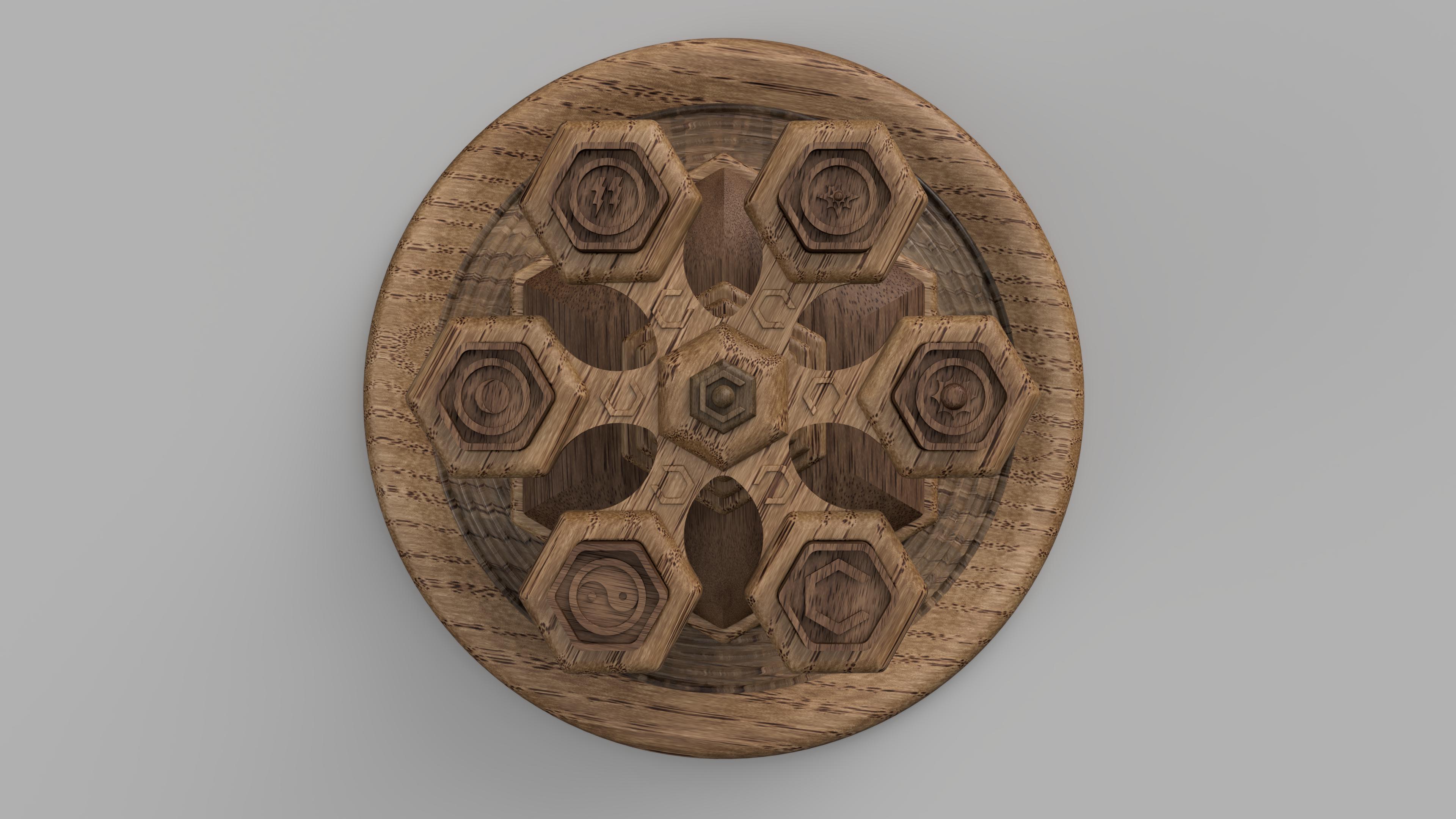

At that point I just started designing random things that I can spam as a texture on surfaces, ended up with somewhat of a theme, but I could see possibilities for hundreds of other samples, crude models of almost anything sized down to fit in mass. Was getting fun after a while and I framed the samples in Hexagon cubes, then started making corresponding plates that fit in the base to expand on the concept of the samples. I picked out 7 of my favorite designs for production.
I took the opportunity to give myself a lesson on micro milling, designing things down to the point where you have a hard time seeing them, and got to the point where a 1mm end mill was too big for my needs. I do have a few packs of the PCM mills but did not try them out due to time constraints.
I had a few fails trying to mill down to .01 thickness and gave up on it but did have a moderate success with a very small but accurate to scale representation of Ursa Major and Ursa Minor.
Definitely learned my lesson trying to use my table router on some .1 inch thick plates, I managed to dodge half of one as it shot across the room. 4 hours wasted!
So I am barely keeping my eyes open and have about 15 hours of machine time to go before I am finished and roughly 16 hours till deadline haha… Suck it up buttercup! I will update as I finish the rest of the base plates
Out of all the textures I think I like this one the most, when you have a perfect pattern it is like a old 45 record, the grooves just feel nice to the touch. -“Default Texture” it’s really hard to make! (it’s all in the toolpaths!) -lol
So I guess the secret to a curly mustache is Walnut oil, who knew? Check out the 1mm curl, I was afraid I would break it with a paint brush when I was applying oil,

So after about 50 hours of machine time I fell asleep at my desk and did not finish these last 6 plates till the next morning after the deadline. However here they are, just don’t consider them when voting lol. My 1mm did not cut the second holes on the ying yangs properly which is strange since it worked fine on the hex sample piece, I will fix with a drill press later.
