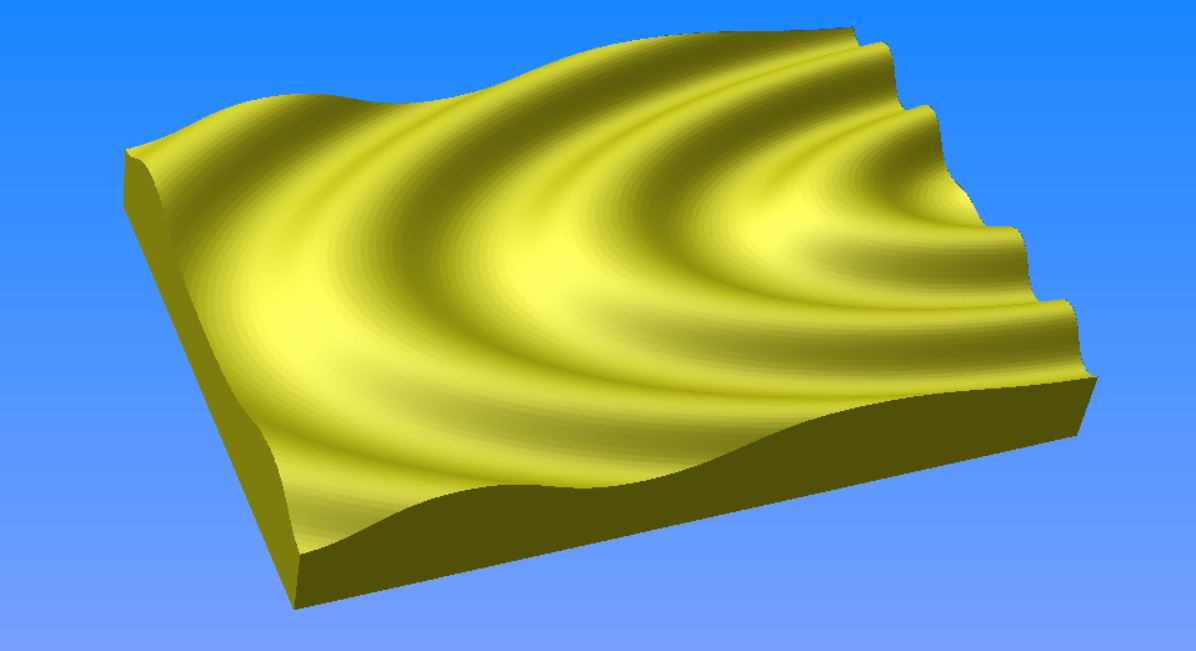

Here’s my second entry - somehow managed to get some time in between planning a wedding and moving house!
I wanted to play around with Vectric’s ‘Project Toolpath onto 3D Model’ a bit more.
Files are here - Dropbox link - I’ve included Logo SVG, ripple model that will work in any Vectric Software, and my Aspire 9.0 file :slight_smile:
First off I created a ‘ripple’ using the techniques Here (youtube)
I started with a circular ripple, then stretched it horizontally so it would fit the way I wanted it.
Then I traced the Carbide3D logo, did a rectangular pattern of the vectors and trimmed it to create a bit of a border
Next up were toolpaths, in my last 3D project I used a 3D roughing Toolpath first and didn’t feel it was required, so I went straight to the 3D finish toolpath with a 1/4" Ballnose endmill. My Machine is limited to 4800mm/min at the moment so I went with that, with a 0.025" stepover and no step down restrictions. - this was cut at 10° to horizontal to avoid fuzzies in the pine I used.
Then onto the Pocket toolpath for the Texture, this was a simple pocket toolpath, 0.5mm deep but I ticked the ‘Project Toolpath onto 3D Model’ box so instead of machining flat it took the pocket 0.5mm deep from the surface of the model. this was a 0.5mm tapered Ballnose, taking full DOC at 2500mm/min, with a 0.15mm stepover, again at 10° to horizontal - in a raster toolpath
Thats it for software, now onto machining it!

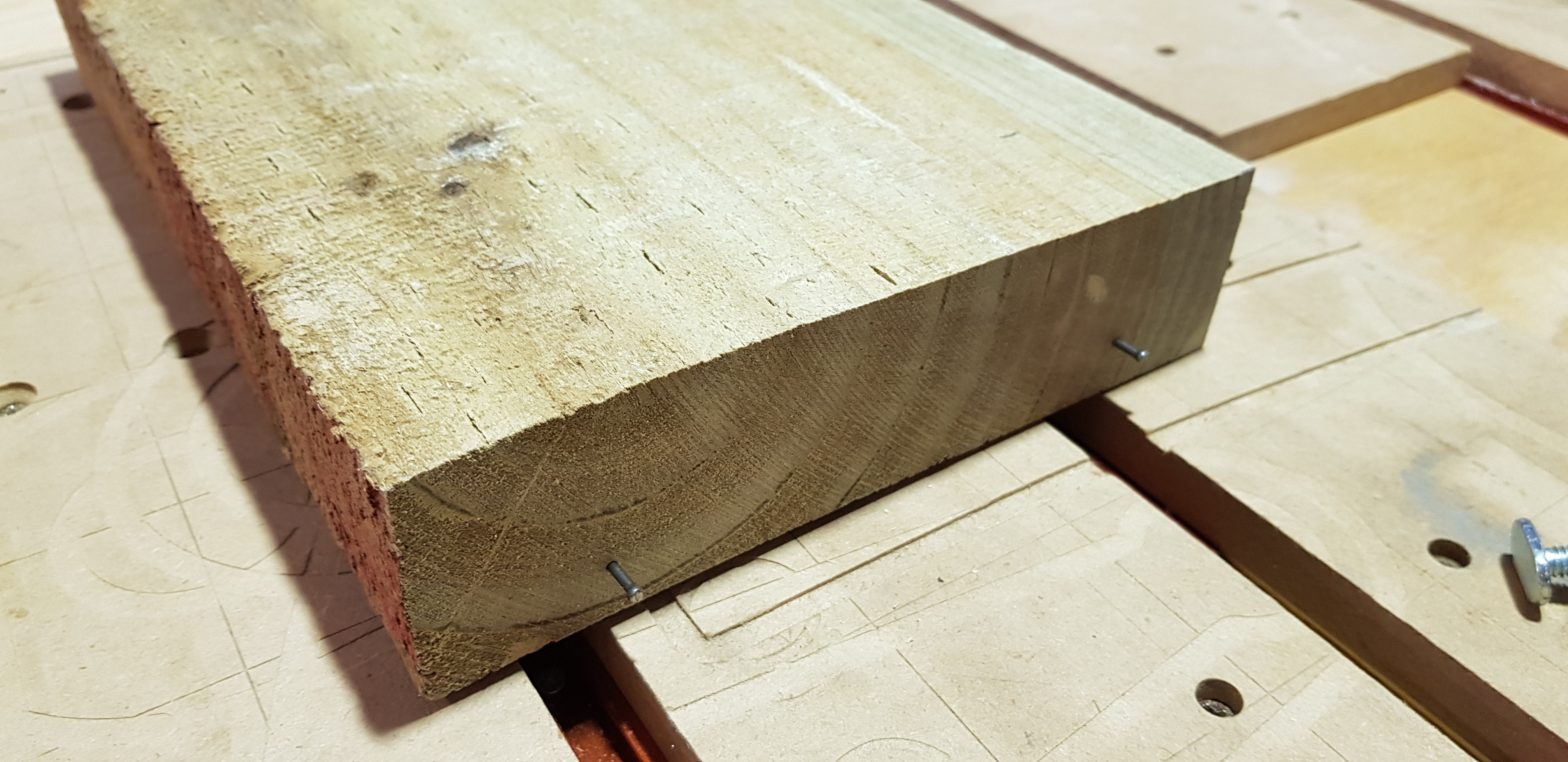

As the effect I wanted was for the whole piece to be machined, I put some nails in the ends of the pine and used my clamps to hold it down that way. It worked OK, but I should have used bigger nails, and more of them.
First off was the 3D finish toolpath, this worked really well, the only issue being that I overestimated the flute length of my Ballnose endmill, and was right on the edge of cutting past the flutes. Turned out ok in the end, but one to be wary of next time! Cut time was about 40mins for this one
Then the pocket/logo toolpath, this is where I realised I had made an epic mistake in setting the zero on top of the material… obviously no top of the material left… it’s a bit hard to explain, but I basically moved the 1/4" ballnose bit to the wasteboard and zeroed it with paper, taking note of the absolute offset. then I changed to the 0.5mm bit, zeroed on the wasteboard, then moved up to the measurement I had taken before changing the bit. it worked!
The toolpath worked well, I did have a blackout in the middle of the cut, but I resumed from roughly the same spot. This toolpath took about 4 hours.

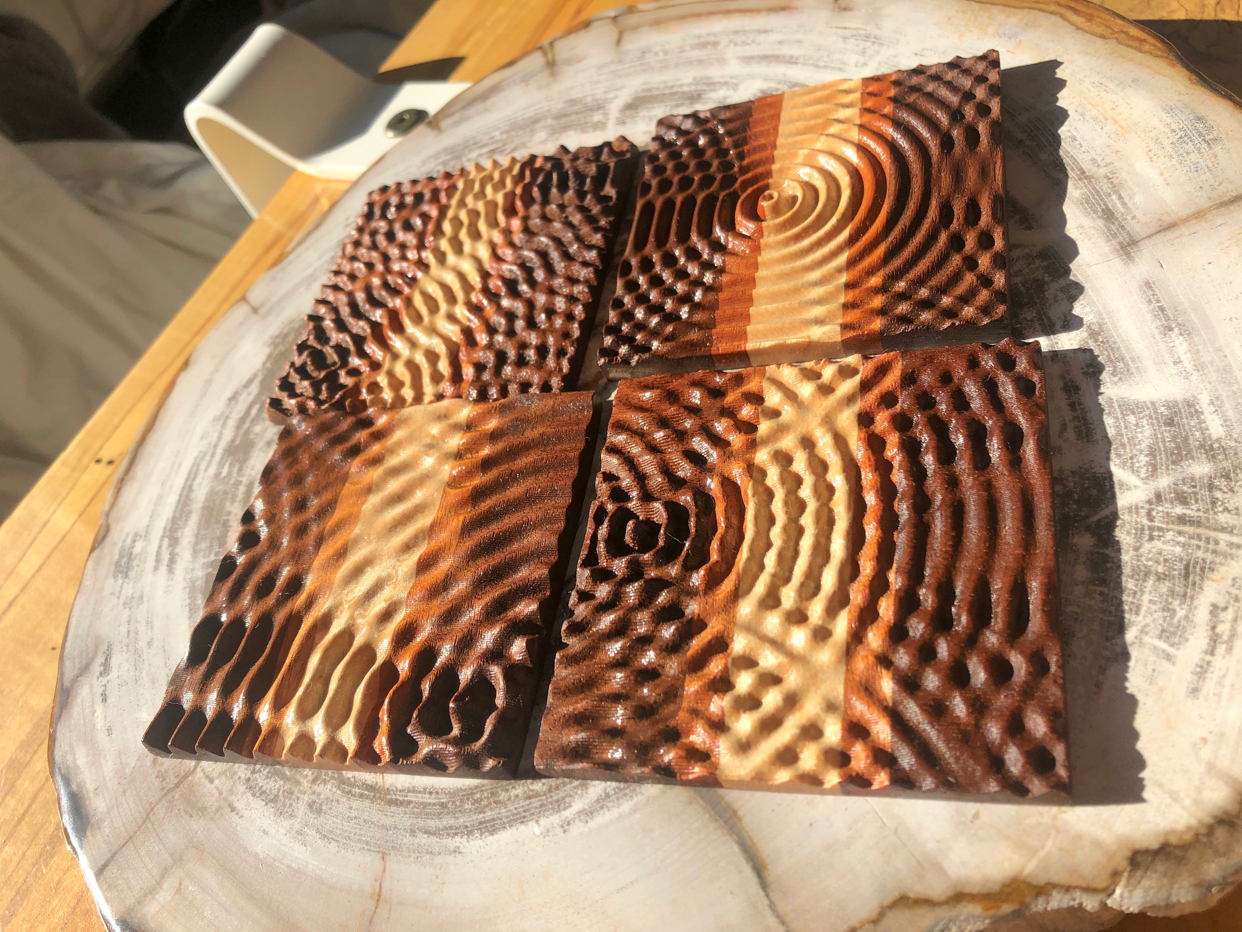

I had some leftover stock from my first coaster making project on my S3 and I been wanting to mill frozen fluid dynamics into some wood now for a while.
Finished Product:
Using a Ripple Tank Generator online Here I modeled 4 different styles of single and multipoint waves contained inside box, then I froze the simulation at different points. Next, I exported these as 2D grayscale images and converted to an STL with the desired height of my stock.
I imported the STLs directly into Fusion360 then reduced the polygon counts and made compatible with my stock size.
Next, I created toolpaths for a 1/8" ballnose adaptive clear, a 1/32nd parallel finishing pass, and a 2D contour, runtime was about 2.5hrs per 2qty coasters.
Repeated for my 2 other waveforms that’s how I got to my finished product. In hindsight, I should have modeled 4 points interacting within the Ripple Tank simulation then cut a single a STL in larger stock so that when the coasters are next to each-other they look like a SINGLE simulation cut into 1/4s (oh well, next time!).
