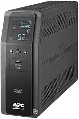

Also I am using this in my setup, not sure how much that matters:
