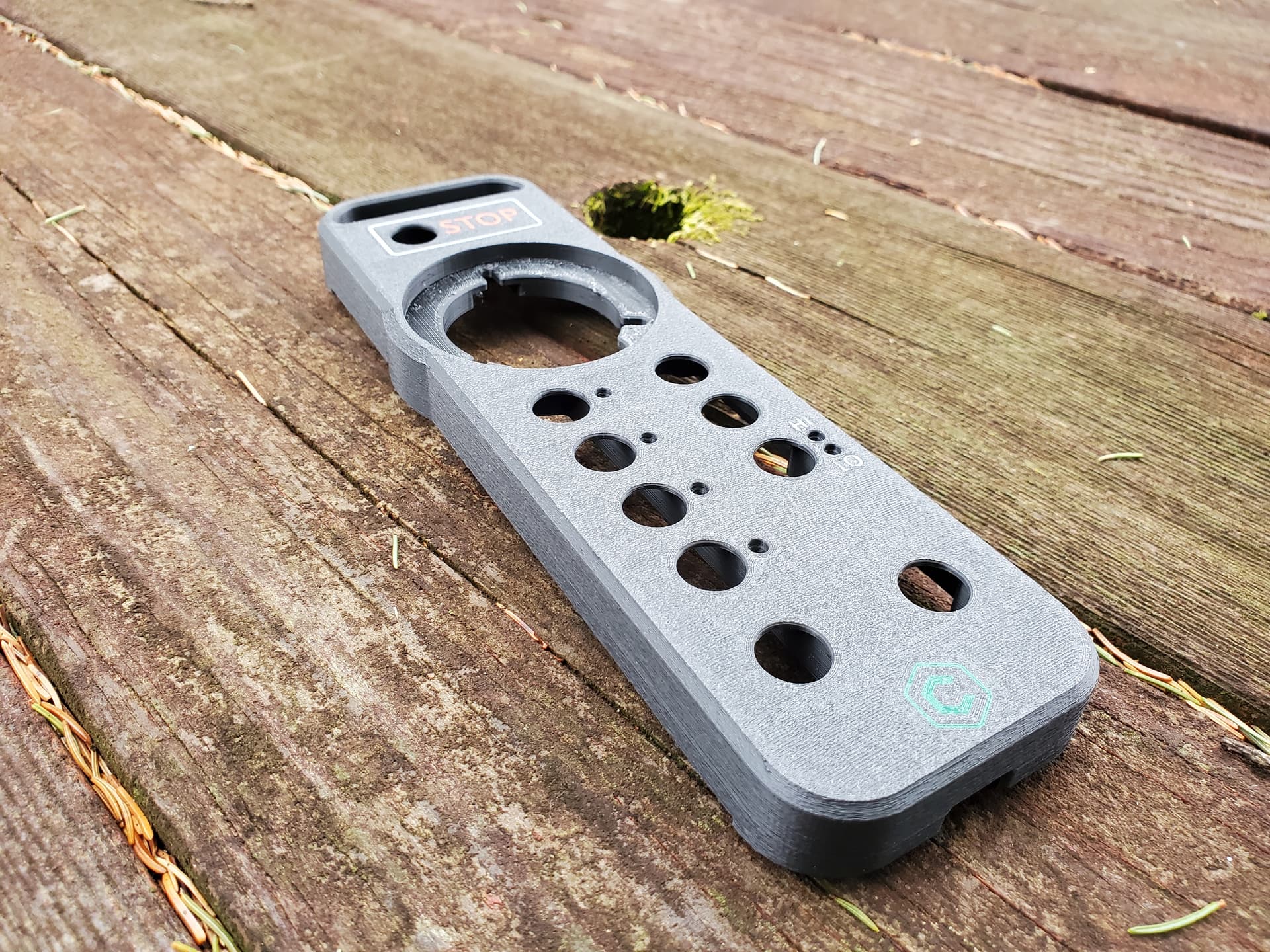

EDIT: Since then, I have switched to the official Carbide 3D Jog Pendant:
(with a few modifications 'cause I can never leave well-enough alone)

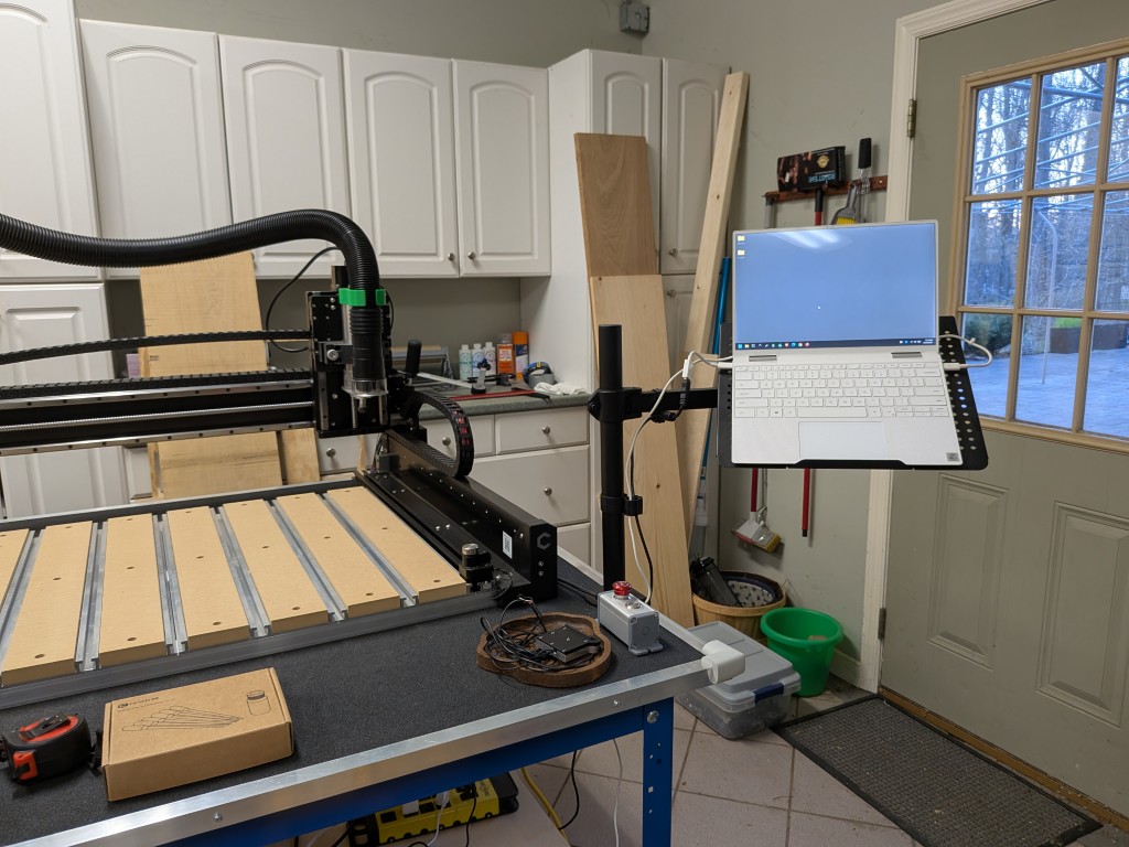

I have a 13" Dell laptop that I wasn’t really using anymore, so it now sits out in my workshop (OK, garage) permanently connected to my Shapeoko 5 Pro.
I picked up an inexpensive laptop stand that clamps to the side of my Kreg worktable and it keeps things relatively tidy and out of the way. Pic attached below.
I only really use the laptop to run Carbide Motion and drive the CNC machine, but in theory I could make quick changes to a project if I needed to.

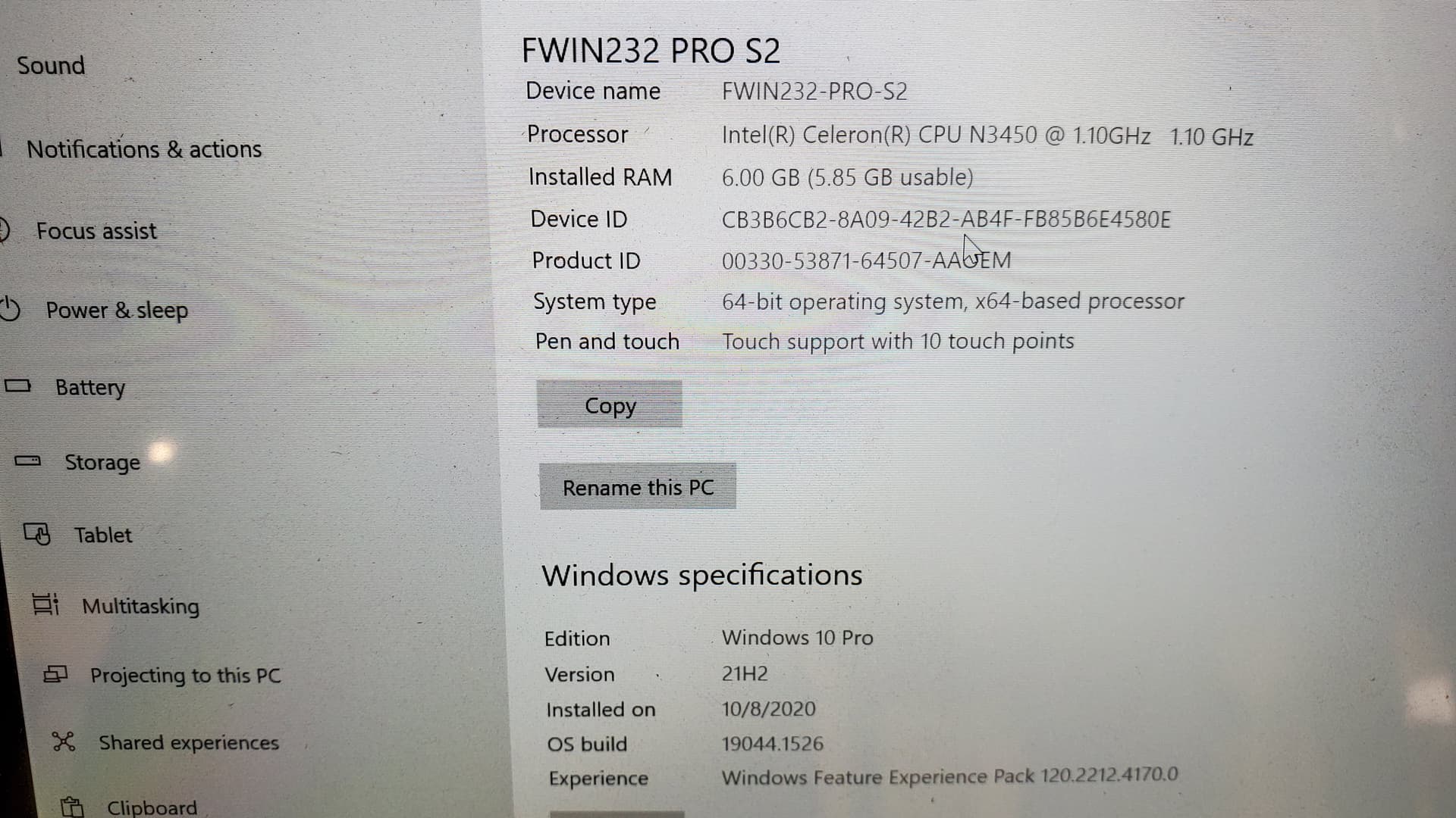

Thank you! how much space/memory do you find yourself using on the tablet? Enough to where the decision between 128 GB and 256 GB is important?
@mrrwashington Aside from the browser, I run CM, CC, and Lightburn on that tablet. I’ve never had a memory issue (that I can remember :slight_smile: ).
These are the specs for my tablet (I’ve upgraded Windows several times since this photo). It’s just a 6GB RAM machine…very simple. Your storage needs depend on your usage patterns, how much you take advantage of Dropbox (or equivalent), USB Drives, etc.
[EDIT] FYI: My set up includes a small USB hub (powered), which attaches the Tablet to the keyboard, mouse, Shapeoko, USB Sticks, and anything else I need.

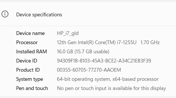

I have an HP I7 16gb ram with 2Tb solid state drive. I specifically got a non touch screen. Don’t like to touch my screen. Have wireless mouse and keyboard. Windows 11.

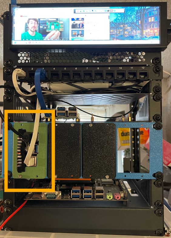

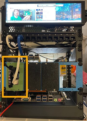

I’m running a little fanless pc hooked to the 5 pro with wireless keyboard and mouse, and a LCD monitor I had sitting on a shelf. cheap and gets the job done, but I wouldn’t want to do design work and stuff on it although I have done a few small edits.
I’m running this:
from
16GB
With the official heat sink and PSU.
I added a USB fan bowing from the back side to help my SSD on heat.
I find a N100 sufficient on a the current software.
I’ll be doing a write up on it down the road.
In the Rack its power by Power over Ethernet.
I’m making a positive airflow system around it.
I chose this to run my Shapeoko 5 as this company seems to have a long term plan to provide them or some versions of it.
