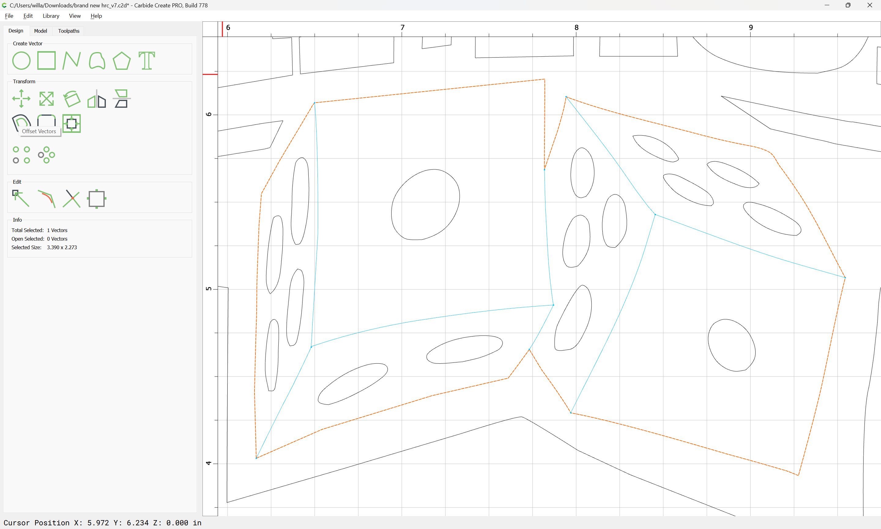

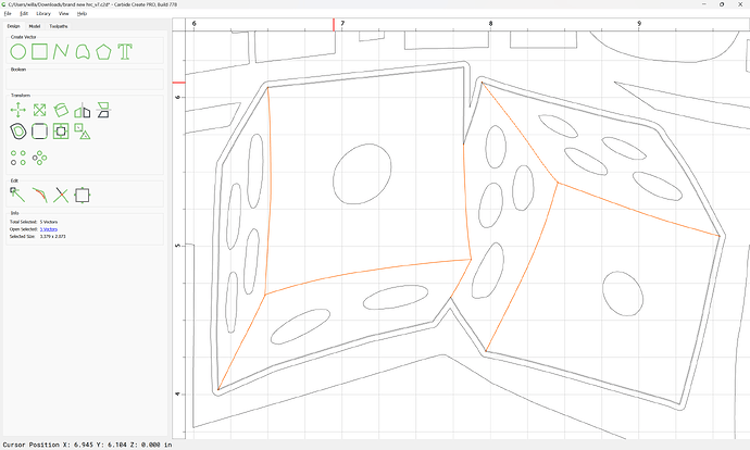

Connecting 3 or more vectors

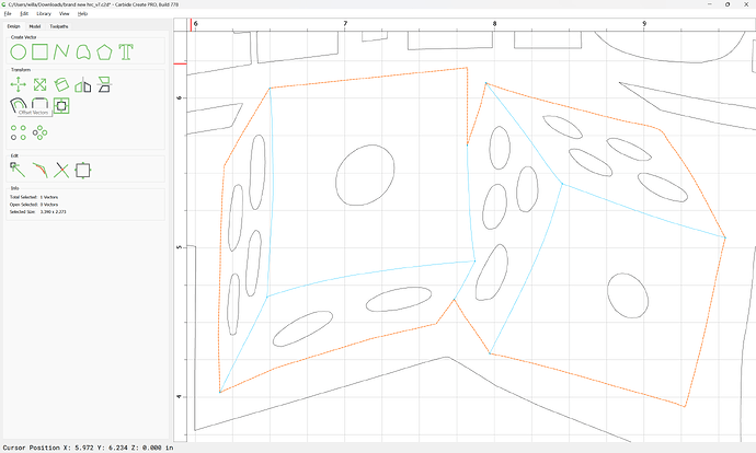

Note that this is a classic example of the “Figure–ground reversal” problem.
Please see:

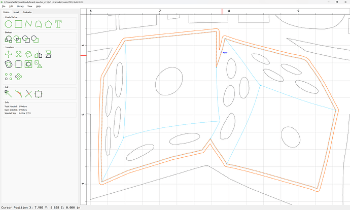

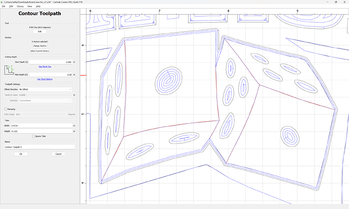

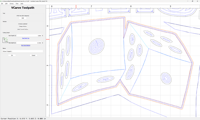

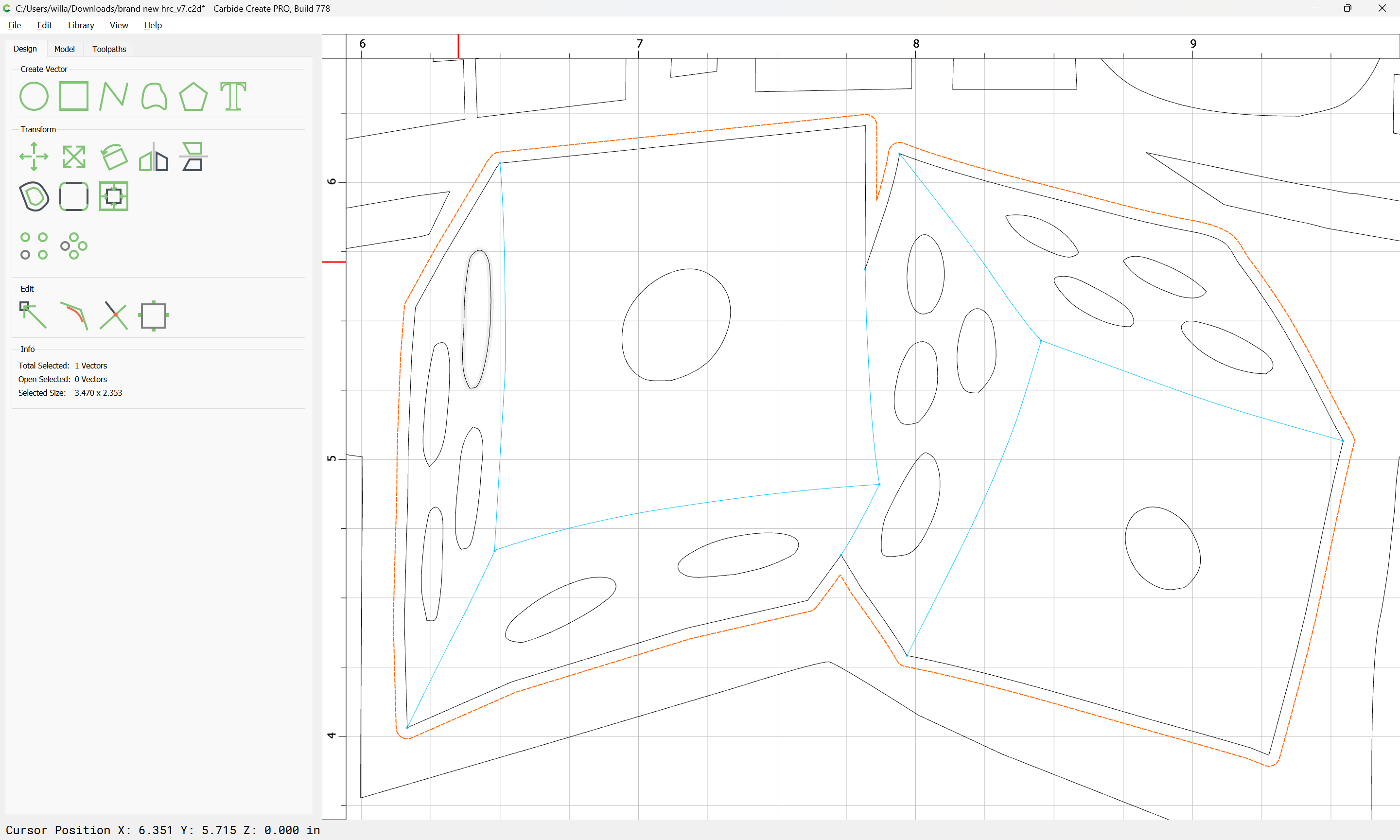

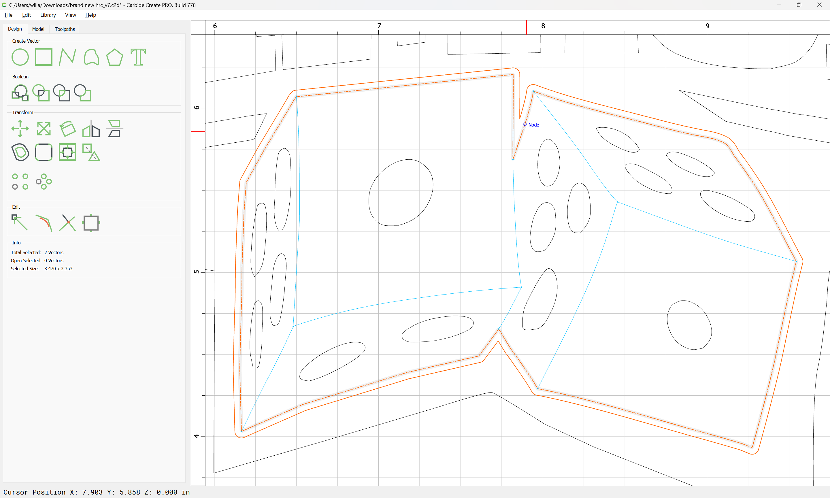

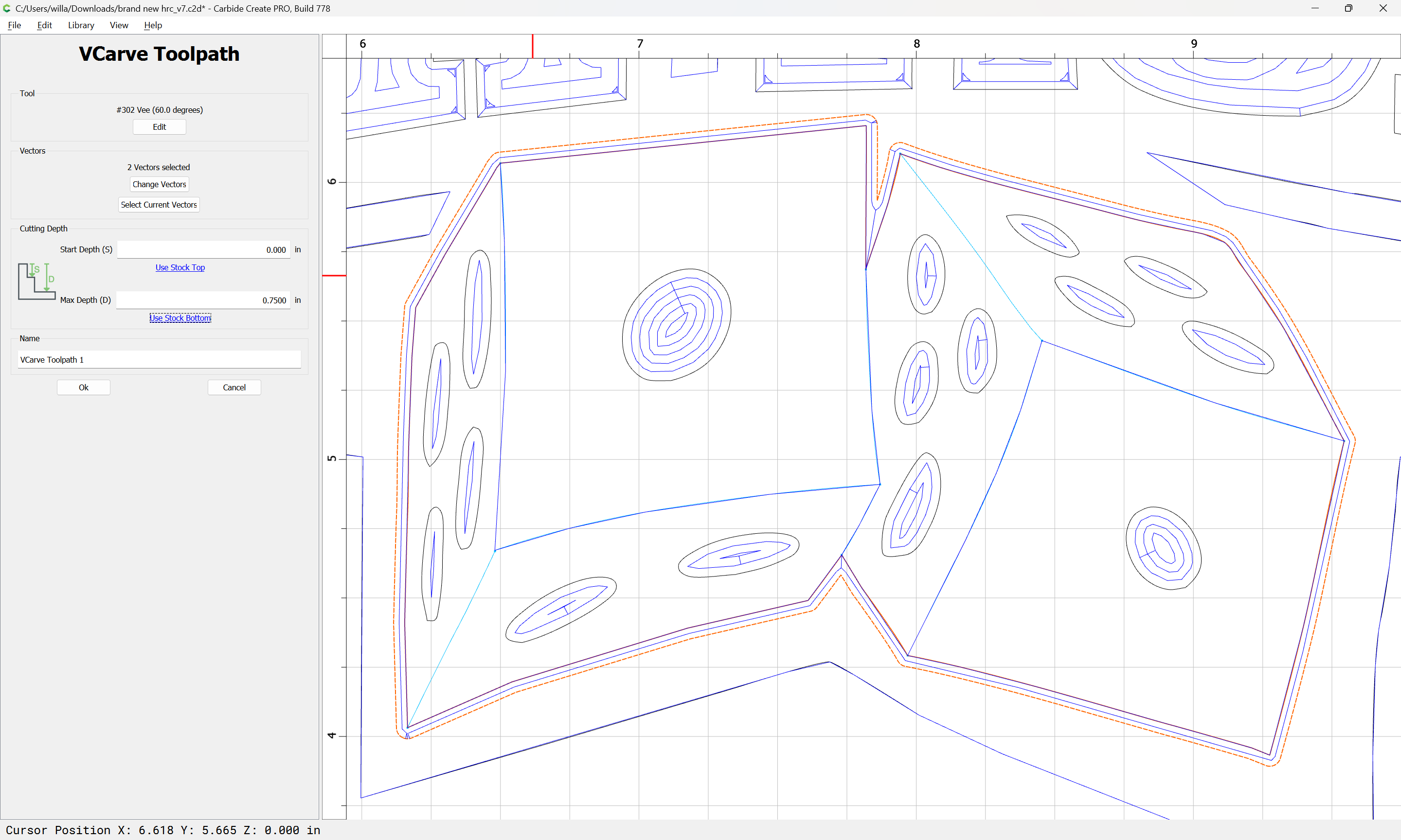

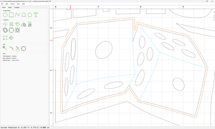

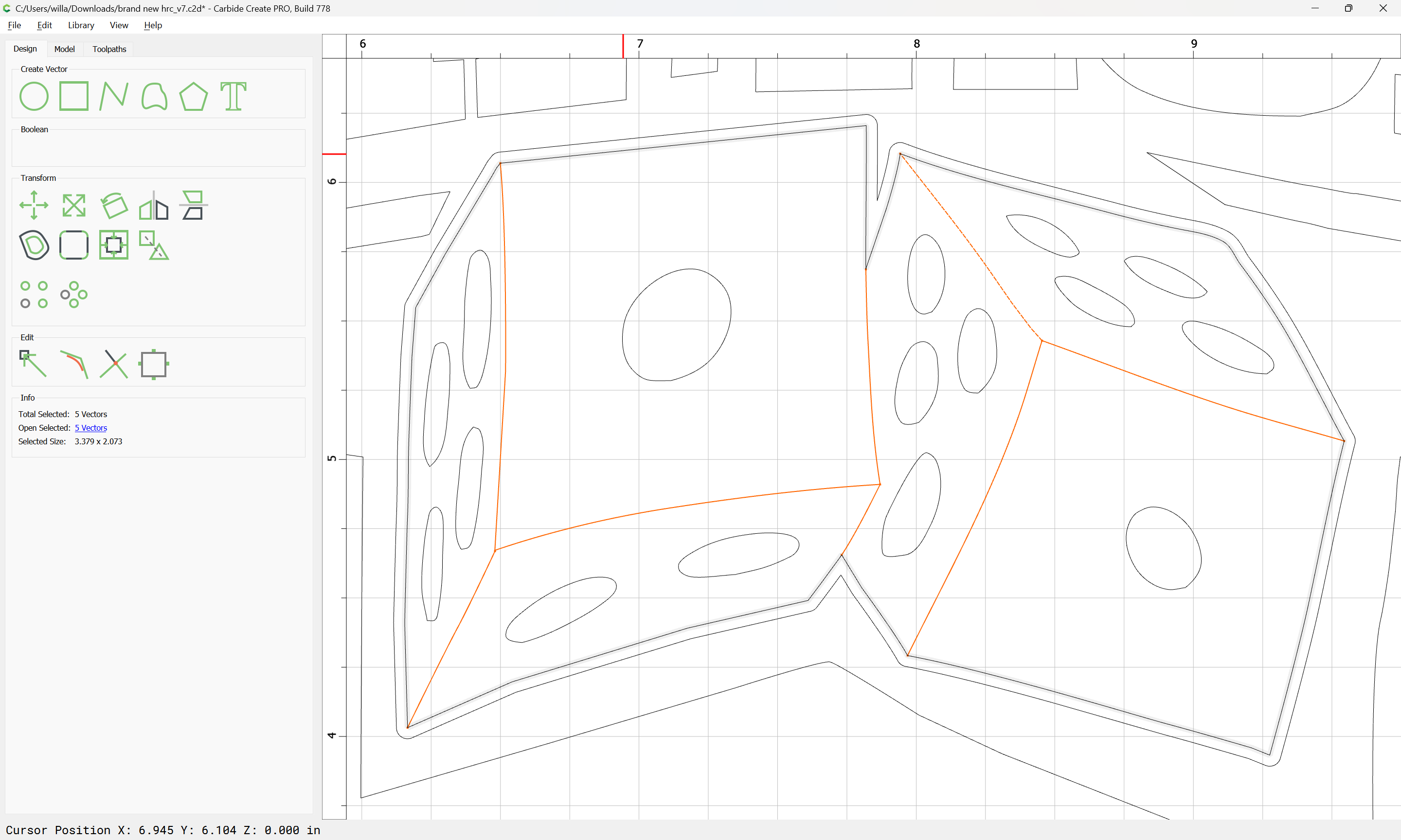

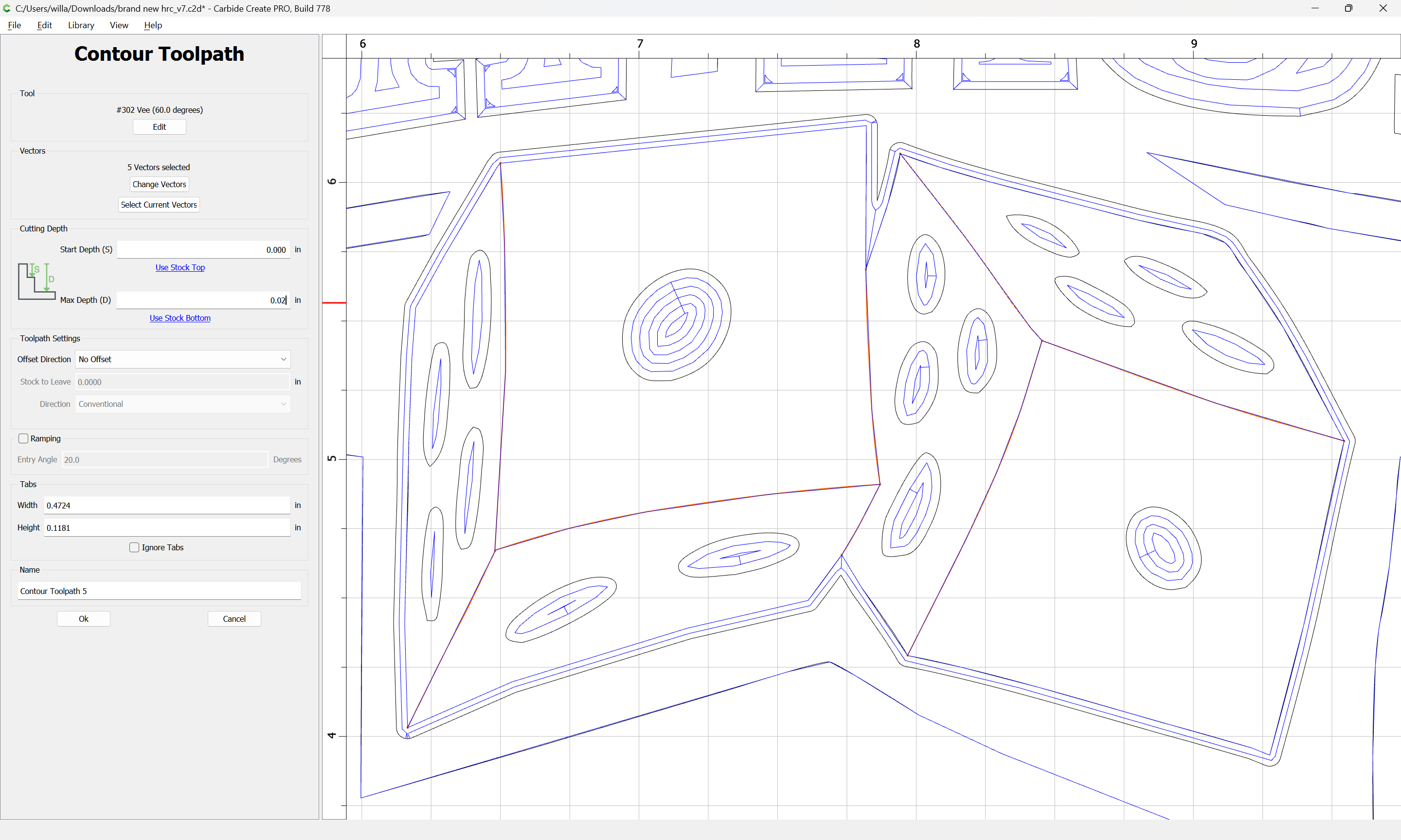

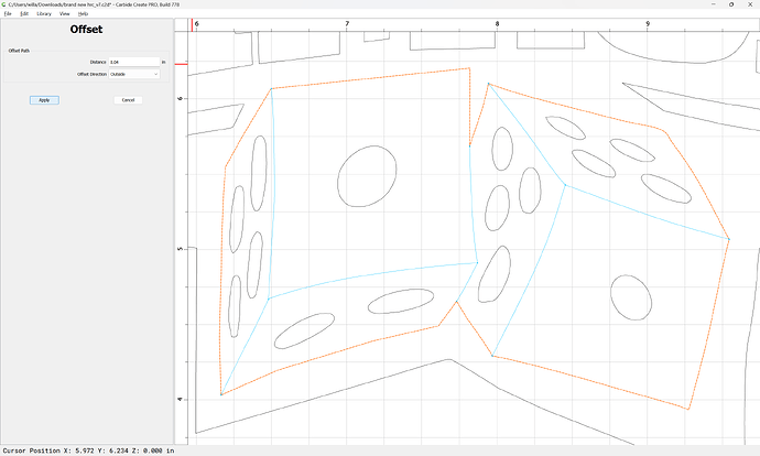

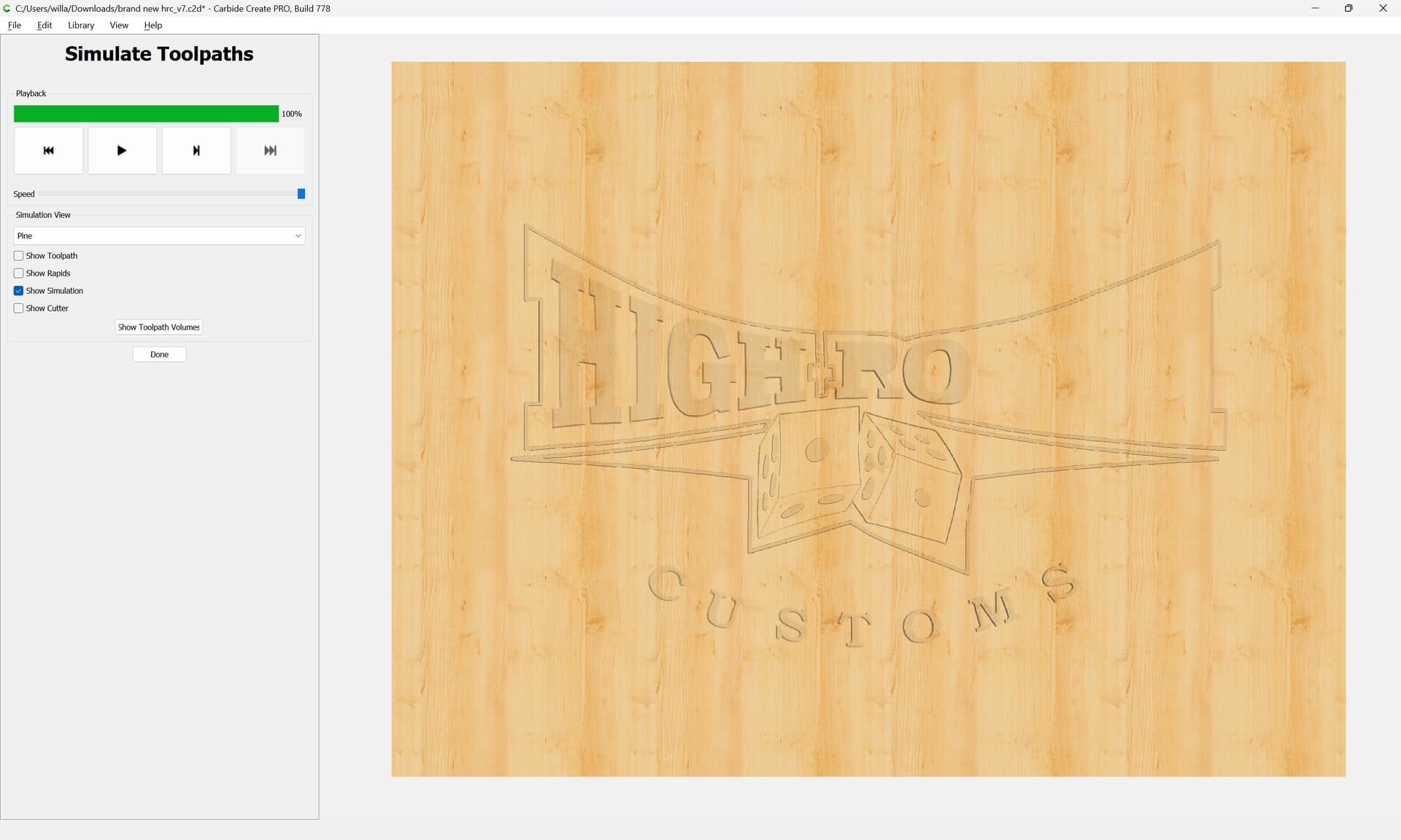

Probably the most expedient thing to do would be to offset the closed geometry and V carve that, then use a No Offset Contour for the interior lines, and Advanced V carving for the pips on the dice, something like:
Apply
which previews as:
Updated version:
brand new hrc_v7.c2d (228 KB)
