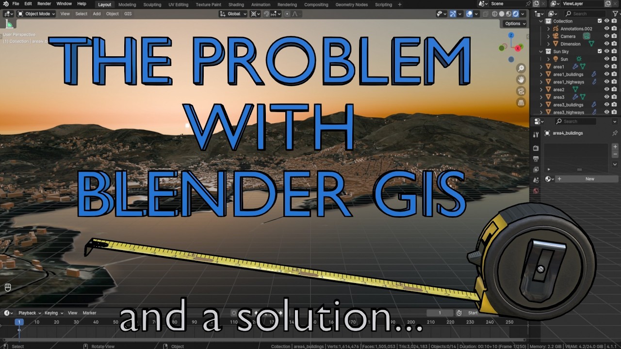

I like blender and the GIS addon. There a number of blenderGIS tutorial. Export the chosen terrain to stl or obj.

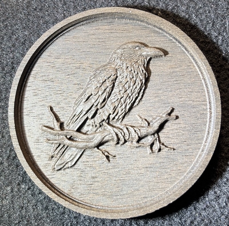

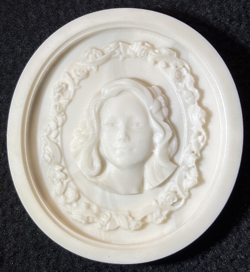

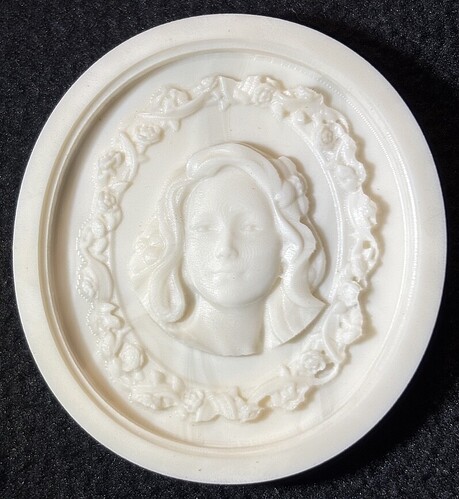

Some examples:
Those images are very detailed look great,what other animals do you do?

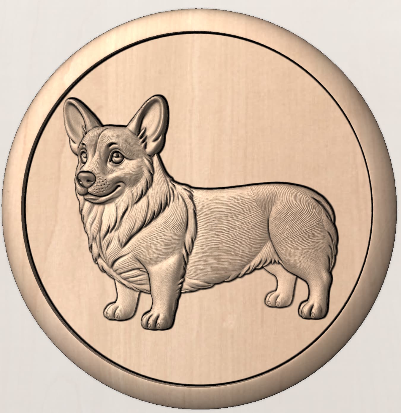

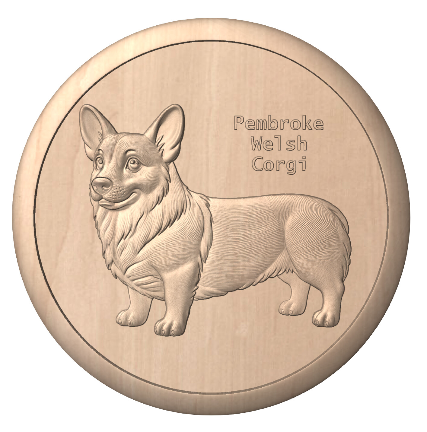

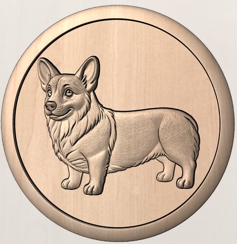

I have been working mostly on dogs. I am through the first 25 of the AKC’s most popular breeds. But I can do most any animal. If you ever get to facebook I am CNCfileDesigns my website is the same: https://cncfiledesigns.com, which is actually a store like Etsy called Payhip. This Corgi comes with or without the frame. I am pretty active in support of my files as well. I use WhatsApp or Facebook Messenger… or just plain old email. If there’s something that needs tweaking, I tweak.
This is where I tweaked the relief from 3/8" to 1/2"…

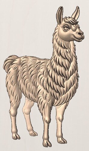

We have Llamas any image in the pipe line?
No…but if you want one I could do that. :slight_smile:
I would be up for that,I will get the dogs tonight.
I will finish him tomorrow…dead tired. Thank you.

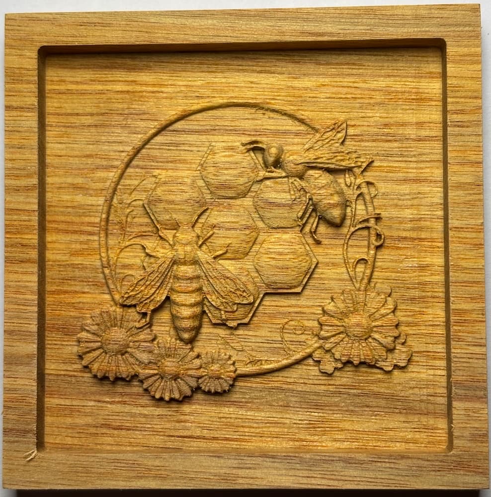

I like the honeybees. Do you remember the sellers name on Etsy?
