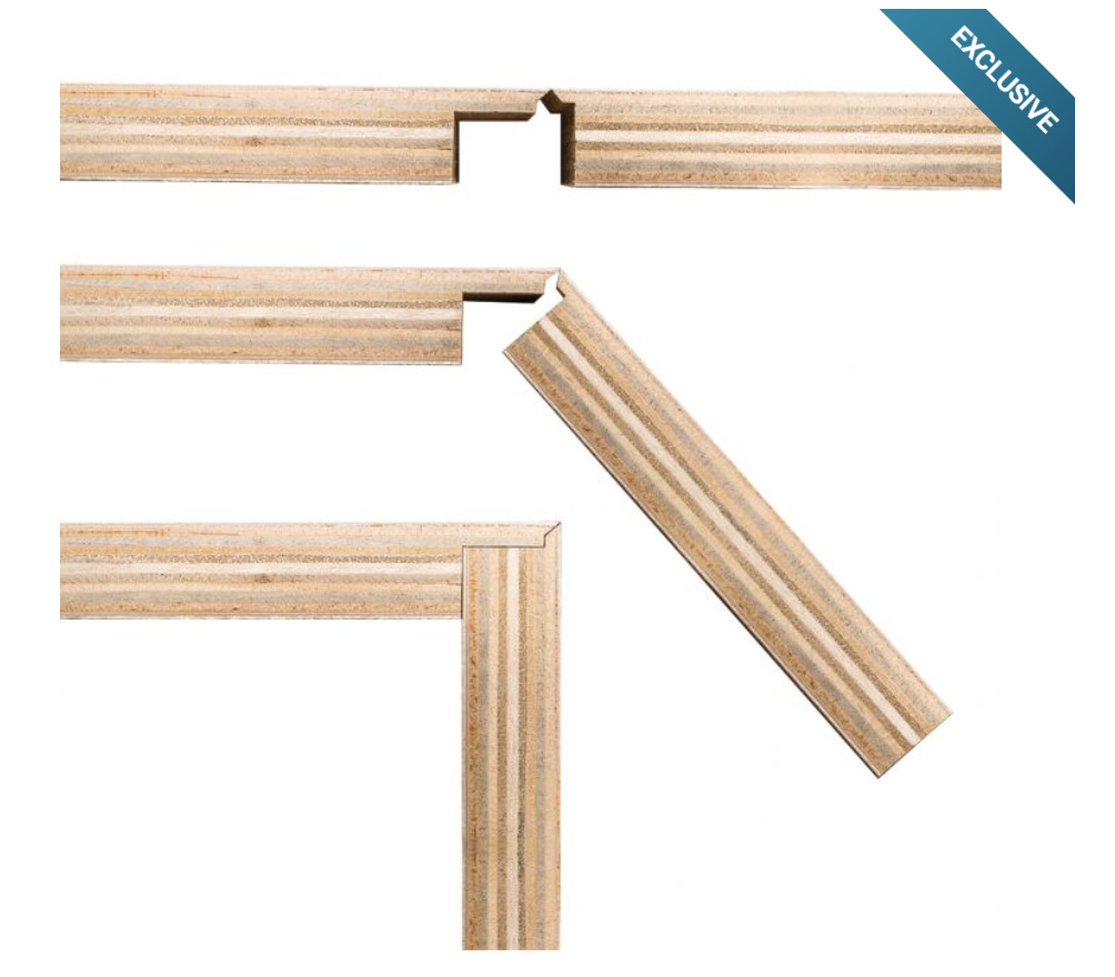

I think this would be a great idea for BlockSCAD/OpenSCAD @WillAdams… Rockler currently sells specialized dado stack that allows you any piece of panel good into a box just by making 4 cuts on your table saw.
The joint and result looks like this:
This is highly desirable from a production time standpoint as well as being able to achieve continuous grain on the outside of the box on ALL of the sides. However, the parametrics behind making this a “design by numbers” model are beyond my proficiencies in design software at the moment so i thought I would throw this idea out here and see if anyone wanted to take a shot at making it.

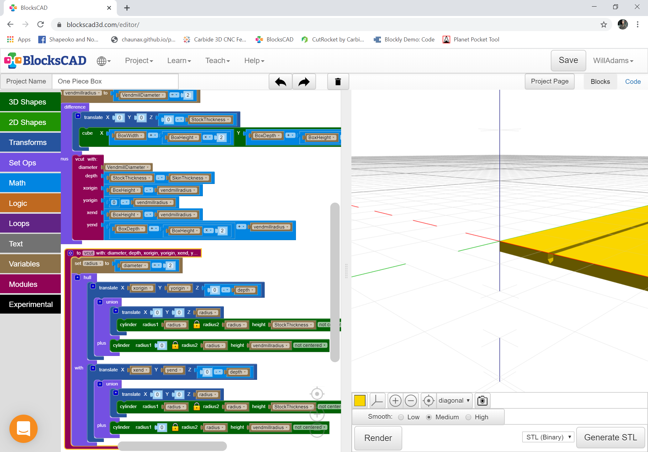

Next we need to model the V endmill and determine how deeply it should cut at and how much material to leave (probably need another variable for that latter dimension — the plywood I’m using has a skin thickness of 0.025in so we’ll roll with that). Offsets are by the radius of the endmill.
We make a module with appropriate inputs and use it to make the first cut:
and do the math for 3 more:

Wiring up the Customizer and getting the export possible is just a little bit of code:
V carving geometry:
Pocket geometry:
except I need to go back and tweak some numbers.
