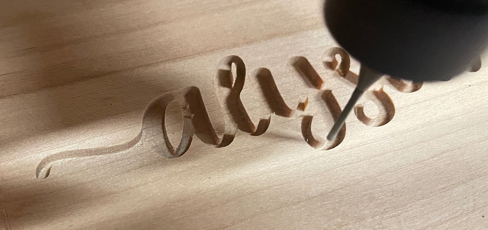

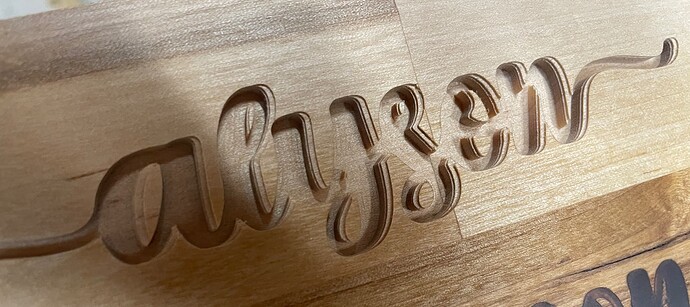

This has happened a couple of times now and is super annoying. I am doing some epoxy inlays and have been cutting coutours for the epoxy. A few times now the cut seems to “shift” - sometimes more than once - during the cut. Any thoughts?
I have the latest software andn I a running Shapeoko 3 Pro.
Lost steps.
  • Check that nothing is mechanically interfering (wires and cables are a frequent culprit)
Check the machine mechanically:
  • (for belt drive machines) Pulley set screws — verify that these are in-place and secure — be sure to check all axes/pulleys (including Z on machines w/ belt-drive Z-axis, for an HDZ, check both coupler screws).
  • (for the SO3/4, X- and Y-axes, and the belt-drive Z-axis on Launch and summer 2016 SO3s) V wheels / eccentric nuts (per assembly instructions)
  • (for belt drive machines) Belt tension (see the relevant step in your instruction manual, Note that the X-axis motor is held in place on standoffs and if those bolts are loose this can cause belt tension issues. Also, belt tension for the Y-axis stepper motors needs to be even/equivalent on each side — a significant difference can cause skipping on one side eventually resulting in lost steps on both.

I’m beginning to think it is definatelyt the belts. I’ll give tensioning them a try. Any suggestions for new/better ones?

My machine is a XXL I bought in 2020 and haven’t done anything to it shince I initially set it up. Just looking at the belts I can see where they might be a bit loose - and “dry”. I checked all the v-wheels and all seems ok. Ii can’t get to the pully to put a mark on it as it is blocked by the router plate. I tightened up the blets. Good idea aboutthe 3M finishing pad. I did have some “stuck on” sawdust. I think I’m going to go ahead and pull the plug on the maintenance kit. I mean, it HAS been 5 years… :thinking:
after adjusting and cleaning the belts, and checking the v-wheels, the cut looks a lot better. but I still will get the maintenance kit.
