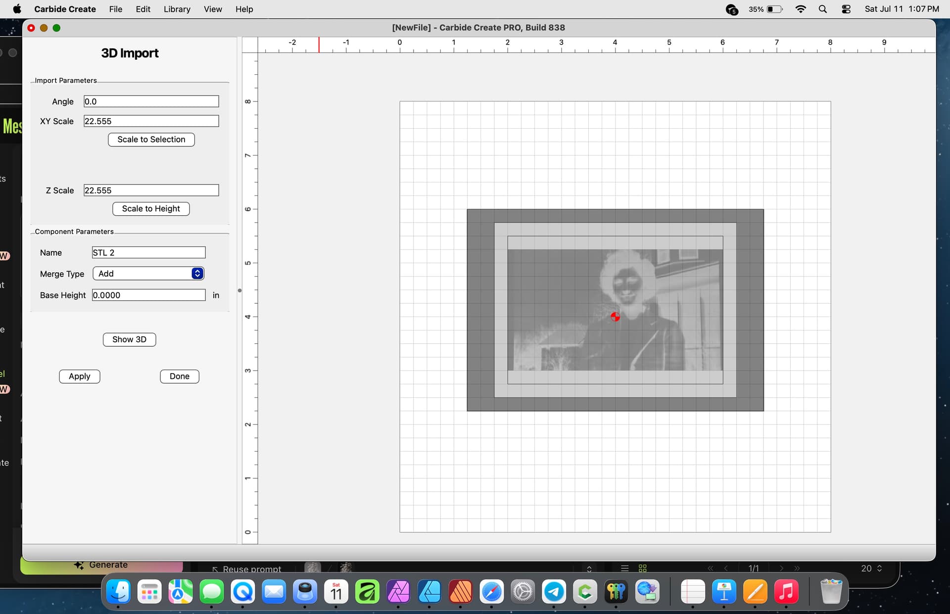

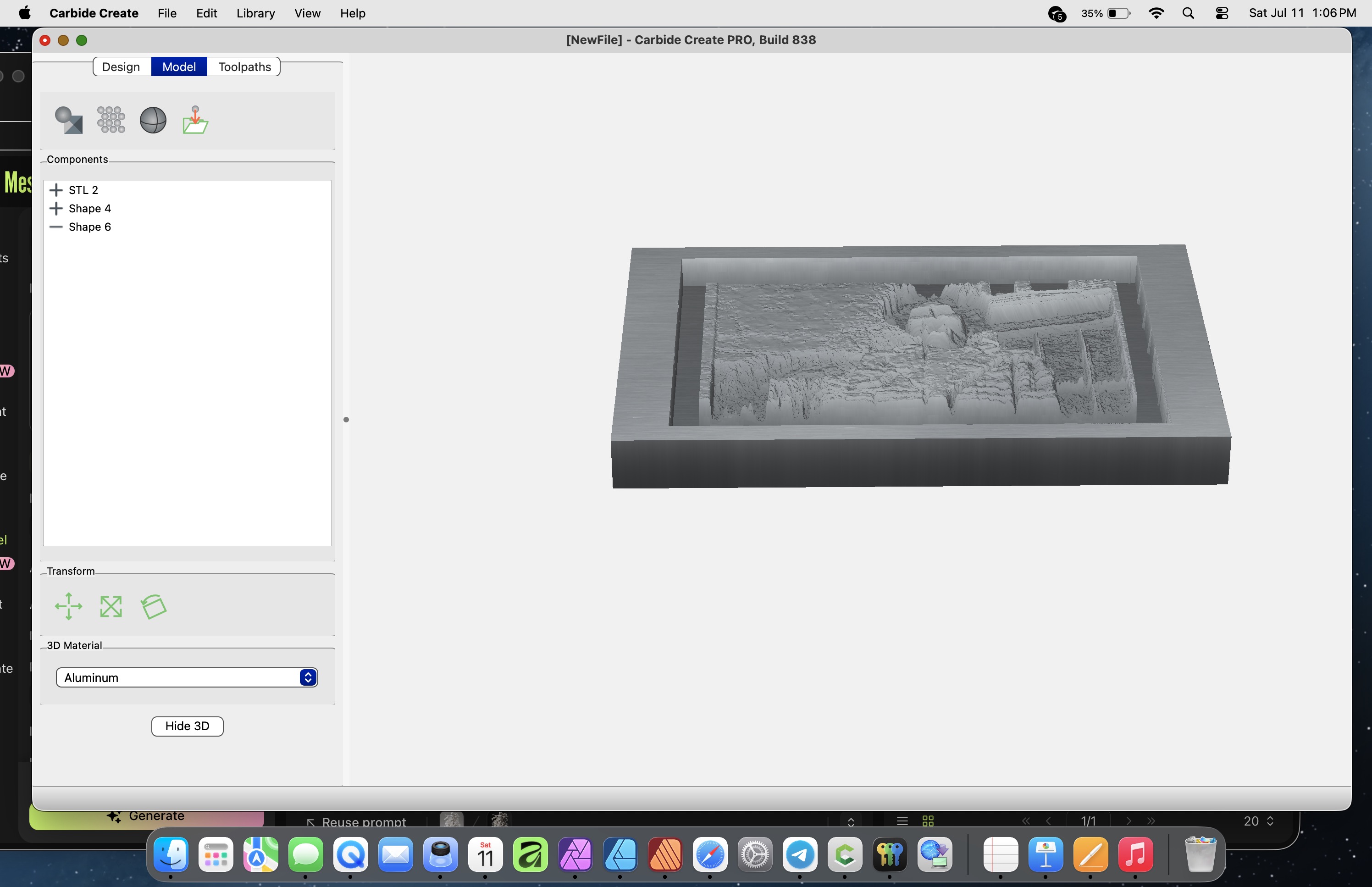

I am having problems converting a PNG grayscale file to a 3D STL file. You can see in the image the 3D is going in and not up. So the mapping is in the wrong direction. Here are some images of the PNG and then CCpro as an stl. I need to make a relief ? I am not sure what I am missing in the process?

The invert does not turn carve the opposite direction

How do I create a depth map or relief map that has it in the correct direction?
You need to re-work this image so that light/dark correspond to height/depth, see:
