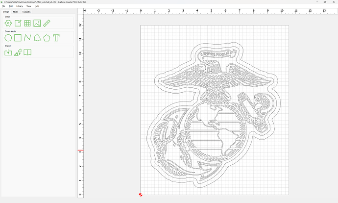

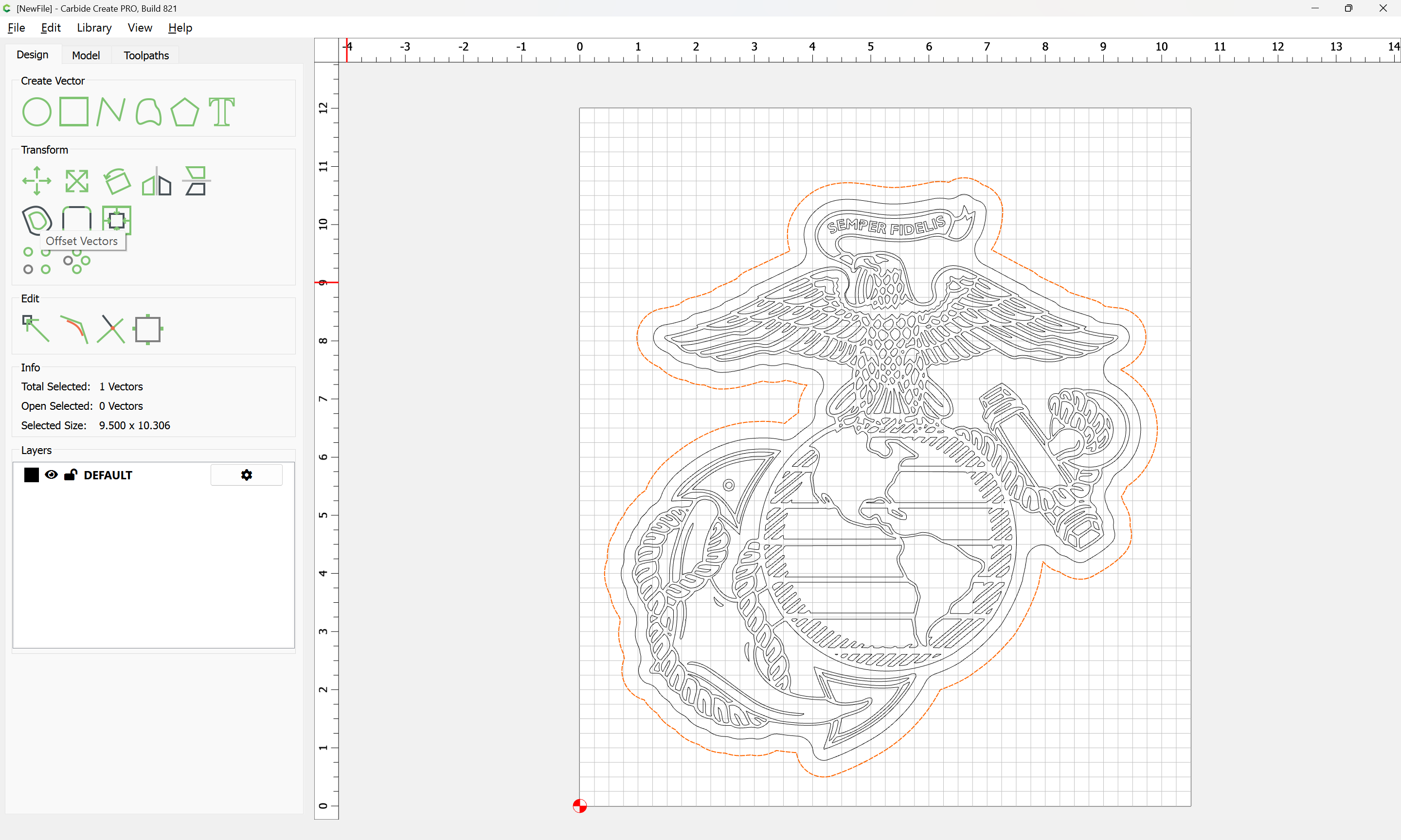

I am trying to download the Marine Corps Eagle Globe and Anchor (USMC Catchall) from the organization tab on CutRocket but it is not loading into CarbideMotion would you be able to fix this?
USMC Catchall by bporter61
This design is much like that worked up at:

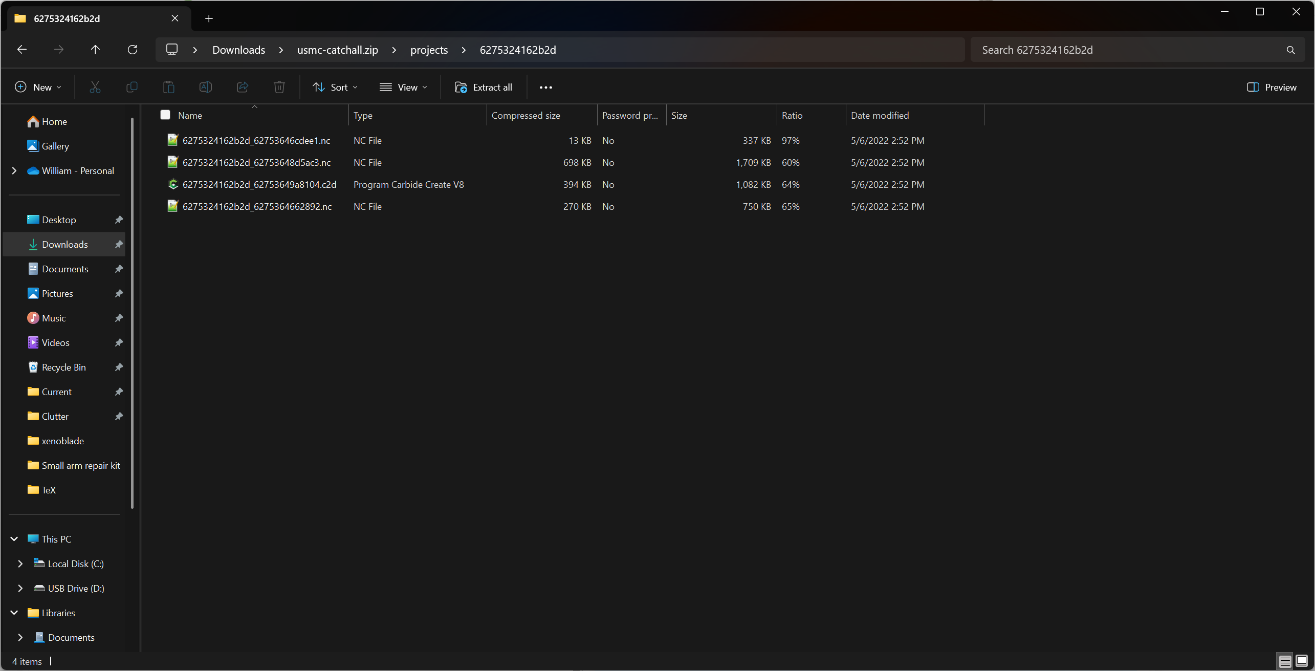

Once downloaded and the .zip archive inspected one finds:
The .nc files may be run as-is (if one has the exact same tooling, workholding, stock, and ideally machine as the project creator, bporter61)

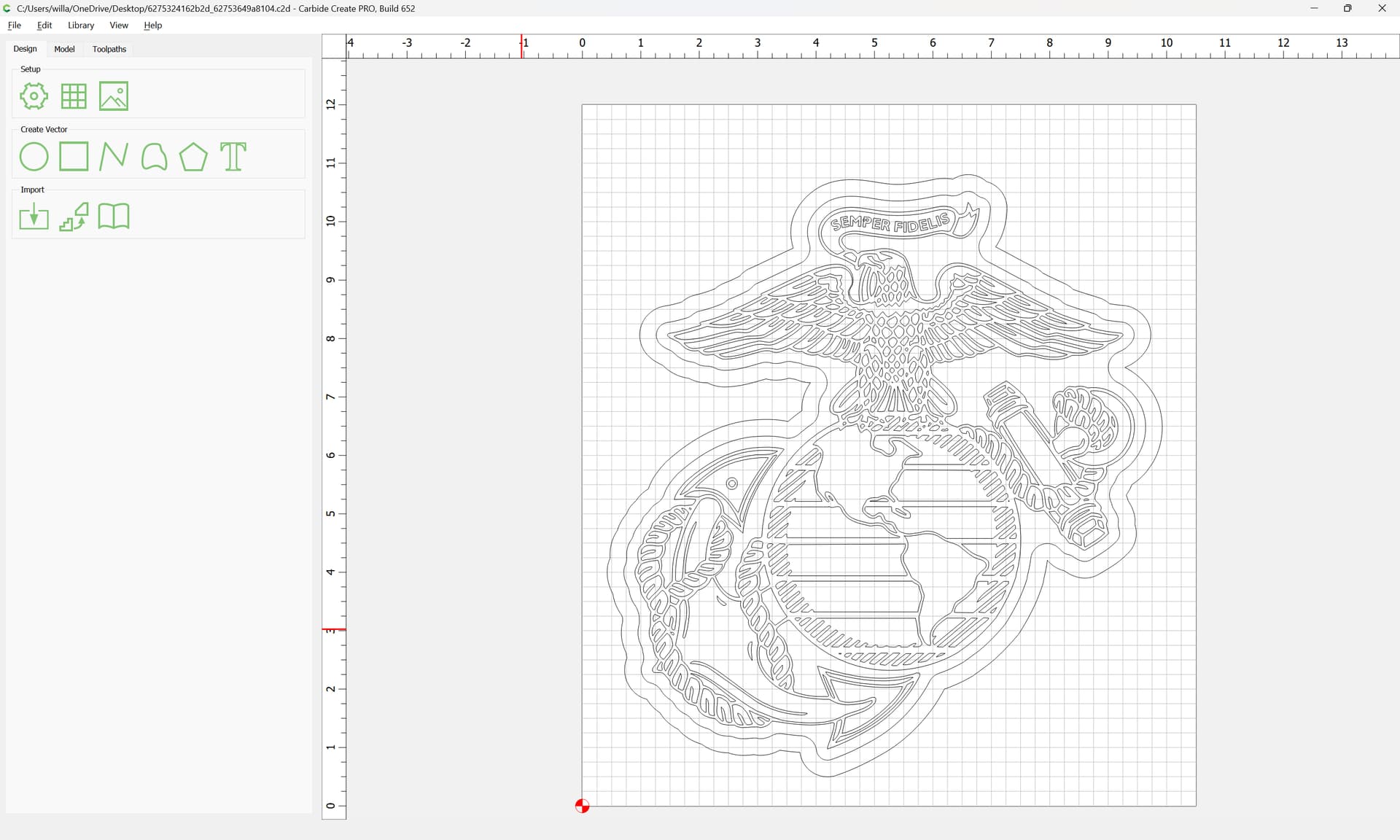

The .c2d file may be opened up:
and we see that a build of Carbide Create 524 was used — this should allow the file to be opened in v6, so we do so:
and re-save as a v6 file and open that in v7:
Note that v6 files should open in v7 which is available at:
https://carbide3d.com/downloads

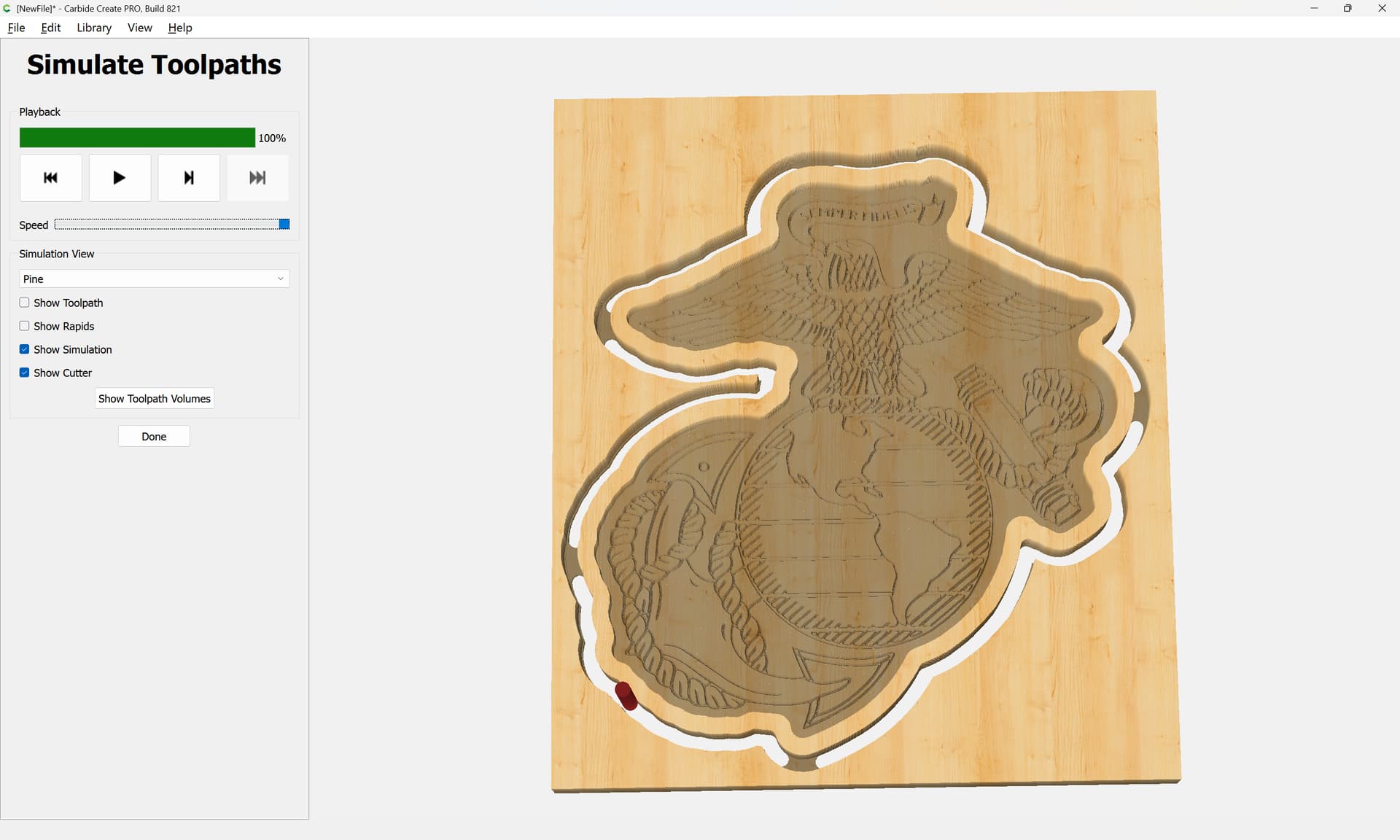

and re-save that as v7 which we re-open in v8:
which opens and previews as expected:

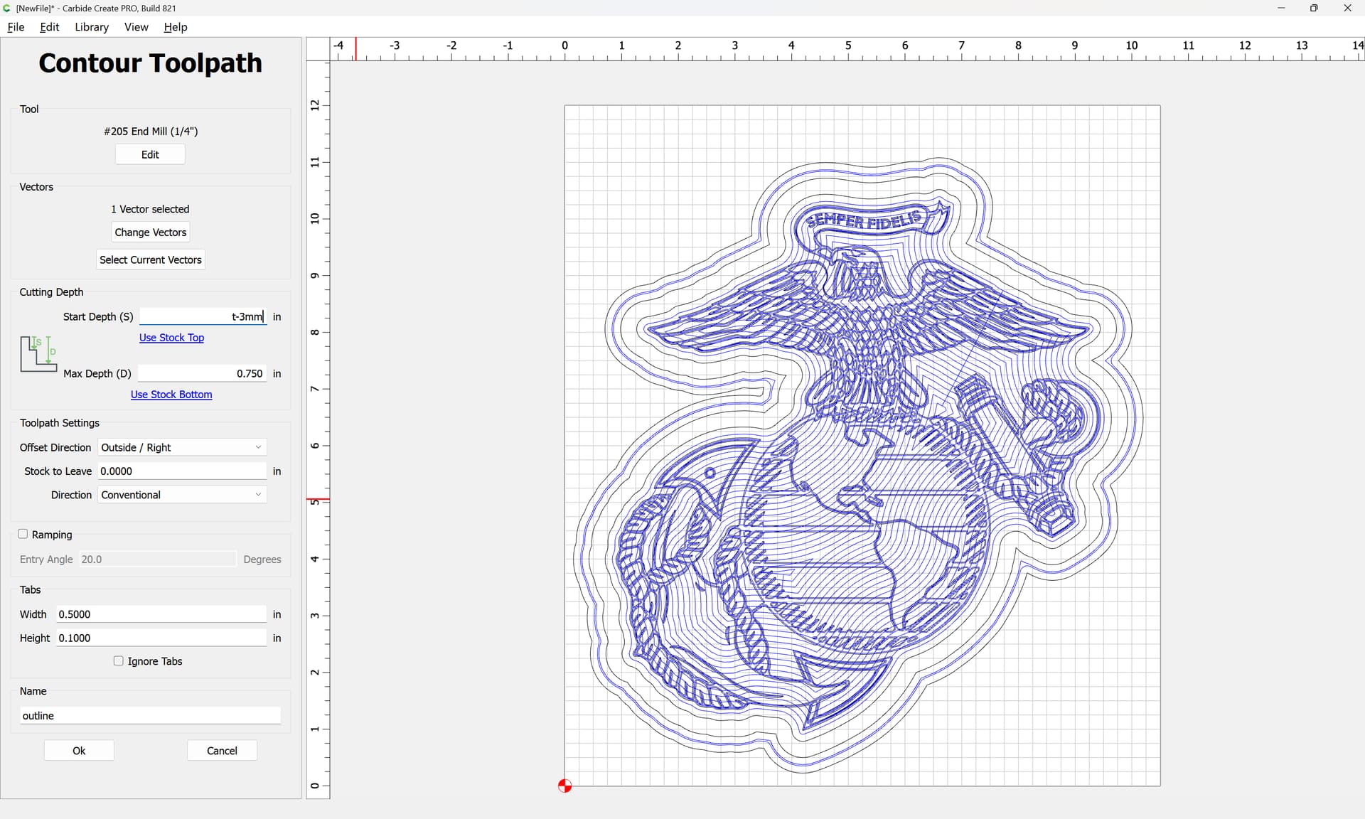

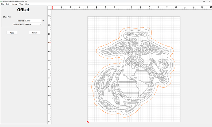

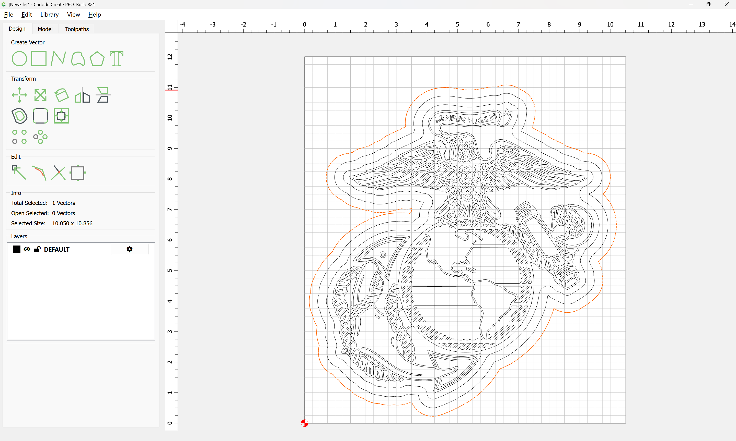

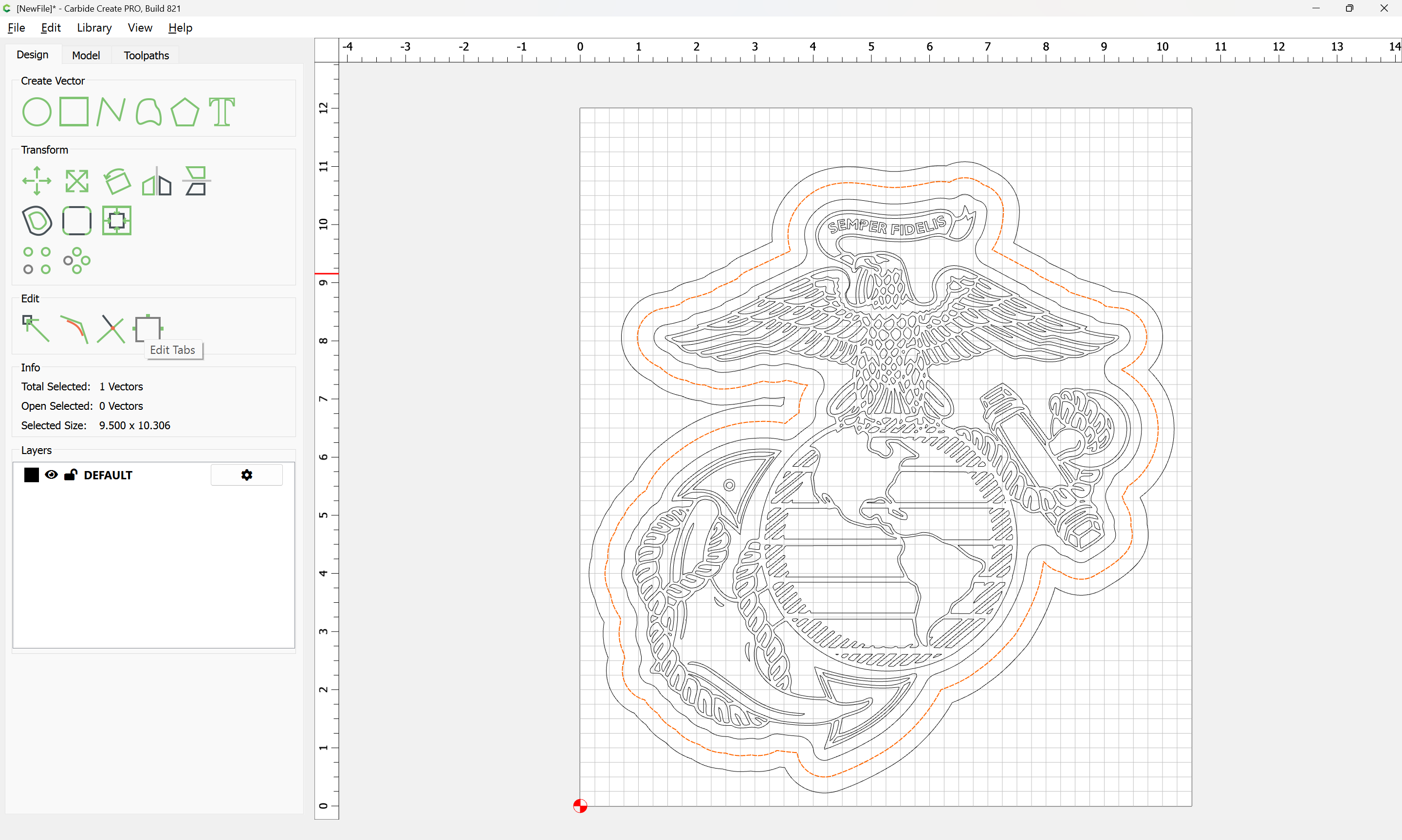

but we go back to Design and add an Offset:
Apply

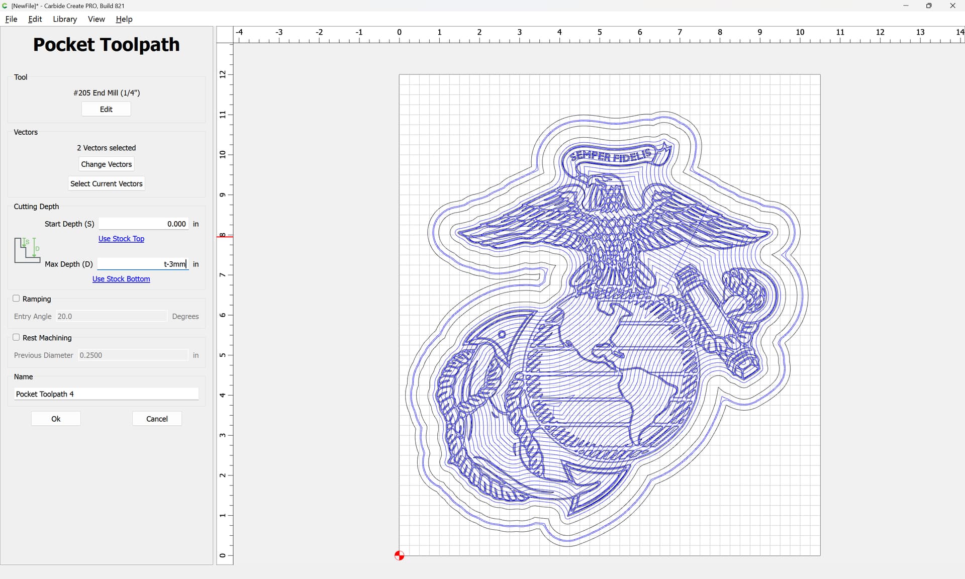

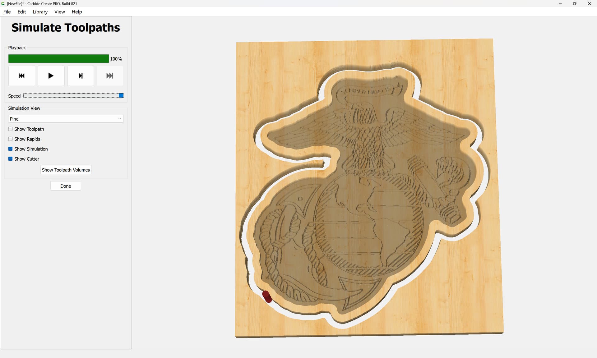

and then insert a Pocket toolpath above the Contour:
and modify the Contour toolpath to begin at the bottom of the previous pocket:

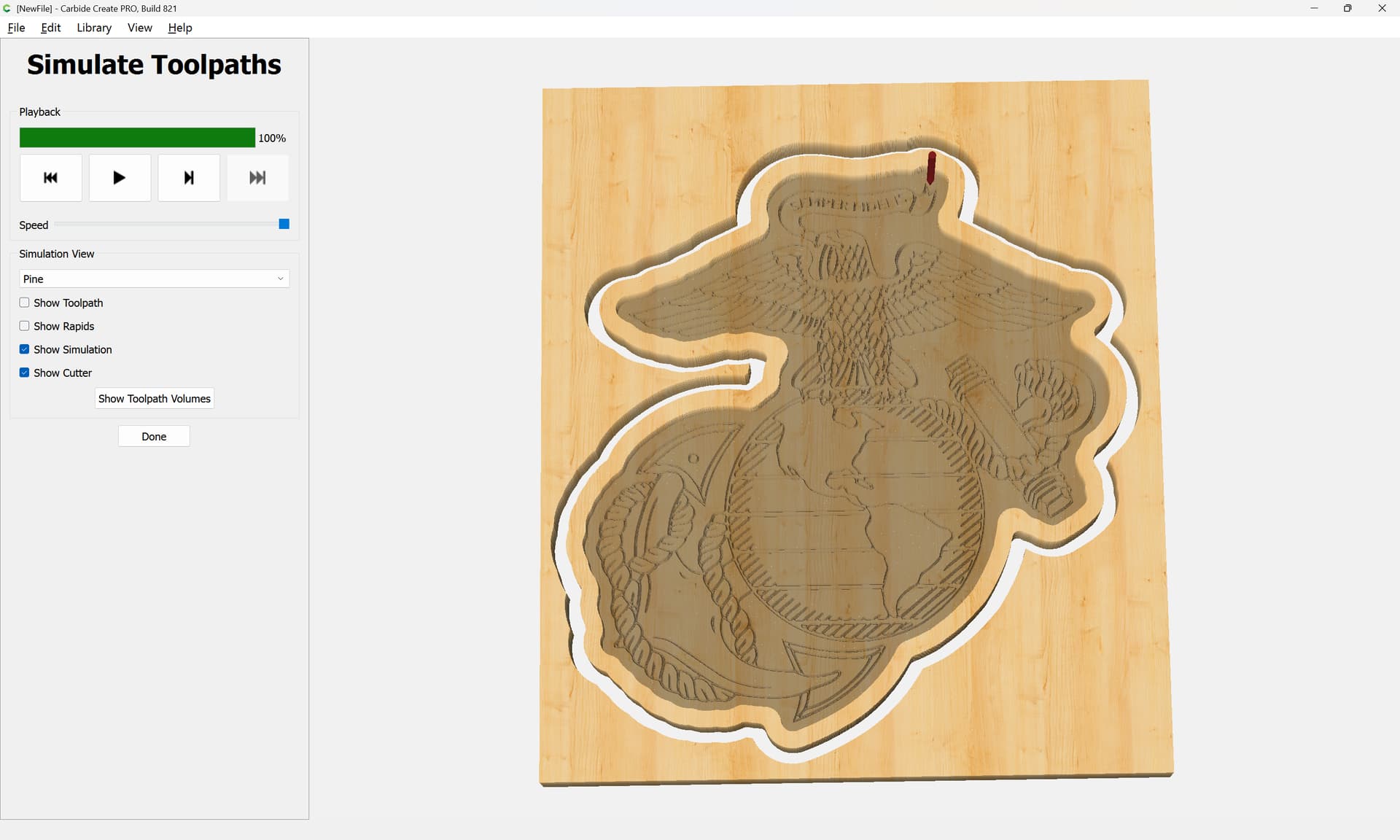

which previews as:

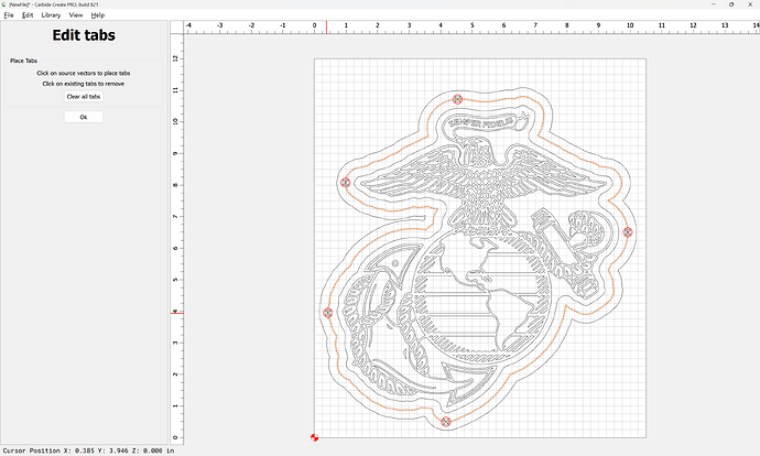

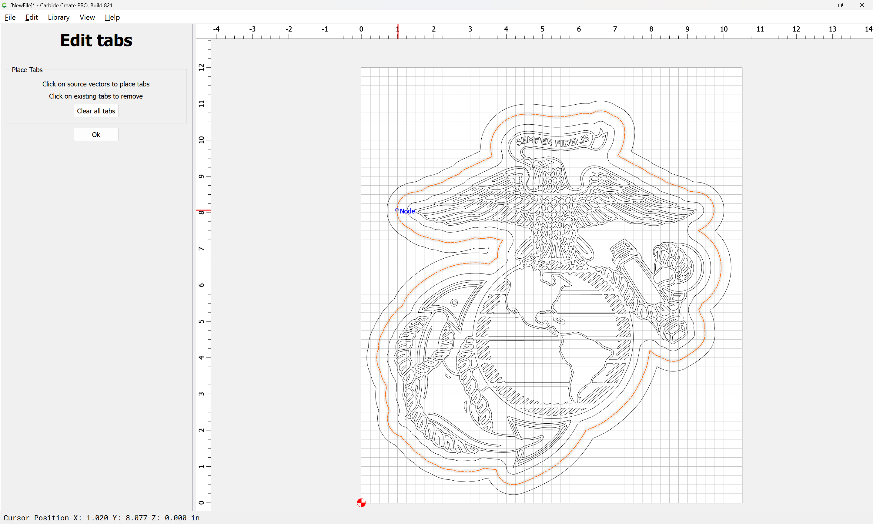

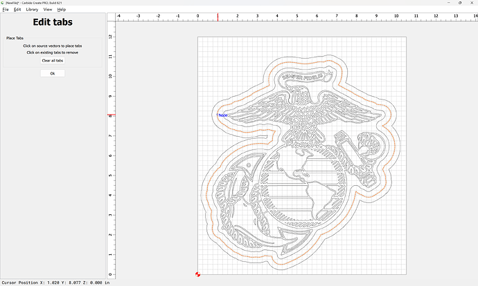

Adding tabs:
and if used:
(the checkbox may be cleared by folks using blue painters tape and cyanoacrylate glue)
Attached as a v8 file:
USMC_catchall_v8.c2d (2.3 MB)
