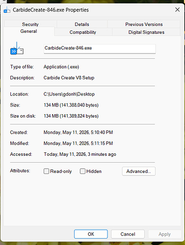

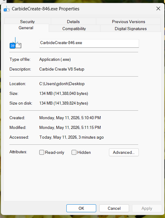

I downloaded from the link provided and installed. However after opening CC it still reports v845. I checked the installer and it says it is 846.
Yep, it somehow got the old build number, but it’s got the latest fixes.

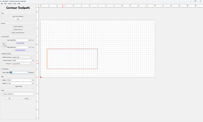

1 - There is no provision for ramping.

  1. Ramping is a pro feature:
  1. Could you upload a file and screen grab depicting what you mean here?
  2. Thanks!
I have the pro version but do not see ramping available for the new cutout toolpath.

The Cutout toolpath does not have ramping.

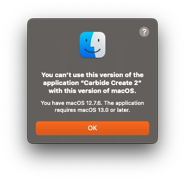

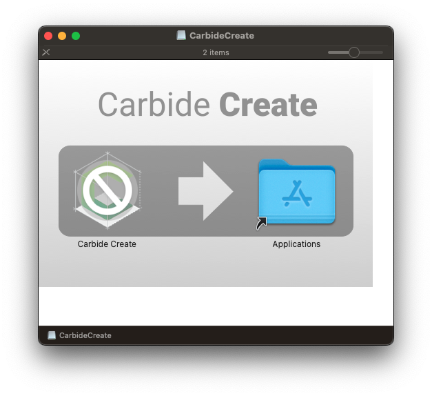

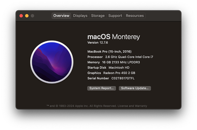

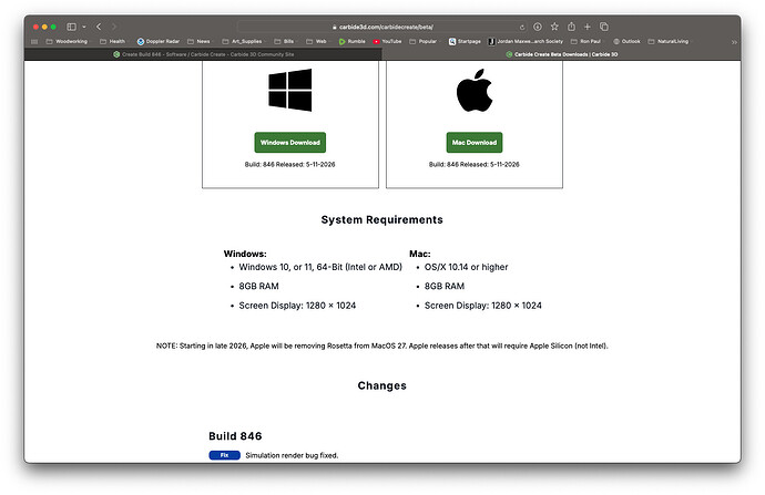

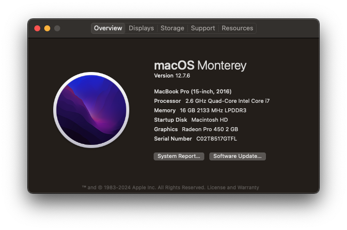

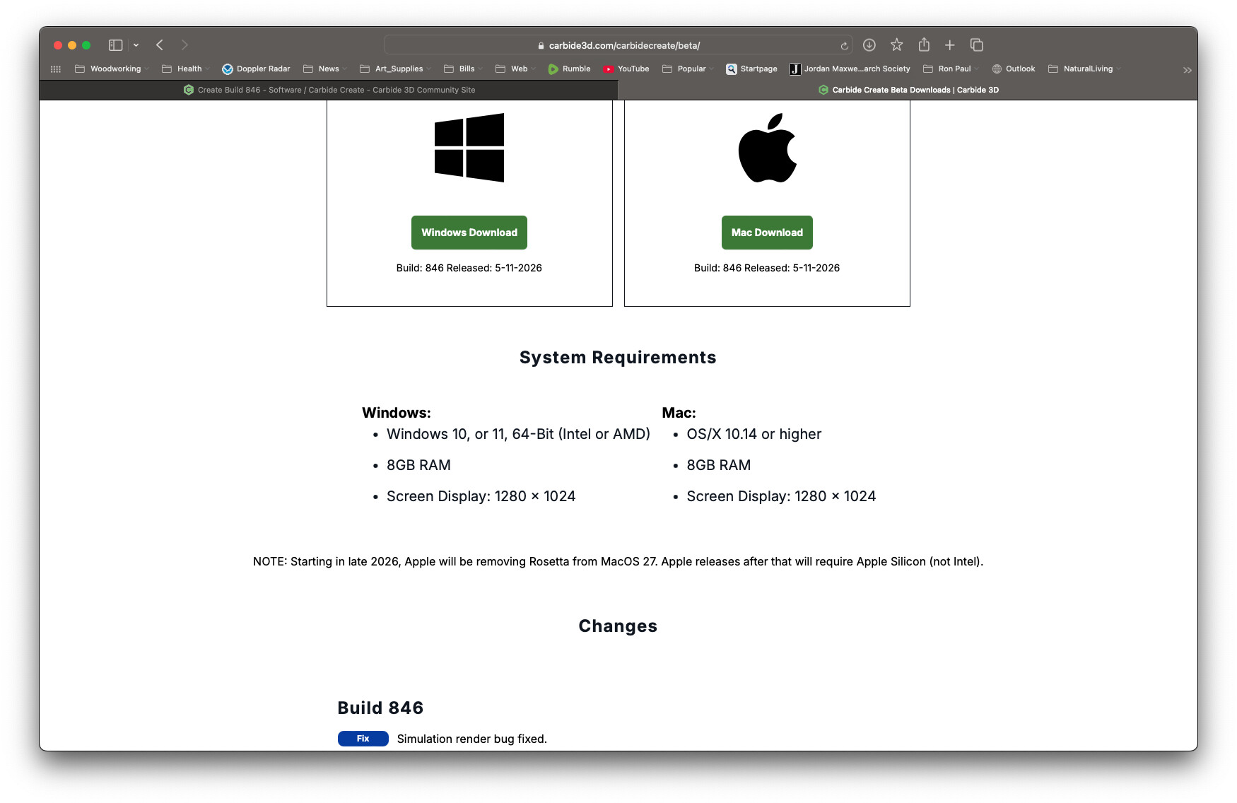

Hello Rob and thank you for the update. I downloaded the latest beta and it says I need MAC OS-X 13 however the beta download page says Mac OS-X 10.14 or higher. Any help is appreciated. Thank you!
I’m not sure if this upgrade bumped the minimum requirements. I’ll have to check.
Yep, the latest Qt libs require macOS 13. We’ll see if we can drop back to a revision that’ll support macOS 12. Unfortunately, this is a short-term fix for you.
Since Apple is dropping Rosetta later in the year, we’ll have to change from compiling for Intel to compiling for Apple Silicon, which means those builds will no longer work on your Intel Mac. (But, everything will get incrementally faster on all of the Apple Silicon machines)

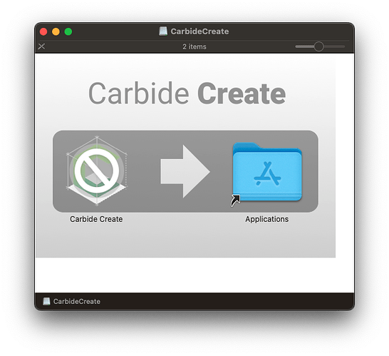

If you really like the way your mac runs & feels but are possibly “barred” from future OS
upgrade path (same boat I was in), I bought a relatively inexpensive USB attached Seagate drive and installed a copy of Kubuntu (any version of Linux probably would work the same way), then installed WineTricks (lots of internet info on this) which allowed me to then run a Windows version of CC Free within Winetricks while booted in Linux. So far everything works just fine, and I still have the rock-solid Mac hardware running it. By using and booting into Linux on the Seagate drive, the MacOS remains intact and bootable and usable if you have things that work better for you on the Mac (other than CC). Hope this provides another “avenue” to get where you want to be.
Thank you for the info David. The way these computer companies force you into newer equipment burns me up. In 2008 I bought a new MacBook Pro for $2600. By 2016 I was forced into a new MacBook Pro for $2400. Well, I suppose I could have stopped working but that doesn’t pay much. I suppose I should be glad it took 10 years to upgrade instead of 8. Yay! Anyhow, thanks again for the work around.

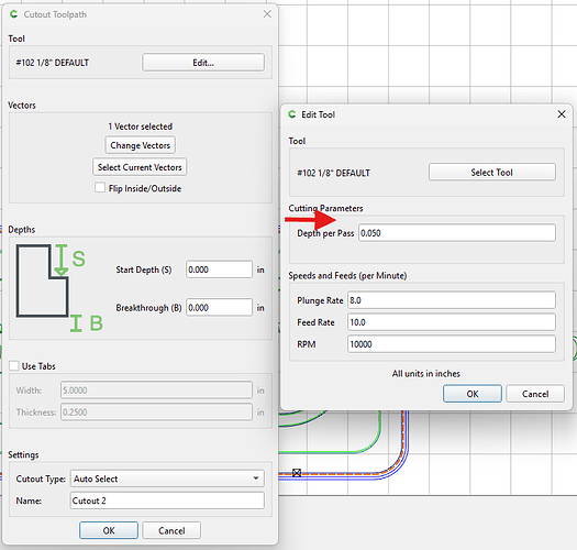

I love the new Cutout Toolpath. Would it be possible to add “Ramping” and “Stock to Leave” similar to Contour Toolpath.
How about putting the stepover back in the tool dialog so we can control it?
Where was stepover removed?
There’s no stepover for the cutout toolpath- that’s all predefined at this point.
Indeed. It looks like it defaults to half the dia. It would be cool to specify it.
