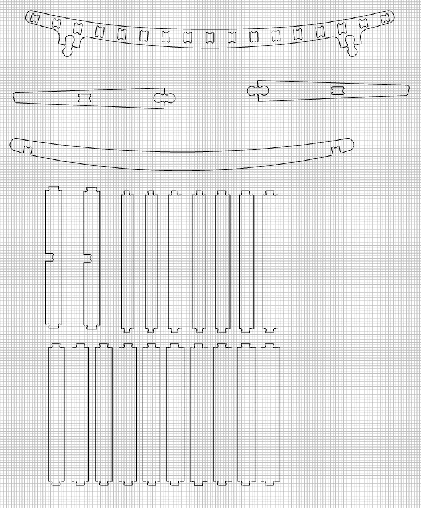

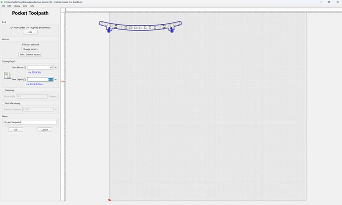

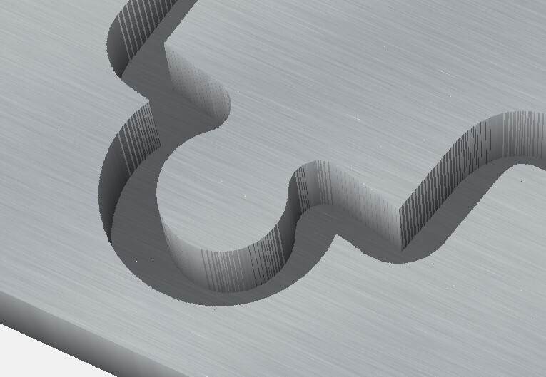

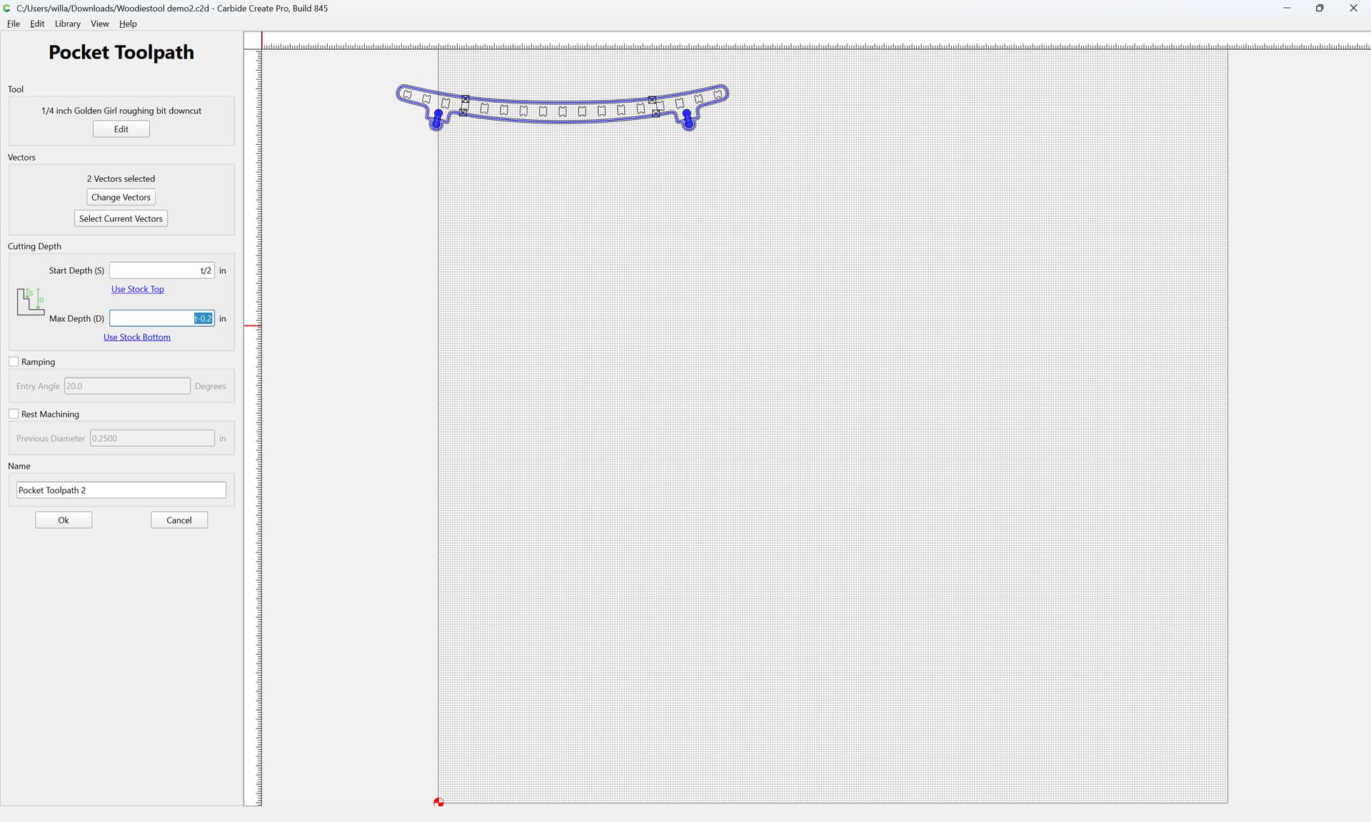

Looks like my third toolpath does not cut at all, despite defined. Idea is to get a joint for legs, should be cut half depth as a pocket, and then the rest of the contour should be cut, what does not work. What did I wrong? As a makeshift will do the 3rd toolpath the oldfashioned way. But how to use the new feature properly for my purpose?
Woodiestool demo.c2d (248 KB)

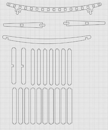

The next file should show how the piece is intended to be cut with the “old” method:
Woodiestool demo2.c2d (296 KB)

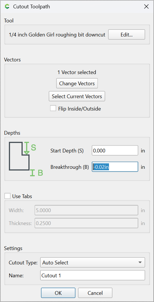

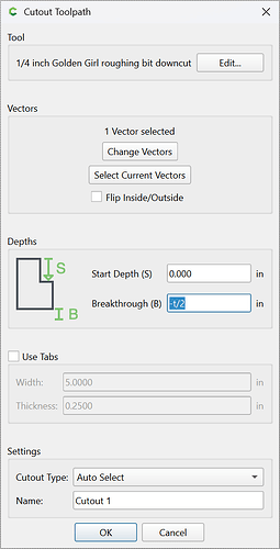

I found the UI and parameters for the Cutout toolpath confusing at first:
Values for Breakthrough are normally intended to be positive (as indicated in the diagram).

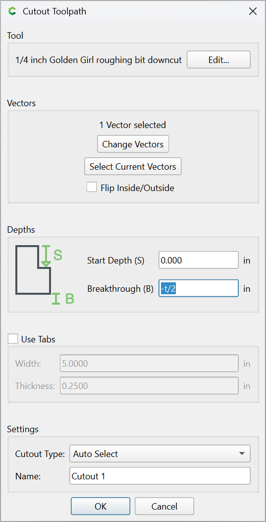

If you want the same effect as:
then it should work to enter a similar formula, but you have to remember that the starting point for the specified dimension is at the bottom of the stock, so instead:
a negative value pulls the cut up above the bottom of the stock lessening the thickness which is cut out, a positive value causes it to be increased so as to cut deeper than the bottom of the stock by the specified value.

with positive values it did not show any cutting path at all.
I believe “stacking” two cutouts is something the software cannot swallow.
So I used the first path (upper one) as a cutout,and the lower one the traditional way, and it seems to work. If I remember right you said this version is anyway just a step towards an integration of the cutout feature into contour? We will see. So far I have a solution, just not as “elegantly” as I hoped. Hopefully my license will be good enough for that next improvement.

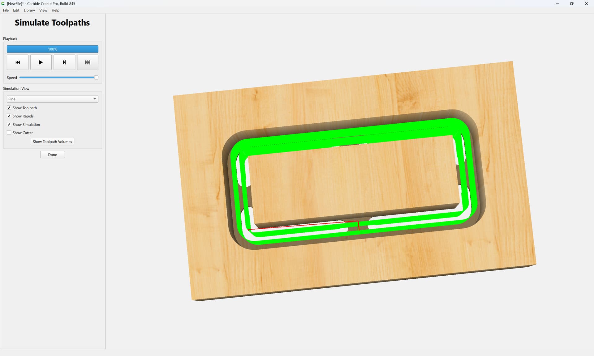

If we then change the dimension, say by Tab Height (default == 3mm):
it cuts through by that additional dimension (for a positive value):
If we change it to a negative value:
then the cut falls short by that distance:

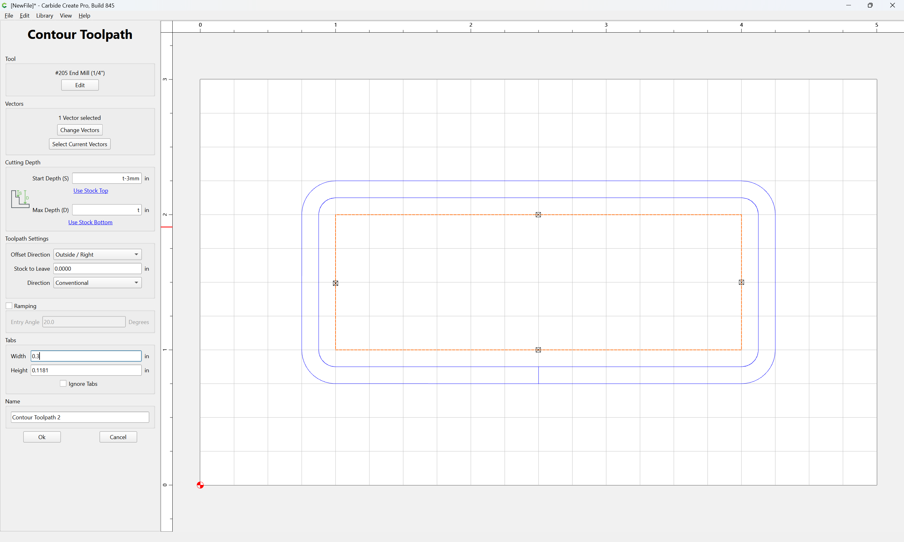

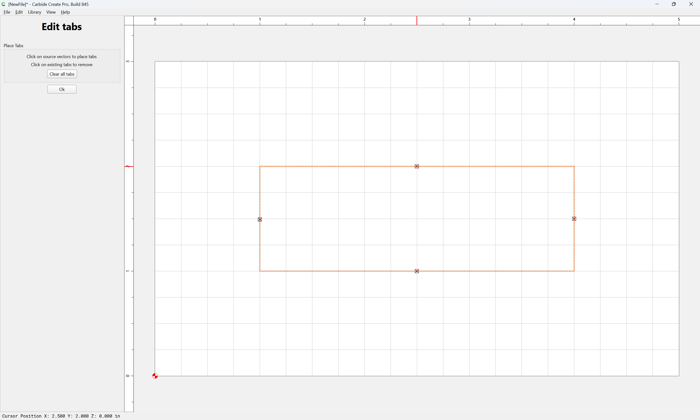

If we than add an additional toolpath to complete the cutout, as well as tabs:
then the added toolpath compleats the cut, leaving the tabs and outer perimeter uncut:
TY, obviously works well with “stacked” toolpaths on the same one pattern.
What I struggle with is to make those joints work, what needs two different patterns stacked one above the other congruently. That is possibly where the software gets its hickup.
