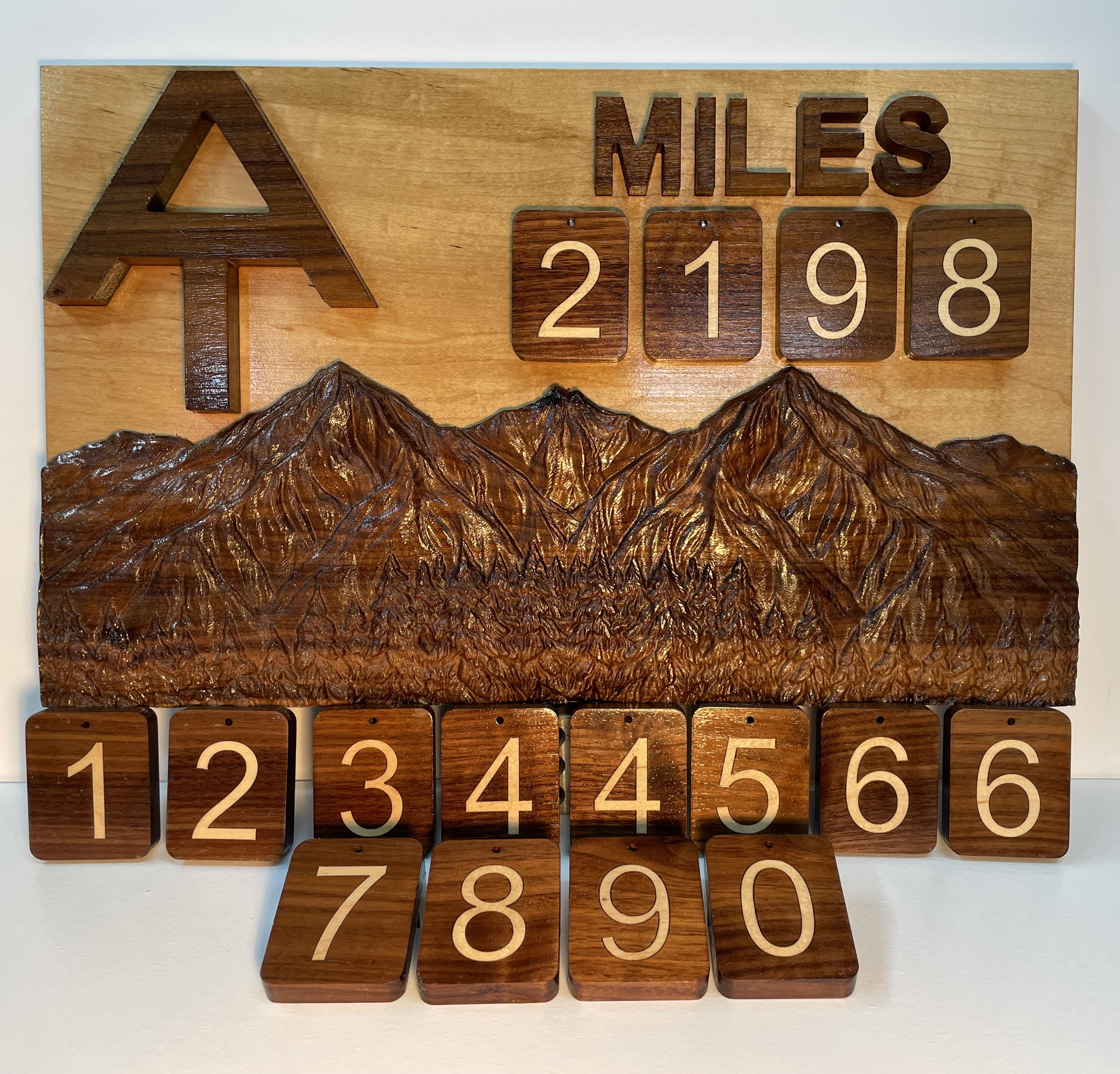

I just use straight bits and cut a shallow pocket for the letters to nestle into. This allows for proper alignment.
In my most recent projects I cut the pocket .02” larger than the letters and that provides a nice fit. That number could vary depending on the design and bit used perhaps.
The AT logo and the word MiLES were done that way on this one from a couple of years ago. The numbers were done with the traditional inlay method.
