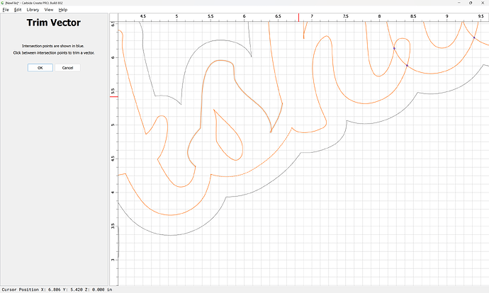

With that done, the text may be converted to curves:

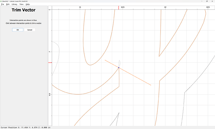

and then Trim Vectors used:
to remove the internal geometry which might interfere w/ toolpaths:

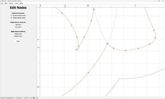

(Note that the font has self-intersections which should be cleaned up using Node Editing)
Until one arrives at:
OK
OK

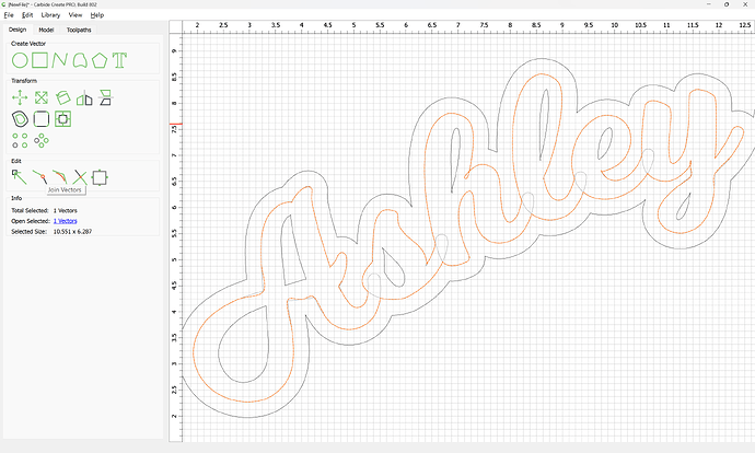

Use Join Vectors to close things:
Yes
As noted, use Node Edit to fix things:
If need be, exit Node Editing, delete, then re-select and return:
(repeat the exiting and re-entering)
Done
Close using Join Vectors
Yes
Or, draw a line:
and select everything and use Trim Vectors:
Eventually arriving at:
Attached as a v8 file:
