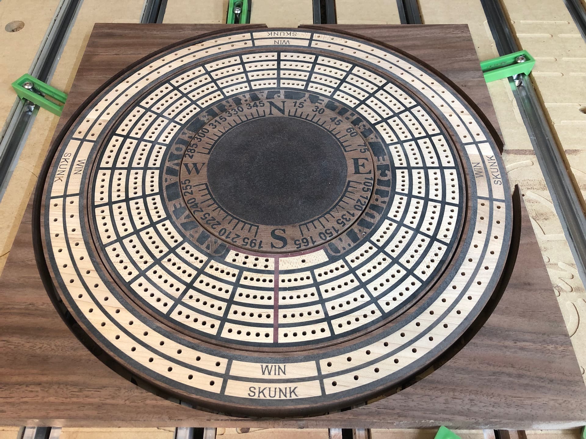

Had a chance to get some stuff done
I cutout the line that will serve as the start/stop. I’m going to filling it with Red Epoxy tonight.
Cut the Lazy Susan in, I left some play room just to make sure I could get it dead center with the rest of the bodies. Also left .03 sticking out so it will freely rotate off the base.
Also started on the Compass. It will get epoxy’d tonight and ready for the 3D carving tomorrow.
First stage done, time for the ball nose
Dear Shapeoko…love you :kissing_heart:
Super happy with the end result. First “3D Carve” that was designed and computed by me.
4hr total cut time
1/16th Spiral Plunge
1/32 6.2 Deg Tapered Angle Ball Tip
There’s a couple of spots to sand, but super impressed with the cut!
The plan now is to fill the compass with clear epoxy that will sit flush with the numbering. Should be a cool effect once all finished

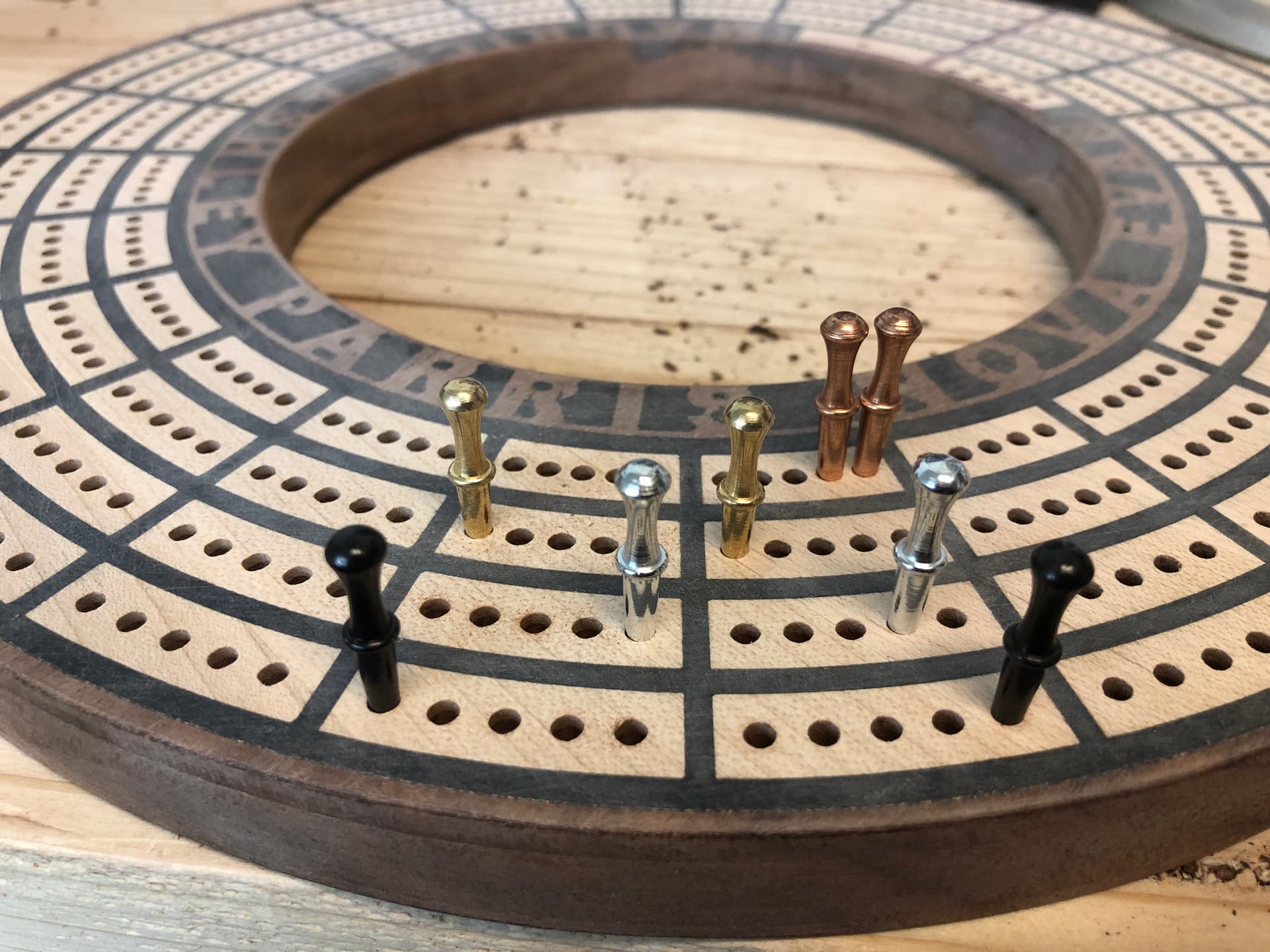

Test fitting the pegs to make sure they fit snug. .5” 1/8” hole is the perfect fit

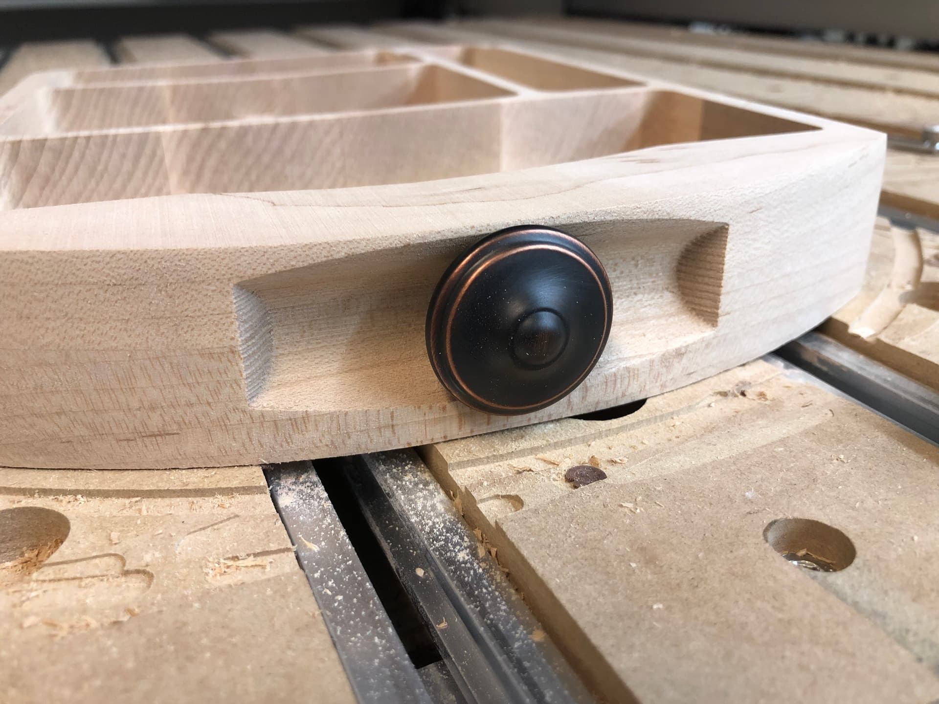

The drawer is done, just some sanding left. I CNC’d the front face before the glue up to give it a nice shape, really like how it turned out
Fits like a champ!
