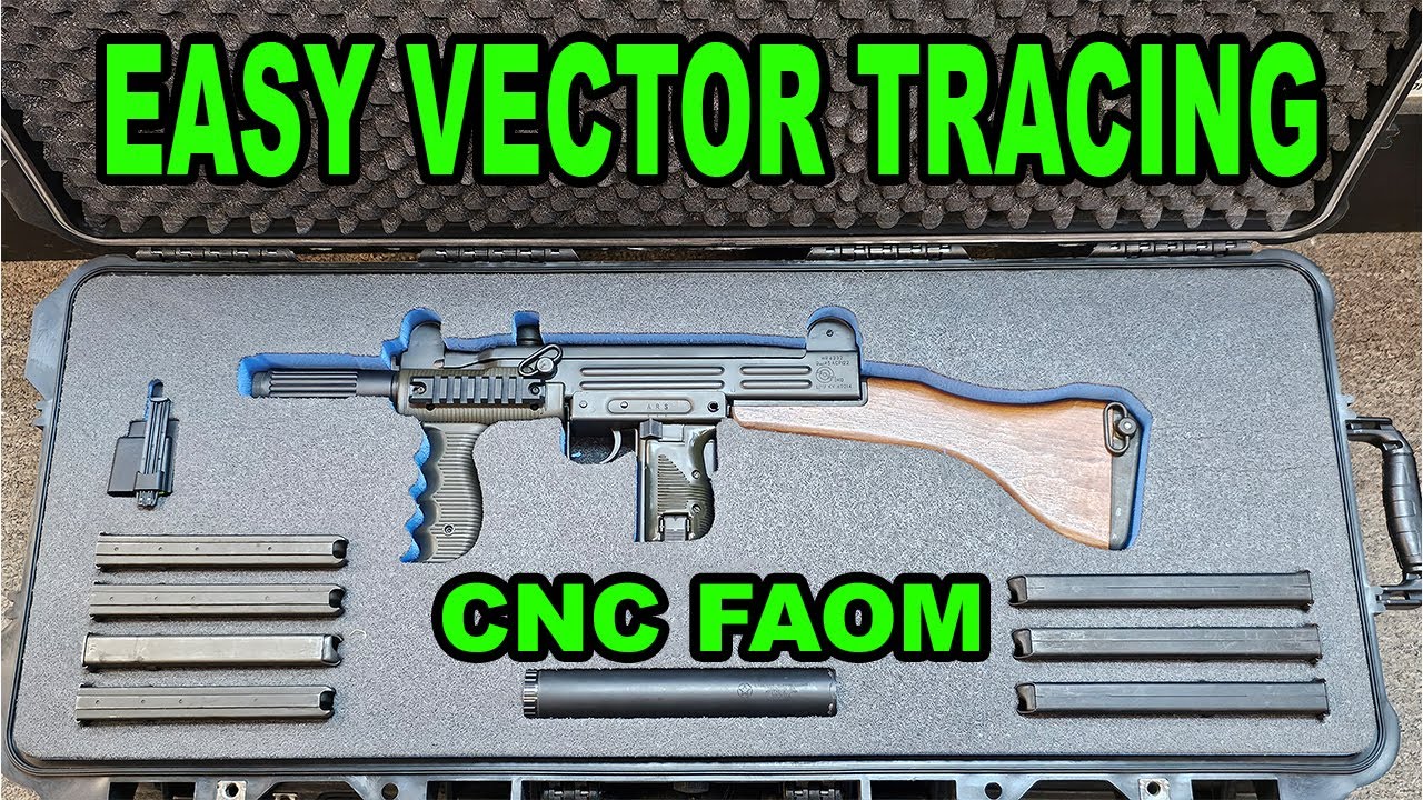

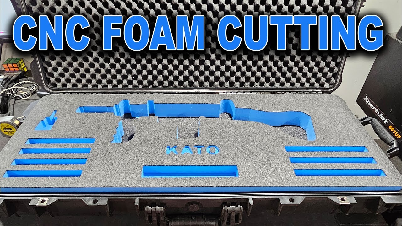

How I make custom foam gun cases for customers
using my Shapeoko 5 pro

How did you design the gun pocket so that you knew it would be a good fit? (without wasting a bunch of foam doing trials and sneaking up on the final shape?)
you simply trace the product
Then measure a few spots
but when you trace the shape is the actual shape so all you need to do is measure and make the shape the actual size
For an example of that sort of thing see:
To get an outline, cut a triangle out of some suitable material taller than the item you wish to trace, putting a circle at a point of it which will hold a pen refill, then use that to trace the outline:
