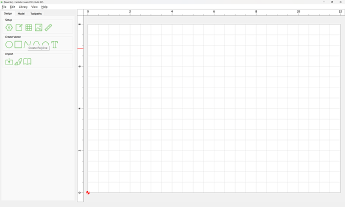

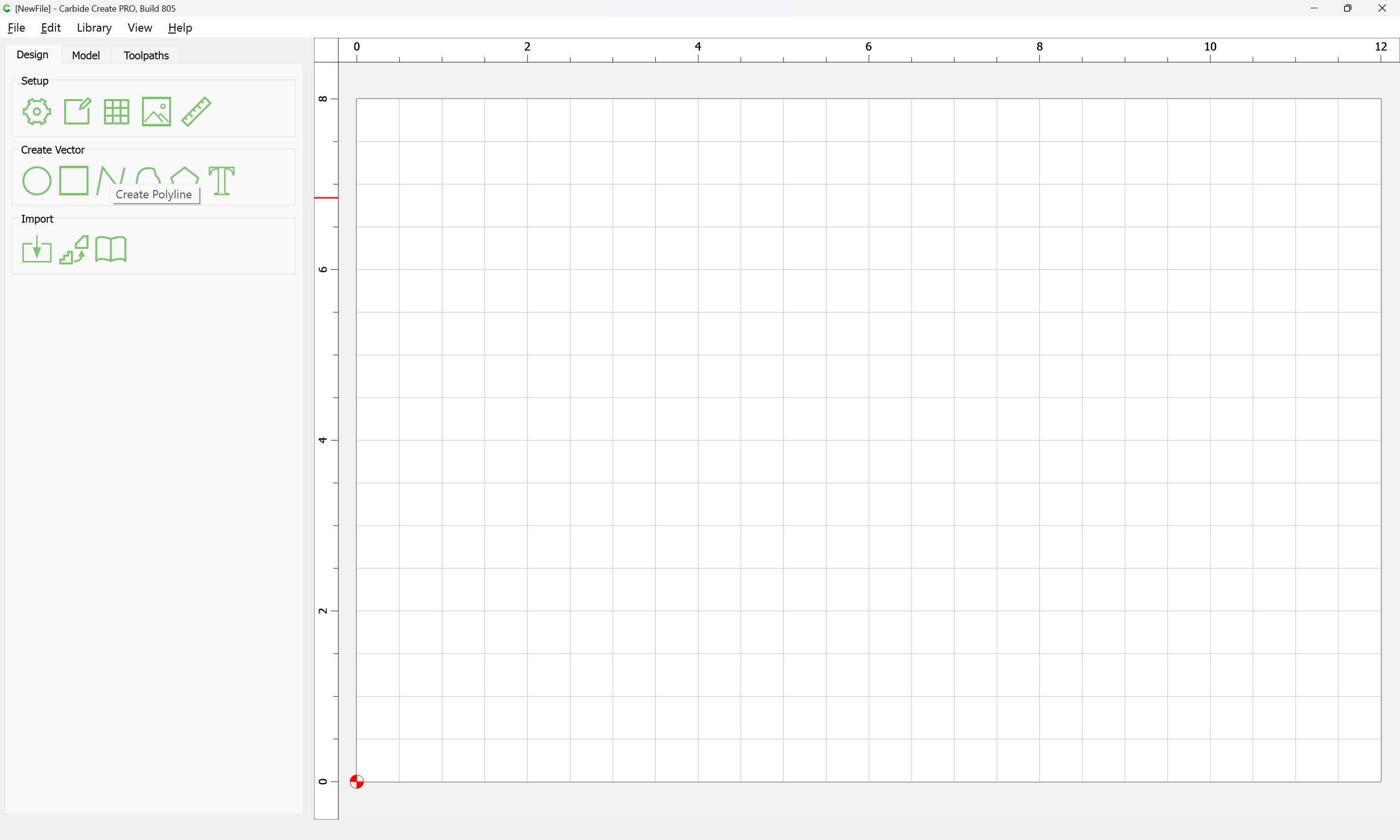

Making a cabinet. I can cut out the panels. How can I set a line in carbide create to cut a groove into the side panels for the back panel of the cabinet to slide into. Doesn’t seem to have a simple line tool.
With nothing selected:
Choose the Polyline tool:

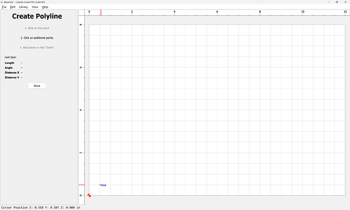

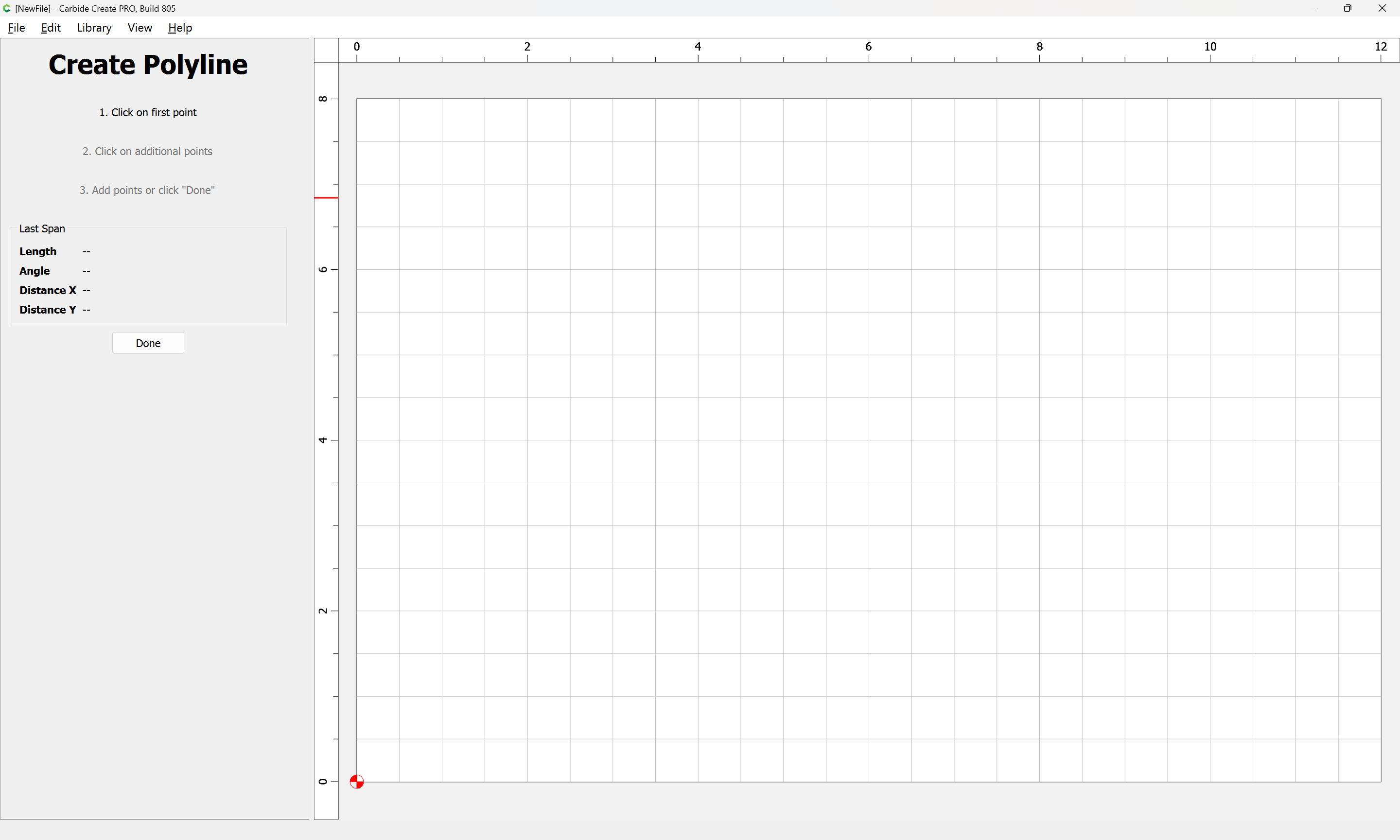

Click at the first point:

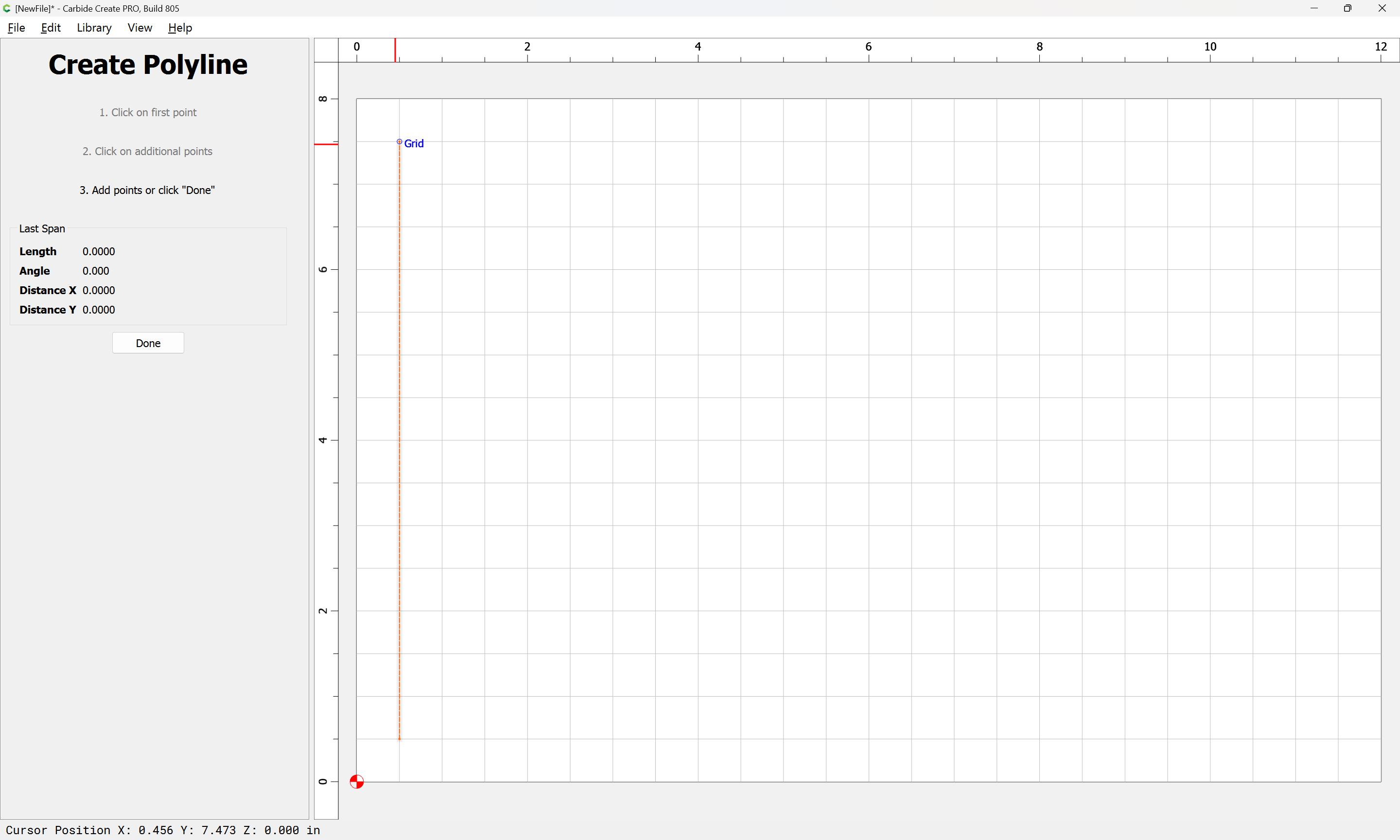

Move to the second and click again:

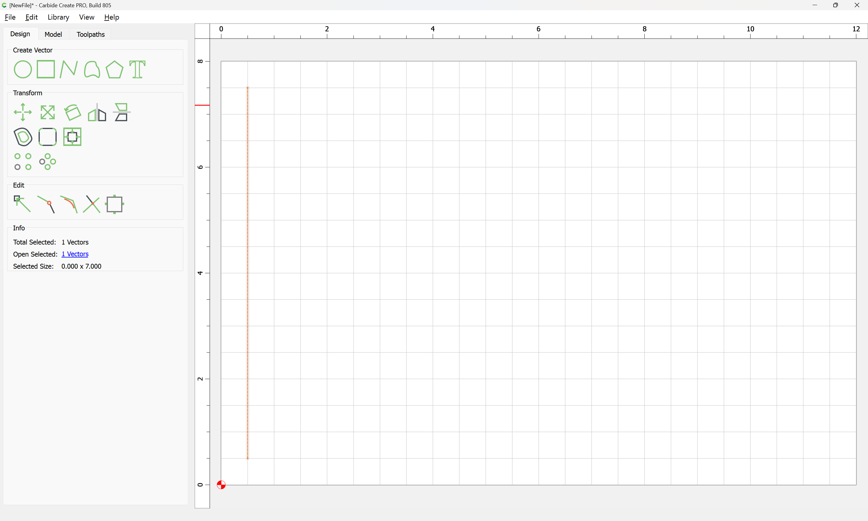

Click “Done”

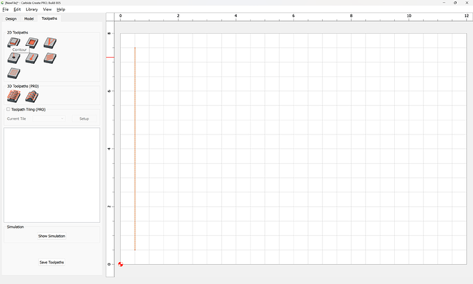

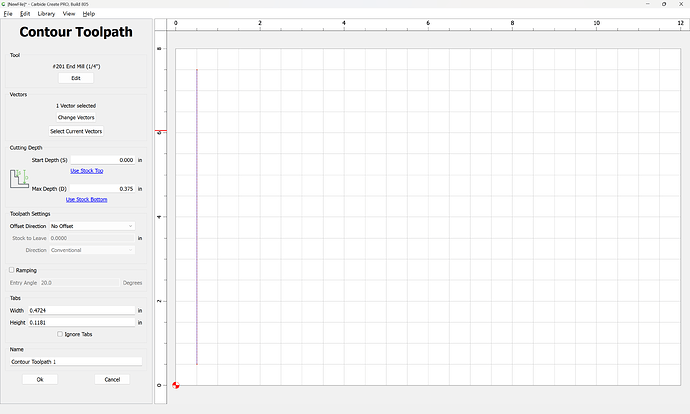

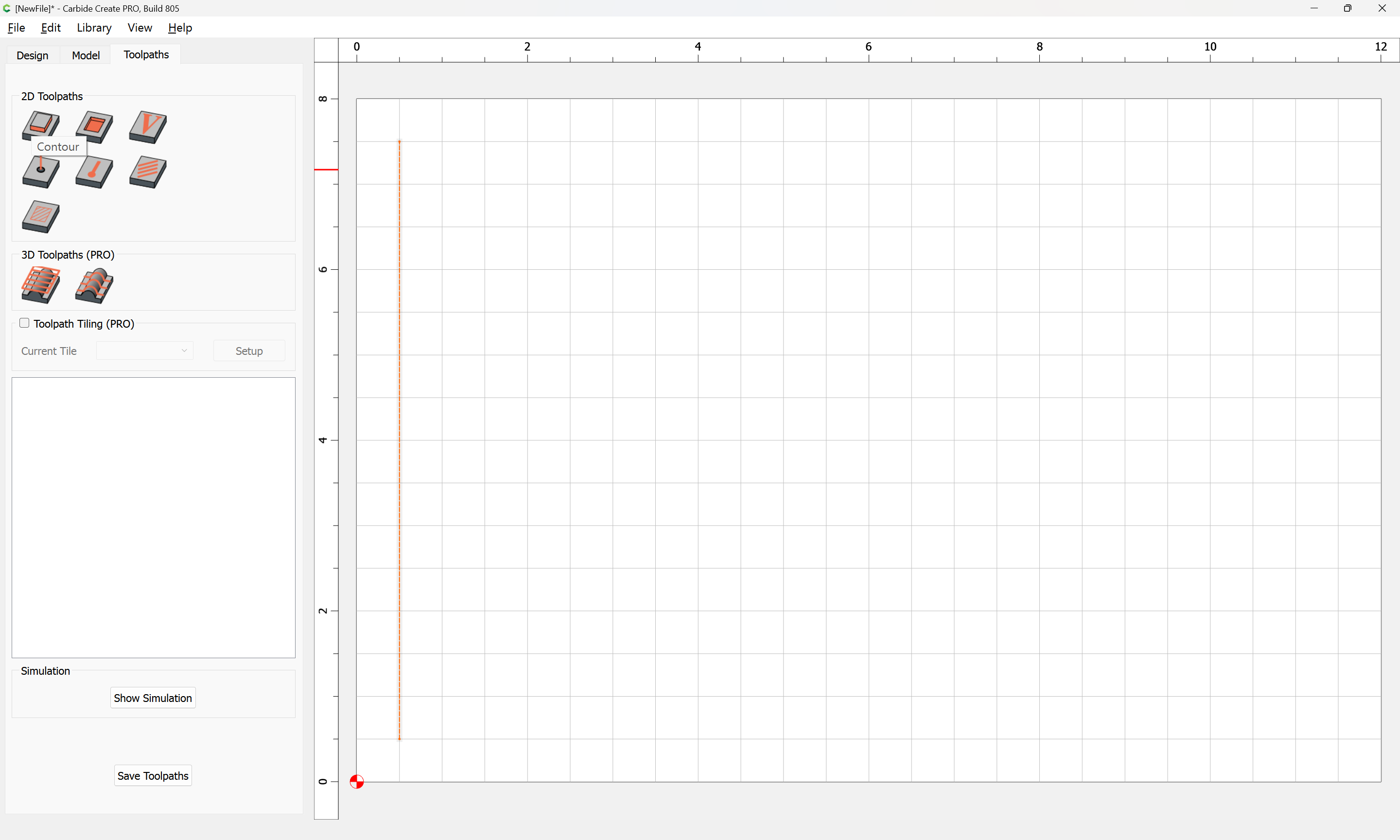

Assign a No Offset Contour toolpath:

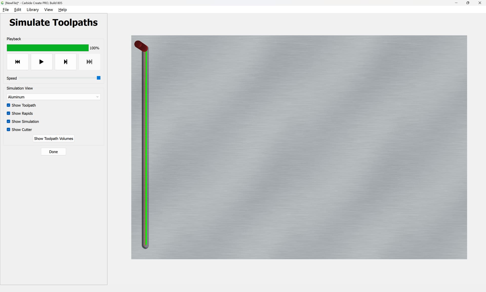

For more on this see:
Very through response. Maximum effort! I appreciate it. I tried it last night and worked great.
