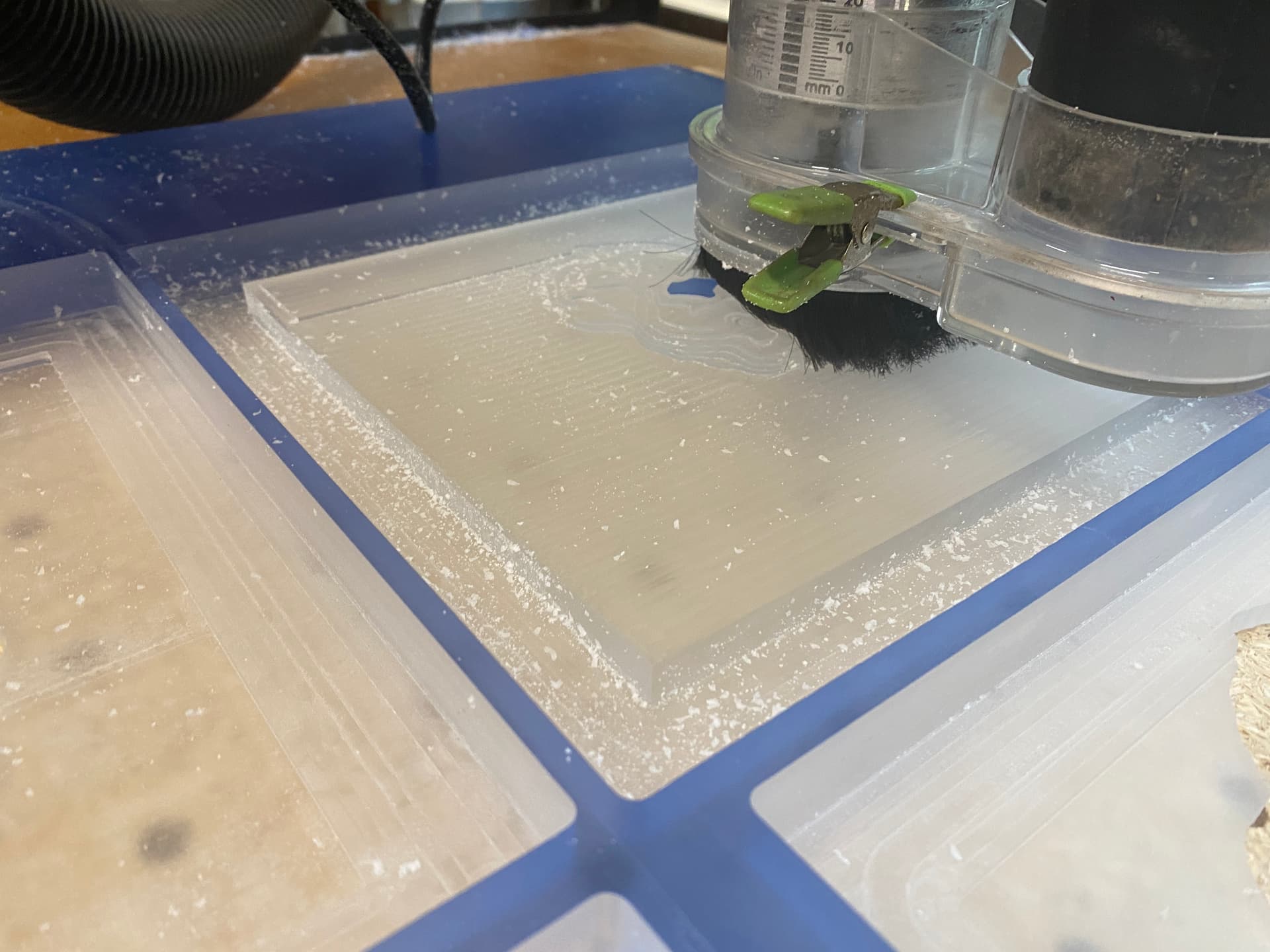

While cutting my acrylic projects, I started getting lost communication to the cutter. Two days ago, I turned of all other apps, including CCPro and the error continued another couple of times.
Yesterday, I additionally turned off the Norton 360 AND disconnected from the internet totally. The machine ran ok, all day today, UNTIL I quick and stopped the machine.
I reinitalized it and left for about 30 mins. Came back and the screen message said communication lost with cutter. or some such verbage.
I had not received these messages before Monday this week, which, BTW, I received a Windows update/load. Maybe conwinsidence, but ???
