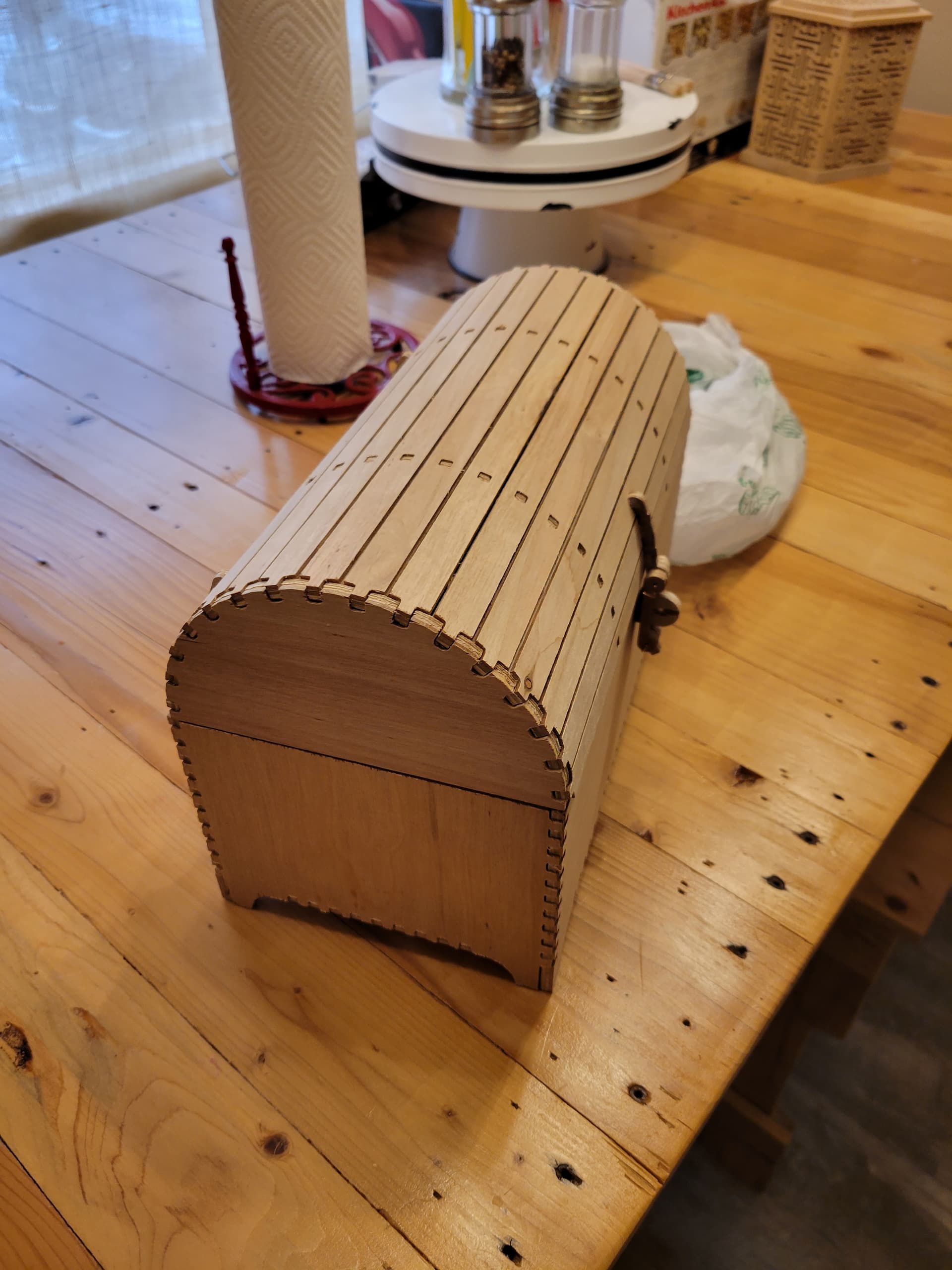

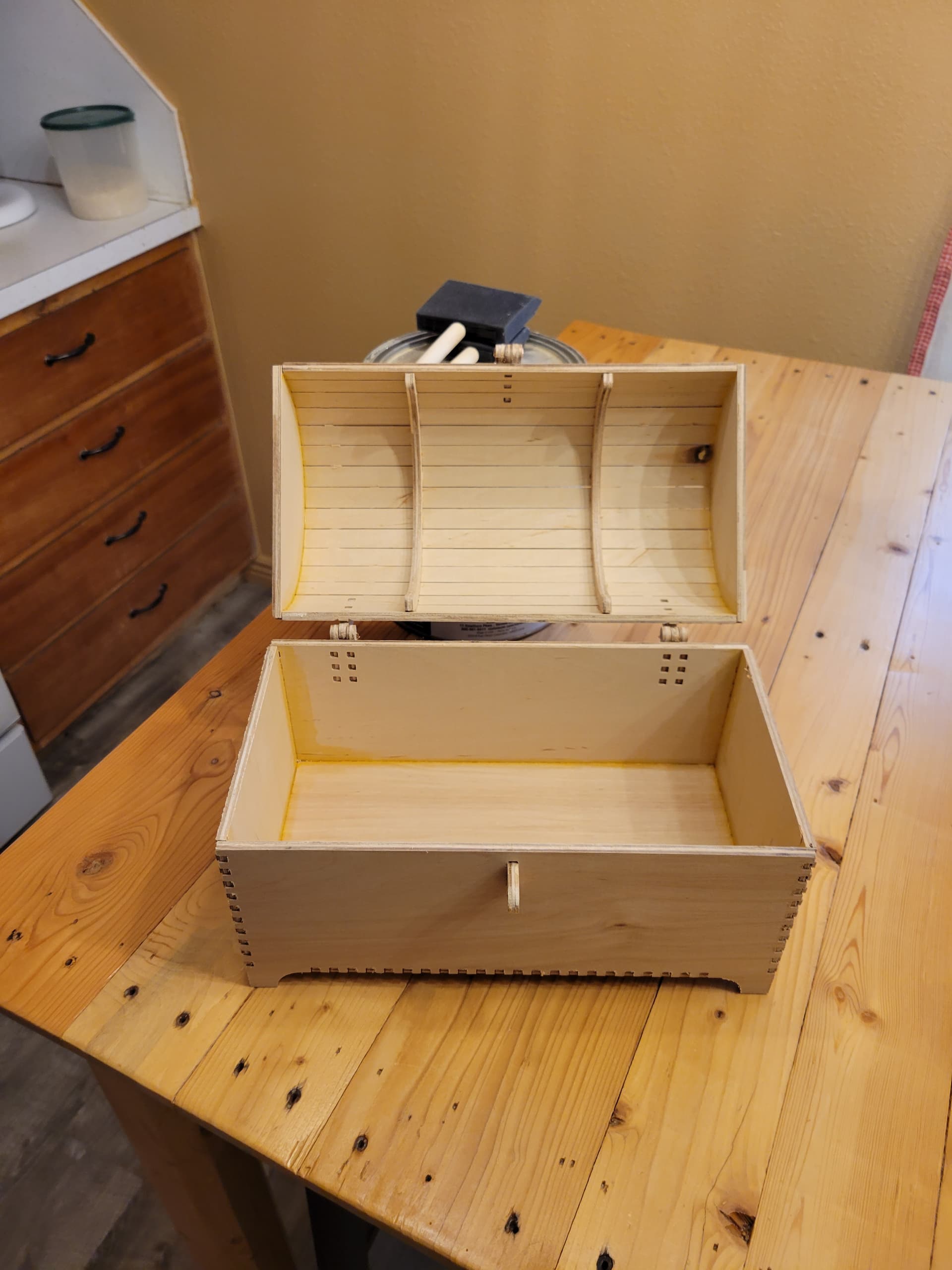

Ive had this issue as well plywood can be a nightmare with chipping and splintering. My most recent project was a small teasure type chest i cut using 4mm birch plywood. I got some down sprial 1.5mm bits via Amazon and that helped with the chipping a little bit. Then i got thinking. I tend not to stain wood as i like the natural look, so before i cut the second box i coated the sheet with varathane indoor water based poly. (Home depot at arounf 24 bucks a gallon) Just used a sponge roller and applyed a rather thick coat. That product dries in 2 hours. Sanded lightly with 220 to remove the bubbles applyed a second the same way, then knocked the bubbles down with a brush. Sanded a second time just to smooth it out, then went to cutting. The parts turned out beautiful. I only had some splintering when i assembled the parts and that was very minimal. Mostly due to the rou ded corners in the pockets where pieces had to slide in
Here a link for the bits
https://a.co/d/aj2ZDcm
Cutting speed 40 inch a min
Depth .050 per pass
Spindle speed 18000
40 inchs a min seems ro be the sweet spot for these bits i broke 1 at 60 and another at 50

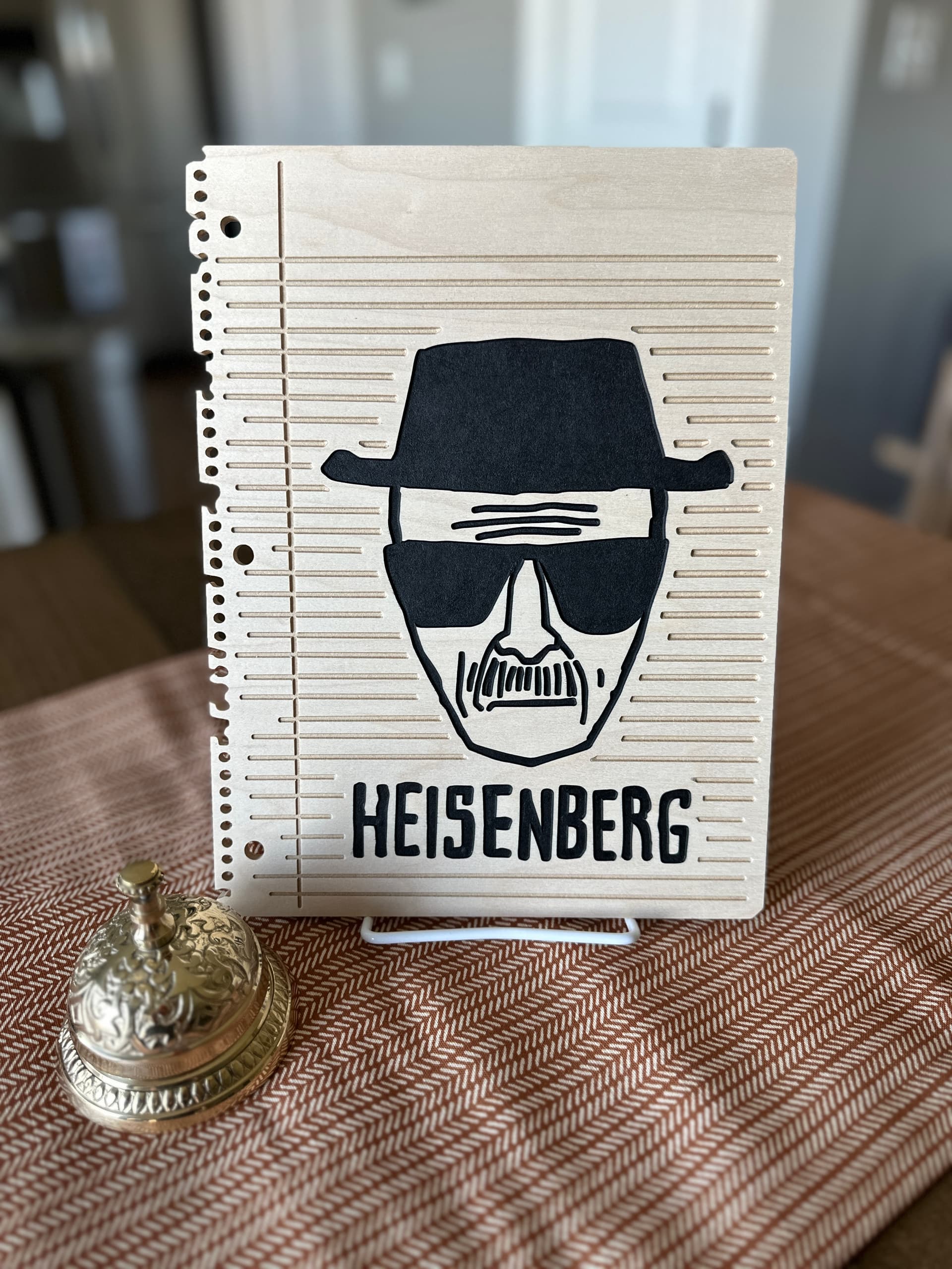

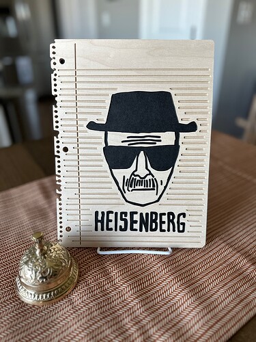

Here is a project I made thanks to the great advice about getting good quality plywood! This was rotary cut, which I hadn’t heard of before. It made a lot more mess in my enclosure. And, had a fuzzy kind of MDF feel when carved. But it painted well!
What’s a rotary cut ?..
They rotate a log and continuously shave off a full continuous sheet. I hadn’t heard of this before and the guy at my local supplier gave me a pretty unhelpful explanation, so I had to google it. The cut areas don’t really display grain and look a bit like MDF, unlike the surface. It cut beautifully though!
