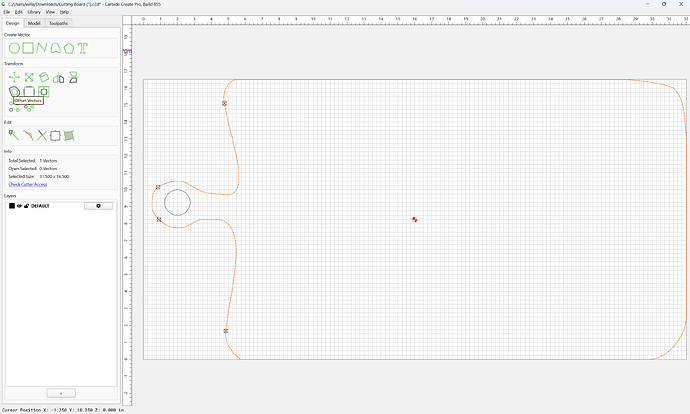

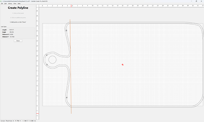

I’m trying to create a cutout for a live-edge cutting board, but I’m getting hung up on how to have only the handle cut out.
Where the file is:

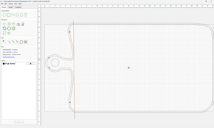

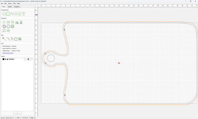

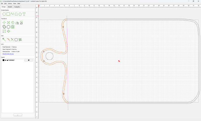

In the design tab, select the outline:

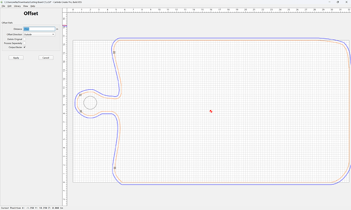

and offset to the outside by endmill diameter plus 10%:
Apply

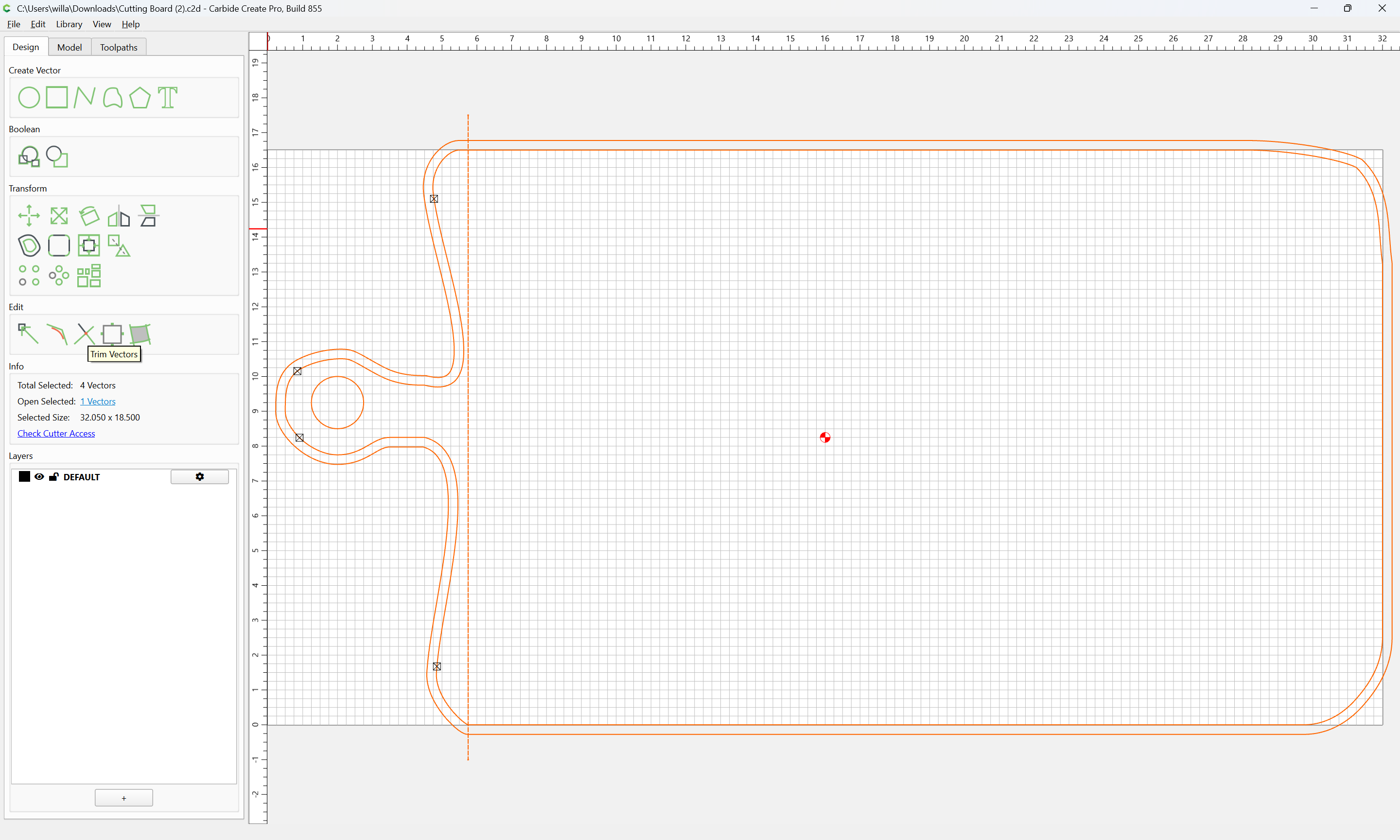

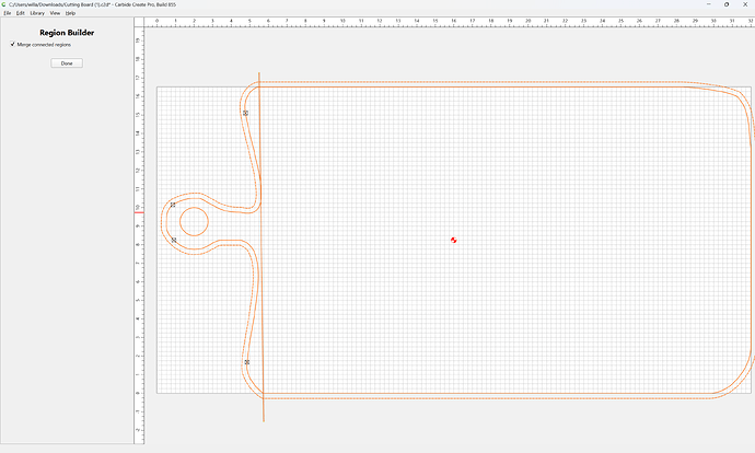

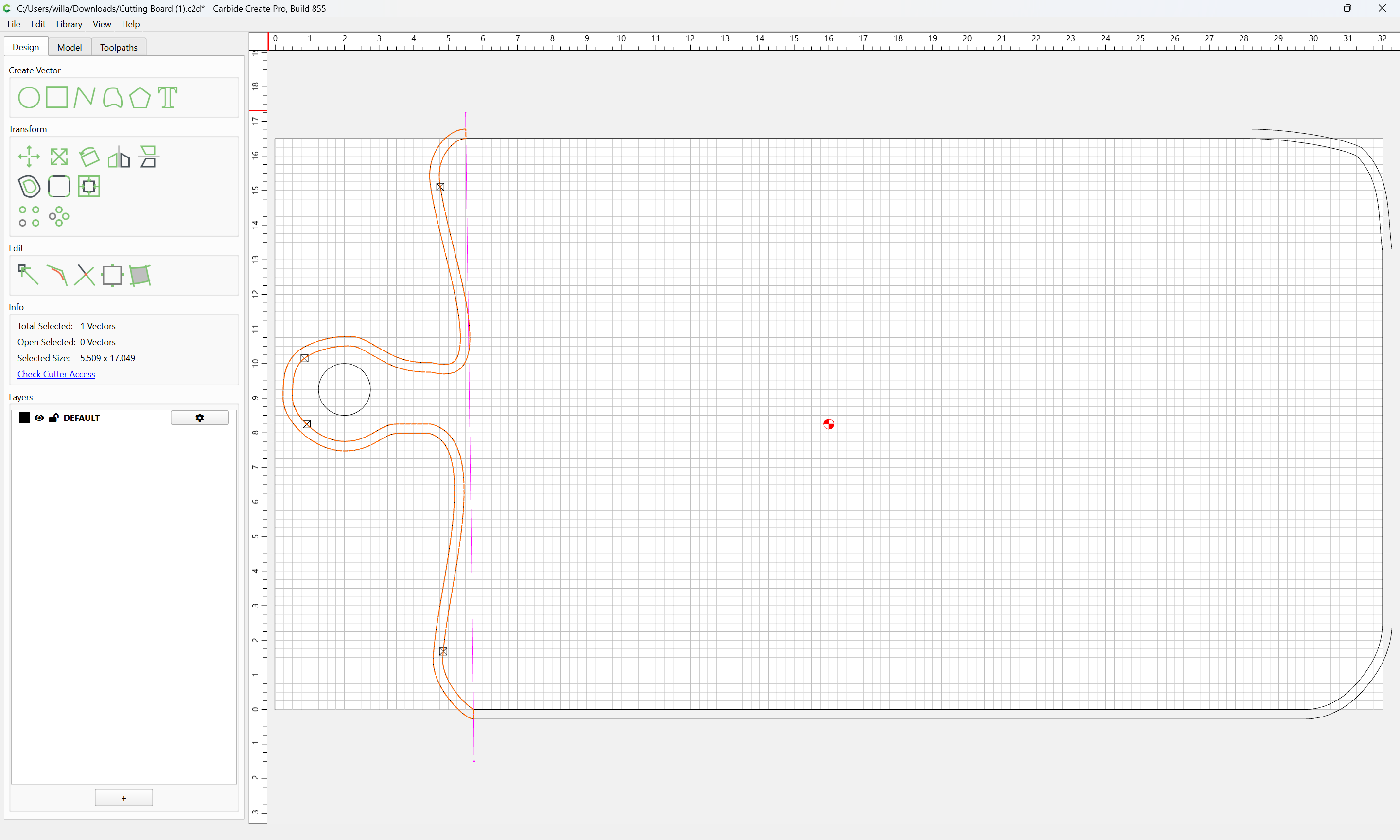

Then draw geometry to define where one wants the cut to begin/end:

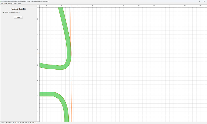

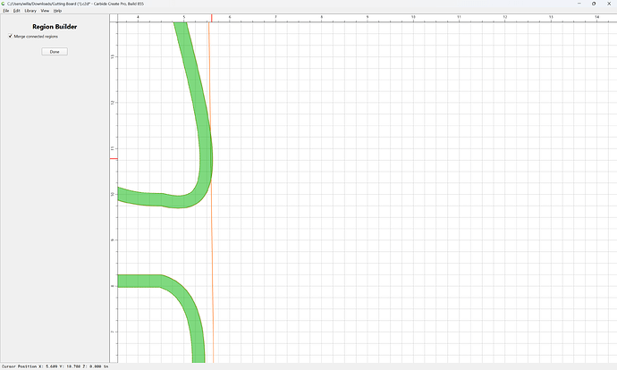

Done

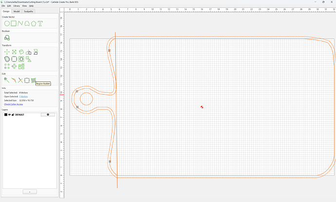

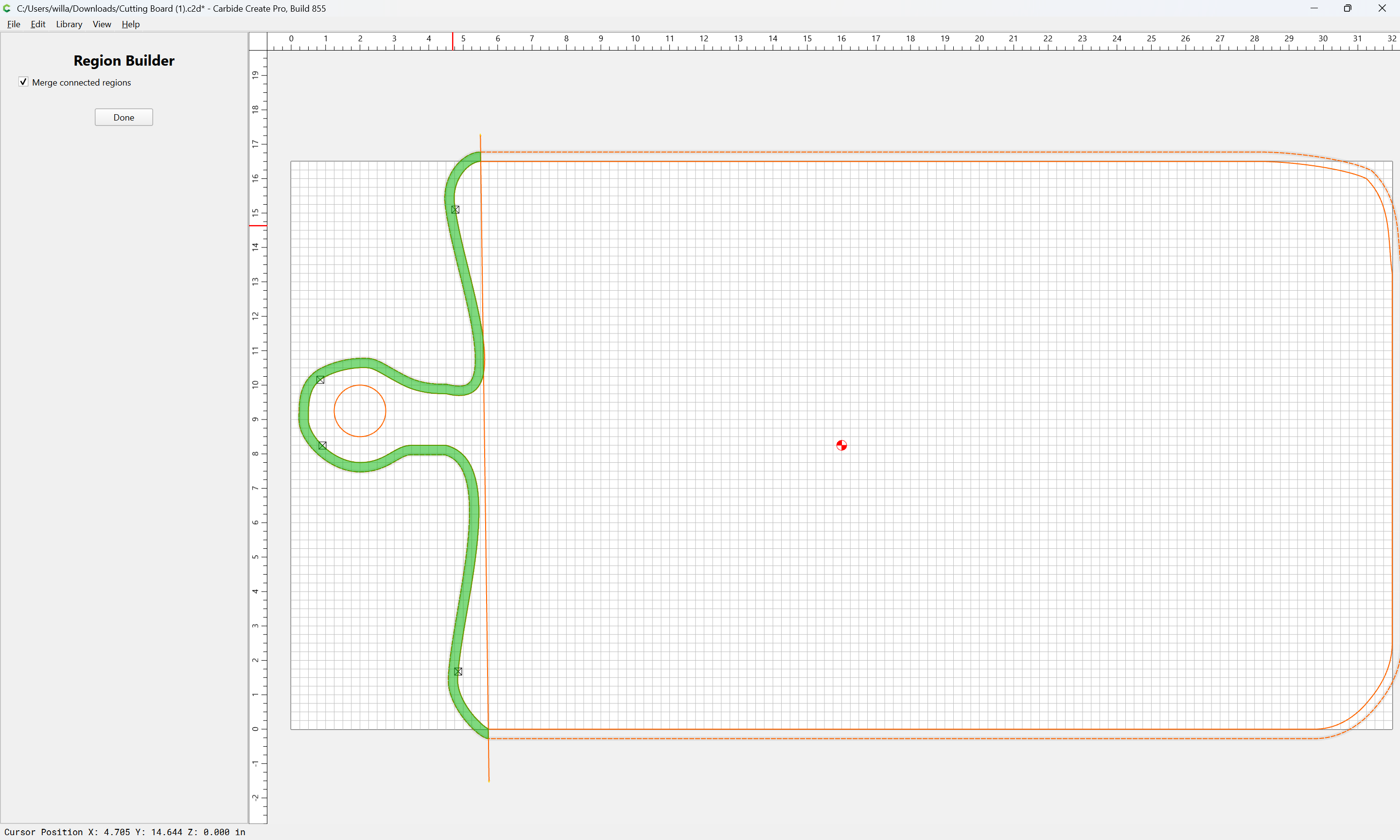

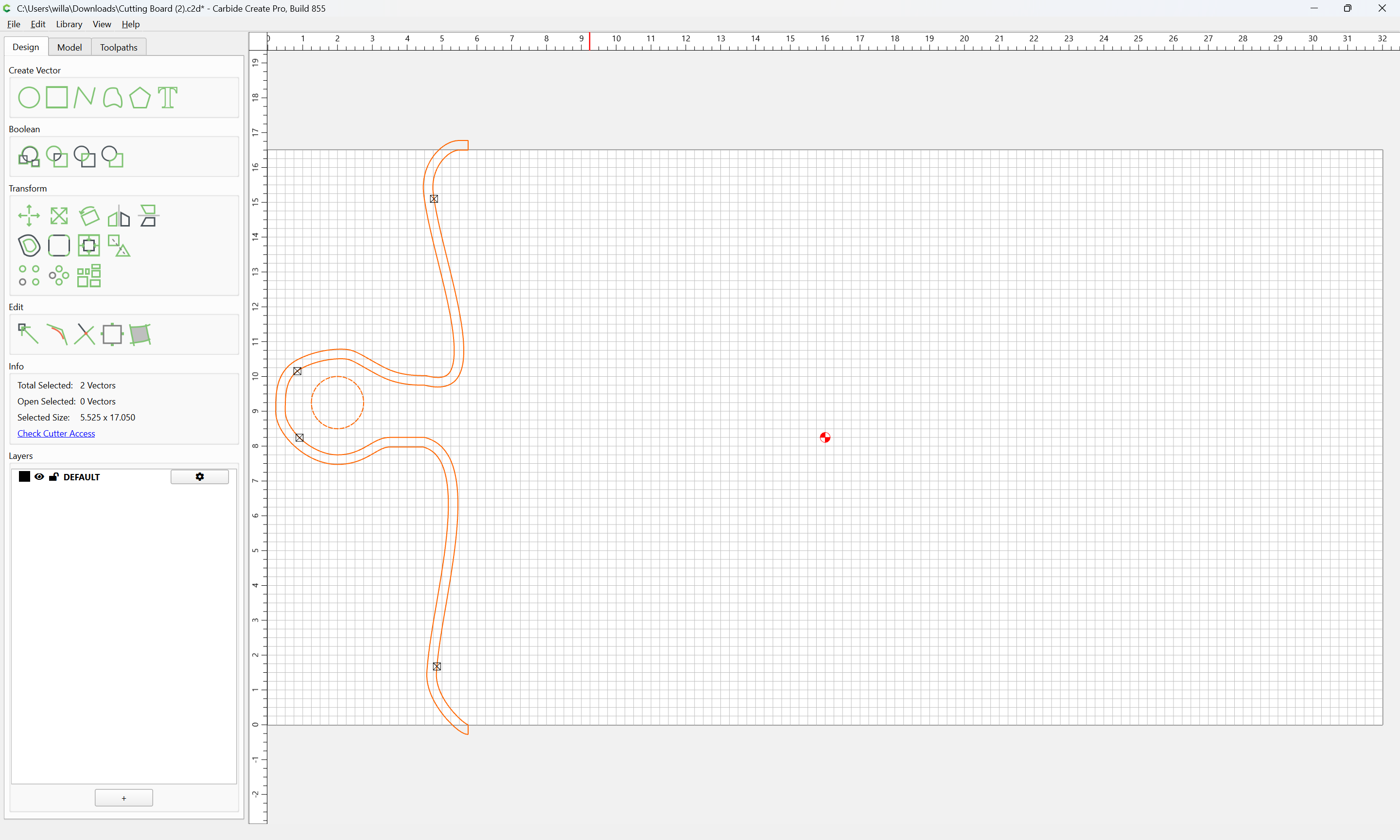

Select everything:

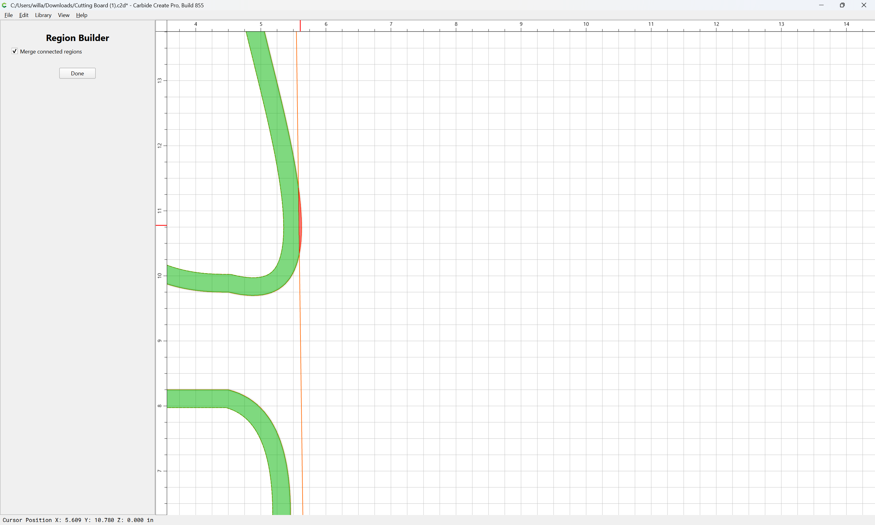

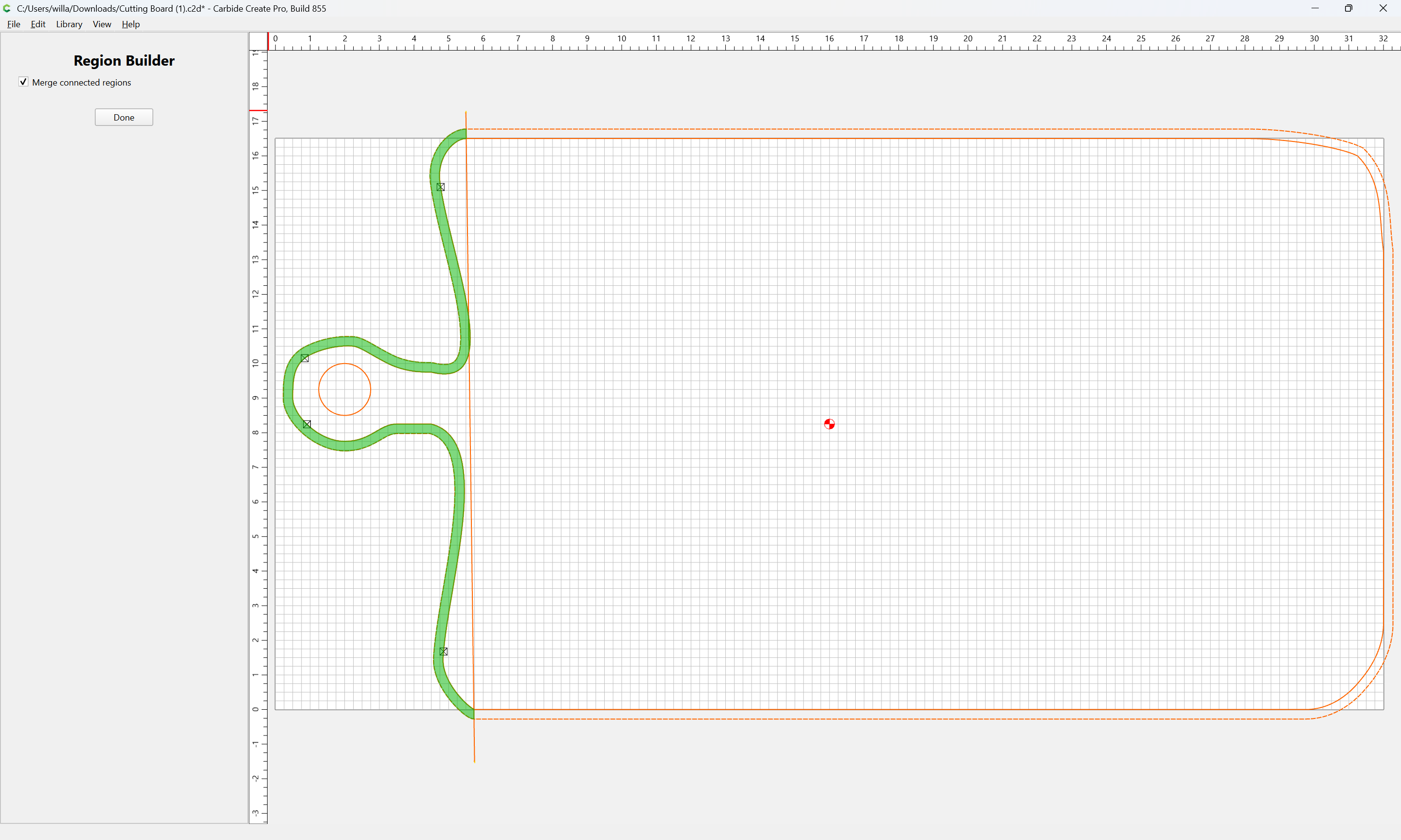

and use Region Builder
Yes

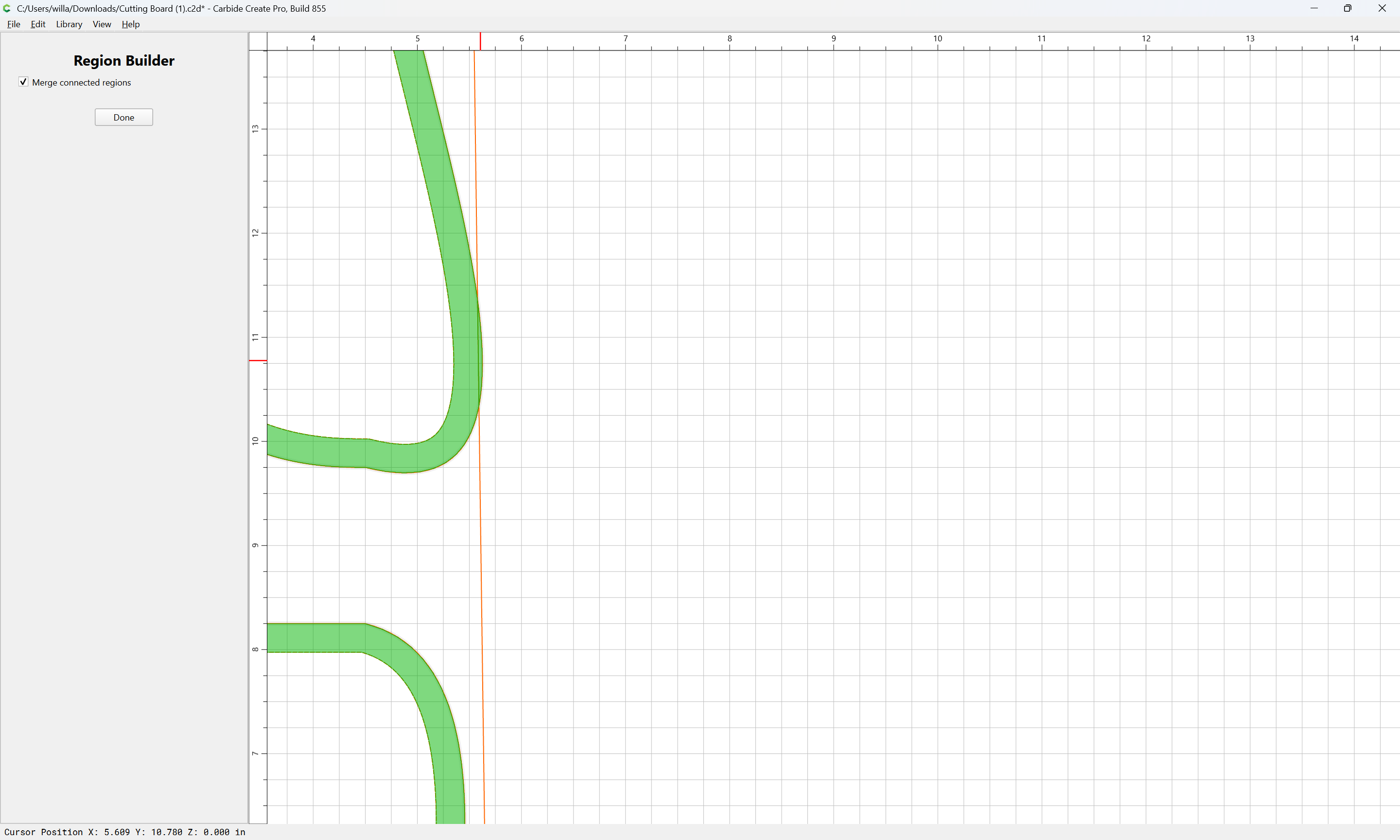

to build the cut are desired:
Done

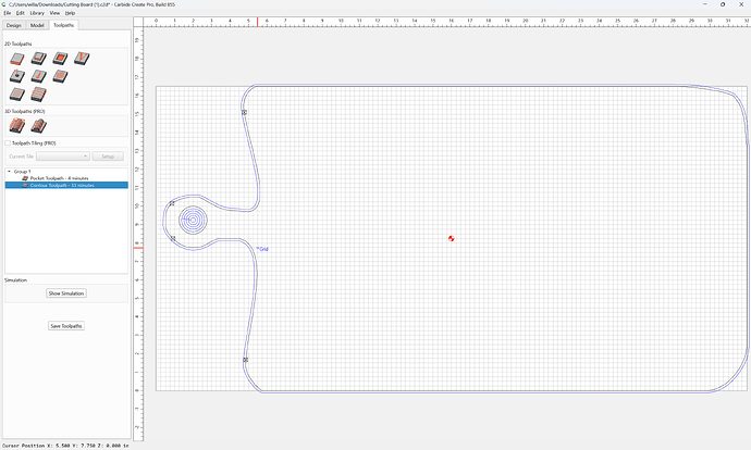

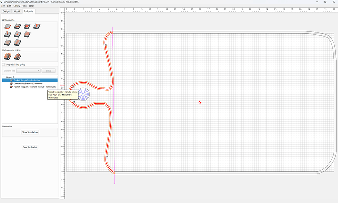

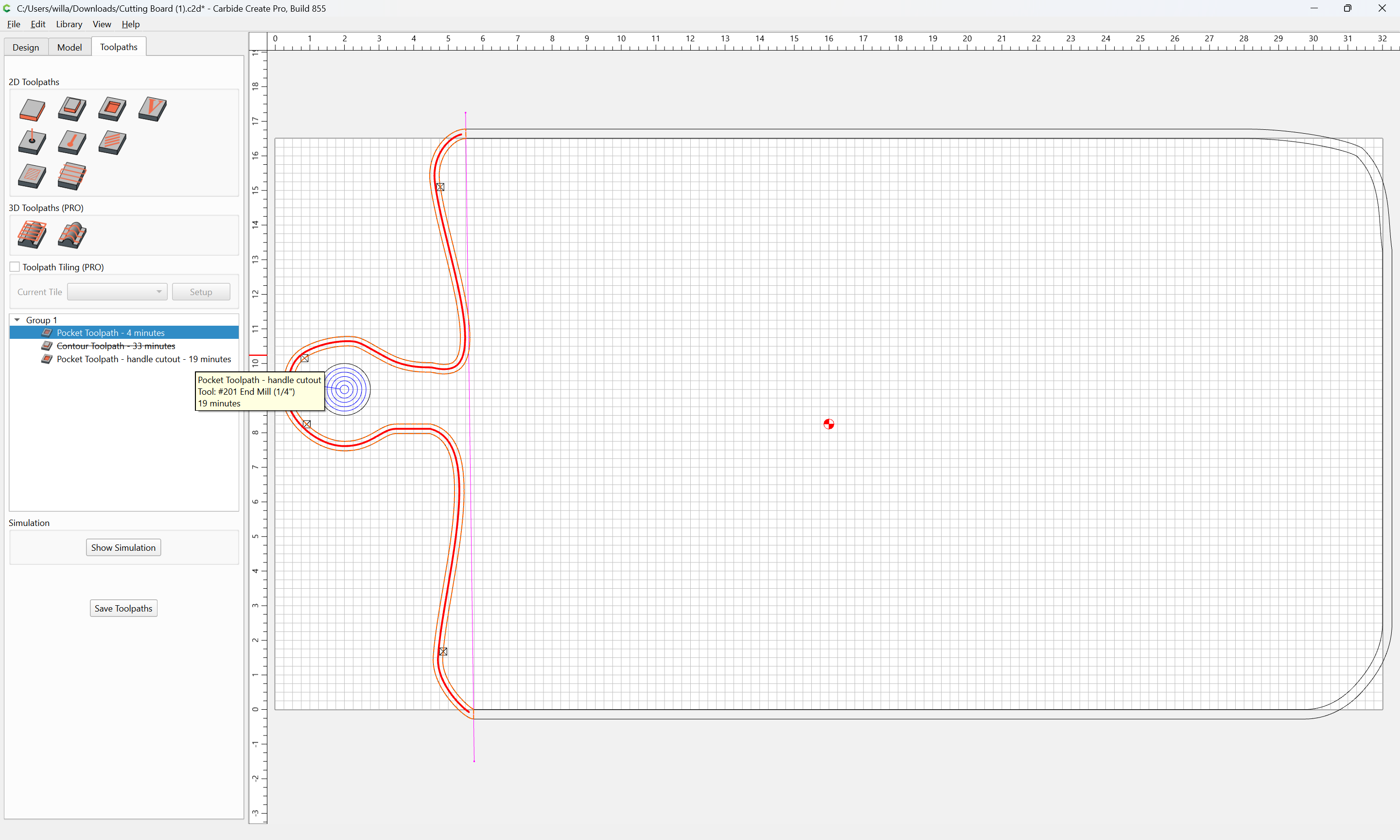

Assign a Pocket Toolpath:
Very interesting. I had never even clicked on that “Region Builder” before.

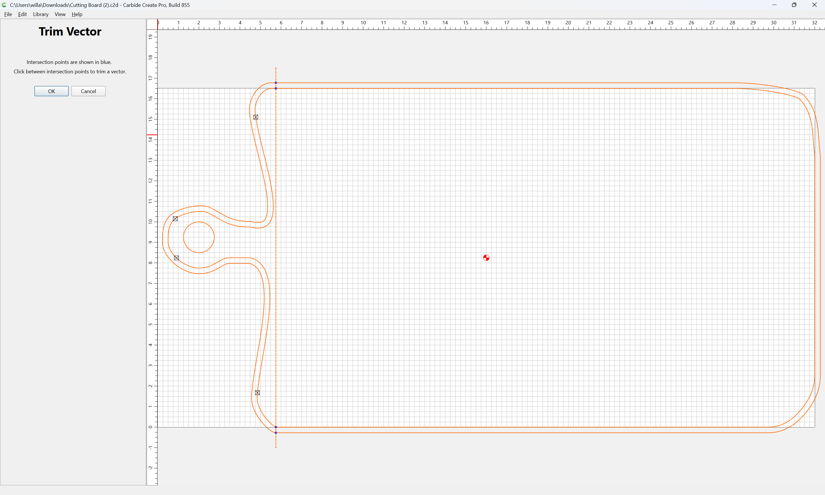

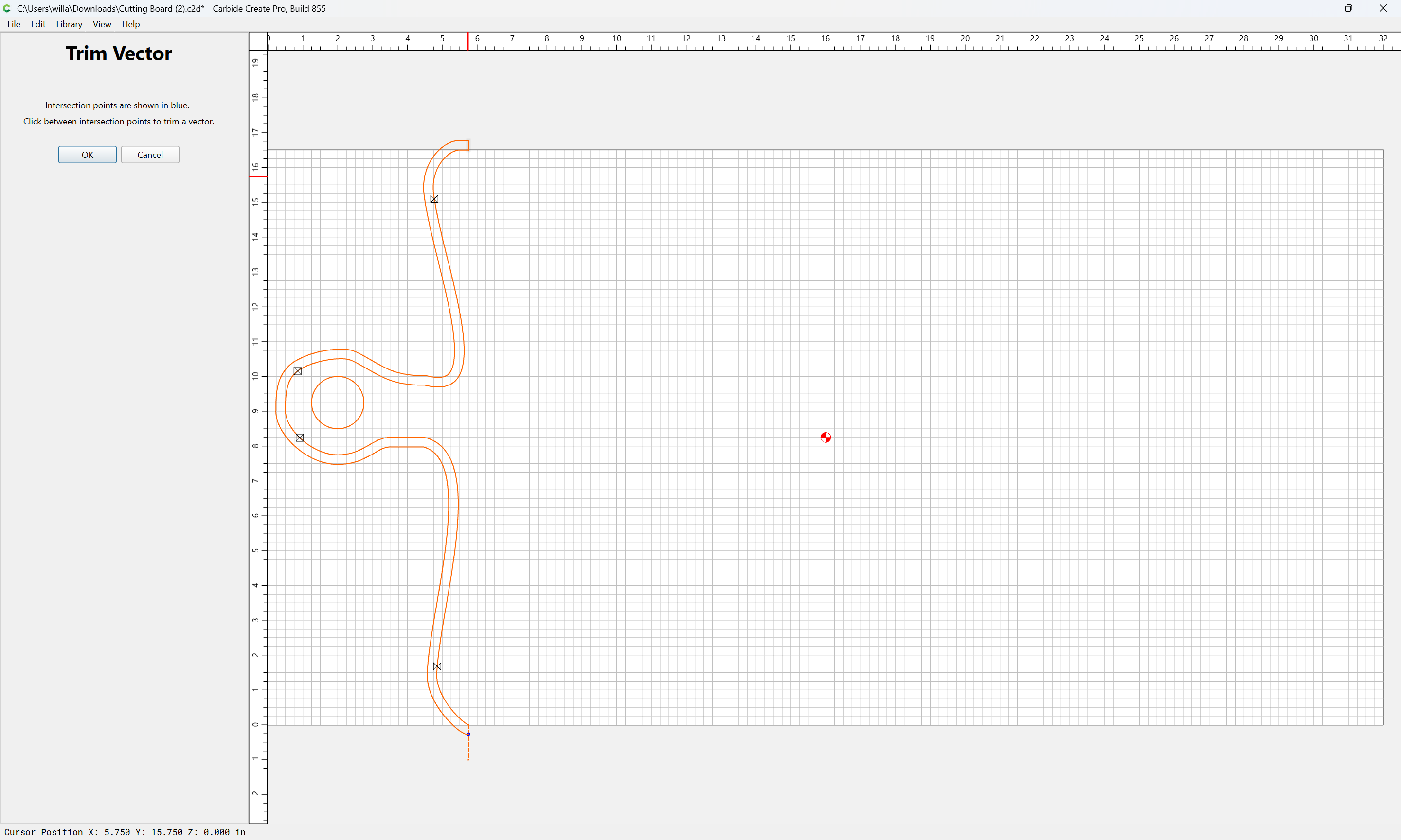

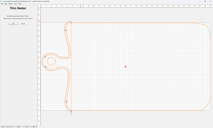

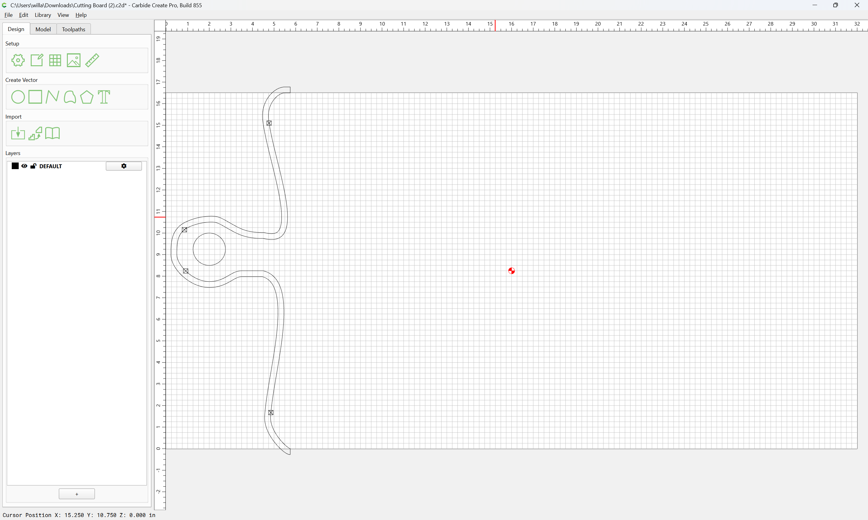

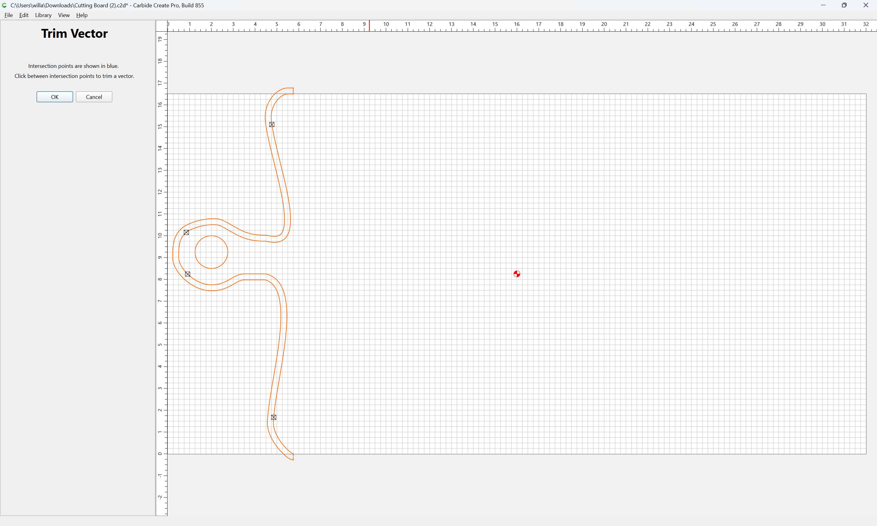

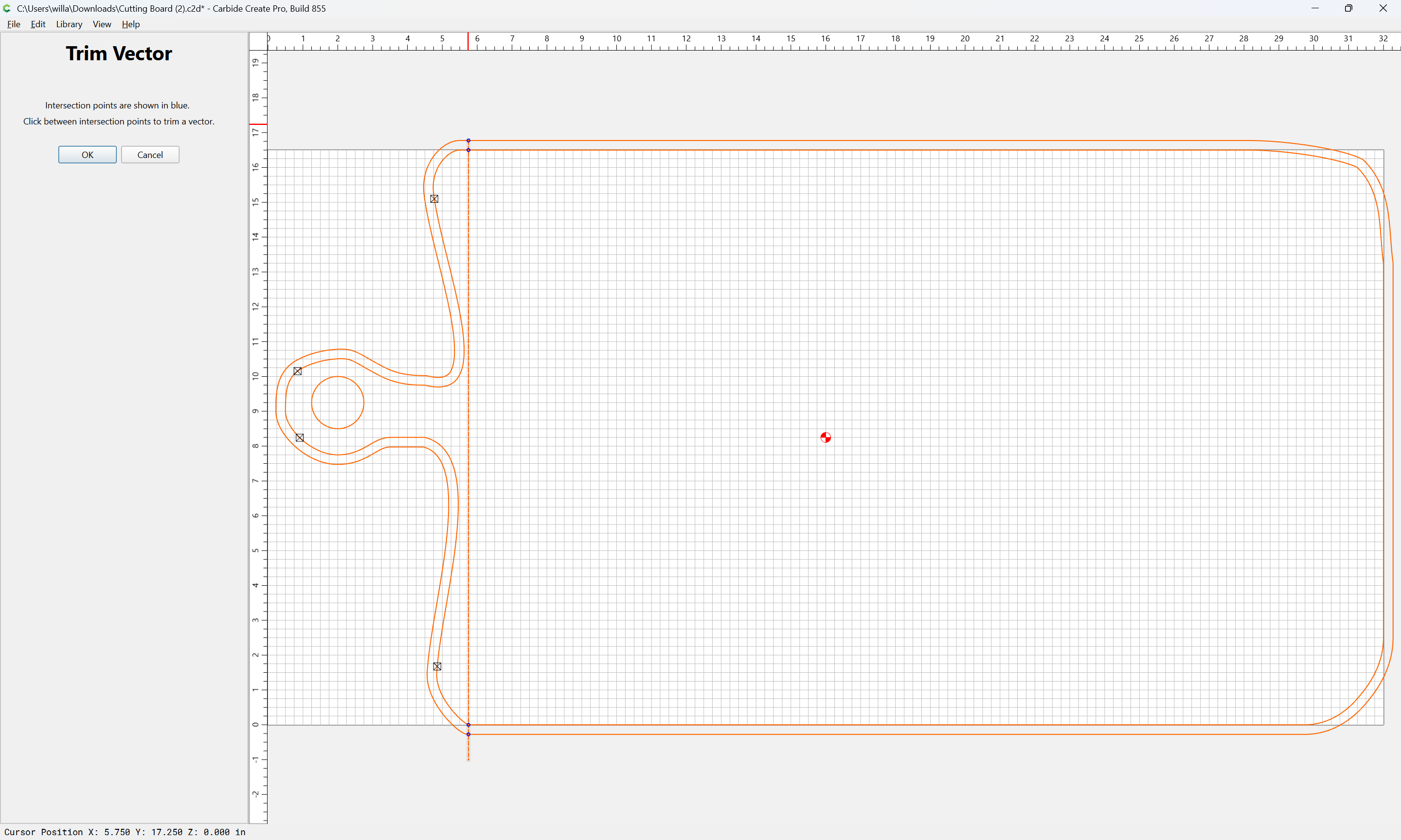

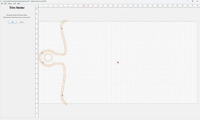

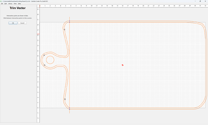

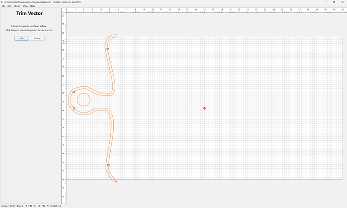

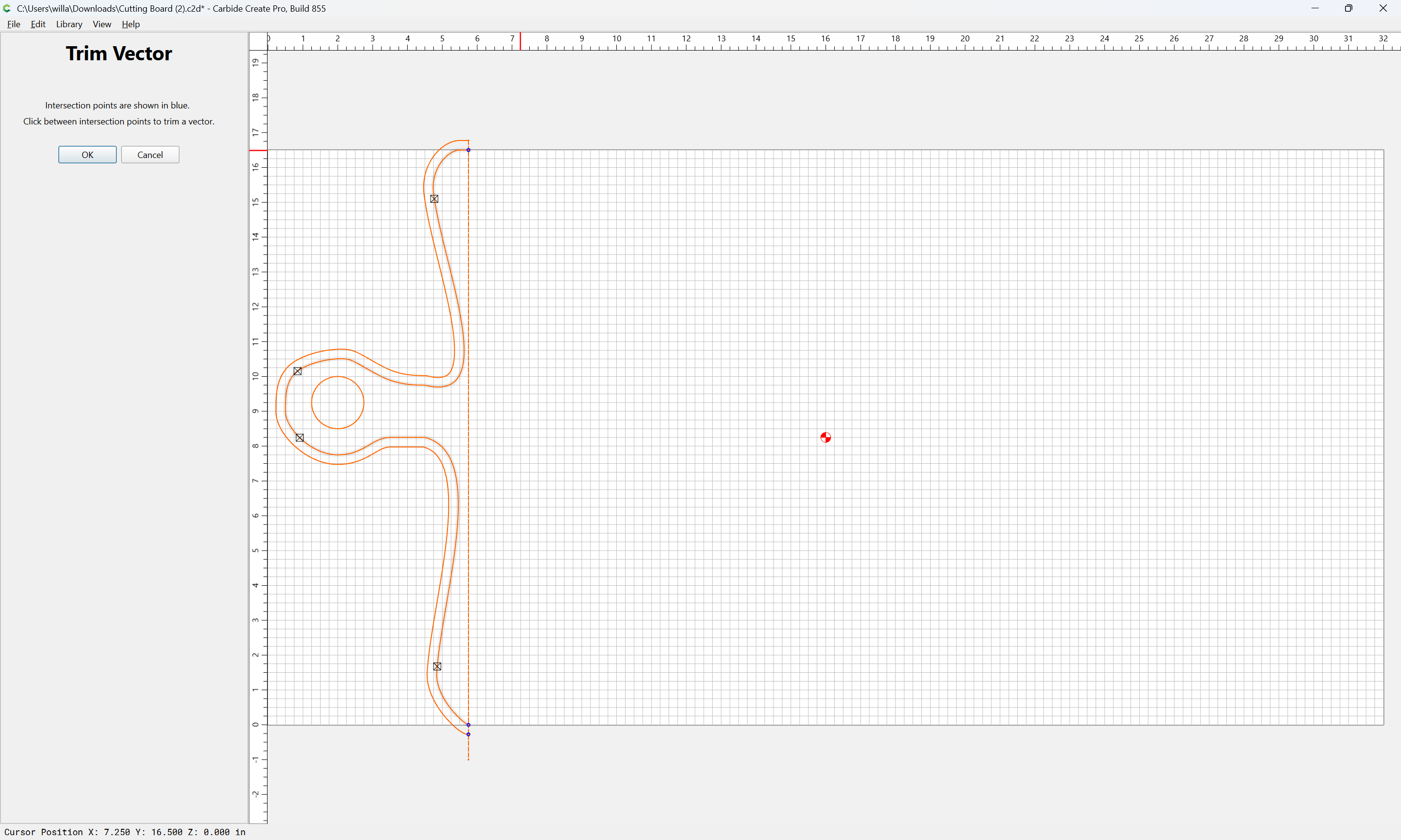

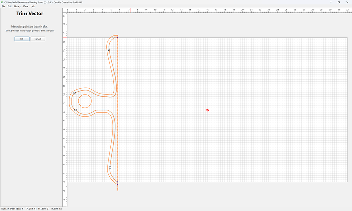

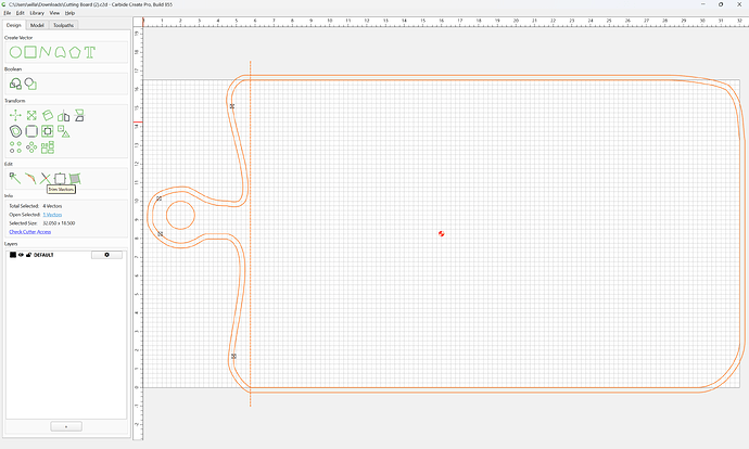

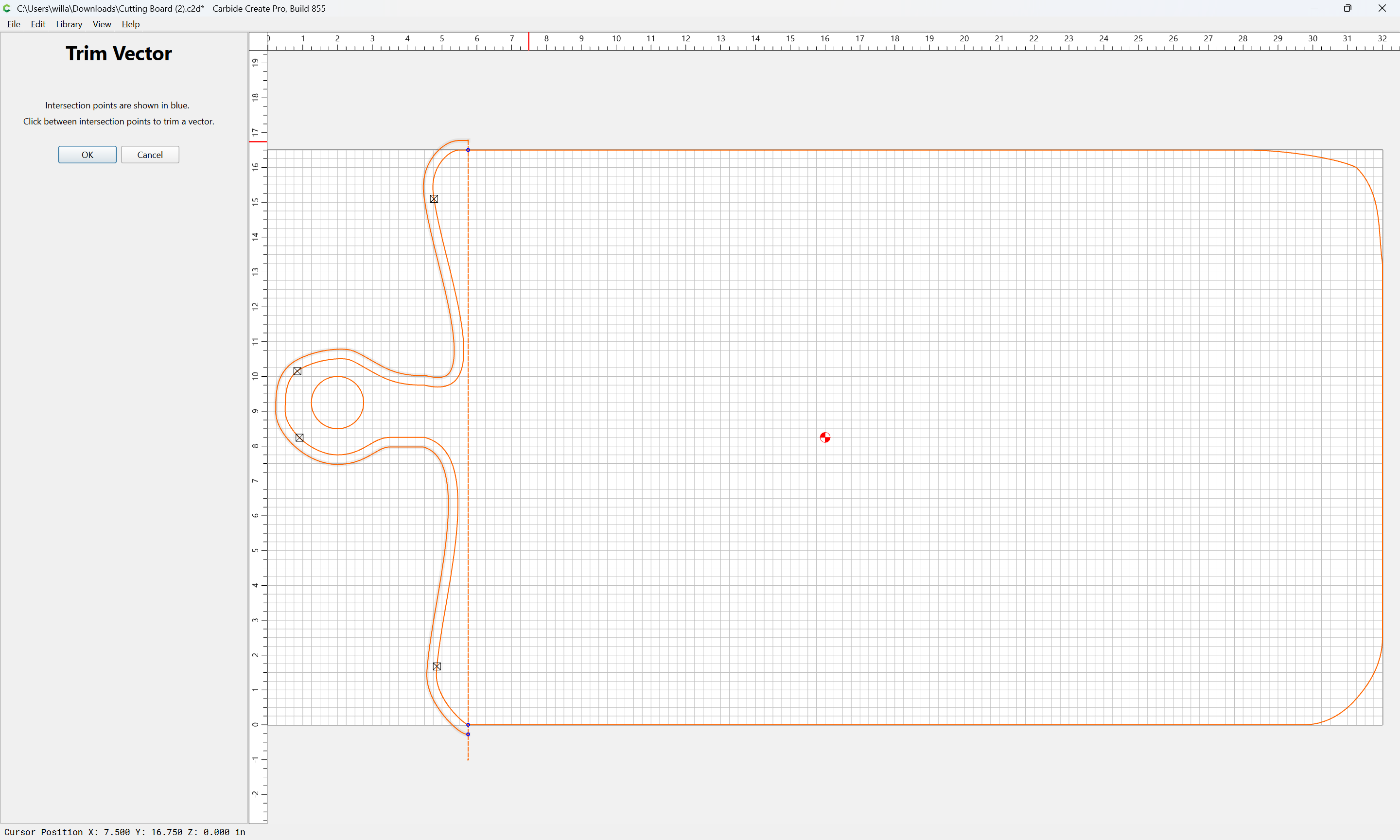

Or, do it using Trim Vectors:
OK
OK

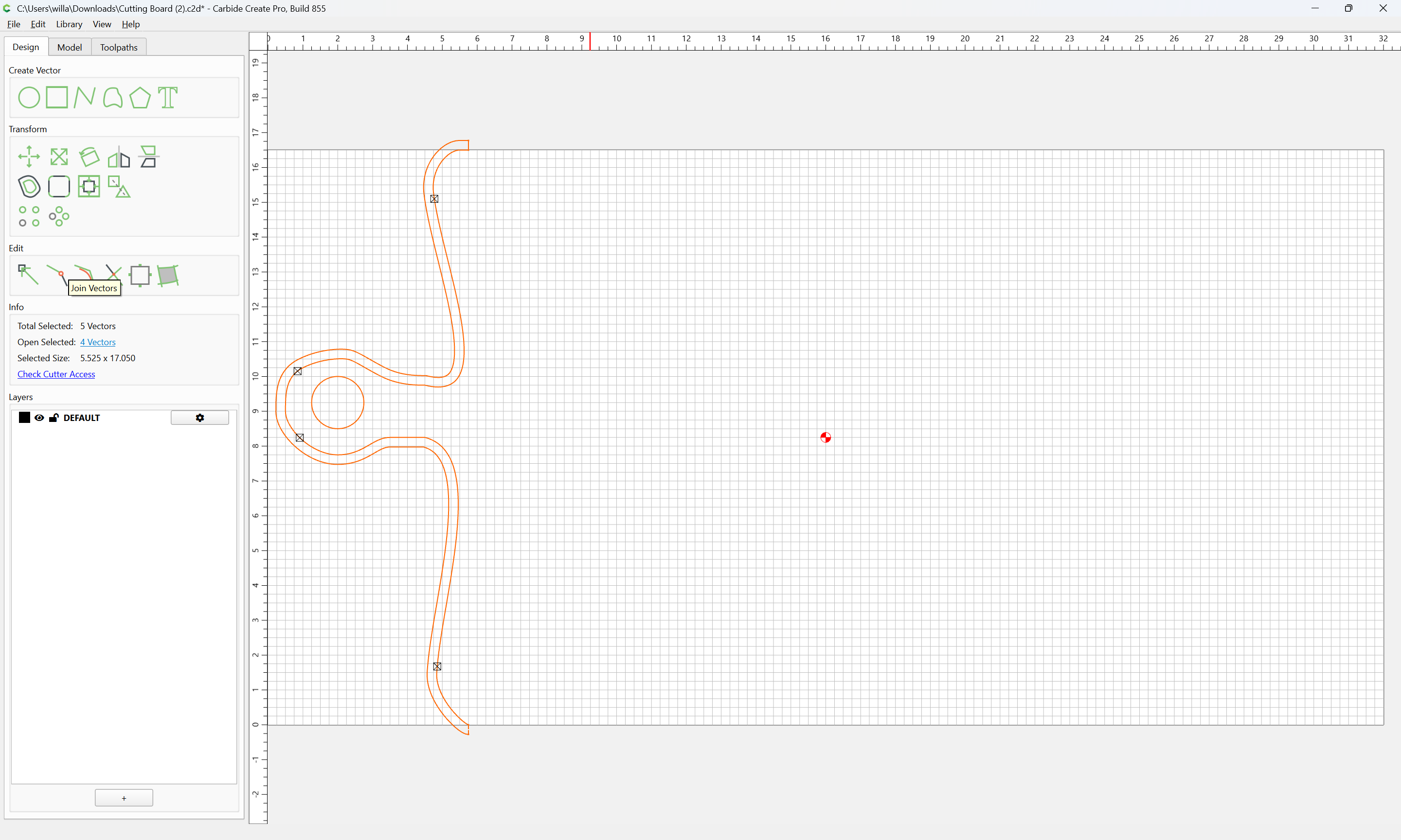

Join Vectors
Yes
apply toolpaths as before.
