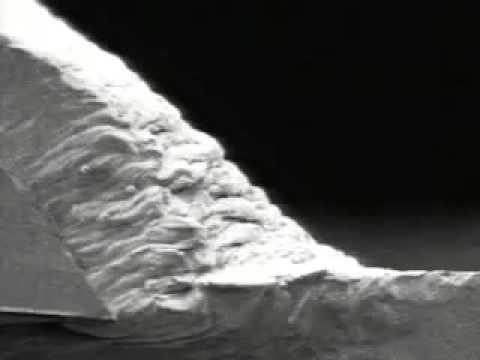

Wow! Thatâs beautiful. You can see the changes that coatings make and that materials make. Thanks for finding and sharing that @Julien.
Cool, chip pornâŚI watched it twice, so far.
That is a fascinating video. Also, now I really want some ice cream.
Pretty cool but what is it? ![]()
