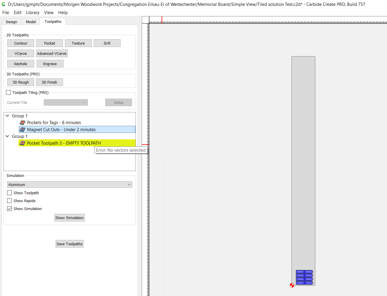

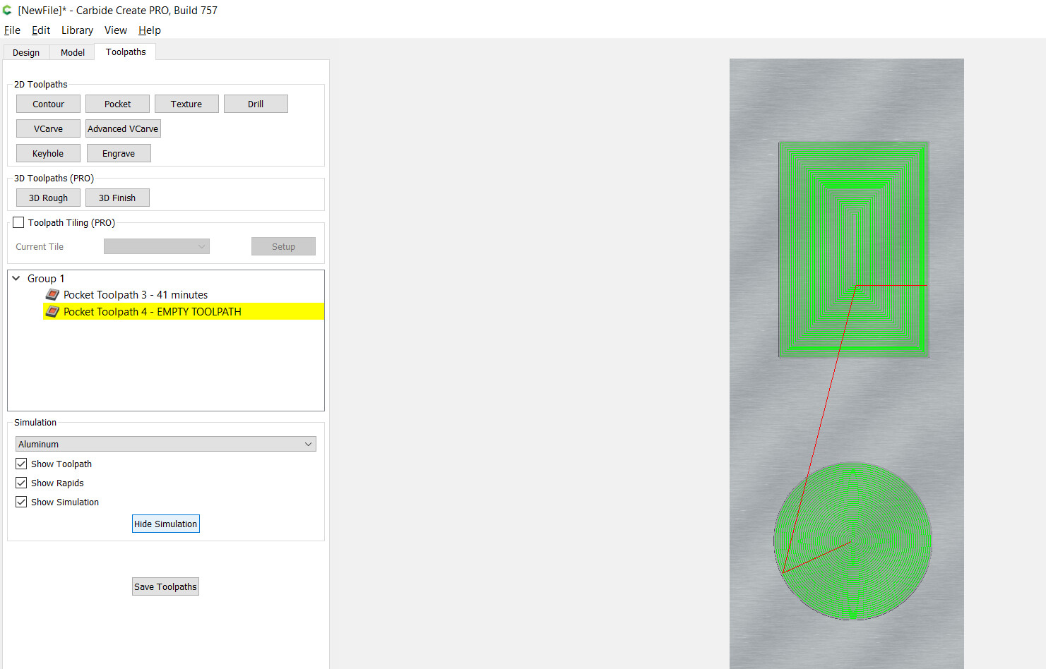

Found this strange defect in the Simulation code.

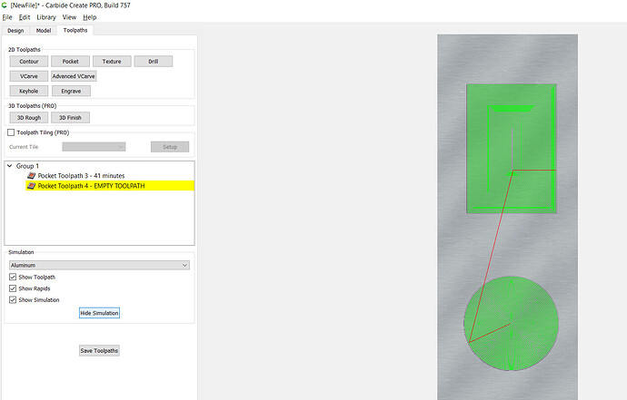

Situation:

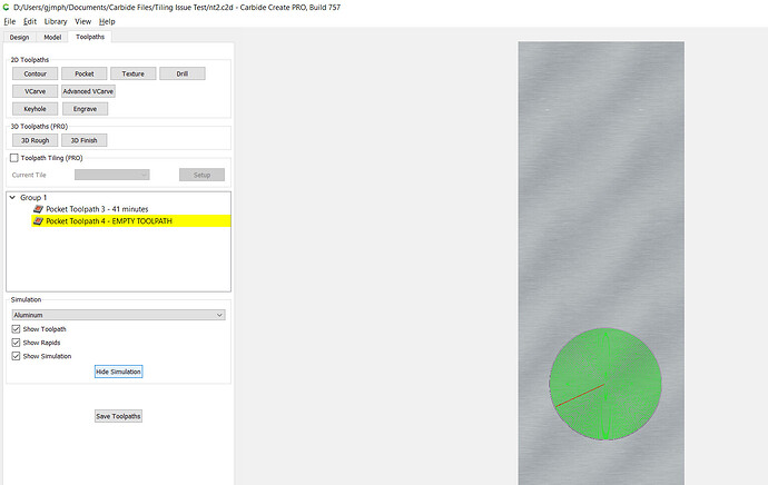

I deleted objects from the design that had toolpaths associated with them. I did not delete the toolpaths. Therefore, they showed up as empty (as expected).
However, upon Show Simulation, the toolpaths show up (notches on left side of board):
Those vectors do not exist in the code and the toolpath is “empty”…but they are still being cut (not sure if it would cut if I ran the job or not, but I’m guessing the GCODE is in there if the simulation is showing it.
  • Gary

    [LATER EDIT]: This problem doesn’t really GO AWAY when you save the file. It is still present when the c2d makes its way to CM — so it’s actually a larger problem than I originally thought. I don’t want this post to cause folks to ignore the error.
OK Will…now it’s getting really funky:

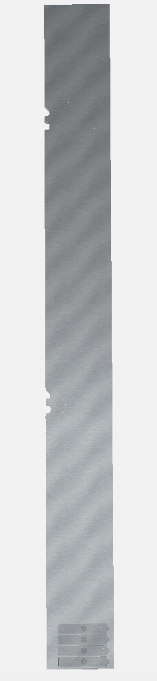

Open it in CC (757) and you will not see those cut outs on the left hand side
Run the simulation : STILL NO cut outs

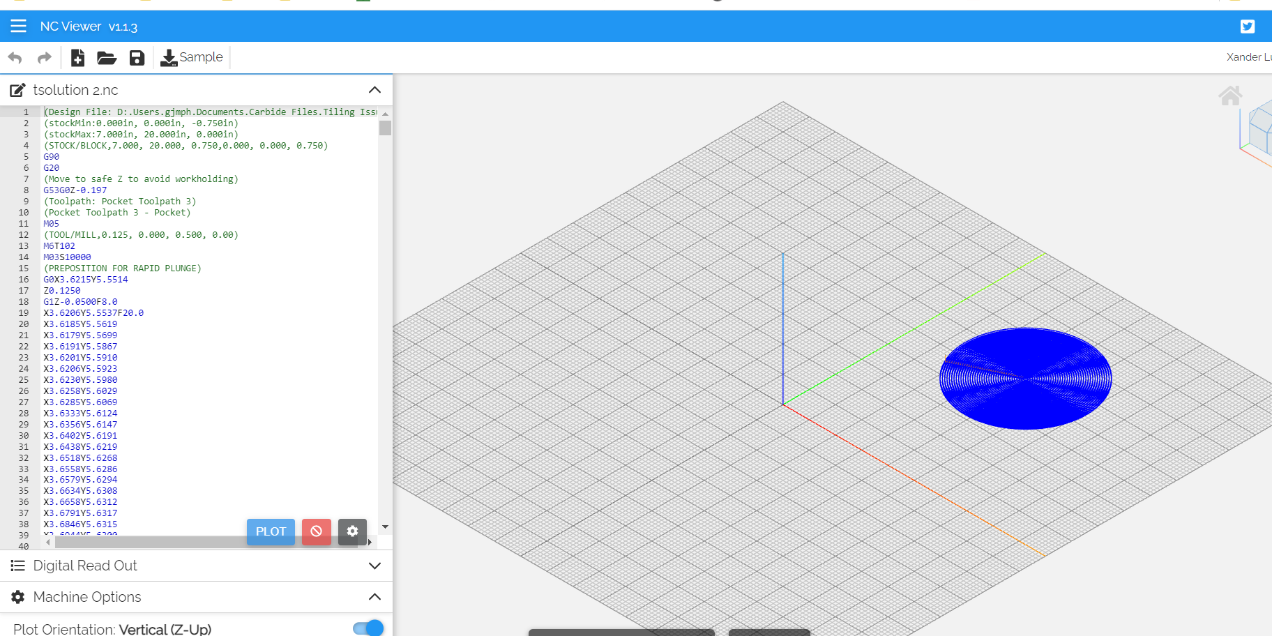

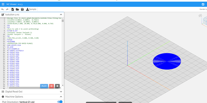

I exported the GCODE into a GCODE-only file and ran it through NCViewer and I DON’T SEE THE SLOTS.

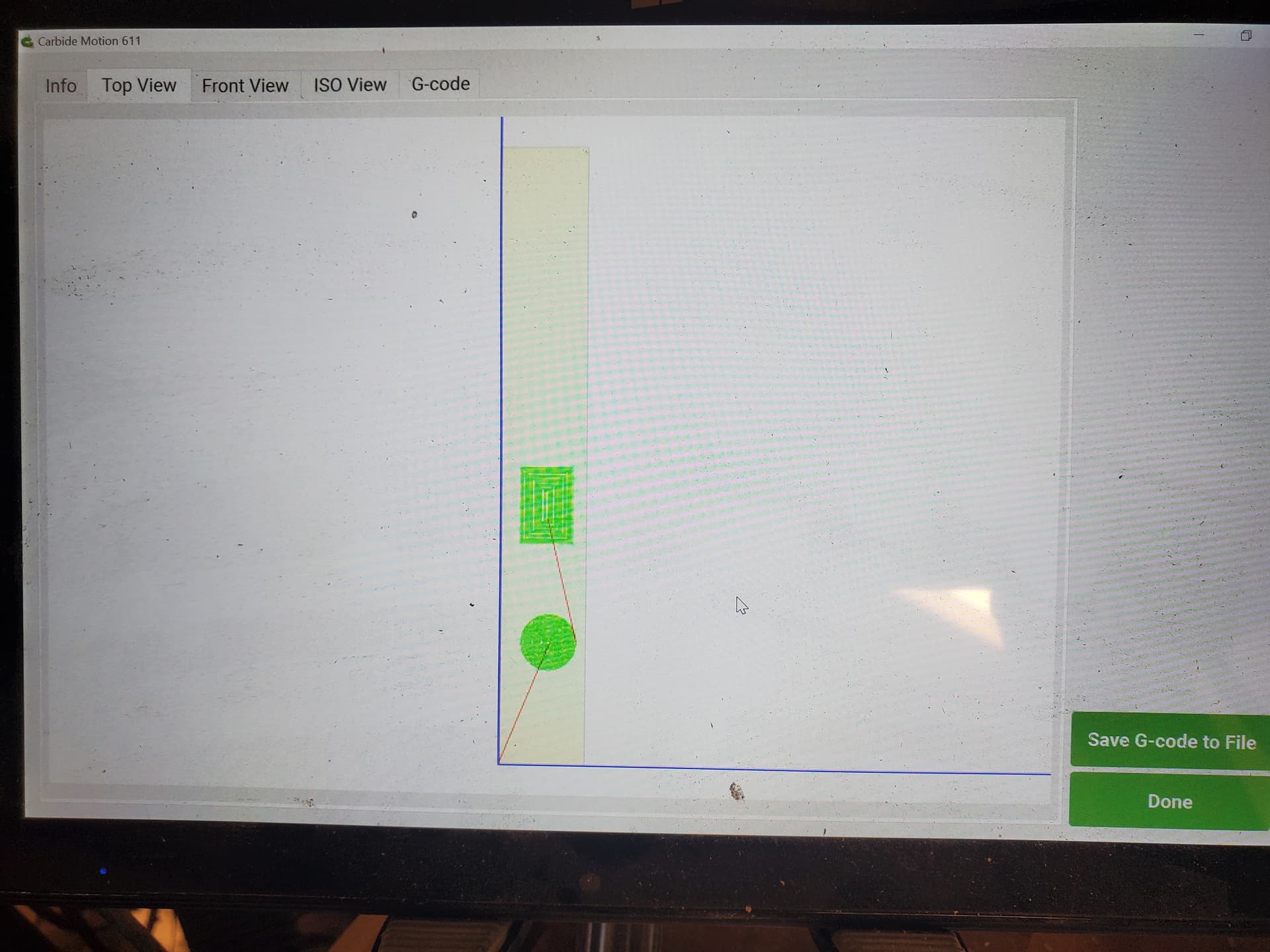

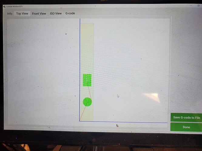

HOWEVER:
Bring it into CM (611) and look at the top view and you’ll see that IT IS going to cut those slots. I ran the job and sure enough, it went to cut those pieces out.
Pretty interesting problem.

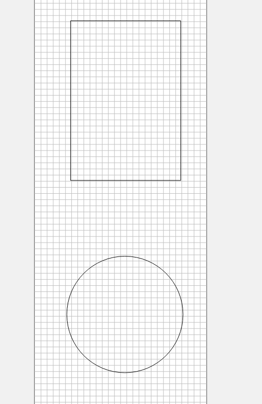

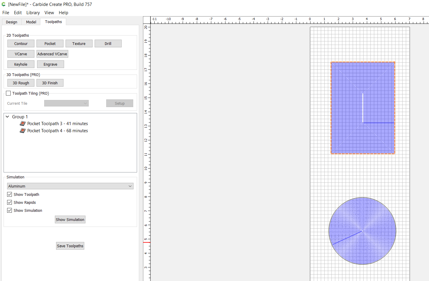

@WillAdams Here are simple steps to create the situation:
Create a file that has two toolpaths

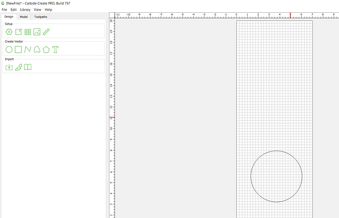

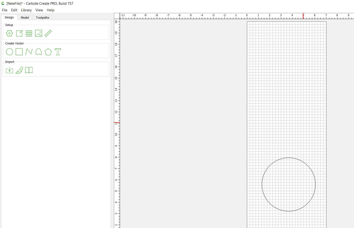

Then go to Design and Delete one of the objects:

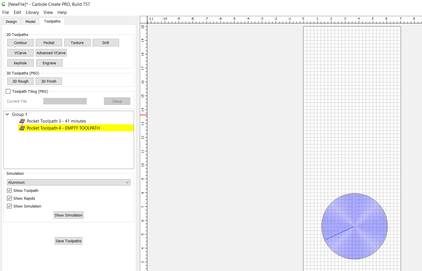

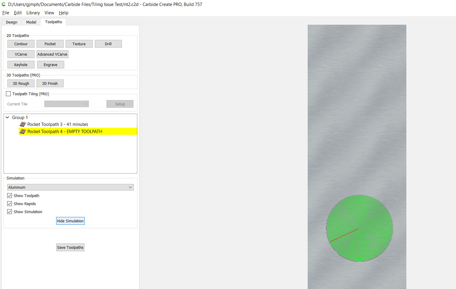

Return to the Toolpath screen - you will see the missing shape in yellow:
Run Simulation - you will see that the phantom shape is still in gcode:

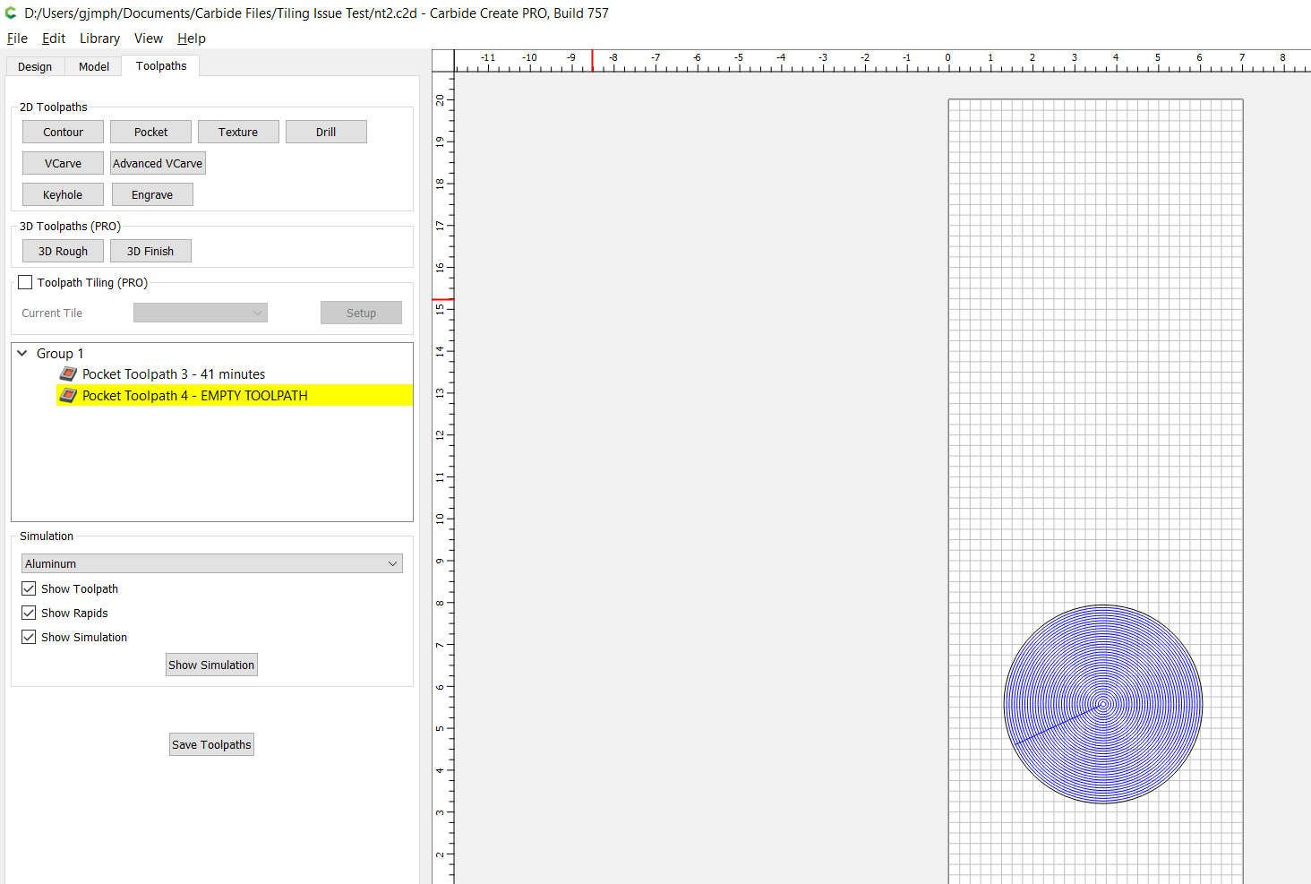

Save the file and reopen it:
Go to the Threshold tab and run the simulation:
You will see that the warning is there, but now the phantom shape DOES NOT show up
HOWEVER - if you bring this file into CM (611) you will STILL see the phantom shape - and it will cut it if you let it:
The problem seems to be in the interpretation of the c2d gcode - because the extraction code works properly: if you save the GCode only from the file:
and bring that into something like NCViewer - the GCode seems clean (I haven’t brought the NC into CM yet…but I will…I’ll include it below as well:
tsolution 2.nc (565.0 KB)

When you save the file and reopen it, it LOOKS LIKE the toolpath is gone from the simulation - but when you bring that same c2d into CM and look at it with something like Top View, you will see that it the toolpath is actually still there - and will get cut.

You don’t really see the problem in CC, you see it when you get to CM. You see it ni CC until you save the file and reopen it…but if you take the saved file to CM, those deleted vectors still have their toolpaths in the c2d. If you export the gcode from CC, however, those toolpaths are NOT included in the GCOde file…but will actually cut in CM
@WillAdams Will, can you confirm this bug? You will need to save the file and bring it into CM to see the full impact of it.
I actually wrote up, and then deleted a report on this because it went away on reloading the file in Carbide Create — will work up a report for it the next time I am at a machine.
Great…thanks. As I mentioned, if you export the gcode separately, the phantom toolpaths do not show up - but they’re there in CM (611).
