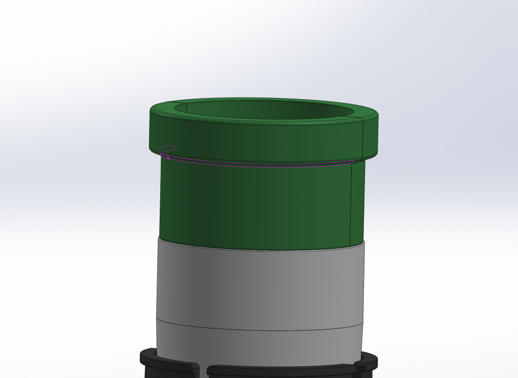

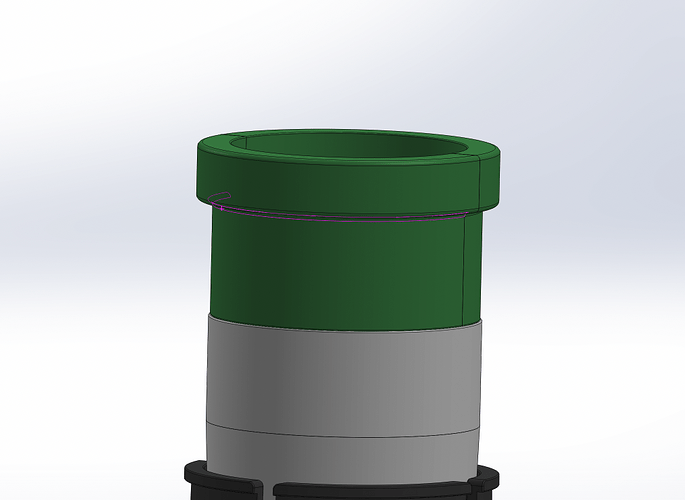

Design discussion: Universal pen mount
It’s some ninja flex you I bought like 2 years ago.
Is the 95a vs 85a a designation of the filament flexibility? I’ll have to check when I get home.
Ninja flex is 85a, I think. It’s the softer, more flexible variety.
The color of my green filament was too perfect, so I couldn’t help myself. It will all be printed in the green color, and I’ll add a special model just for fun.

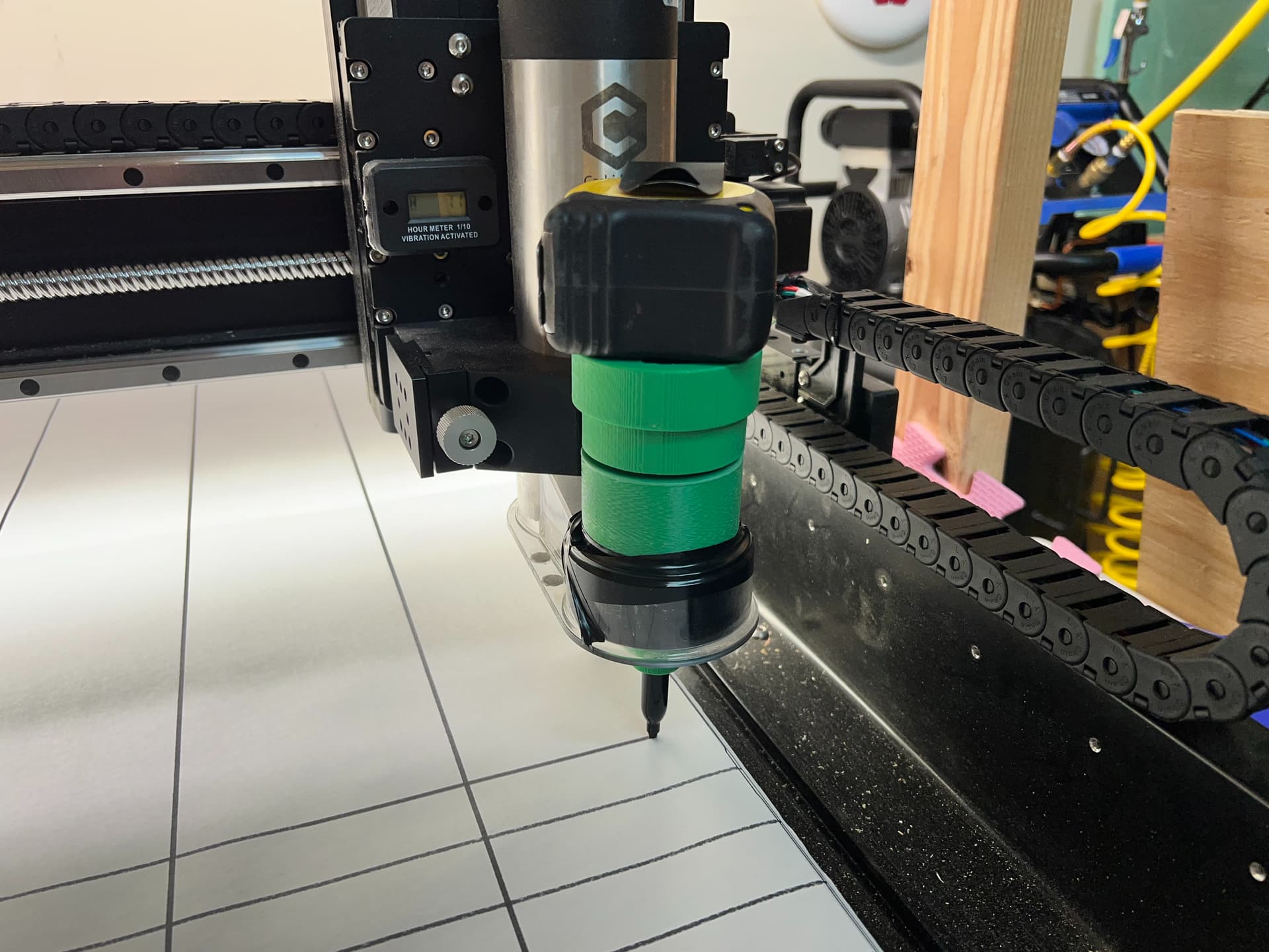

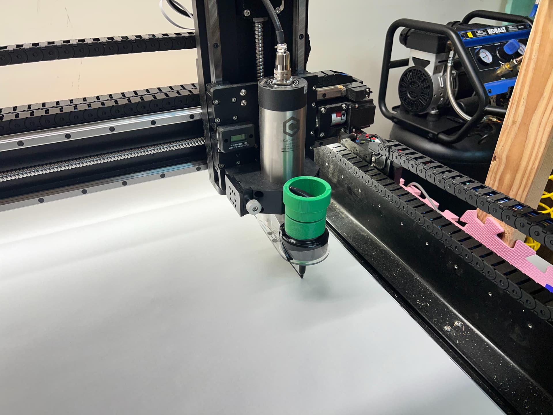

So I have an update on this:
I printed the above file, and it worked magically. couple things to note:
  1. I added a 3/4" sheet of MDF over the whole work area. The bit-setter got in the way, so I’ll either have to remove it or (more likely what I’ll do) chip a chunk out of the side of the Plotter wasteboard to allow for that.
  2. Sharpies bleed a bit too much for the detail I was aiming for, and the sizing of everything.
  3. I think the speed of the file and the size of the sharpies I was using caused the markers to temporarily run dry. They also flattened the tip a little bit.
  4. I will likely use the marker-board sharpies for larger jobs, but I think this will work nicely for smaller, more repetitive jobs.
Here’s some pictures:
I found the weight wasn’t really needed, but the cup served as a good place to store the cap while running, and it fit my tape measure well enough to squeeze some extra ink out while the pen was kind of drying out!
Yes, I found the sharpie bled to much for the project I had at the time so I put a ball point pen in and it worked quite well.
I expect the sharpie would be good for larger poster sized projects. Maybe dial back on the zero as well.
I have not tried the fine point sharpies. They would be a lot more precise, but may be a lot more delicate as well.
Bleeding or wicking is actually a problem with the paper rather than the pen.
So spray the paper with shellac first :blush:
Ha! Shellac wouldn’t be a bad idea. I have like 100’ of this paper, so I’ll need to figure out a different material for stuff I might sell or send to people.
But, it would be good to get an idea for full size prototyping your cut paths before cutting.
to your point, @CullenS, those fine point sharpies, I don’t think would work, at least not on the bigger jobs. The ink flow isn’t fast enough. Maybe for really fine intricate work, it’d do well. if anyone wants the STL files for this, or the solidworks files, Let me know. I’ll package it all up and send it over.
