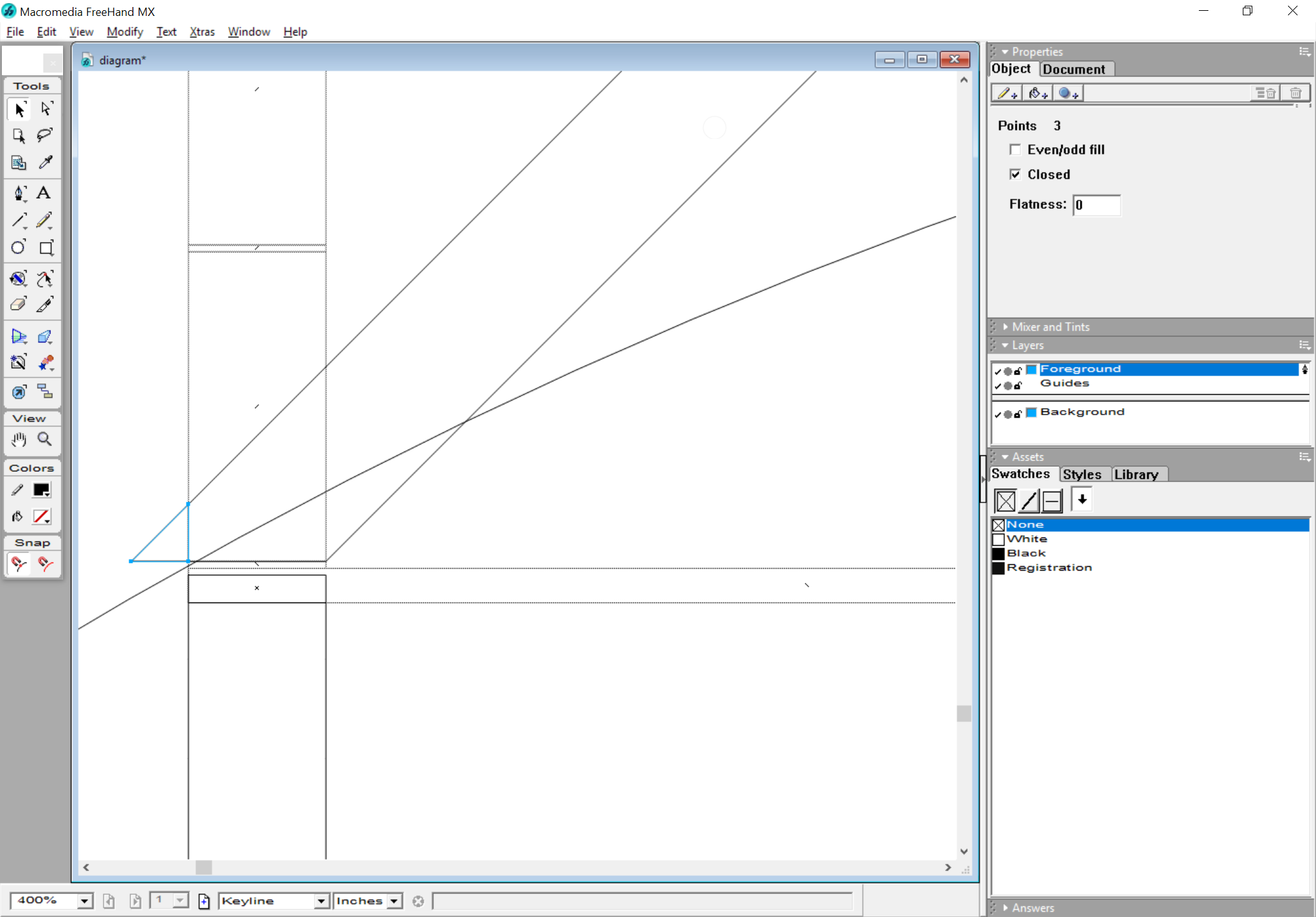

Next step is making a board with the correct (and rather slight) angles:

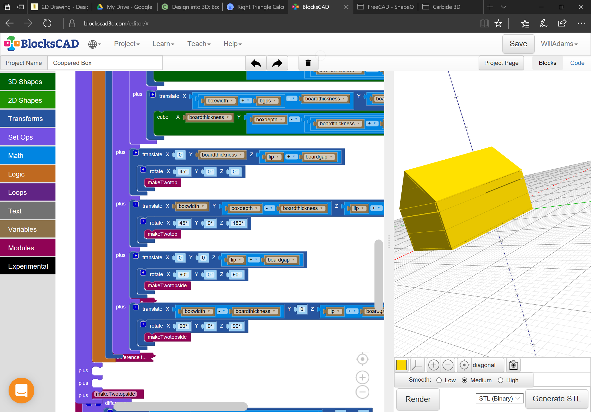

Yeah, one has to model the parts in design orientation, then rotate them into place:
A further consideration, for maximum interior volume we want the board edges to meet at the internal edges, which makes the boards which meet the lid skirt want a two-sided operation:

Okay, the 2 sided top is pretty much just a placeholder. For the 3 faceted top, we actually want good engineering and connections, so we need to angle the parts thus:

The balance should be achievable with a loop.
As is often the case, the first thing we figure out is that we need to revise what the variables are called, and make modules more general:

then based on the chord length of the box as a whole (this is boxdepth) we calculate that angle using the Pythagorean theorem and then we can get the length of the segment arc by calculating the ratio of that angle to 360 times the circumference.

Next is placing it at the top of the lid and rotating multiples through the arc of the lid — arguably it should always be odd — will have to add logic for that.
Unfortunately, BlockSCAD/OpenSCAD makes doing contextual changes of variables (which aren’t really variables for some architectural reason) difficult, so we won’t be able to force things to odd at this juncture (so that there’s always a keystone — might add a parameter for that).
We do however have a coopered lid (finally):
and the lidarcproportion parameter works:
(currently subtracting 1 from that — will hopefully revisit that)
