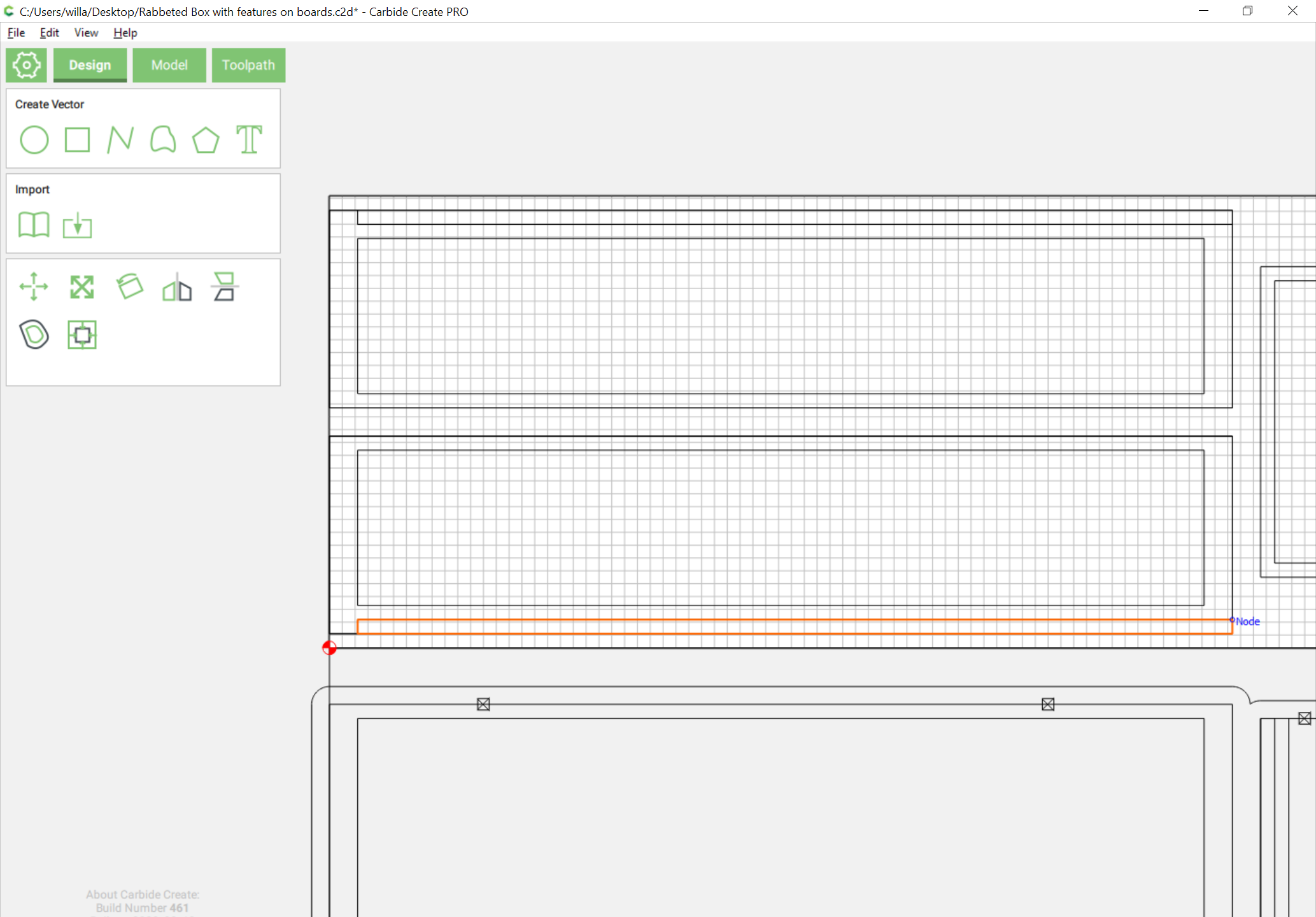

Next, modify/add geometry and arrange for cutting out of some reasonable size of stock which will fit on a machine. The largest part is 3" x 8" so we will try 4" wide boards which are a bit longer than 16" long (which will allow this to comfortably fit on any Shapeoko (my apologies to the Nomad folks).
Before we get too far, let’s mark the lid with a finger cutout:

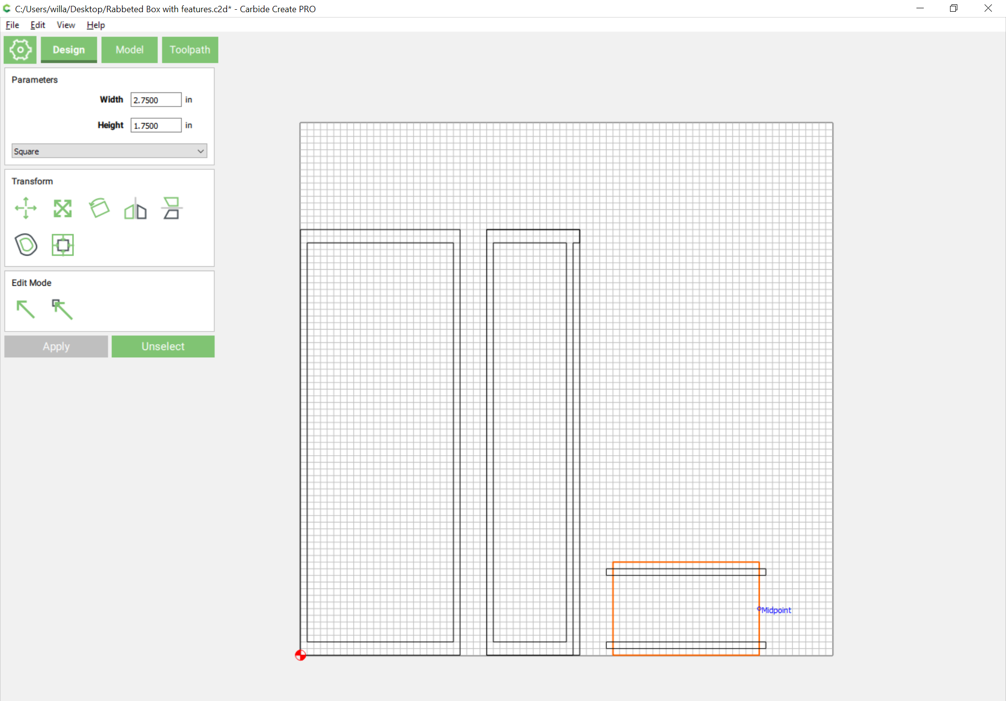

Then we select everything and rotate it 90 degrees:
We’re going to need two boards, so let’s draw those in:
(note that you’ll need to use boards a bit longer than 16" at least for the sides/top, the bottom board can be ~12" long)
Next we arrange the parts within those two rectangles leaving room for an endmill to get into things:
and expand/modify geometry as necessary to allow cutting things out and to use a 1/8" endmill (the grooves for the top/bottom will be slightly increased in size to allow it to fit)

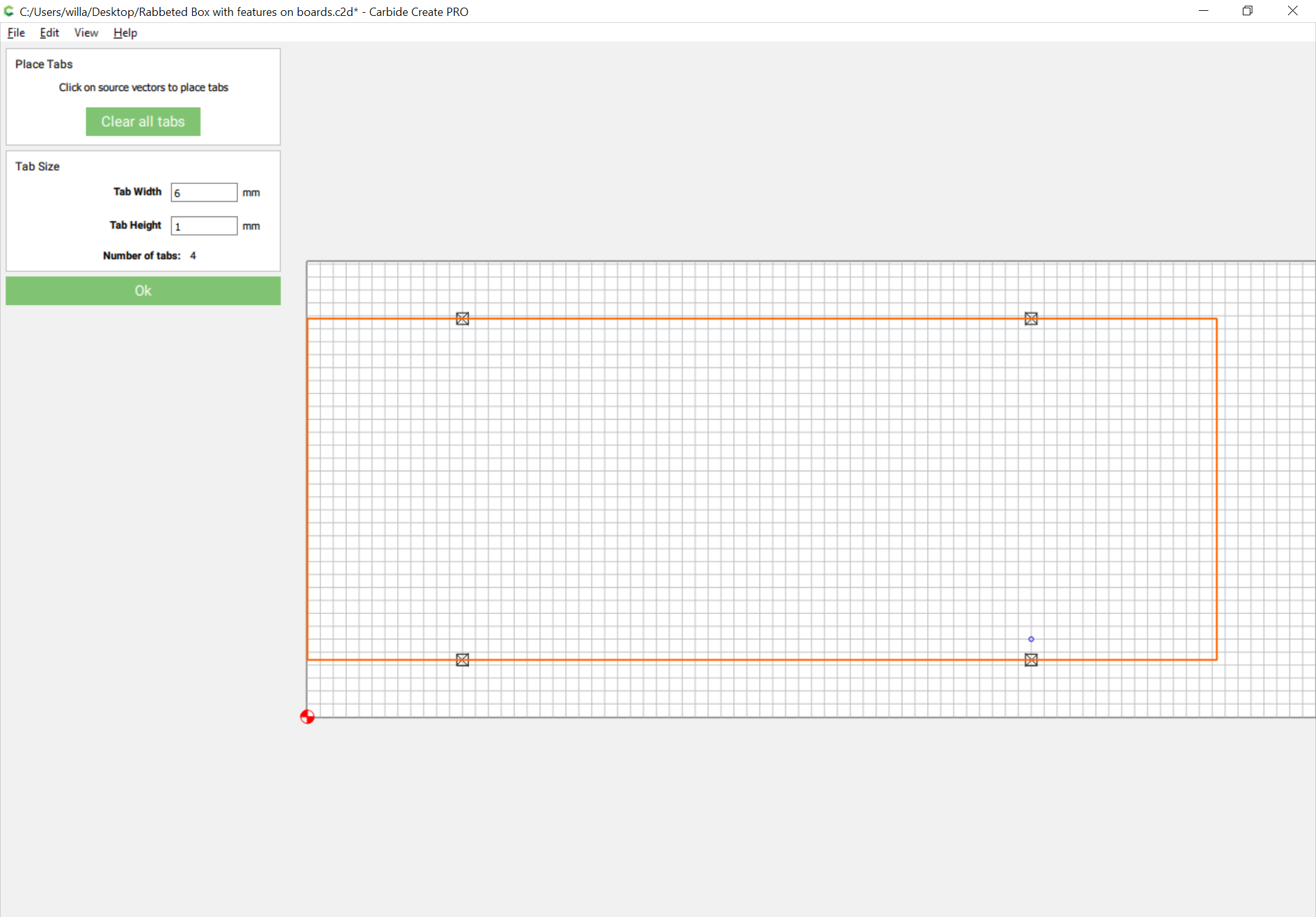

Then select each part in turn and assign an outer profile cut and add tabs:
until one has toolpaths which preview as:

And it seems I messed up the sides.
I believe the fix is to add another pair of grooves to the sides.
Hopefully this is right:
The Z is cut from the underside, so needs to be rotated and shifted into place:
(it would seem the bottom was a bit larger than it ought to have been — will need to adjust that)
Once things are oriented (and adjusted) the box fits together:
and explodes:
And finally, it’s possible to open the box:

It should be feasible to change the job setup so that we clamp up three boards on effectively 10.5" wide stock and cut one box all at one go, but that’s a bit more waste stock than I can accept, so we will shorten the box a bit — the top/bottom are fine, we just have to shift the top/bottom a bit.
1½″ should fit, and it also raises a point on the tab location — probably better at the sides of the front/back of the box.
This file is just for .25 inch wood right. Also how do you separate such as the lid and base into separate pieces because the 16x7 file does not fit on the Shapeoko 3 which I have and not the xl?
Should fit on an SO3 — if it won’t, just rotate a 3.5" x 16" rectangle, mill it as a pocket and secure one board in that pocket as a fixture:
Attached. Rabbeted Box with features 3×8×1½″.c2d (182.1 KB)
To separate, just drag the 3.5" x 16" boxes around and disable the toolpath group you don’t need:
