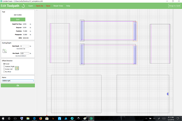

Next begin drawing in the rabbets for the left side — these should be 3.5″ tall and 0.5″ wide, but will need to be appropriately larger to ensure that the entire surface is cut — add at least the diameter of the endmill which you are using to the height and width, so:
Repeat for the other rabbets on the top and bottom.
Note that the rabbets for the right side should have their height reduced by:
half-added height + inset + thickness of top

The next step is to determine how deep those pockets will be, leaving what thickness, which determines in turn, how much the sides will need to be shortened. Half seems about right, so the sides should be shortened by the material thickness:
At this point, it may be helpful to review the appearance from overhead:
The visible portion of the bottom (from the underside of the box) will be 8.5″ × 6.375″ — the dadoes may be any depth up to the 0.25″ of the rabbet — the material thickness of 1/16″ is a bit shallow, so we double it to keep the math simple. A worthwhile improvement is to cut this dado with a ball-nosed endmill — this will result in a rounded bottom which will be stronger and less likely to break. It also makes adjust the fit by sanding the inset part easier.
The dimensions of the back should be a bit less than that, adjusted as desired for using a ball-nosed endmill — simpler to use the 0.25″ for the part dimension and to increase the 1/8″ depth slightly.

And at this point we’re essentially done. All that’s left to do is assign toolpaths. Here we will assume that folks will cut one part at a time — the way I do that is to assign all the toolpaths, save the file, duplicate the file once for each part w/ an appropriate name, then open each and delete everything which is not needed, then export G-Code.
and it’s done:
Please review / adjust / test feeds and speeds as necessary before outputting G-Code and actually cutting.
