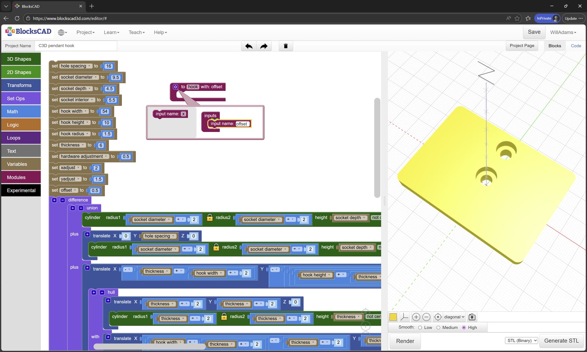

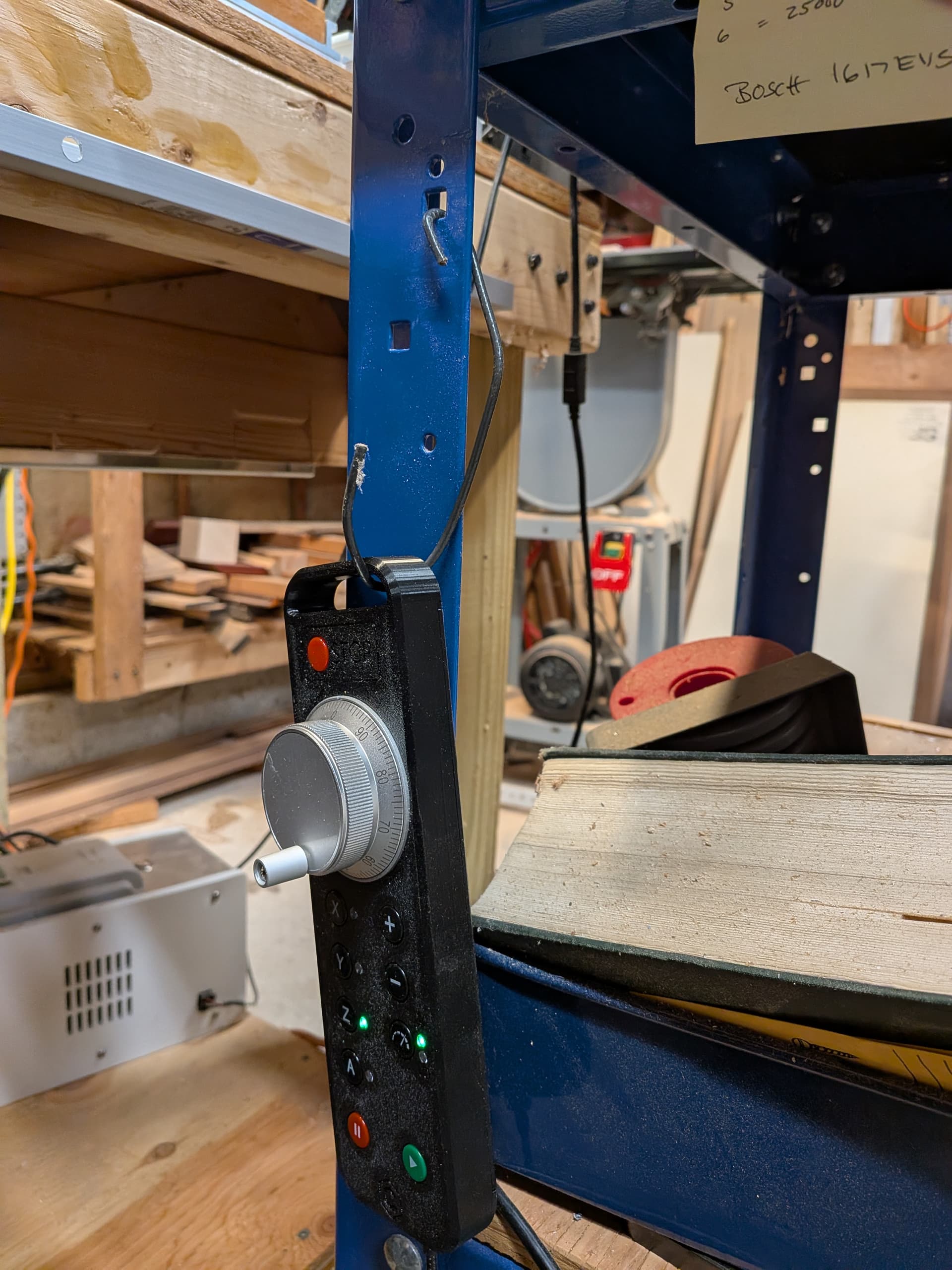

Designing a holder for the Carbide 3D pendant

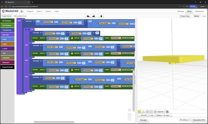

Eventually, I’d like to work up a steel plate as a base for a platform which all the machine controls rest on on the swing monitor arm affixed to the table my SO5 Pro is on, but until that time, a space to hang the Carbide 3D pendant is wanted — since the front plate has two holes in it, and bolts for securing it, using them as an attachment point seems an expedient option.

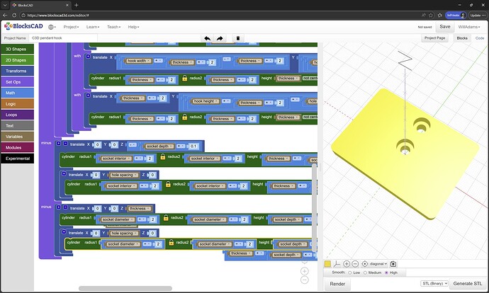

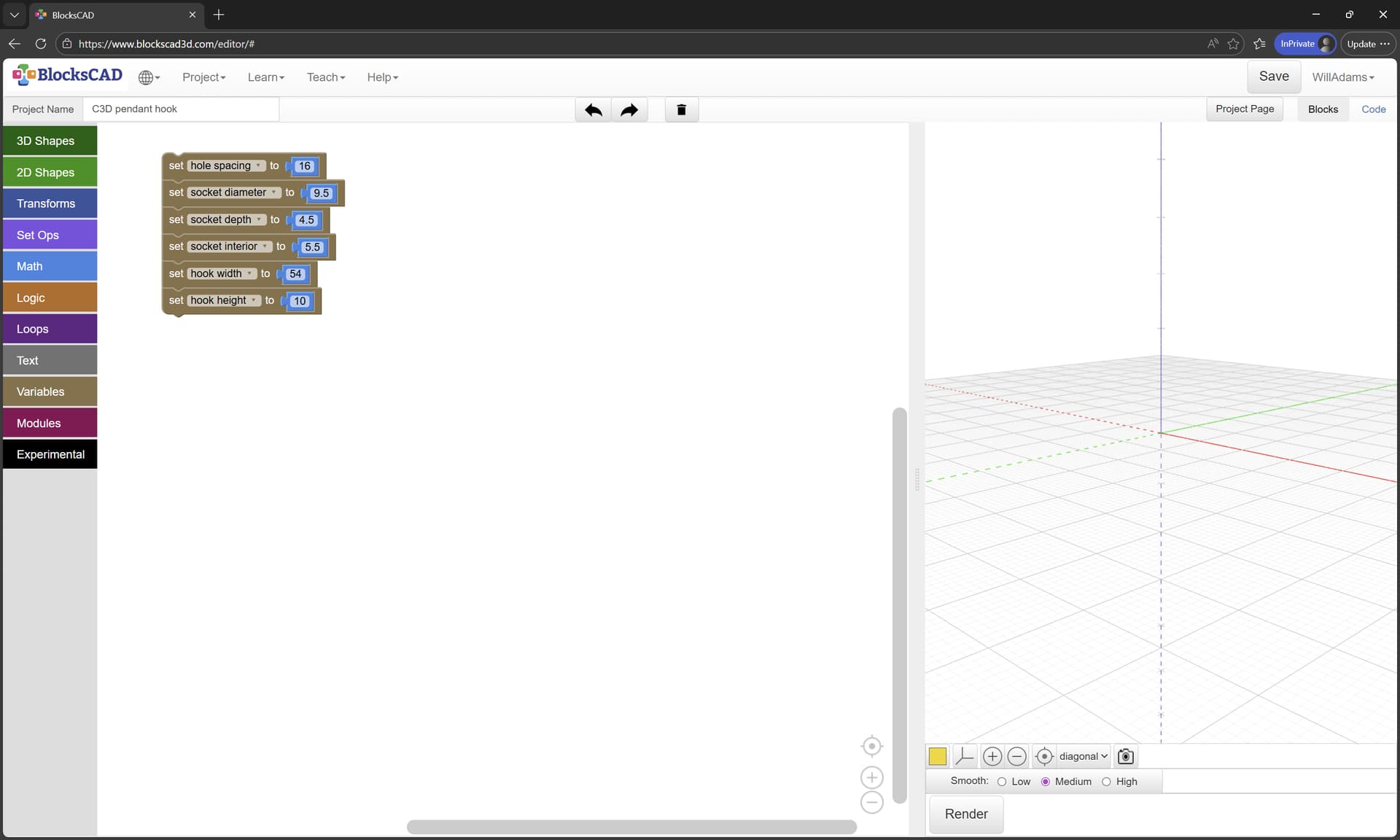

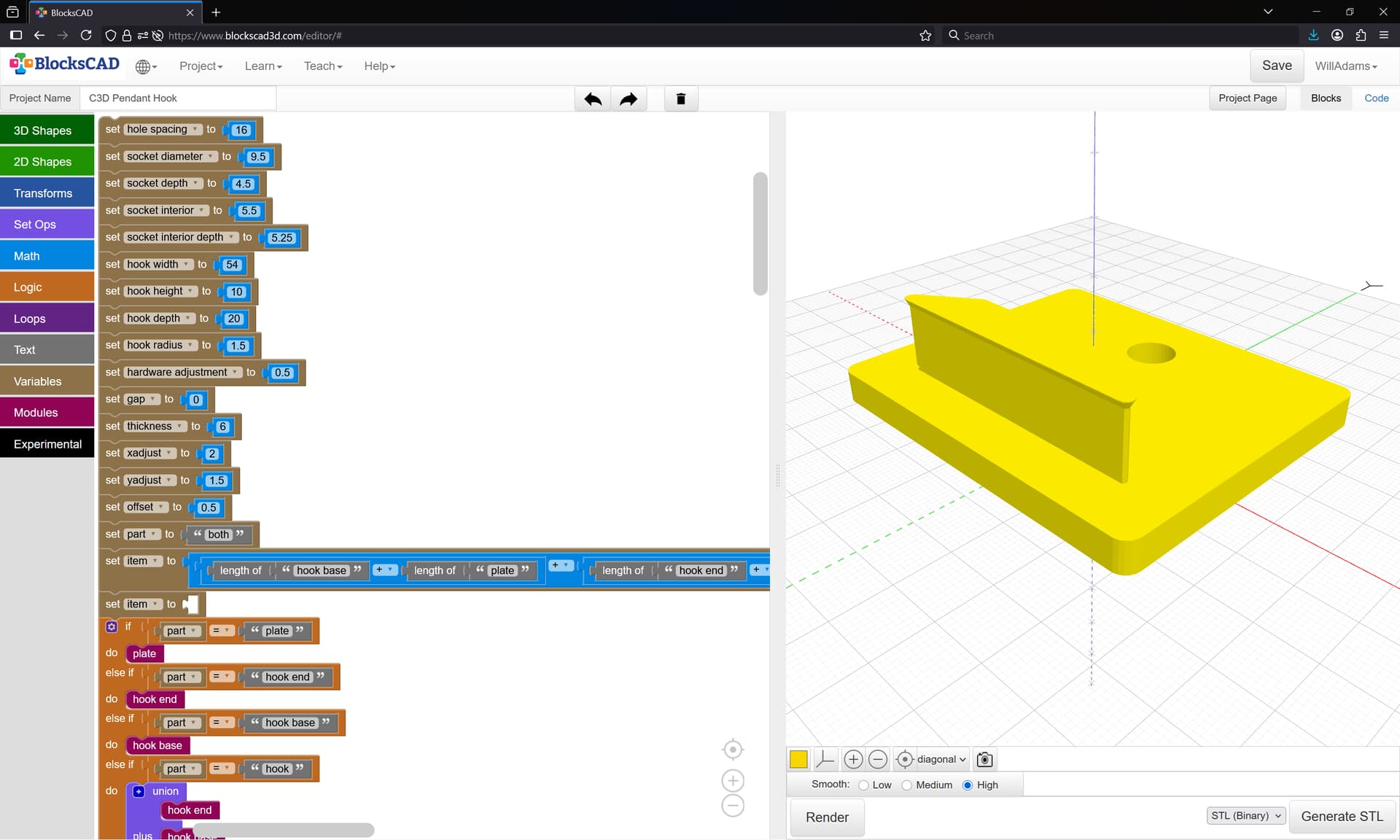

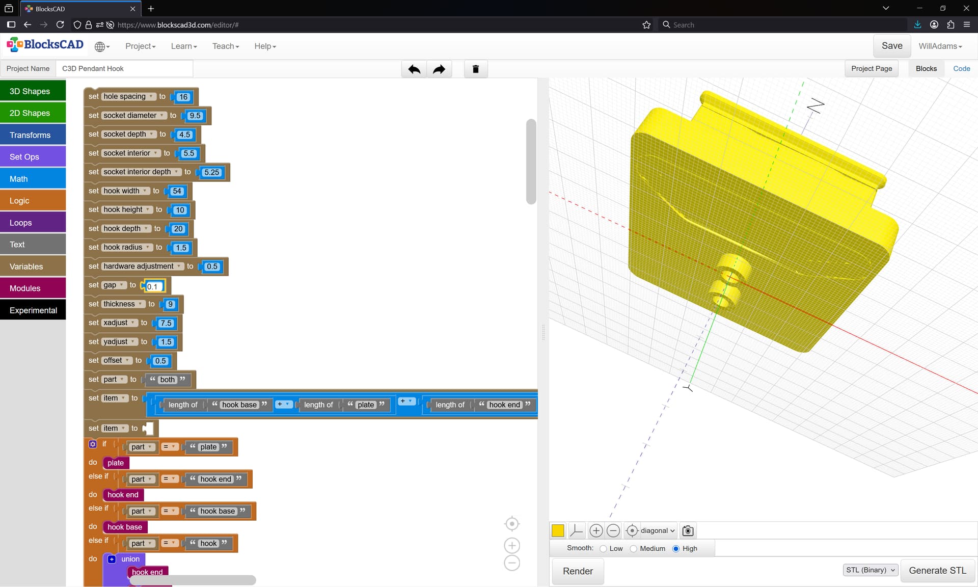

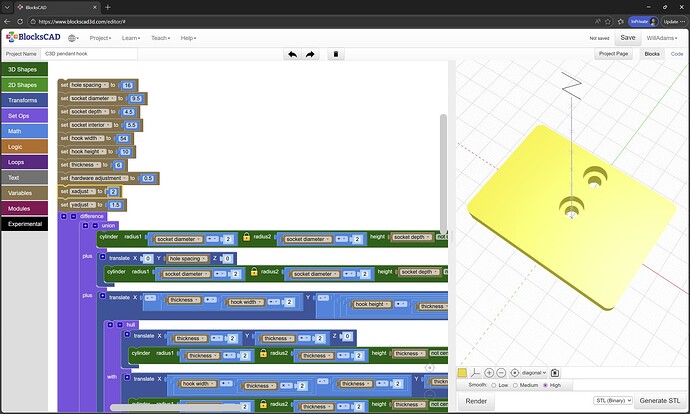

Since this will be a 3D object, and I have failed miserably at actually using every 3D CAD tool I’ve ever used, we will rough this out in BlockSCAD, starting as usual with some measured dimensions:

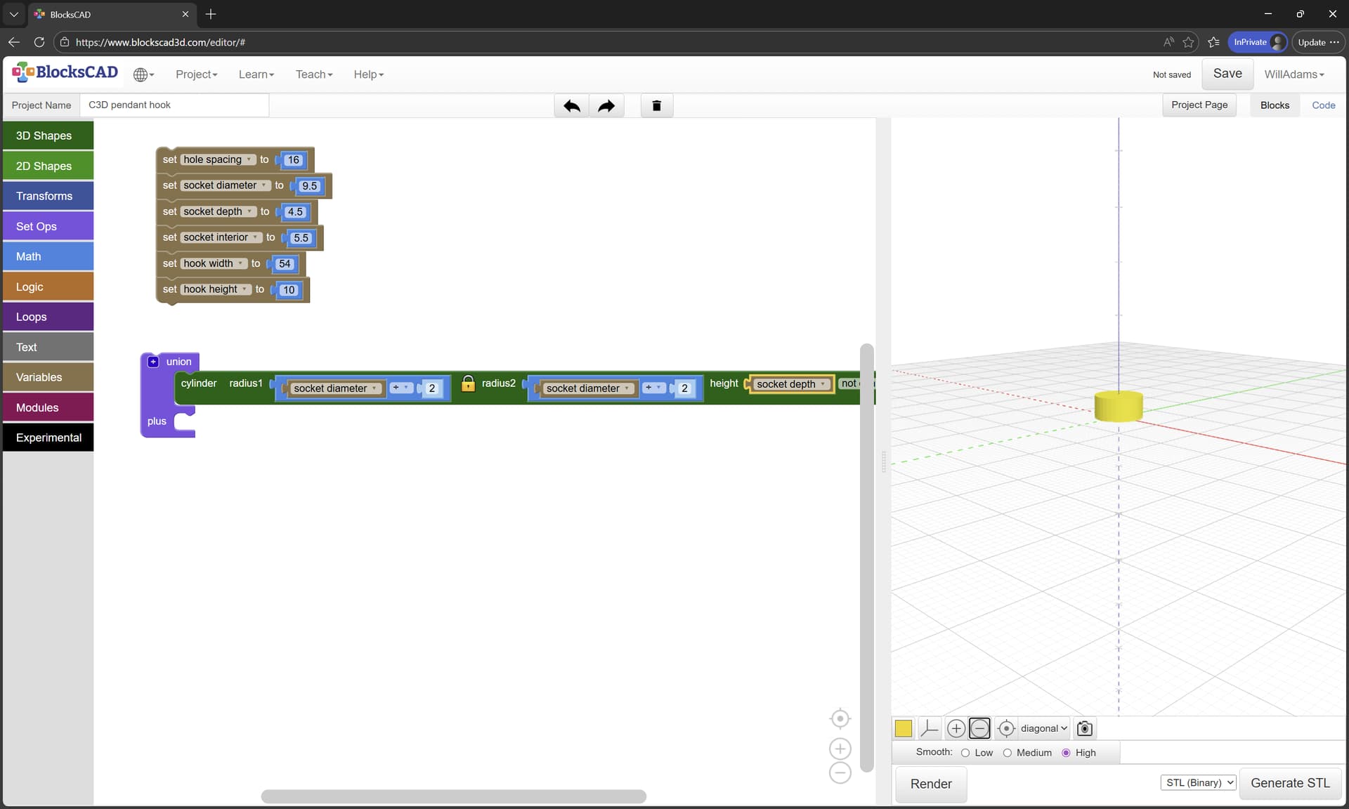

which are then used for modeling features:

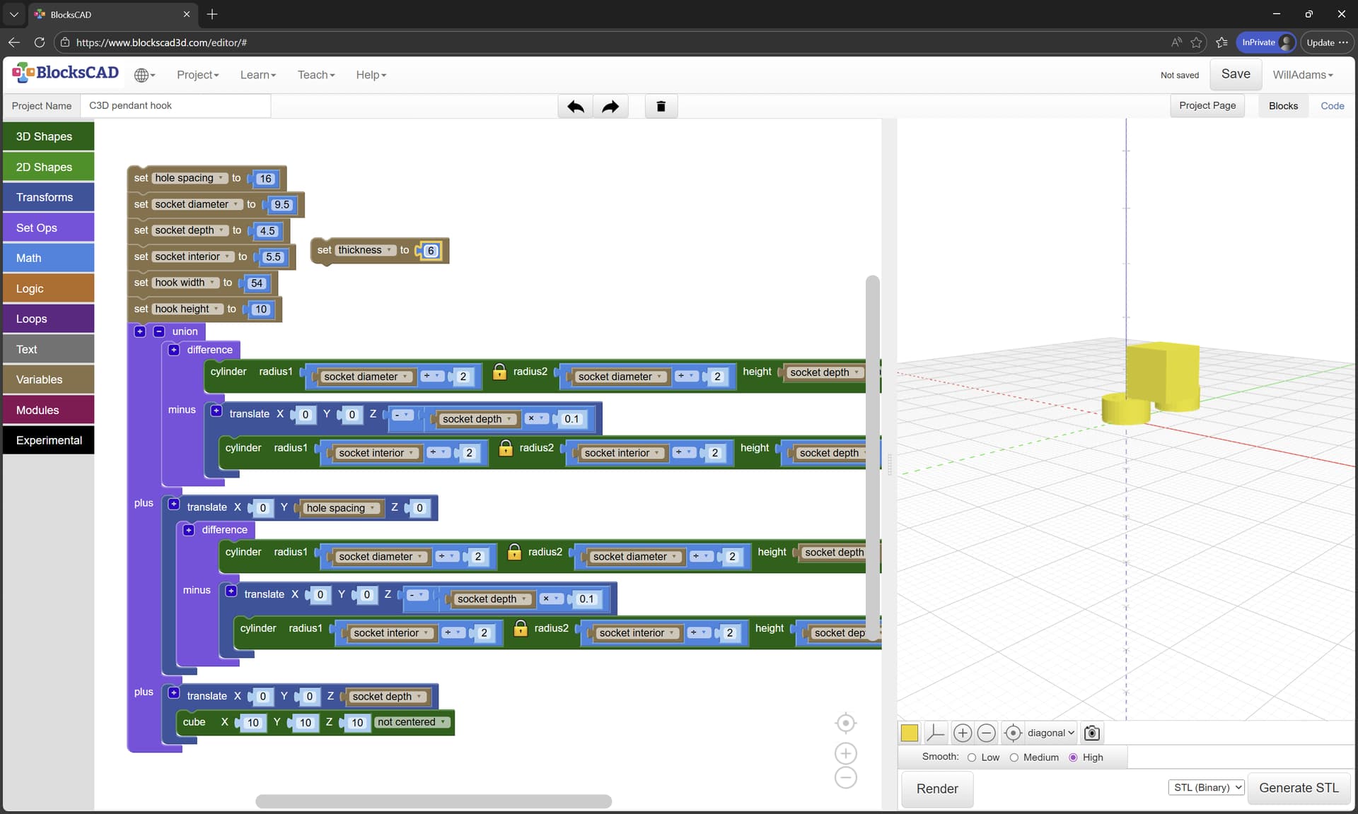

adding variables as needed:
and using them to build the dimensions incrementally:
Adjusting a bit we arrive at:

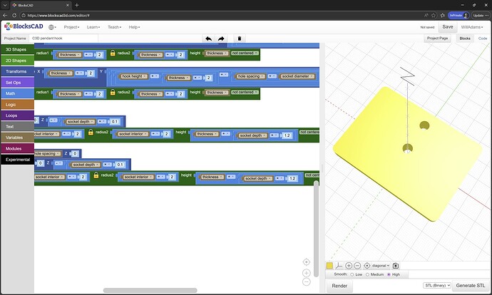

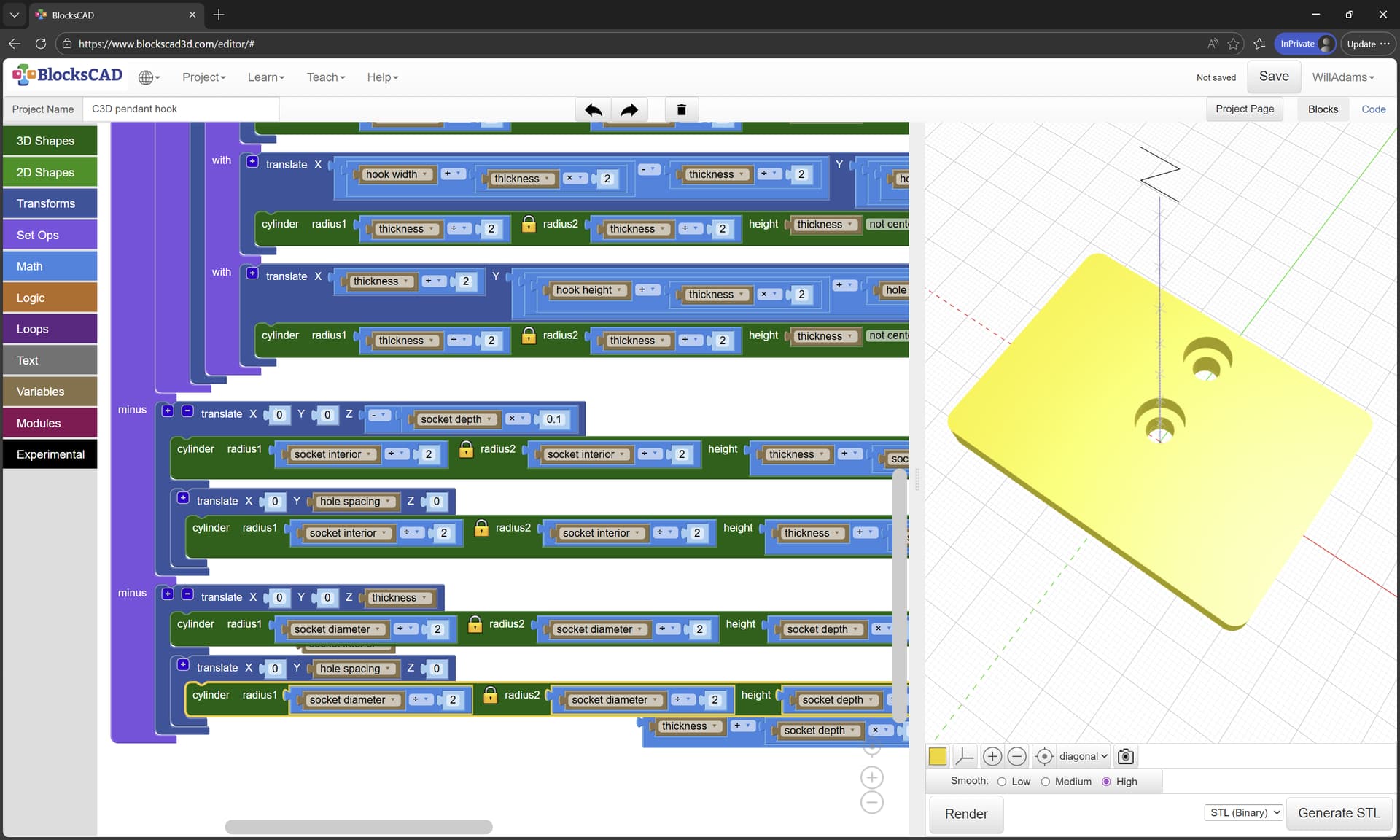

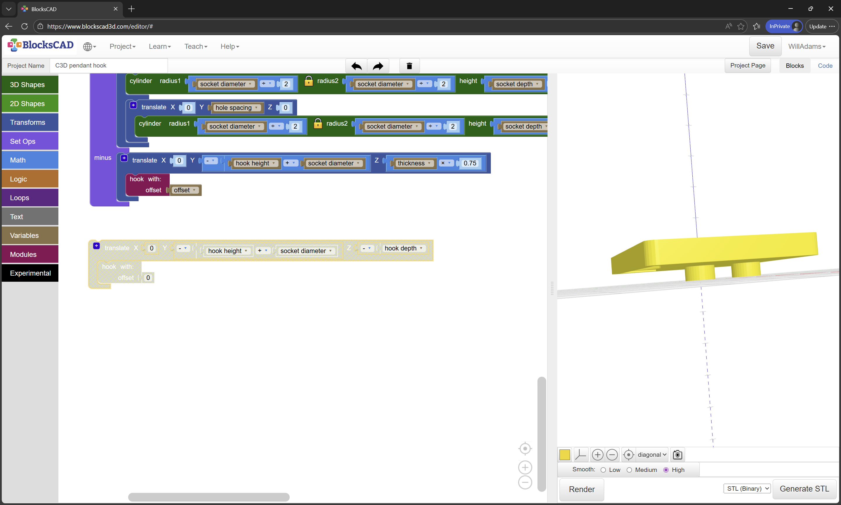

which needs to have the holes extended through…

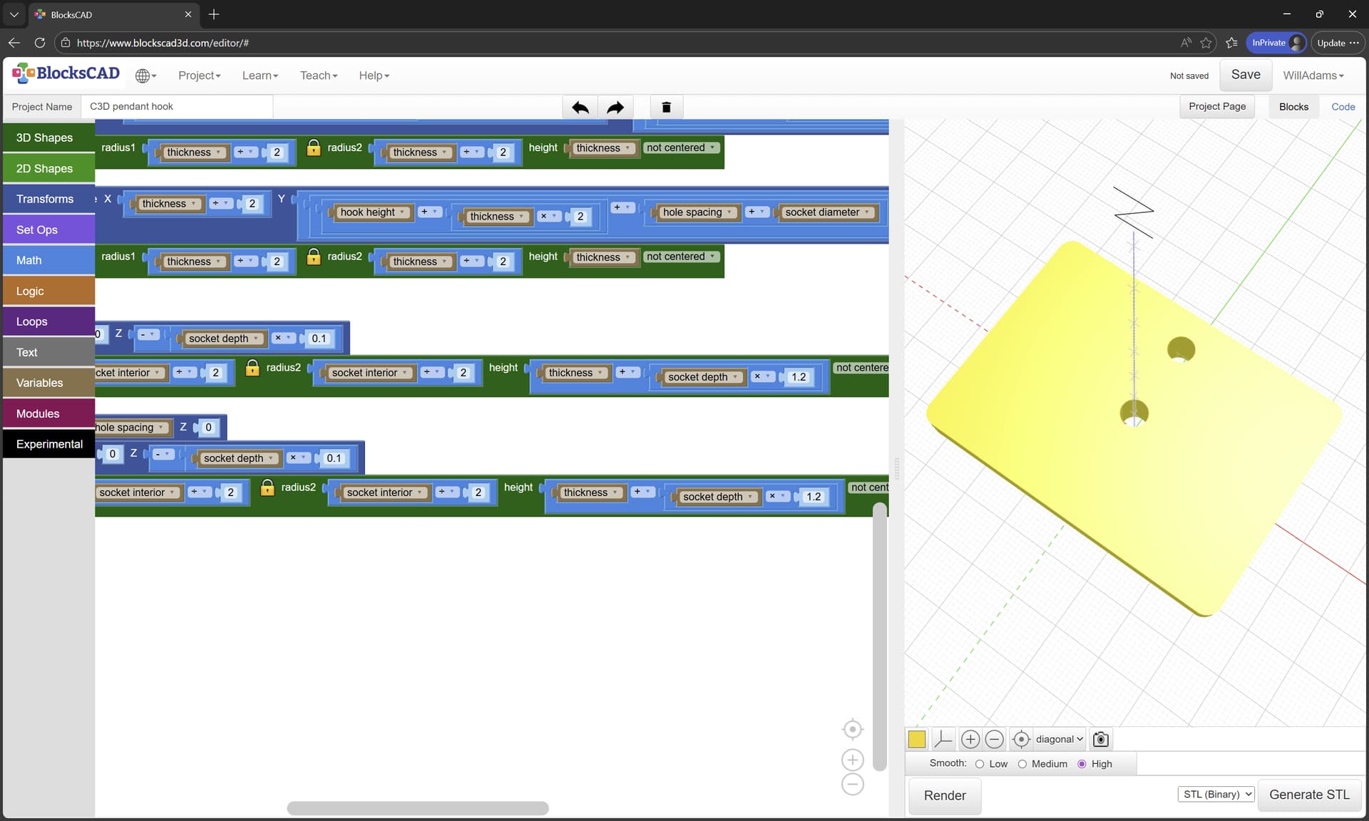

Which is easily done:

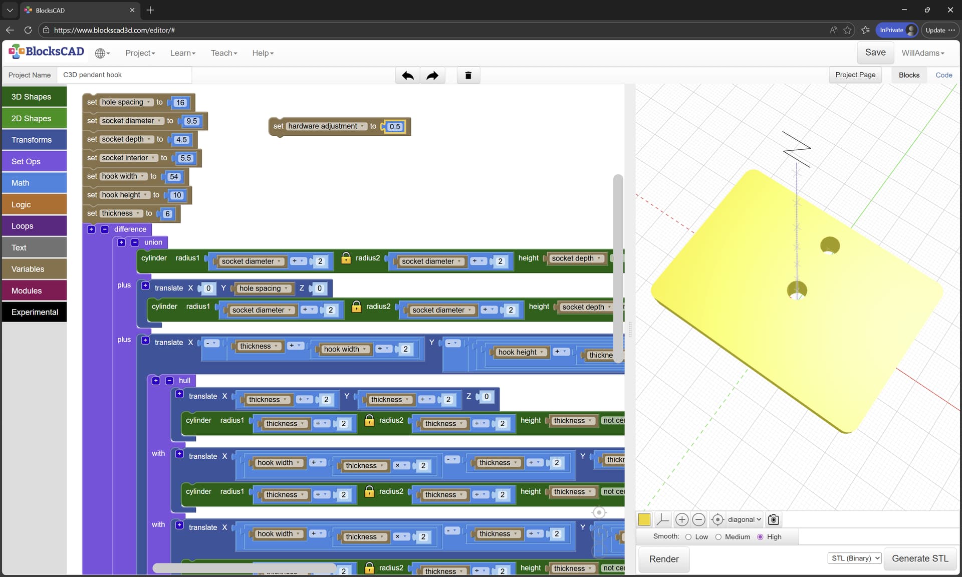

but then raises the matter of countersinking the hardware/duplicating the original recess…
adding another variable:
this is easily done by adding the sockets with the adjustment to the elements which are difference()d:

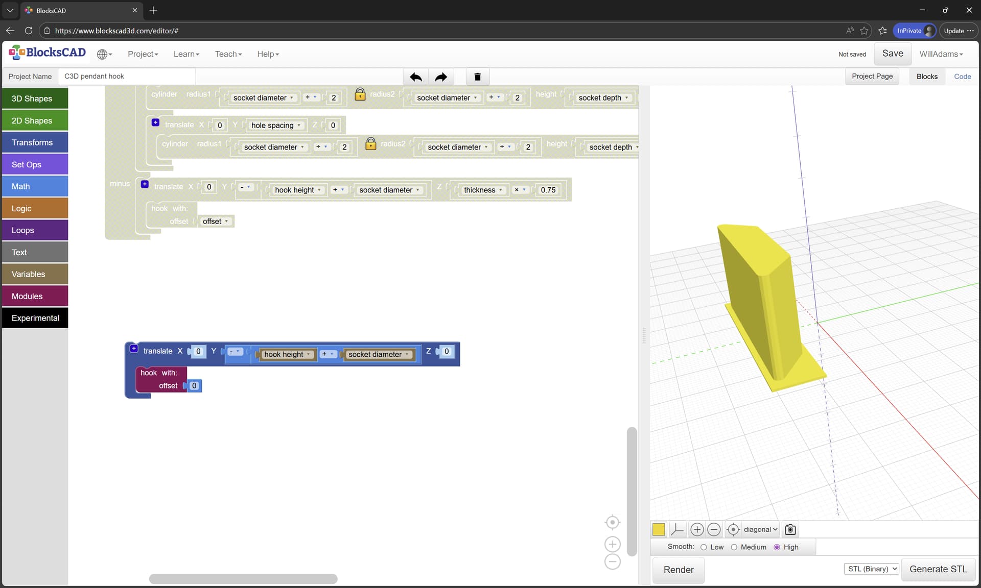

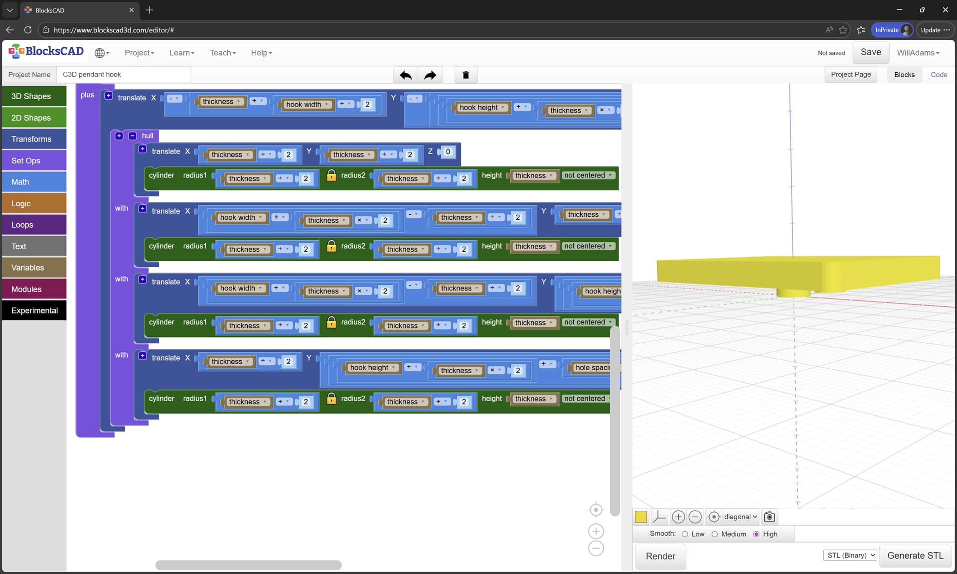

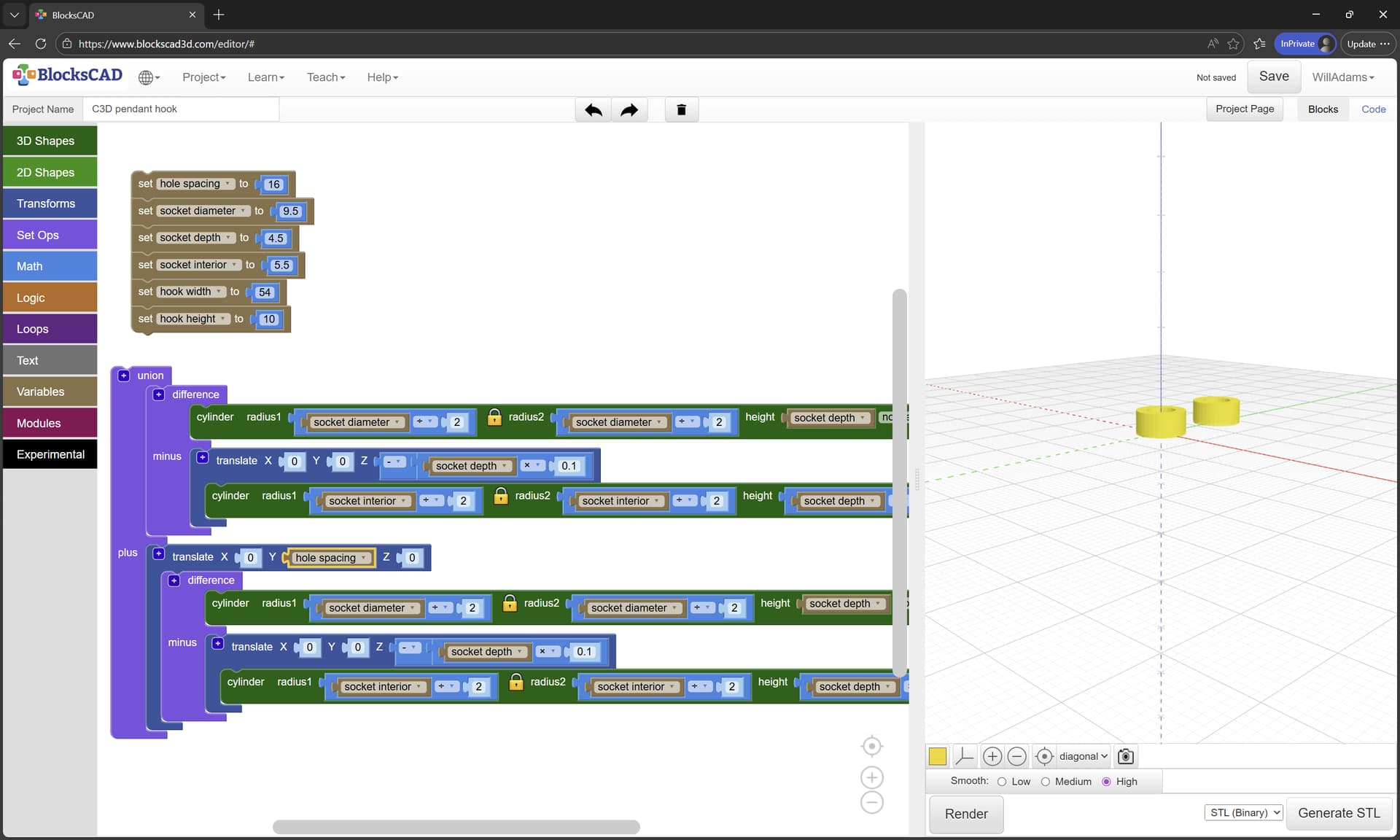

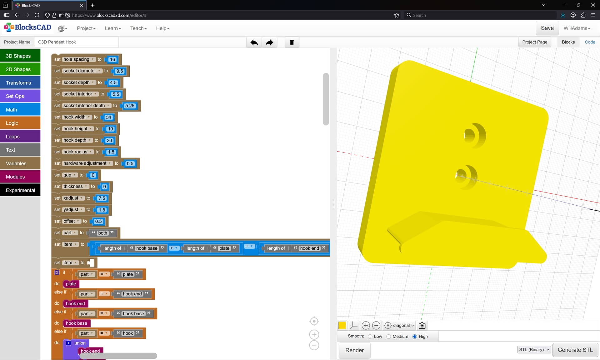

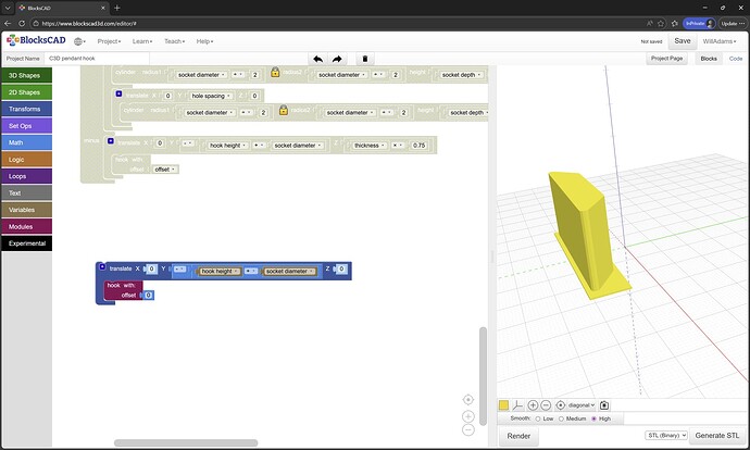

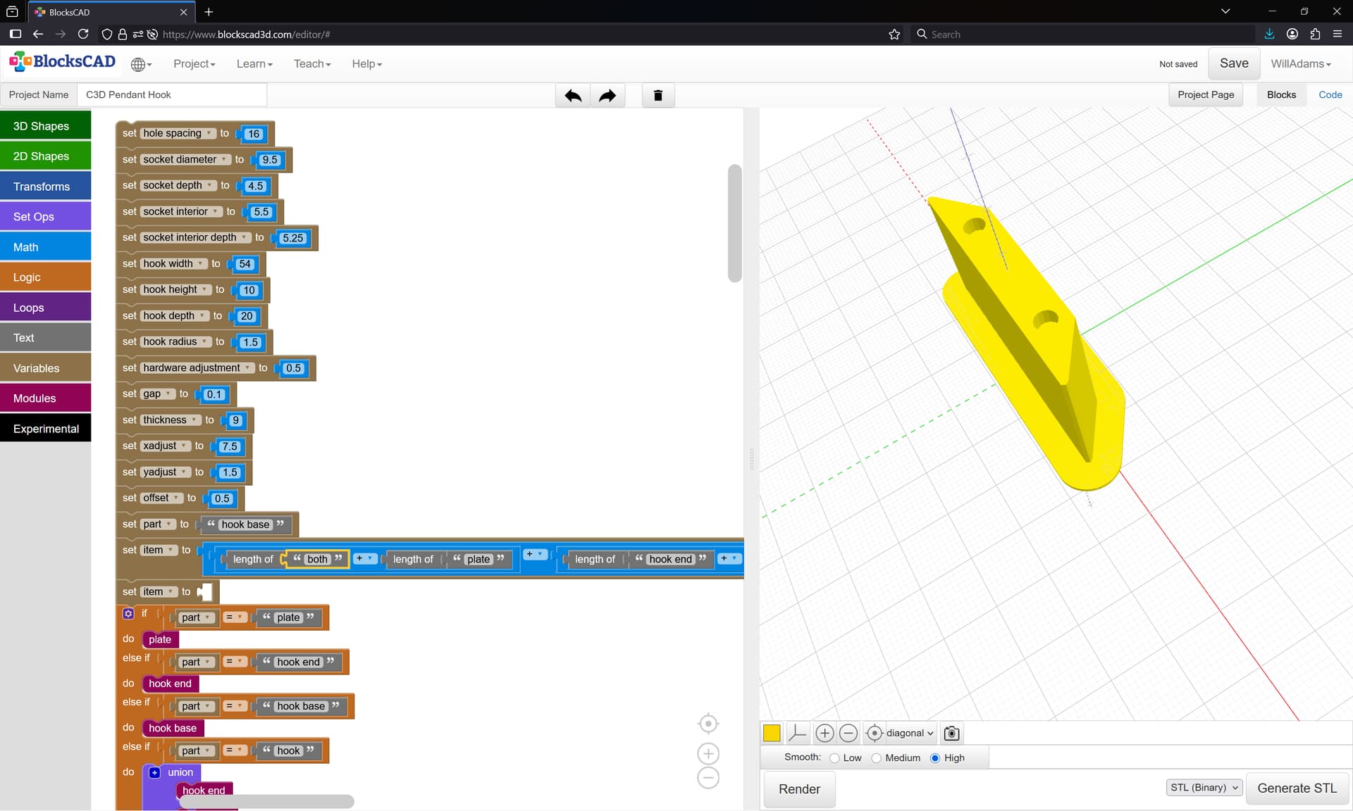

Next, we model the “hook” itself as a module, piercing it through the plate and adding an additional plate which will also be removed so that the two parts will nest/mate.
First, variables to adjust:
and a module:
which needs to be instantiated with and without an offset.

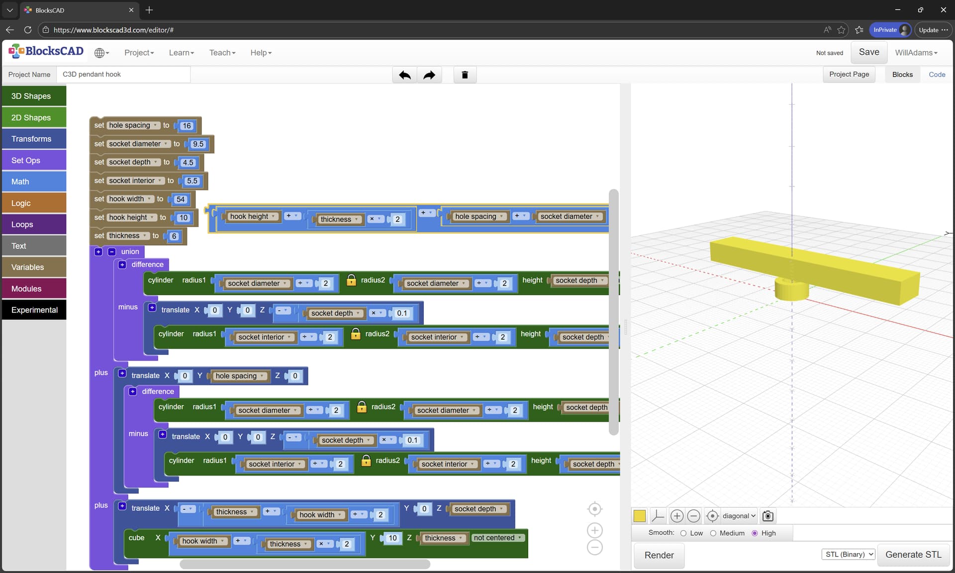

The hook is:
which possibly wants something at the end to hold things in place.
The file is at:
and may be exported to an STL.
Make that was at. Apparently the contents of the modules were not saved for some reason — recreating now.
Fixed, now at:
https://www.blockscad3d.com/community/projects/2055323
making a test print now, and if that pans out will walk through exporting individual parts to cut and upload the STL.

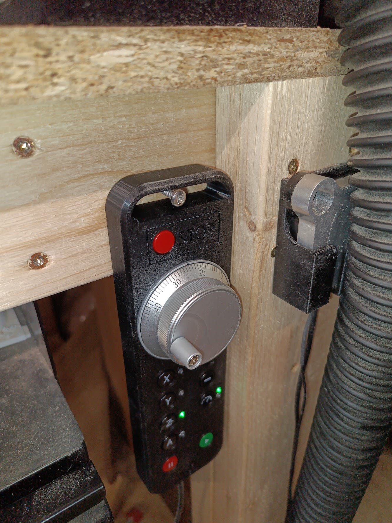

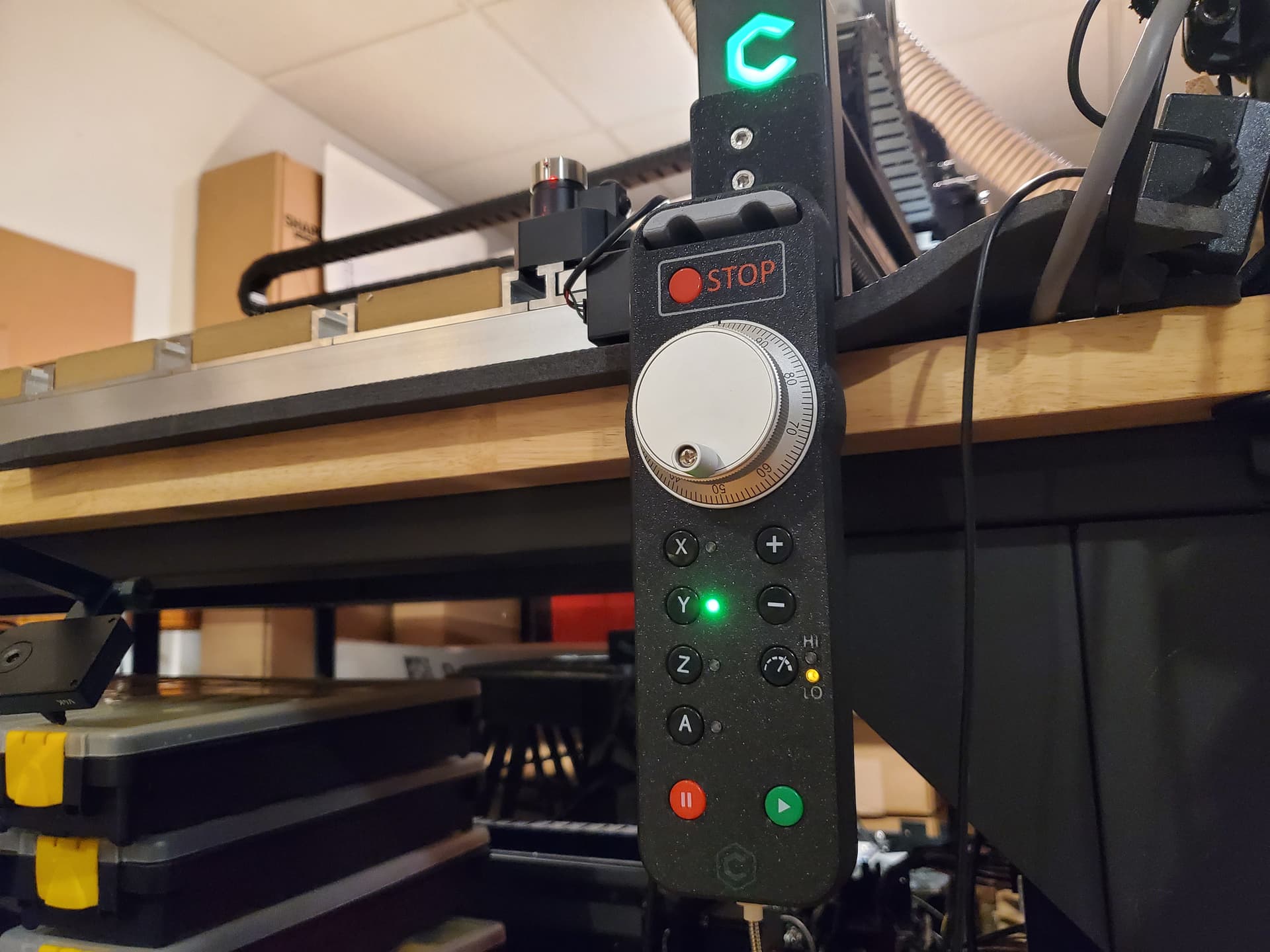

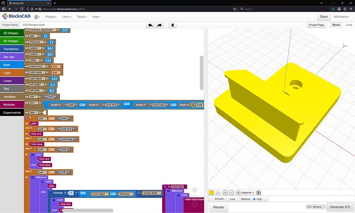

After a bit of adjustment, I believe I have a good design for an SO5 Pro:
C3D Pendant Hook.stl (69.0 KB)
The parametric interface for BlockSCAD allows one to adjust the gap and part variables so as to increase the spacing:
and output individual elements:
as desired — I believe it would work well if printed in multiple pieces and then assembled, or if the individual parts were cut from suitable materials.

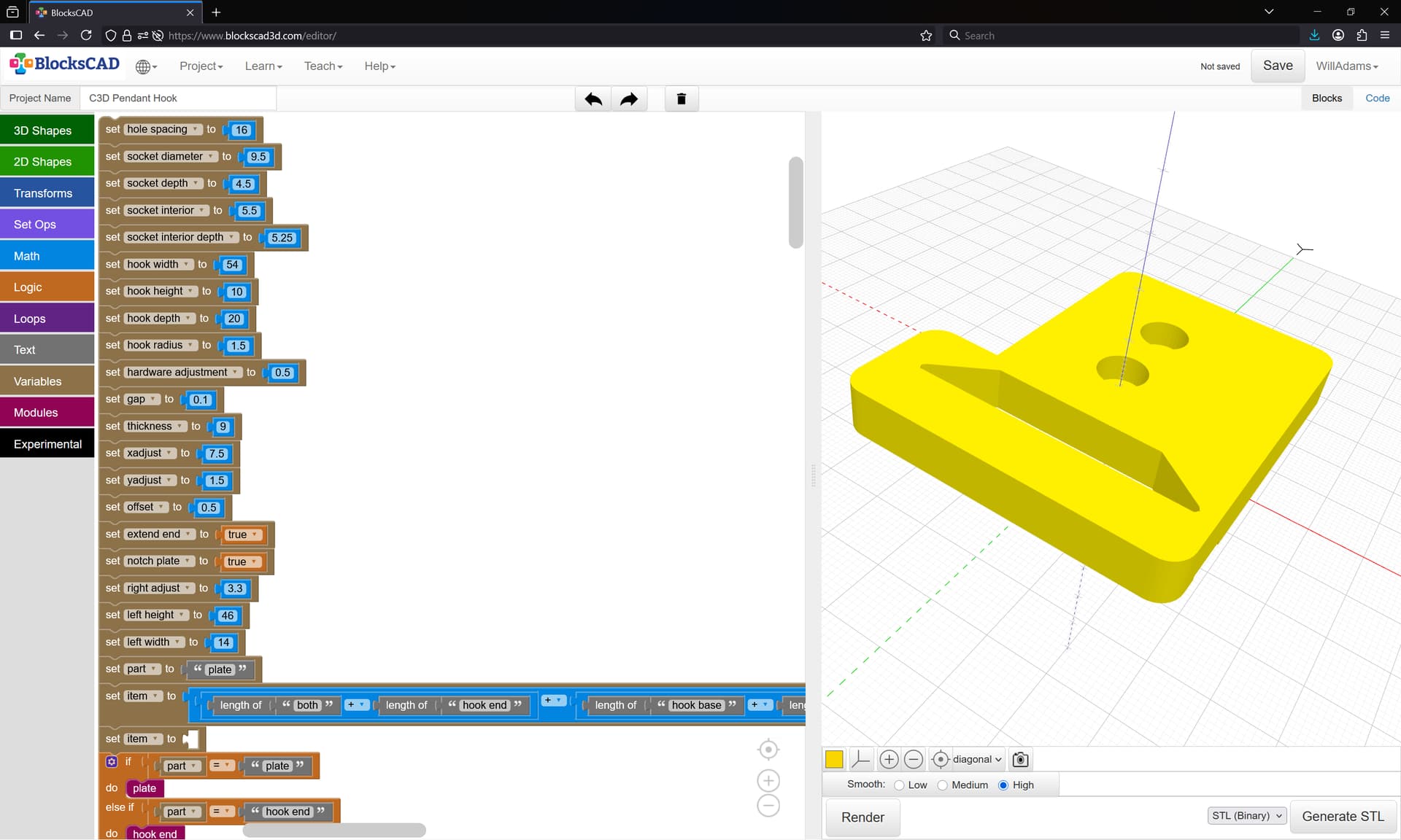

A further improvement would be to arc the sides of the hook to match the interior of the hanging recess on the pendant…
The above file works, but seems to require a bit of adjustment w/ a file or plane:
It’s hanging a little canted due to the USB cable being pulled off to one side — should’ve adjusted that. Further, note that in addition to 3D printing a modified shell I inserted a couple of layers of orange film in-between the “LO” light pipe and the LED.
Note that you’ll need two slightly longer M5 bolts, which raises an interesting question — if you replaced the stainless machine screws on the pendant w/ steel, could you then have a plate w/ 6 magnets which would secure it? (as opposed to opening the pendant up and installing magnets in the recesses)
This suggests a slightly different approach — extending the end of the hook so that it can just be filed to match.
One benefit to this design is that it offers a bit of protection to the BitZero connector…
Making a slight adjustment:
C3D Pendant Hook_notched.stl (71.9 KB)
Printing now.
Success (after a couple of passes w/ a hand plane and a few swipes w/ a file)
Next up, printing multiple parts w/ different filaments (after further adjusting the end to match the internal rounding), then try manufacture in multiple parts using different materials.

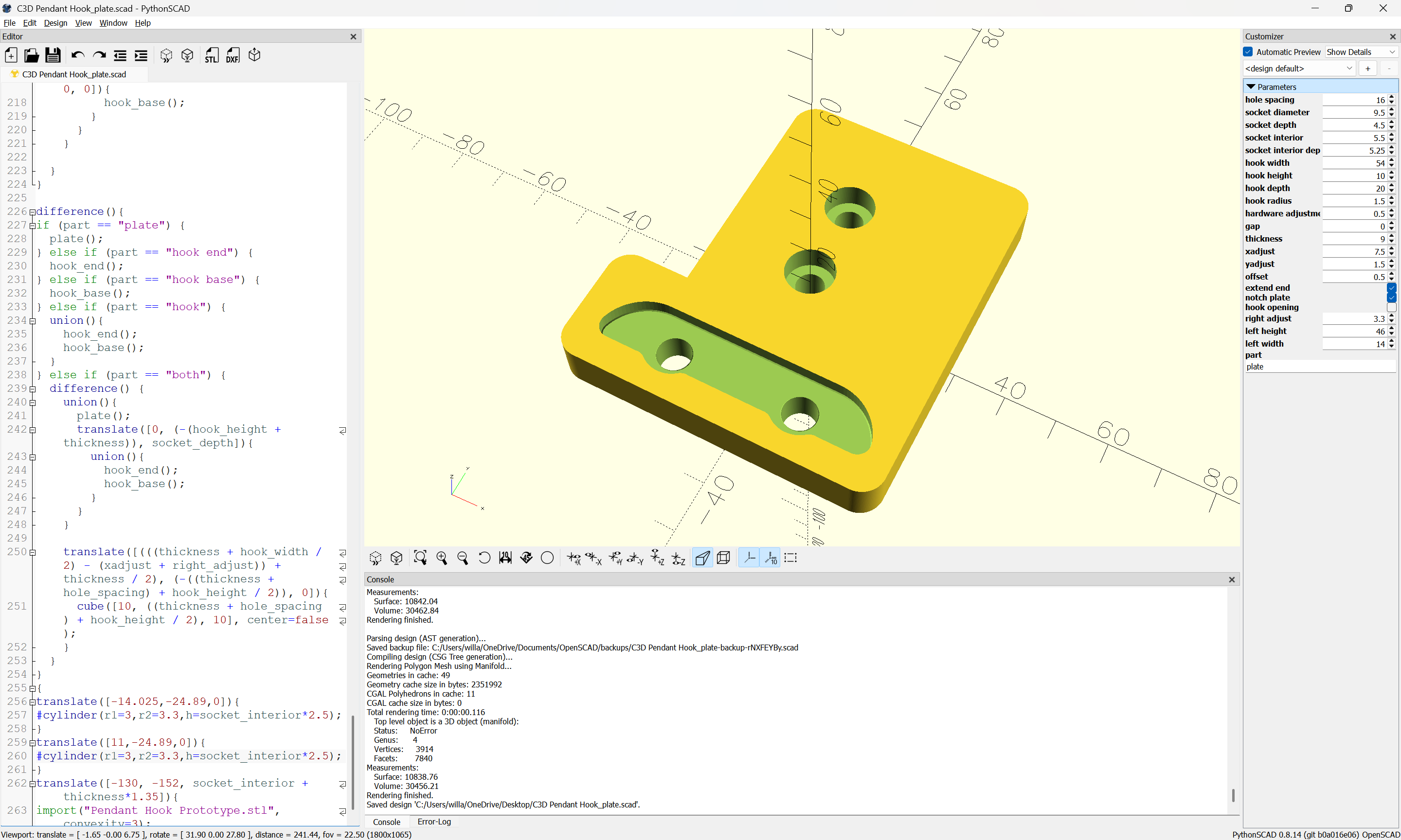

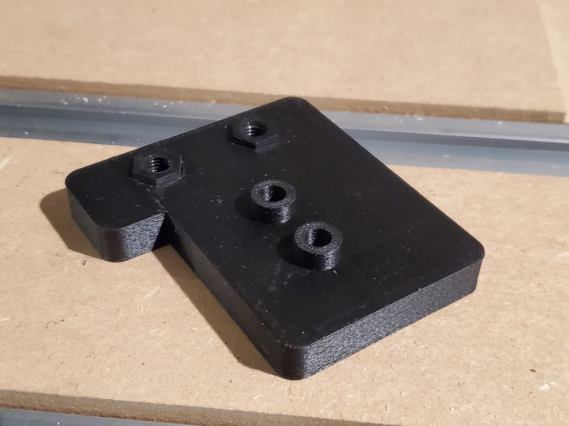

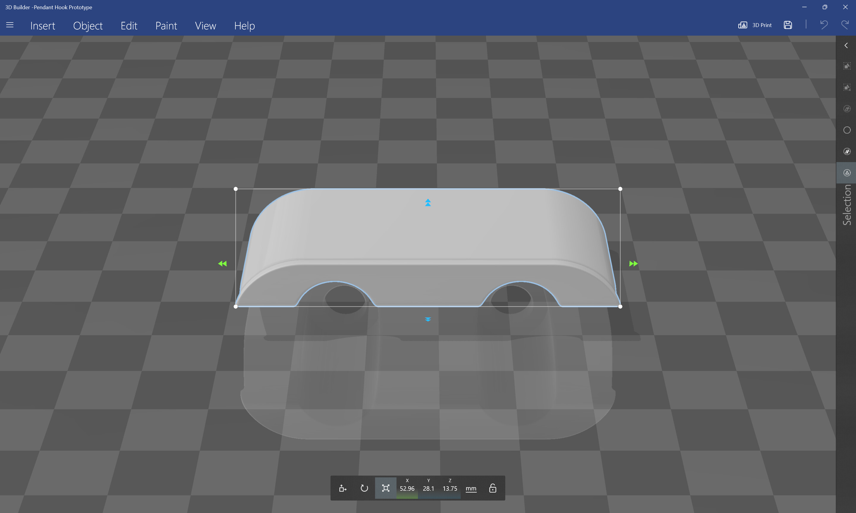

Since Winston published his design for a holder:
the most expedient thing to do is to make use of that for the hangy part…
Opening it in a slicer we are able to export an STL
which then can be imported:

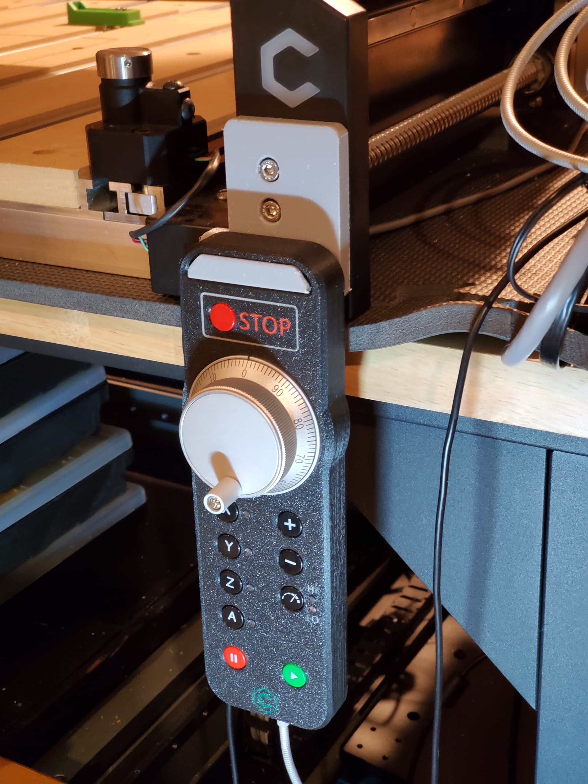

Adjusted a bit:
C3D Pendant Hook_plate.stl (396.0 KB)

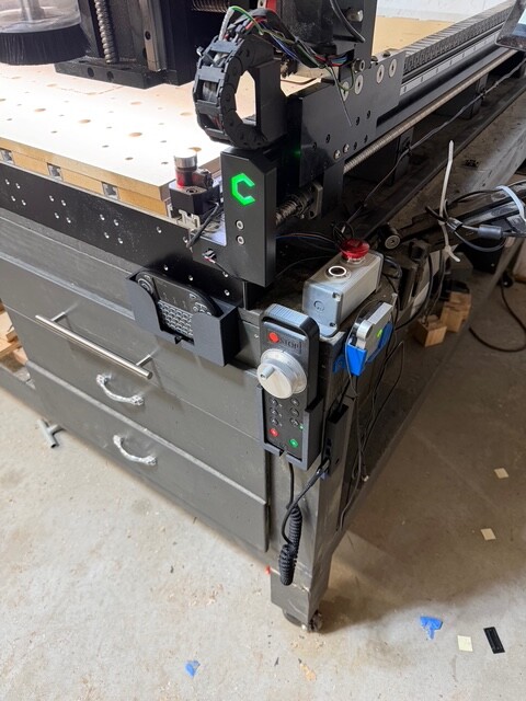

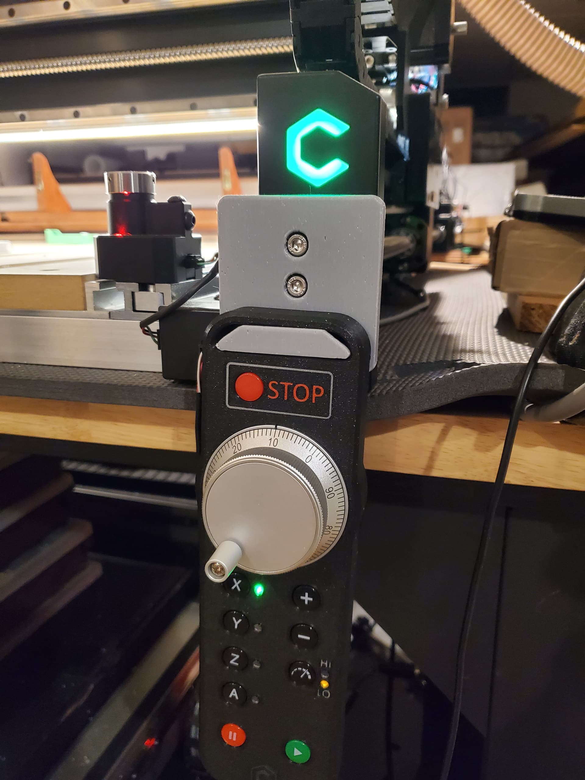

I got my pendant hooked up .
@jtclose :smile: I had mine on a small re-bent steel angle bracket (to avoid the point-loading that your wire is producing–what can I say, I’m a mechanical engineer :roll_eyes:) until I printed Winston’s bracket yesterday.
The file above wants a slim M6 nut — since I didn’t have any at hand, I just pounded in some nylon nuts:
screwed in nylon screws which were just a bit too long, then cut it all off even. Installing now.
Which works fine:
