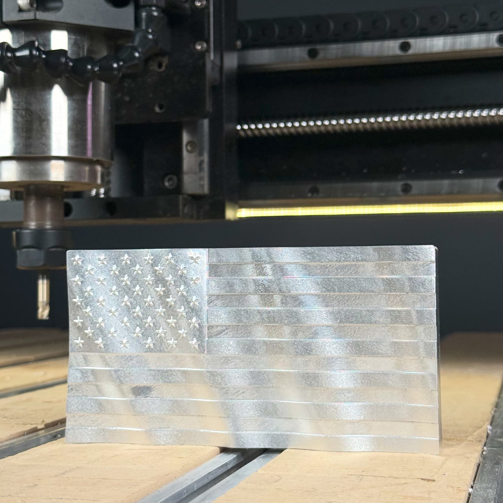

And for everyone else here’s a shot of the aluminum flag from the end of the video. Same techniques as with the wooden flag, but with much more conservative speeds and feeds…
Hey now, that aluminum one looks like it could be made on a Nomad…hold my beer :beers:
Actually I don’t have any beer, hold my Red Bull :ox:
