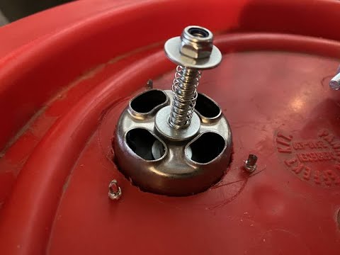

Oneida has a crush proof bucket supposedly. I have been browsing the web for solution and the range from metal drums, pool supply buckets (supposed to be stronger and a screw on lid) and relief valves. There is a nice looking relief valve from Dust Commander but the only source of that I have found in the US is almost as expensive as the Oneida bucket.
Lots of solutions for home made valves out there as well such as this one:
Seems like a restrictive hose / nozzle would be the reason for a crushed bucket. I’m using the same Home Depot bucket I picked up with my separator. The only time I see the sides pull in a bit are when I restrict the flow at the nozzle.

I found some more stuff laying around and changed it. 2.5 inch all the way from the router to the vac now with the exception of the inlet on the cyclone separator. I softened all areas it may have been pinching before as well. The bucket still collapsed.
Switched to a different bucket and so far so good but it isn’t translucent unfortunately.
