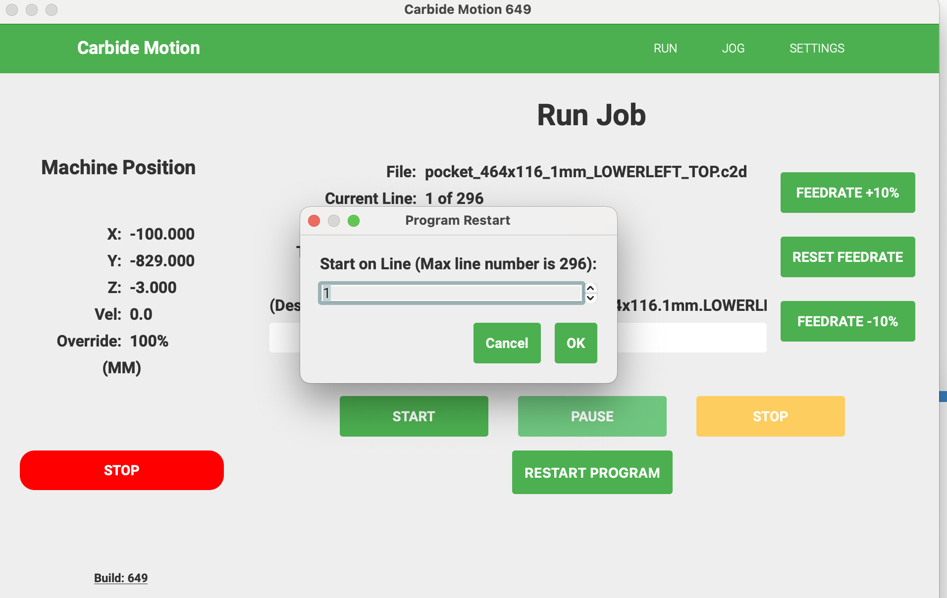

This is a suggestion. If Carbide Motion disconnects mid-job, would there be a way you could save where it got to somewhere eg in a file?
If not is there a way to know where one should restart from?
Carbide Motion should do this and automatically manage a re-start:

I have used this a couple of times. You have to know the approximate line number to restart at.
I use ncviewer to find a line number somewhere before the last cut. I use the z axis value as a guide.
The beta versions of CM ( 641 + ) have the restart capability.
You will have to re zero values if you had a panic stop.
Basically, Carbide Motion keeps track of where it is when cutting a file, and if the cut is interrupted, where it was at.
It then offers the user the chance to restart the file where the cut was interrupted.

After CM gets disconnected, I have to connect the Shapeoko load a file again. There is no restart button until I am running the job. So I first mke sure I am loading the same file as before, then it asks me which line to start from. HOw do I know which line unless CM records it somewhere at the time of disconnect.
