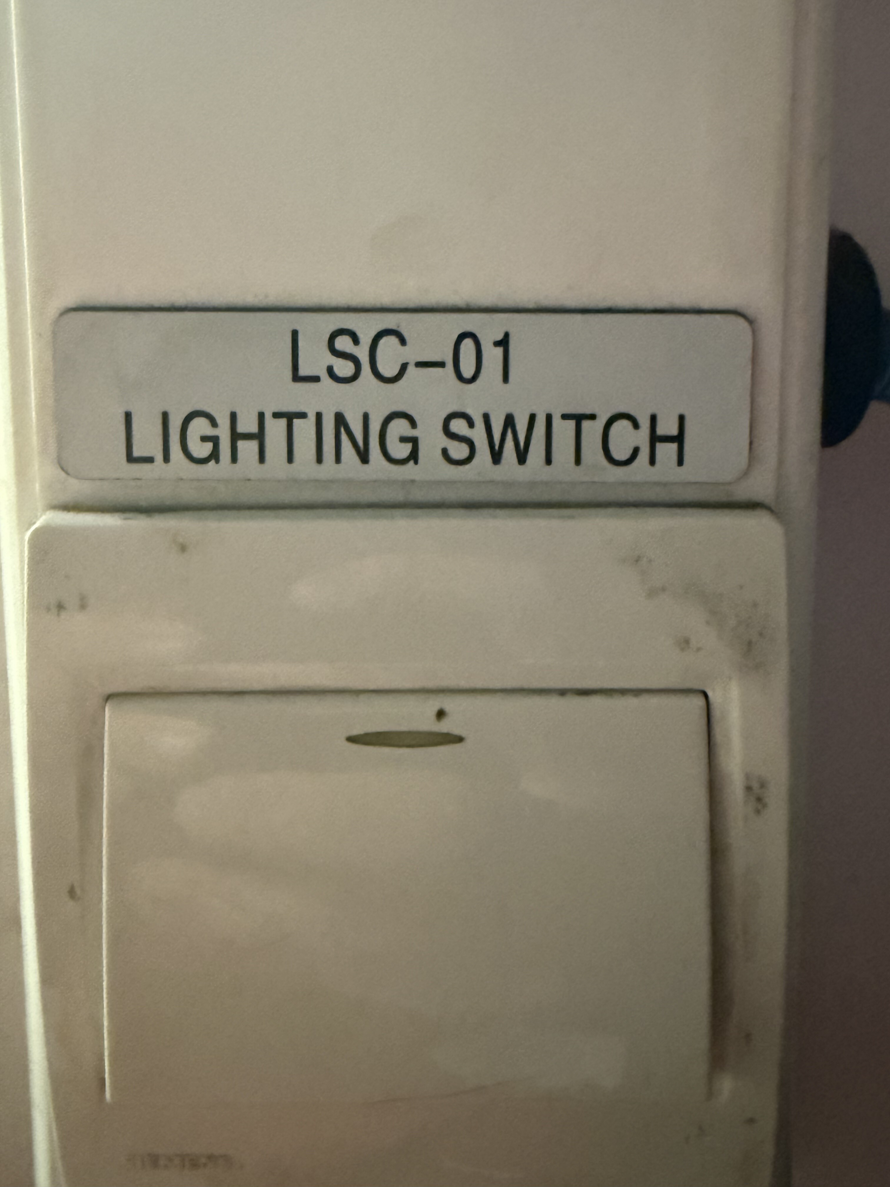

I’m looking at creating some labels for equipment at work. Are single line fonts the way to go, or would a simple font like arial do fine? What is everyone’s experience with this?
Also, what is a good source for the best materials to use? I read in a previously closed post that single flute bits work best. Any tips/tricks/advice is appreciated.

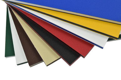

Look into ColorCore.
Alternatively, I have use Max Metal in the past. It is 2 very thin layers of aluminum with a plastic center. You can cut through the aluminum to expose the color of the plastic in the middle. The color choices would be greater with ColorCore though.
You can also get dual or even tri layer acrylic. Its really designed for laser work which is where I have used it. I guess you could get it to work on the CNC but the top layer is super thin so tolerances would be tight. You could however glue up your own acrylic to provide a multi layer effect.

That sign in your picture is engraved in what is generically referred to as two-color phenolic. If you search for “two-color phenolic for signs” you should find what you are looking for.
