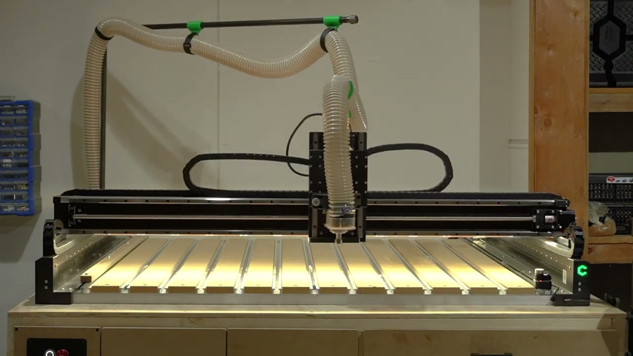

Here is my solution.
I designed and 3D Printed a “gimbal” mount that fits over the Z-stepper. It allows the hose to rotate freely and prevents sharp bends:
The dust hose is mounted on a swing arm made of black iron pipes (I tried PVC pipes at first, but there was too much flex). I keep an extra 10’ dust hose in my cabinet:
I can use the extra hose to connect vacuum accessories and tools quickly:
Here is the swing arm in action:

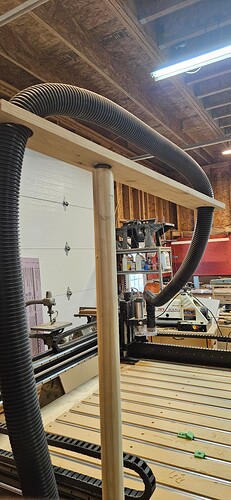

I made a rotatable support arm for the hose and attached it through a bearing onto a post mounted to the side of my
table.
This allows me to move the table if I need to.
