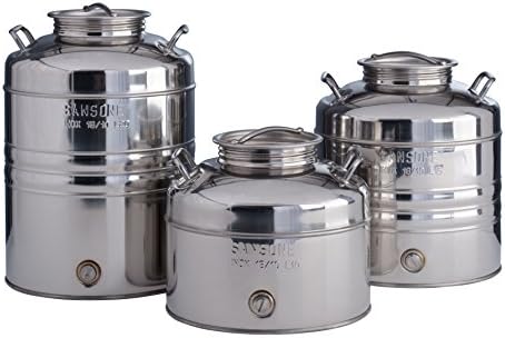

I was running a couple of wood projects yesterday and having a blast. I did make a small mistake and drop a machine vice which then bounced into my dust collector tub (fitted to my dust cyclone).
This put a small crack in my brewing barrel that I was using. Nothing duct tape can’t fix right?
Anyway I’m now looking to replace my broken dust barrel with something better. What kind of containers are people using? Not I can’t use anything crazy big due to space and don’t do loads of wood work.

(Luke) #3
That looks almost spot on for me.
I used a brewer barrel but it also collapsed under the pressure until I made reinforcement rings. I assume you don’t have any issues with a metal one?

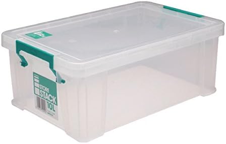

I’m considering mounting mine to the wall I don’t have any floor space to the side of my machine any more :frowning: I was wondering if a small plastic box say 10L like this would work:
I could then fit it under my bench.

That plastic box could do just fine I guess, but I would we worried that the pile of chips/dust may not spread over the full width of the box, and that you would have to empty it long before the full volume has been used. But then again, the cyclone itself being quite tall, if your height is very contrained…

Luke the concern I’d have about the particular box you showed is that it would implode under vacuum. It’s early for me (pre-coffee) so I probably haven’t thought this thru but my Oneida UDD is a pretty stiff walled container and when I turn on the sucker I can see the walls slightly compress.

Yeh thats my main concern. I had to add internal baffles to keep it in one piece.

Flat sides will not withstand much vacuum. Cylindrical is best.

(Luke) #13
I went with the metal barrel in the end.
I do run a antistatic hose and will ground it to. My trusty Henry :joy:
