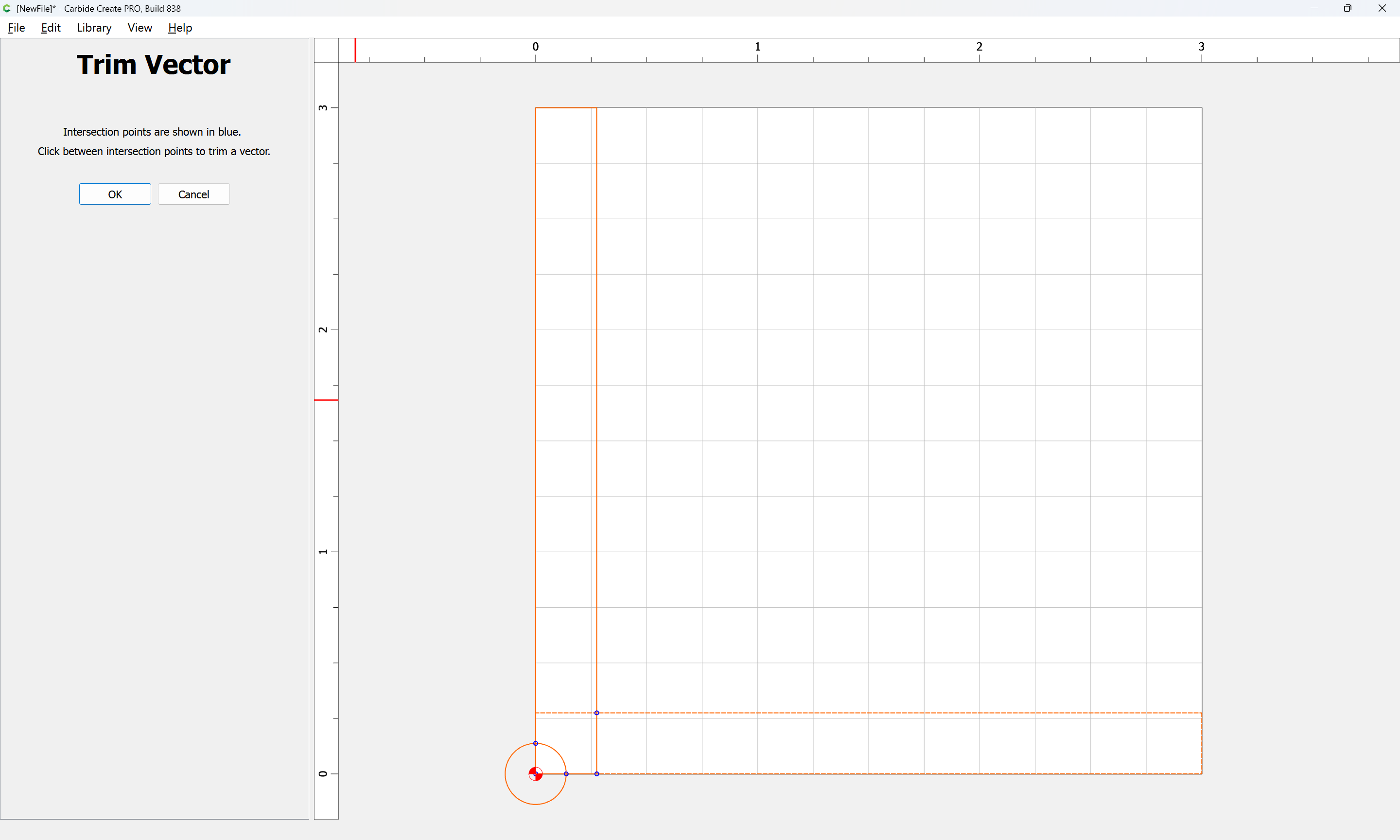

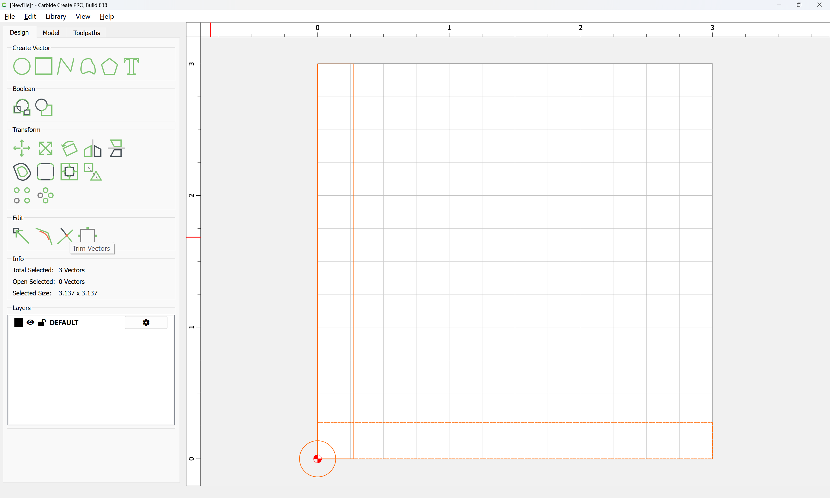

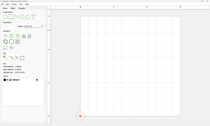

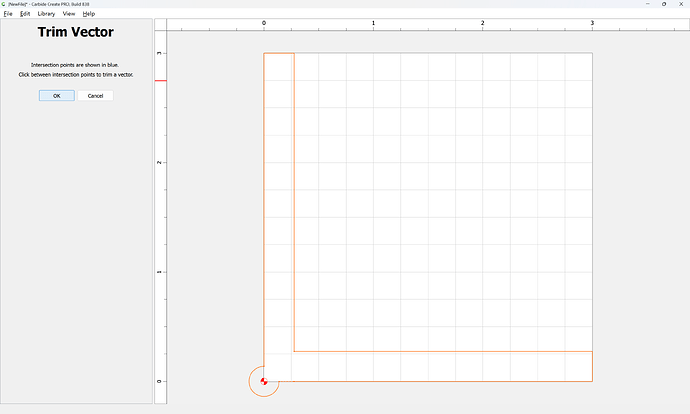

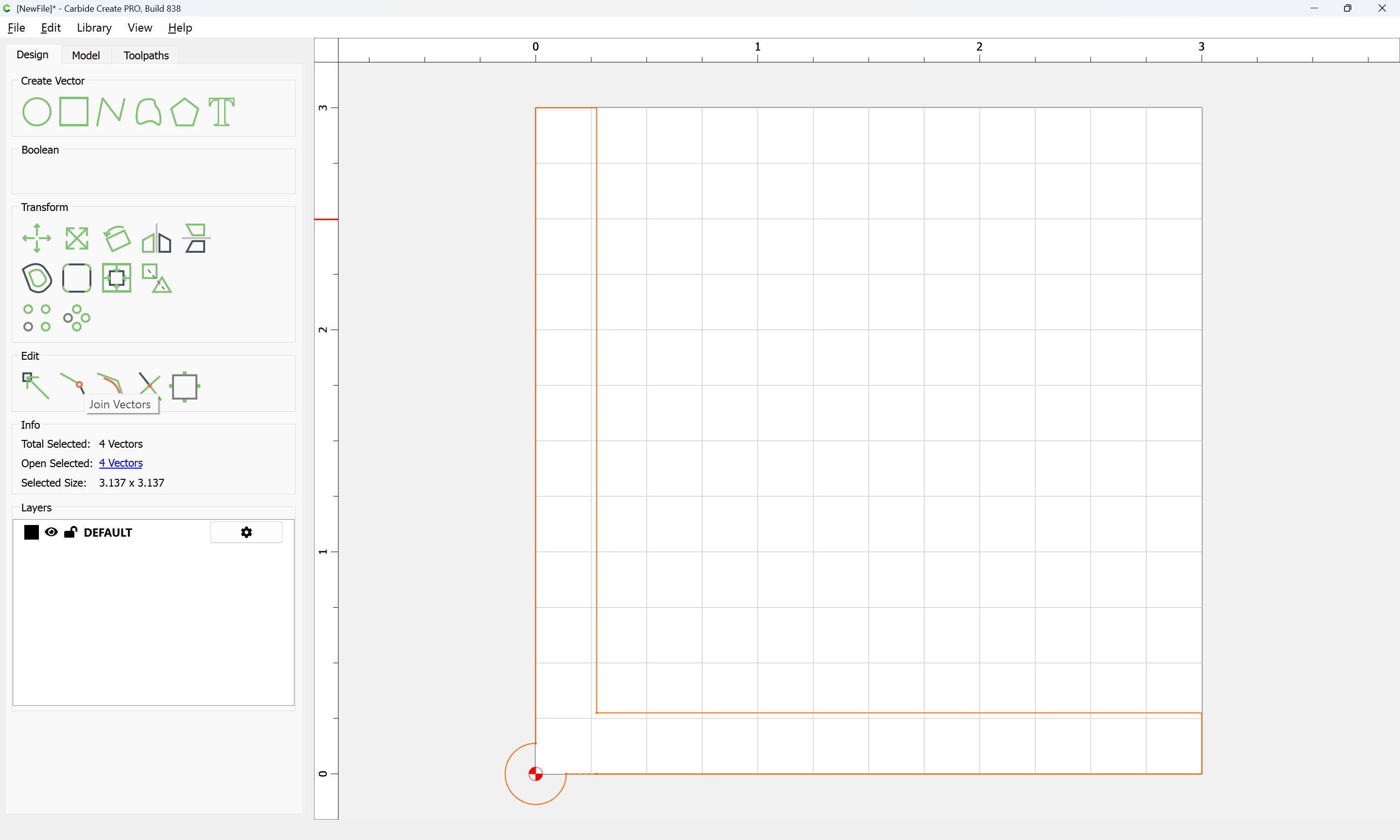

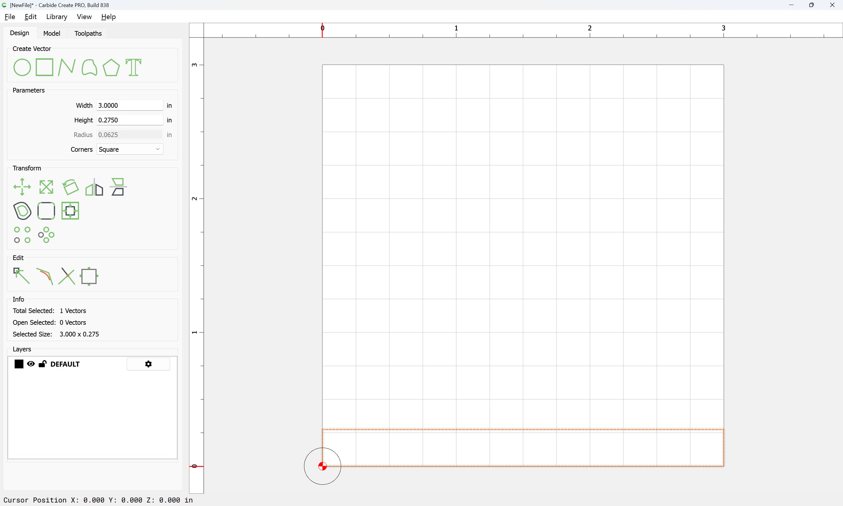

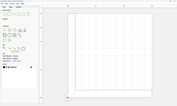

Has anyone made the left edge guide that Kevin makes …where do set your x,y,z to make the cut on it once it’s bolted down to the table to even it out ?
We have some edge guides in the Carbide 3D Print Library:

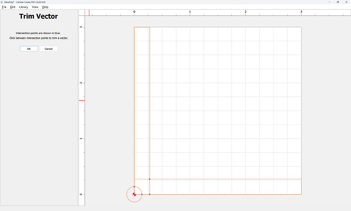

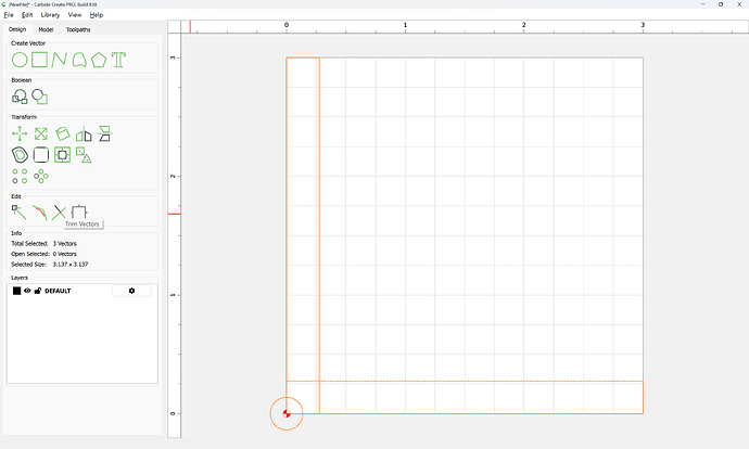

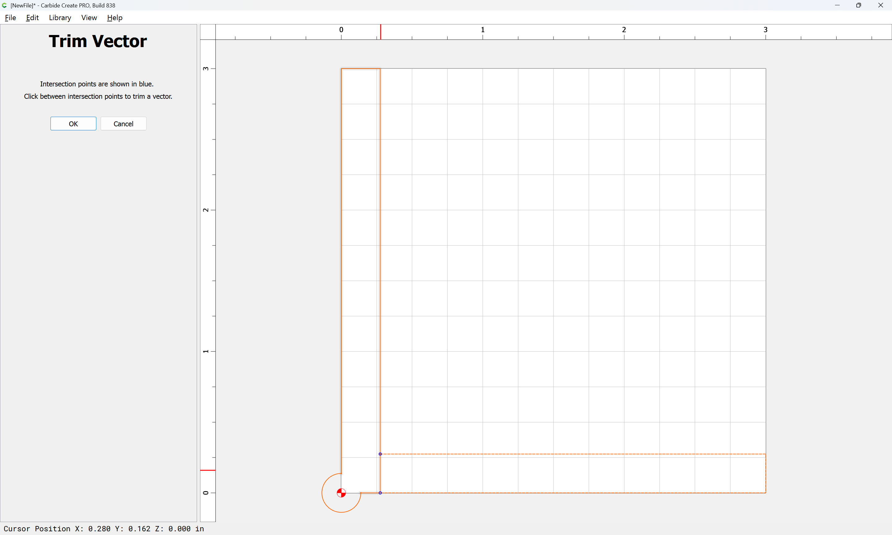

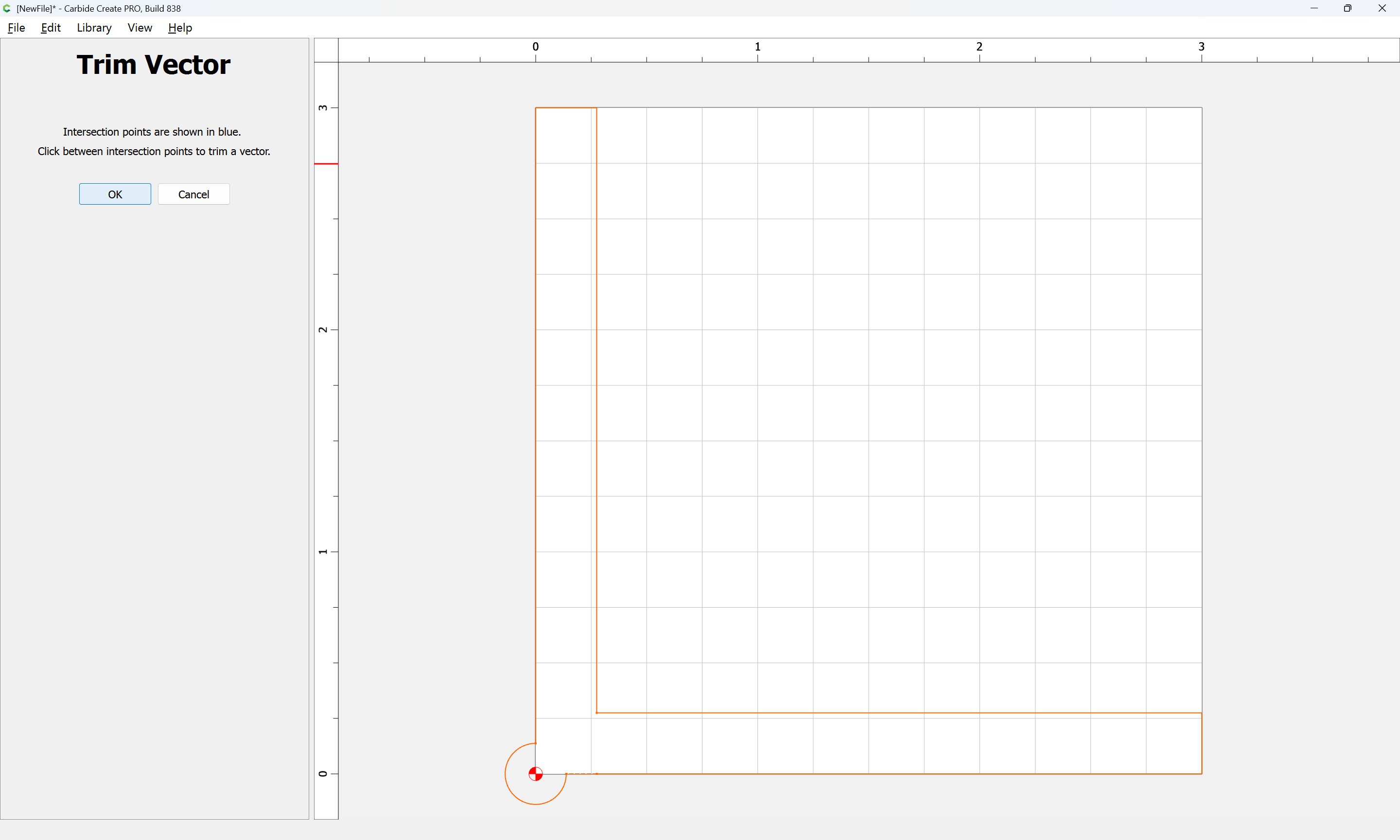

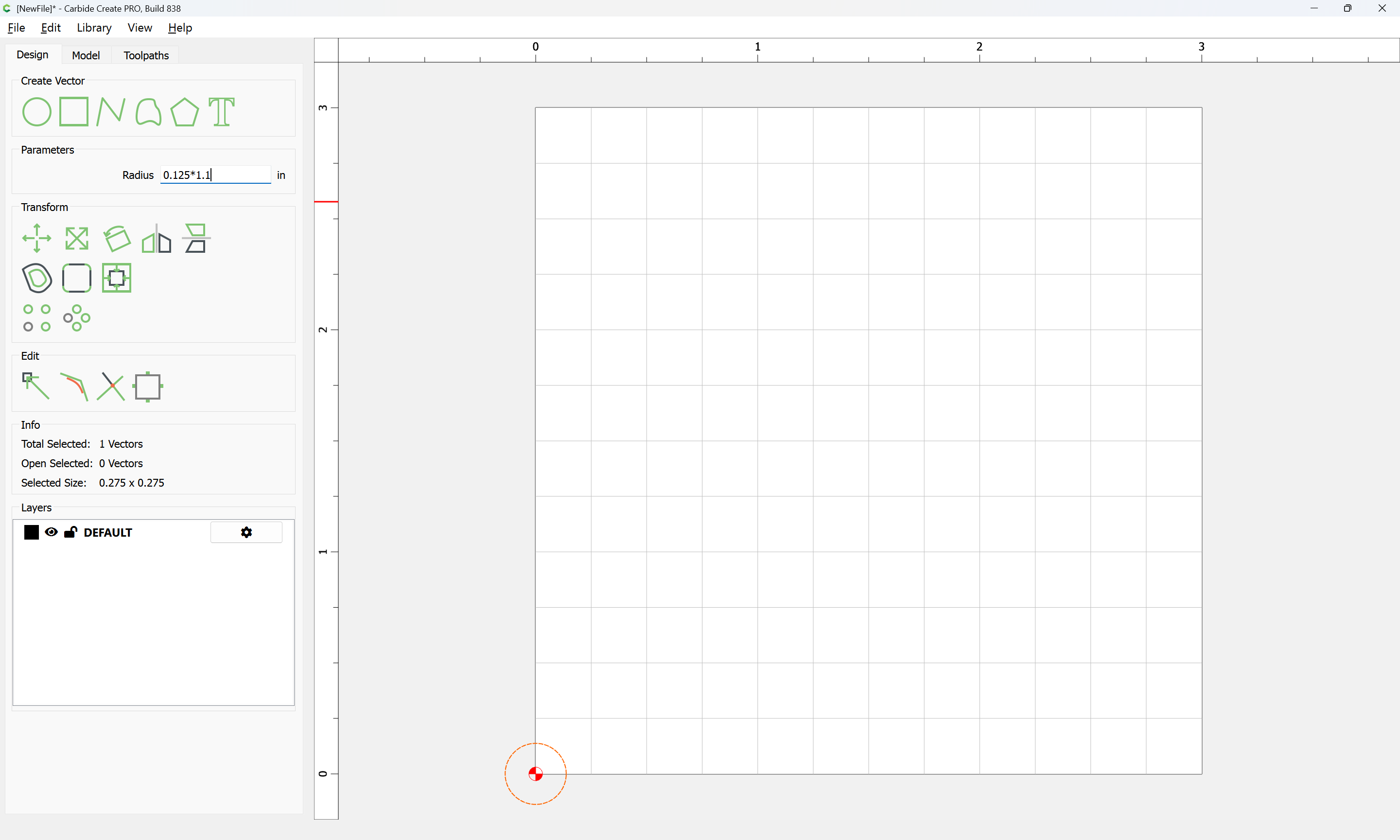

Where the origin would be set would depend on the toolpath being used, but I’d suggest one which would allow the origin of the file to match where one actually wants to set it, so something like:
until one arrives at:
