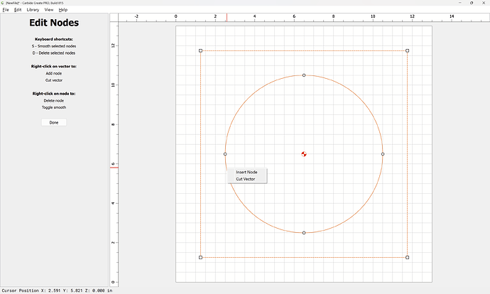

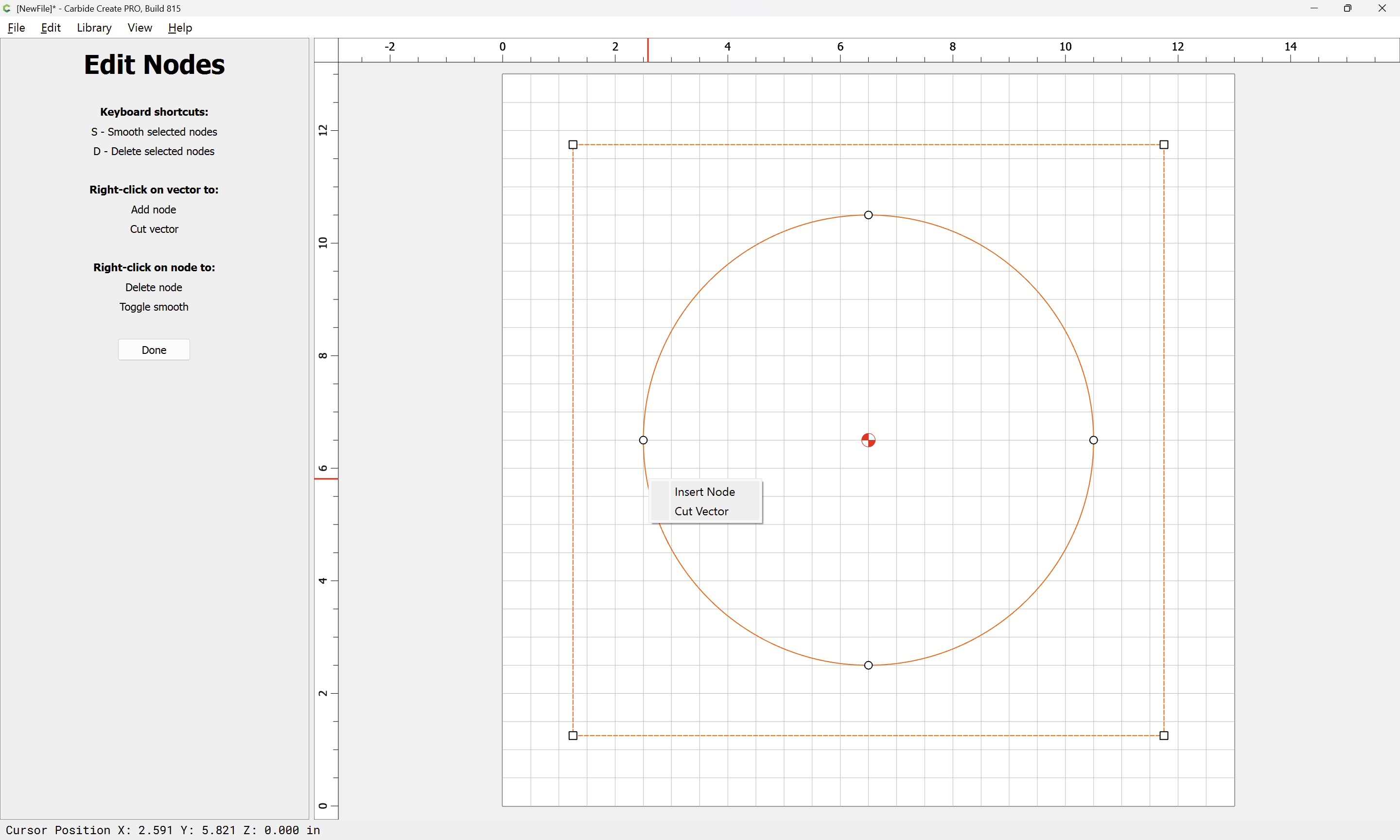

Square indicates a “Sharp Node”, or one which doesn’t have off-curve nodes associated w/ it, so will make a straight line.
Round indicates a “Smooth Node” where the associated off-curve nodes are symmetric.
To cut, right-click and choose:
