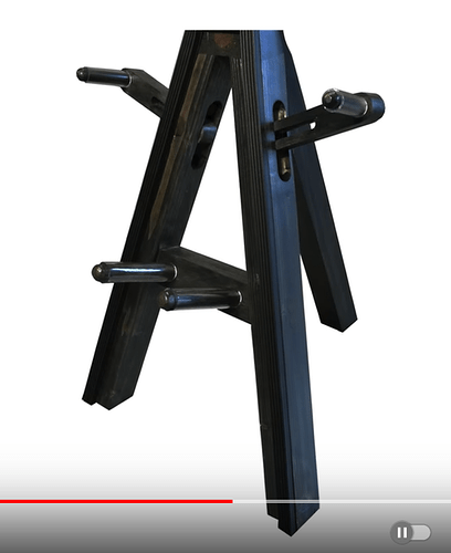

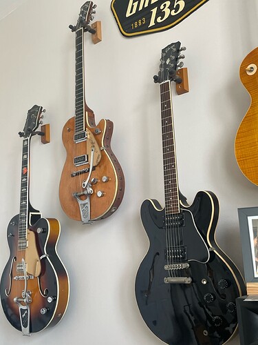

I am not a guitar player. My question is does it hurt a guitar to hang from the neck only with no bottom support? Can some of the guitar players chime in if just hanging from the neck is good/bad. The answer to my question will help me decide on a design. I did find an interesting picture of a stand made from someone that was making a Flying V and used the cut offs to make the stand.
I am not making a guitar and have no cut offs but I have a bunch of mahagoney to build one from.
I found this one but the maker/website is not there any more.

For this application, either method is fine. The vertical orientation is the proper method, preferable in the case. More important is the material the finish on the guitar come in contact with. Some of the cheaper brand hangers/stands will stain the finish. We use the Hercules brand and have never had a problem.
We used a cradle for a double neck. Not the best idea but, not one of our most expensive guitars.
I like the first one you have pictured, and as long as you had some dimensions to go by, it shouldn’t need any specialized hardware.
