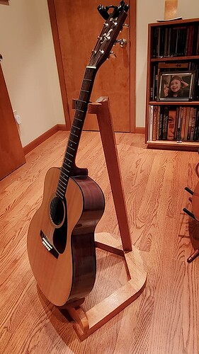

The real key is to make sure that the center of gravity of the guitar falls inside the structure of the stand. If it’s hanging forward or back of the leg structure, you’re going to make it tippy. This is one that I made several years ago for my dad (who was a professional 7-string jazz guitarist…and who could EASILY knock over a guitar!) I used leather strips (from a guitar strap, actually) as my cushioning in the stirrups in several of this model…and it never marred any finish.
Those are very nice. I like the first one. That would work for the Flying V because it is bottom heavy.
