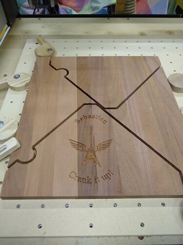

Please comment on my Flying V Guitar Stand. There is an offset needed for the guitar hanger on the back of the stand. The kickstand will still need to have a folding mechanism worked out so the kick stand can be folded down and the whole thing stored against the wall. I could make the kickstand permanent but likely will make it hinge and fold up.
On the left lower corner of the picture are the inverted v shape from the last post. That will have a leather cover on the top to protect the guitar. This is 1.5" thick. The rest of the stand will be .75" thick.
If you want to be a bit clever with the design, you may want to consider altering the “A” support to mimmic the shape of the guitar “V” body. Maybe not a direct copy, but you can certainly replace the angles with curves and round over the edges.
Granted it is the backside and less visible, but it would complement the specific instrument it holds.
I am still in the development stage. The offset for the neck and the guitar hanger will get sculpted like the neck of the guitar. The rear kickstand will likely be half lapped through traditional methods. I was just throwing out this rough sketch to get feed back for the practicality of it. I am not a guitar player just the donor for my grandson. The one thing I have decided on is the vcarve for the Epiphone logo is to fill it with red epoxy. I thought about filling the flying v and name with epoxy but it is messy and the acrylic paint is protected by the recess. Still working on the design. I need to make a prototype for the kickstand because I want it to lever down in position and then fold up for storage. May have to offset the kickstand to give me room for the folding. Thanks for the input.

Made progress. I got the whole stand cut out but not glued up. Here is the pictures.
All I have left to do is make a retainer for the kickstand so it can fold down.
