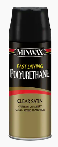

Is it consistent enough to not have to do anything about it? I went so far as to make a polypropylene jig for through-hole epoxy pours, but there is always some leaking.
If there is any bleeding, I’m going to suggest using this as a sealer. I’ve had wonderful success with it, there are many different brands, it’s super easy to use and readily available:
Would it be worth the effort to put just a small bit of clear epoxy in each cavity before you add the colorant, to prevent any of the colored epoxy from seeping through - basically the trivet cavity version of putting a clear coat on a v-carve before painting to prevent color bleeding?
Maybe just paint on a thin layer of clear epoxy on the trivet before you clamp the trivet to the Plexiglas and pour the colored epoxy?
Yup, that is my go-to for clear coating something that is not going to get spray painted.
By the way, I found out that if you coat wood with this, then v-carve and spray paint the carve, the interaction of this and the spray paint will cause the paint to bubble and wrinkle. I didn’t find out until it happened.
The answer for me was to first, find out that clear spray paint exists, and then use that clear spray paint if I plan on paint filling in any carving I do. I have mentioned it before, but thought I would mention it again so someone doesn’t have to go through what I did.
