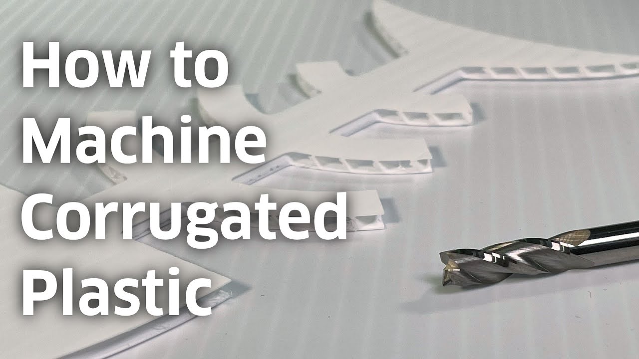

I also hand cut all of my corrugated plastic with an xacto knife (3mm-10mm thick Coro). In the past, I have tried a compression bit around 20k-23k rpm and many different feed rates with some decent success (not too messy). I have never tried an O flute, but I would like to. Itâs a tricky material when it comes to workholding options (very flimsy as you have seen).

Yeah, that is what I discovered last night. I will try the compression bit that @wmoy mentioned in his video and the O flute.

That is a great video. You can see how workholding options are tricky, Coro tends to move around in every direction. I donât know much about the SharkTooth pen holder, but it would be very convenient if something like that would work for Coro. I wouldnât even care about perpendicularity or runout, itâs such a cheap material⌠no matter how you cut it, it never looks great.
