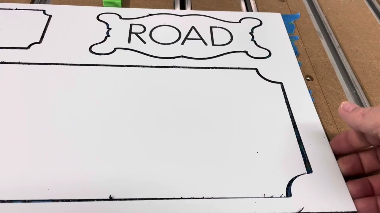

After the distraction of my failed attempt to convert the SharkTooth to a drag knife I finally had a chance to do the test cuts in maxmetal.
I used a 1/8 compression bit at a DOC of .126” cutting through in one pass except for the one with the word.
The sign place I am working with makes road signs for neighborhoods and puts vinyl iver the maxmetal substrate. So she wanted to see if I could cut some profiles. I did a small sign test and then a more fancy one and then a large one about 18” wide.
It al went really well. Very little cleanup when done. There was no real need for deburring. I just ran an xacto blade across the cut edge and wiped with an old rag.
I did have an issue with Vectric Vcarve I will post about in another thread but switched to CC and all was well.
And for the coroplast I have ordered the SST drag knife. I have to leave town for a week but hope to try that when I get back.
That’s great! Looks like I’ll be buying some compression endmills (save myself some clean-up time). Sorry the Shark Tooth/xacto setup didn’t cut properly, but your test results have a lot of valuable info (of course). Thanks!
This is the one I used for this.
